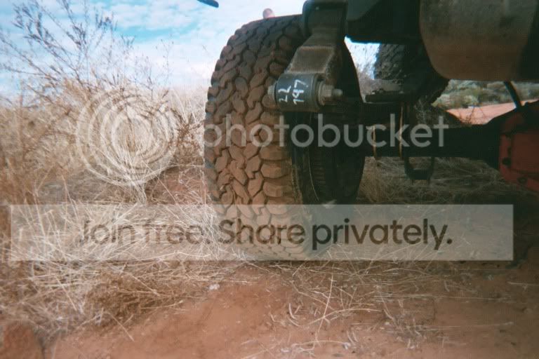

Just got done putting 2in. lift 57in. Alcans in the back of my truck and it sits a little low for me and the shackle angle is not the best. I don't want to move the front hanger back so I was thinking about selling these and getting some 63's. These 2in. lift Alcans are flat with the truck's weight on them. Will stock 63's give me lift? Should I go with 2 in. lift 63's?
Here are some pics of how it sits now. In the front it has 6in. skyjacker softrides and the axle moved forward 1in. with zero-rates. The rear has a 4in. shackle flip, beefed lowering shackle 8in. long, 2in. lift 57in. Alcans with the center pin hole centered in the spring pack, axle moved forward 1in. with zero-rates(I had thought the springs would move the axle back 3in... not quite :doah: )
I also included a pic of the tires that I will be putting on. They're 44's(measure about 42in.).
