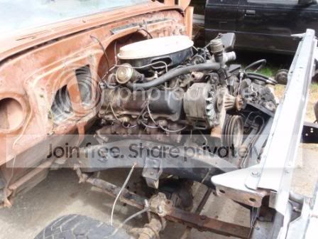

So here it is in place:

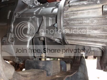

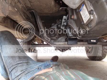

and here are some of the transmission cross member you can probably see some of my concers:

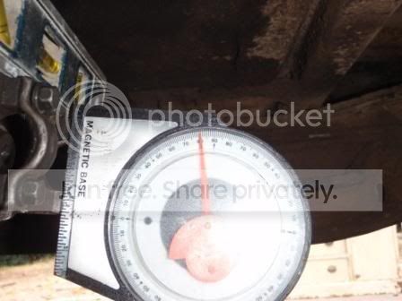

^ with the camera prependicular to the yoke face of the front axle.

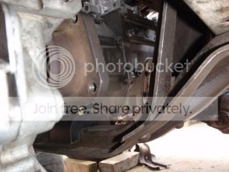

^ and from the just behind.
You can see the clearance was just barely there. Well the spacer I had in there between the stock crossmember (moved back about 2") and the transmission was a 2" x 3" .120 wall box tube. So I put in a 2" x 4" and picked up more. But there is only +/- .5" between the upper most parts of the TCase and the floor pan.
The extra inch also helped reduce the dirve shaft angles:
^ this was with the 3" spacer in.

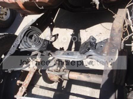

Plus I ground down the rivets and removed on the upper TCase xmember seen on this photo:

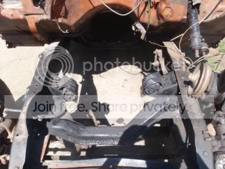

I am trying to fit this into this:
And the best way I have found to do this from the pirate forums is to use second gen Blazer and it looks something like this:

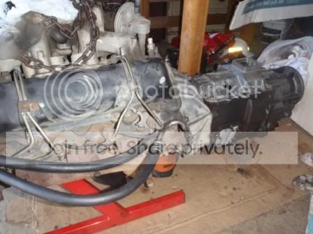

These are 1987 chevy halfton motor mounts mounted in the front hole of the factory first gen mounts. I had to oblong them just a bit to match the on-center bolt spacing from the second gen chevy. The rear bolts of the mounts had to be drilled into the frame. I test fit the motor and it fits! So I drilled out the rest of the holes that I can reach with a drill and bolt it all together for hopefully the last time.
I am using all of the factory nv4500 bell housing and hydraulic clutch.
