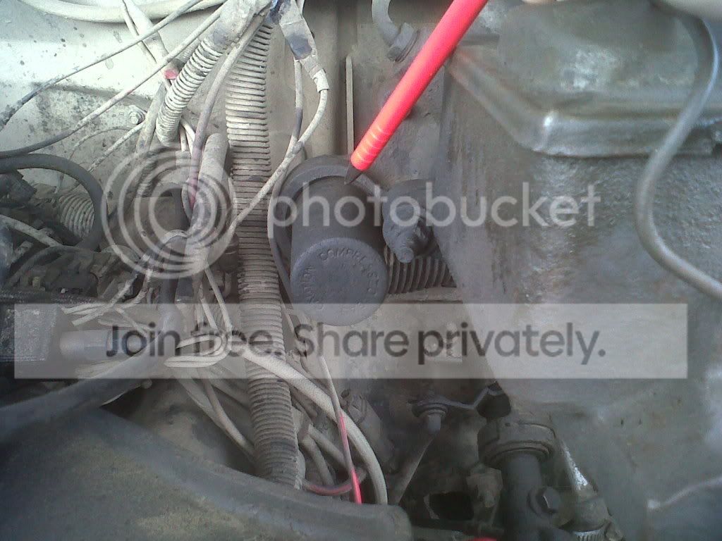

Hey COKE I've got the same truck. Had the same problems and found that there was a small stress crack on my hydroboost, had to replace it was bleeding some of the pressure. I never would have seen it without another set of eyes on it... It was leaking just a touch around the edge of that cylindrical pressure vessel on the front of the assembly.

Scotty ,did you have to replace the whole thing or just the golden cylinder?

I ended up replacing the whole thing. Reason was, I tried the wreckers' to replace just that cylinder but almost every time that thing was either missing or broken. I'm going to take a wild guess that it's not uncommon for its seal to break or the thing breaks itself. Got a full new assembly, remanufactured, for about $200. That's about a year and a half ago, and so far so good.
Just check around it, I dumped some water over it while the engine was running (messy ask I know) and could see it sputtering over where the pressure was escaping. If you're lucky it's where you can see it, if not it could still be along the bottom and it'll take a much more careful look.
Thanks Scotty,It does,nt show leaks when the pedal is depressed.It has a little film of oil& dust covering it but i suppouse that this is usual.
