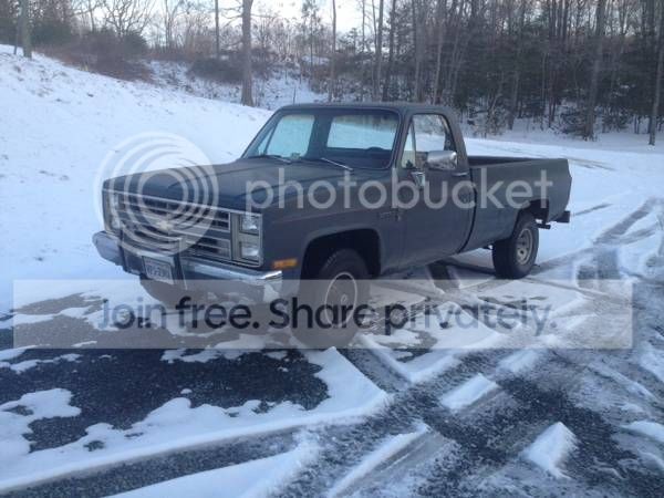

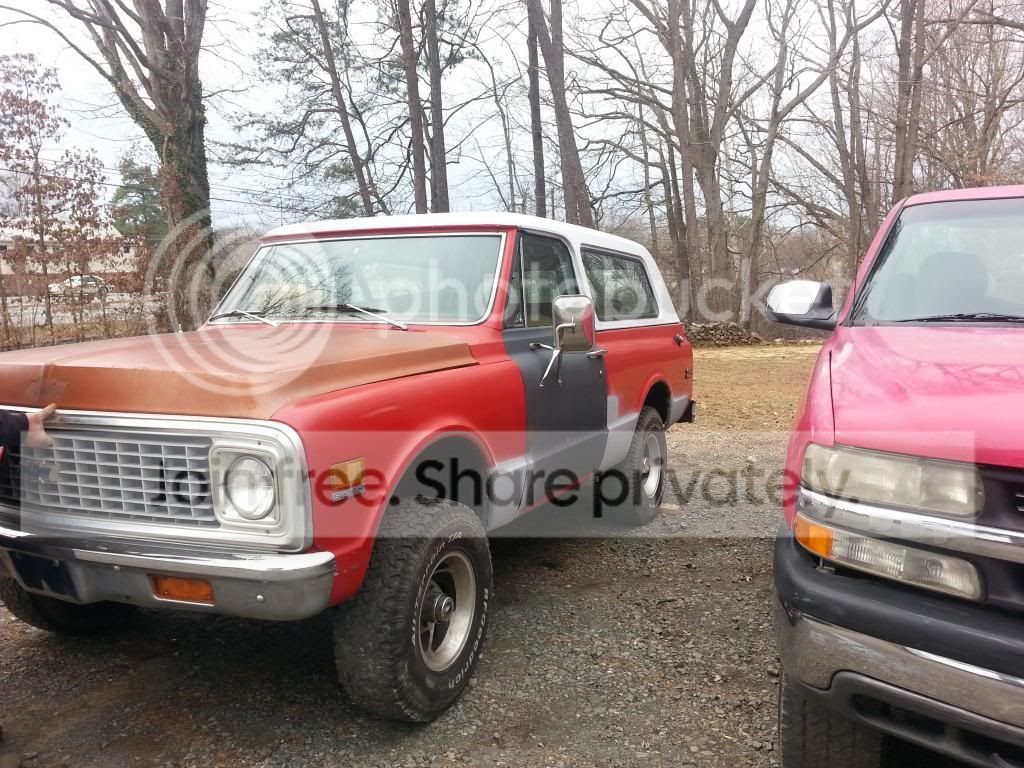

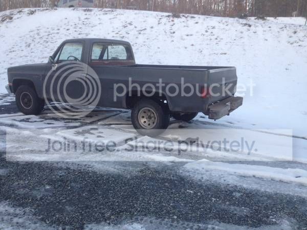

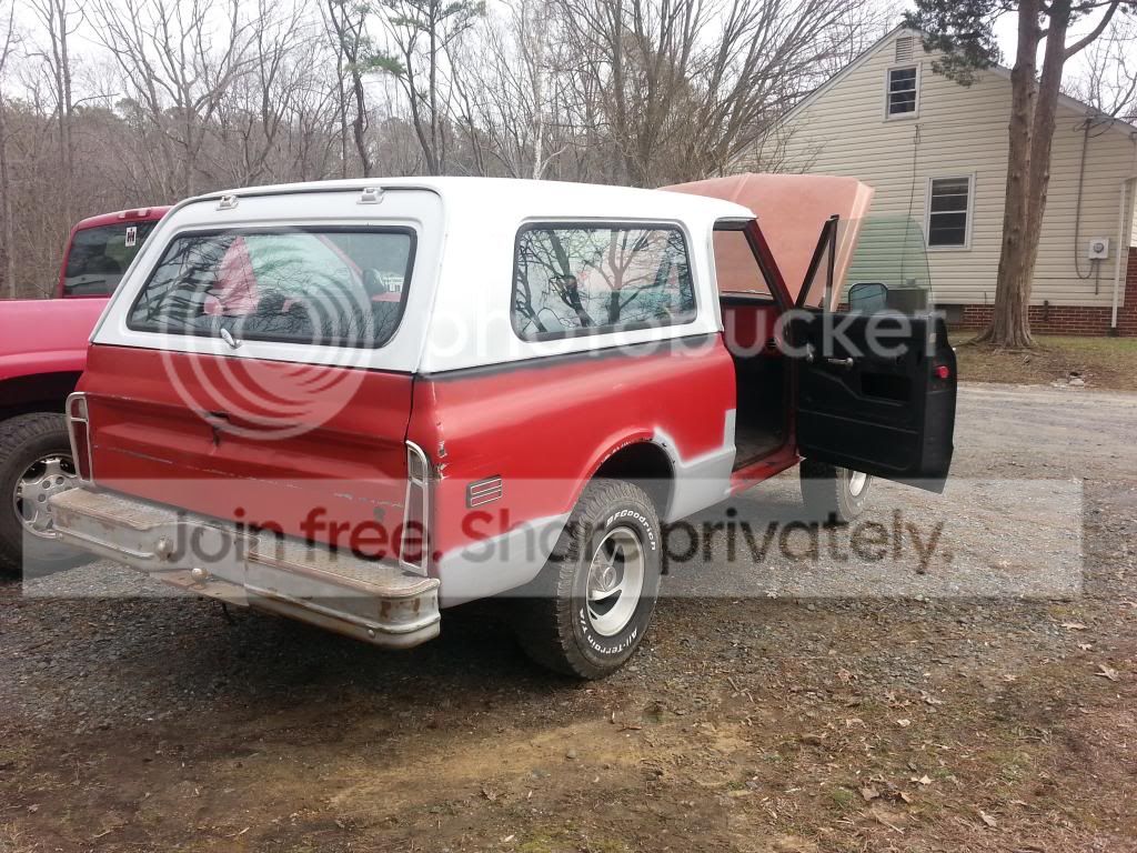

Anyone have any info? If not you will here shortly. I just took delivery of an 82 K10 (yea a half ton) with a 6.2/700R4 combo and I do not know the tcase. It has a 10 bolt out back that will go in the K5 since the front axle is going too. From my reading since I have a donor truck I can swap pretty much the entire front end over from the 82 to the 72 and plumb it and wire it. There is where I am stuck: wiring. What really is involved with wiring to make my stock cluster work in the 72? I would love to keep my tach more than anything. Hook me up guys! What y'all got? :bow:
The truck getting the coal burner:
The coal burner:
