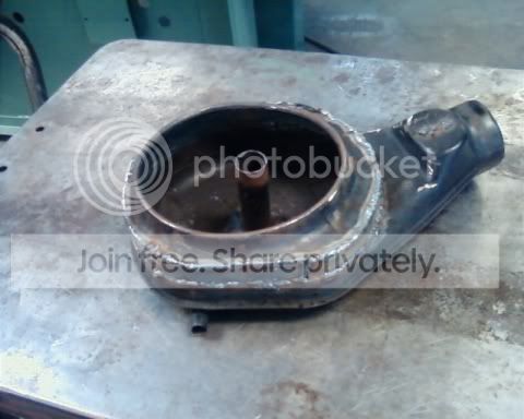

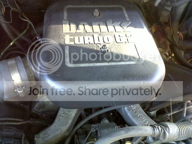

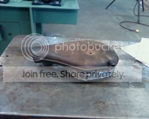

Here's a pics of Banks, and a pic of a custom hat I made for my '67 C-30. I cut the base off a stock 6.2 intake and welded to the inlet of a 1970 Porsche oil bath air cleaner. It had the correct 2.5" connection on it, and it looked cool, so I fabbed it up. It even had a nipple that I welded in a threaded insert and installed my boost guage there.
