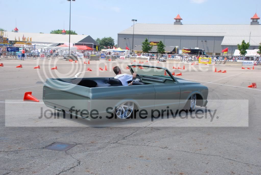

i believe its a simple shaft swap, i did a 12 bolt that way, have a 69 k5 that had 5 lug rear:dunno: and a 68 c10 that i converted to 5 lug and i pulled the covers, the crossshaft pushed axles in pulled c-clips and swapped the shafts,put it all back together, now the 69 has 6 lug as it should have and the 68 has 5 lug, glad it worked out b/c the 68 c10 has a special housing for the panhard bar...up front i swapped a 79 frontend into it crossmember and all, just had to drill a few holes. stops so much better than 4 drums...the 69 k5 still a work in progress, it was going to be a mall cruiser and i'm now thinking of going 2wd w/it on a c10 frame which has coils at all 4 corners and bagging it...heres what i see in my head

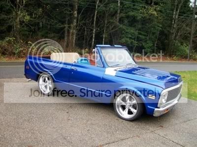

i have the 68 front end even...or more practical

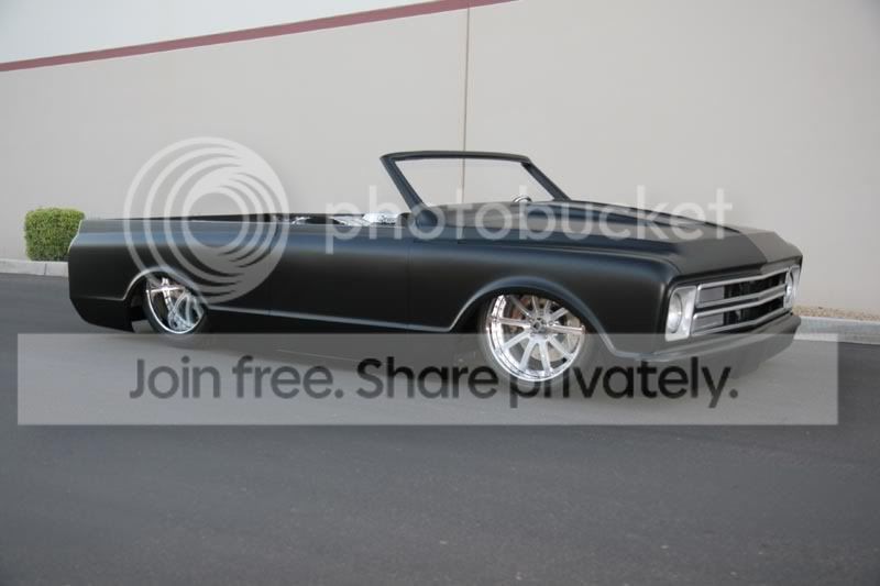

please don't hate me...i wasn't going to wheel it anyway
That blue one is very nice. The black is too, but I don't care for the layin' frame look.

what paint was used in the flat black truck i like how smooth it looks

i believe that black truck is just primer...b/c i have this pic and i'm pretty sure its the same truck painted silver,...
