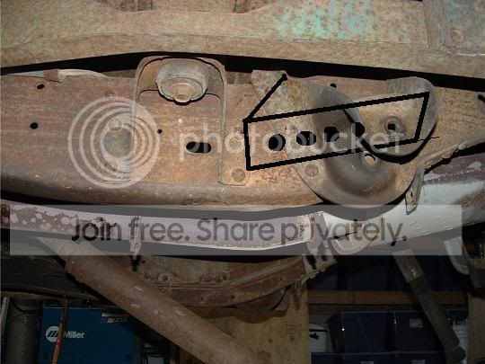

Im doing a 64 swap on my sub and am running into some of the same issues.Im going to move my fuel tank cross members back 3 or so inches and remount them the diff will hit the tank for sure. quarters are going to need work too also inner fender wells.
you have to change and modify alot to keep the front hanger in the stock location. its quicker cleaner and easier to move the front hanger.
Im lookin at buying the new c chanel pieces from diy that he uses on the front b52 kit and cuting the tabs off the stack hanger and welding this piece in. Should give me 3 to 4 inches of adjustability for rear shackle angle and also put the axle forward a couple making everythig easier.
P.S. trying to get kirt to fab a set i think alot could and would use them..
Here is a crapy drawing but by keeping the hanger in the stock location it keeps the belly flater and this would move it preaty close to where i think we all need to be only down fall i see is you are going to loose a couple degrees of pinion angle but i guess it could be turned flater instead of a slant down .02
diy part
and then my crappy drawing
