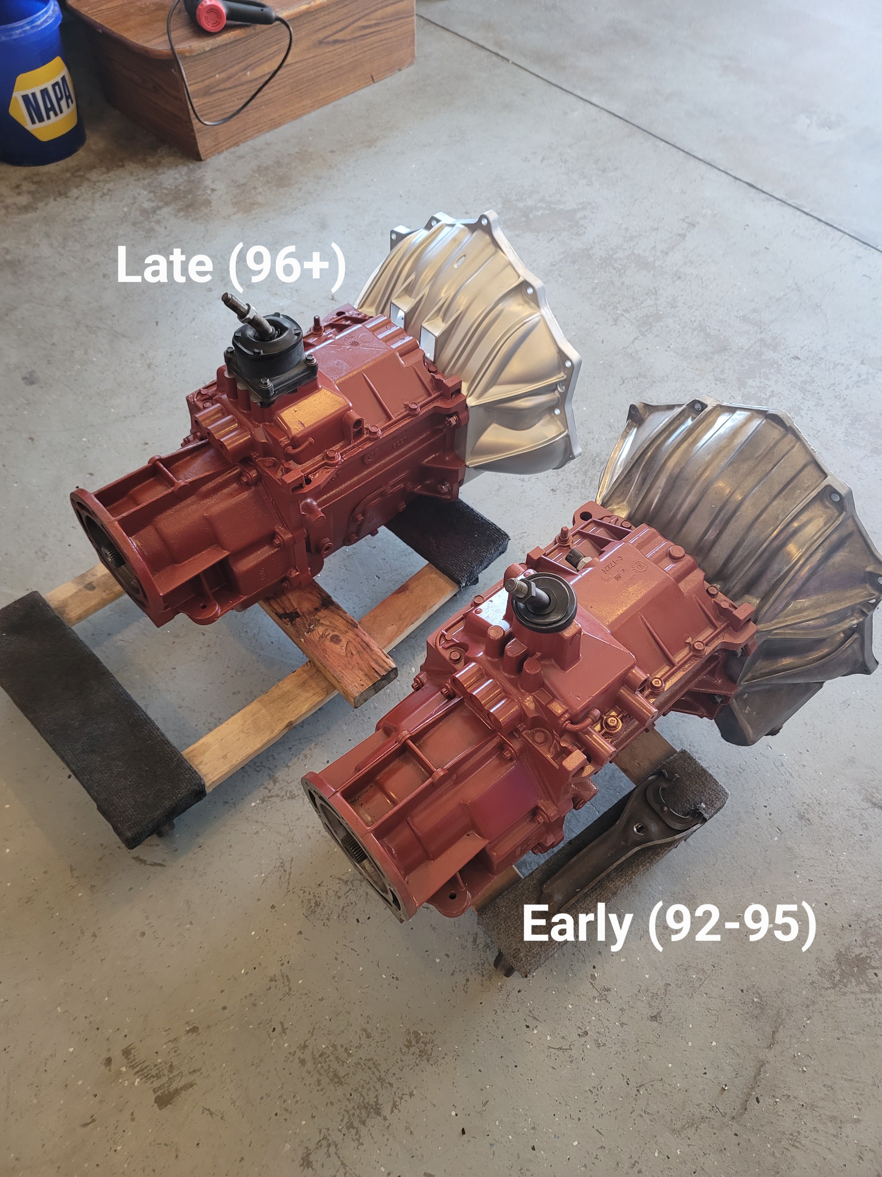

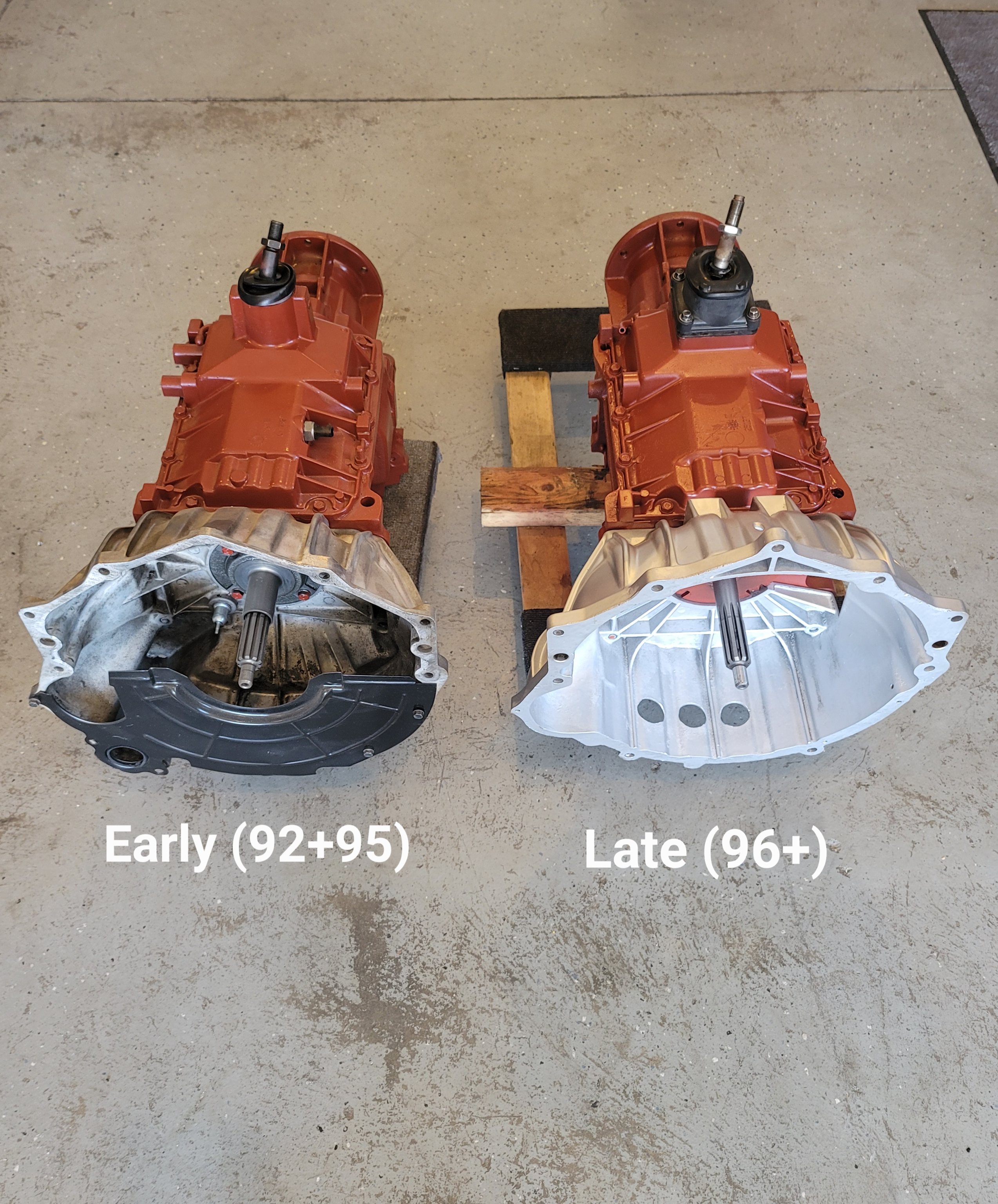

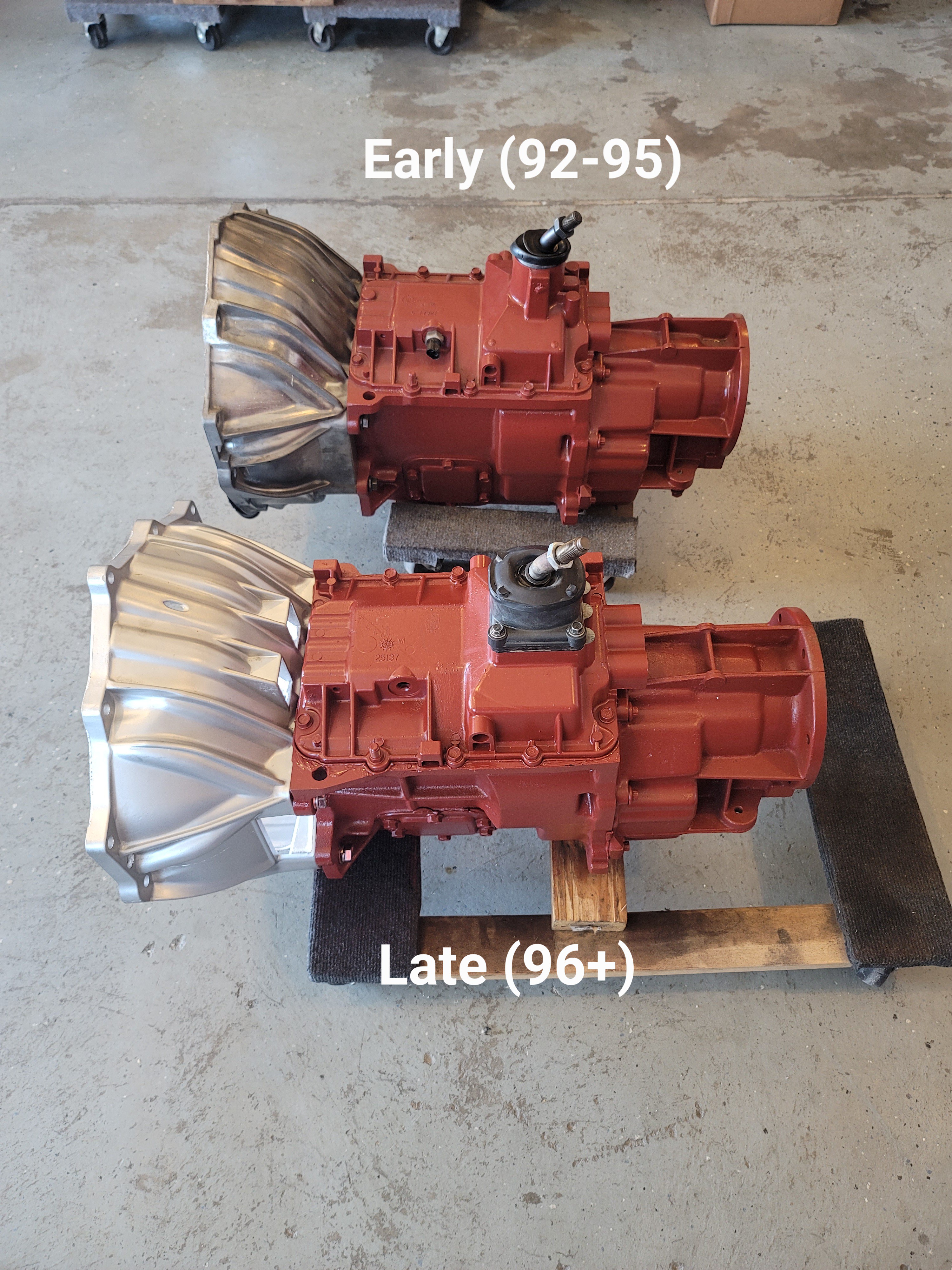

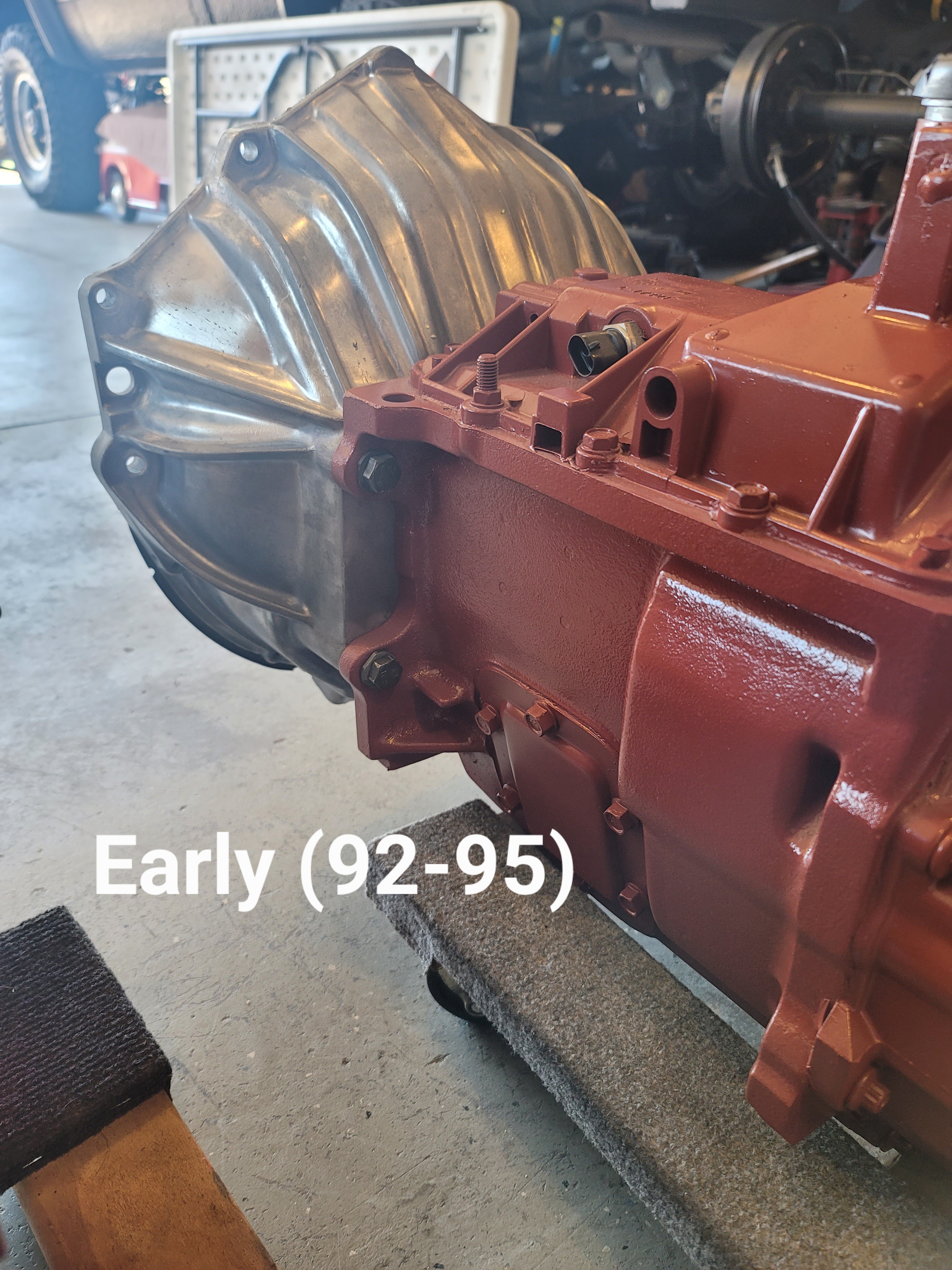

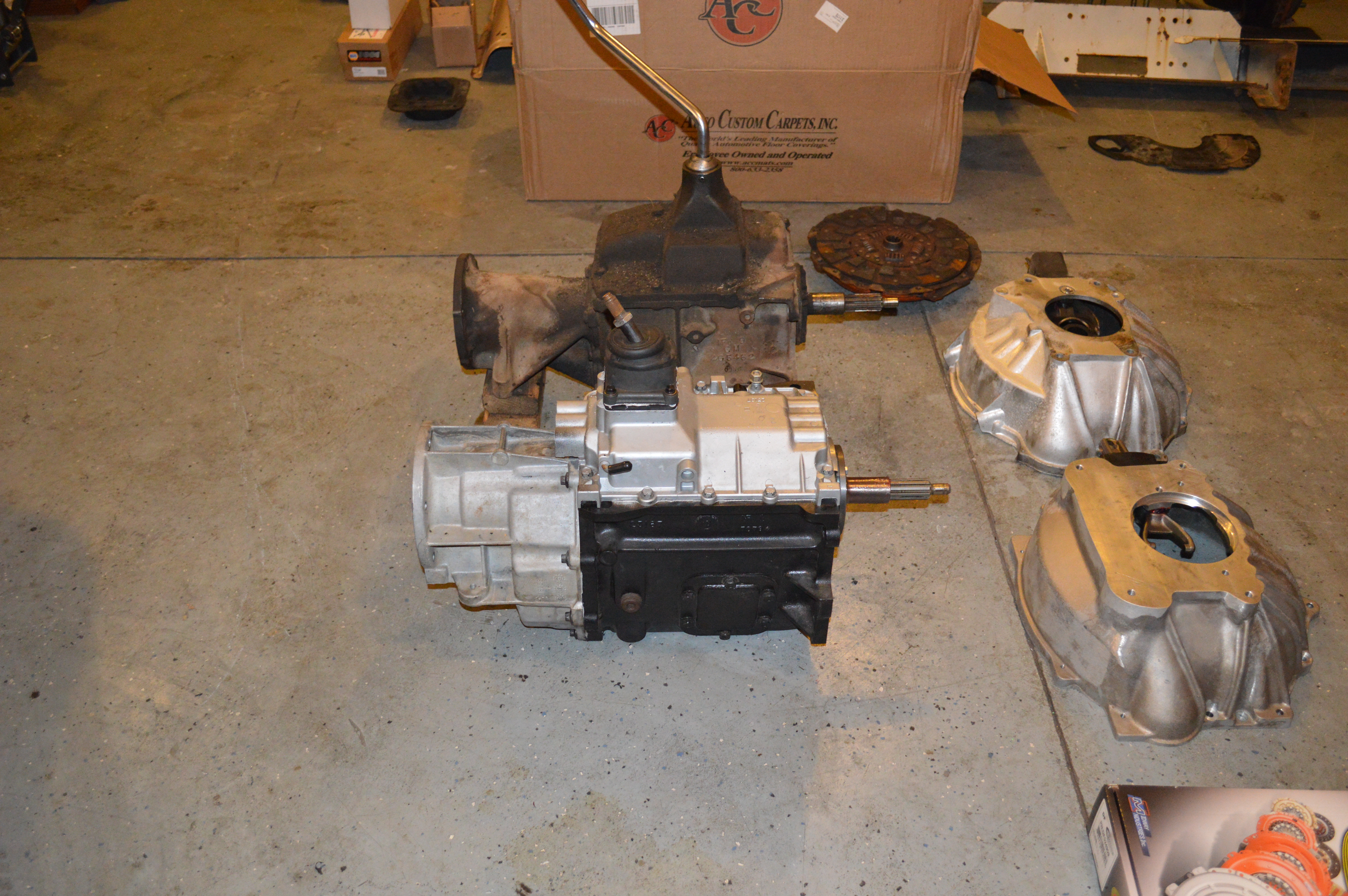

NV4500 to SM465 Comparison shots. Courtesy of Larry and his flickr page.

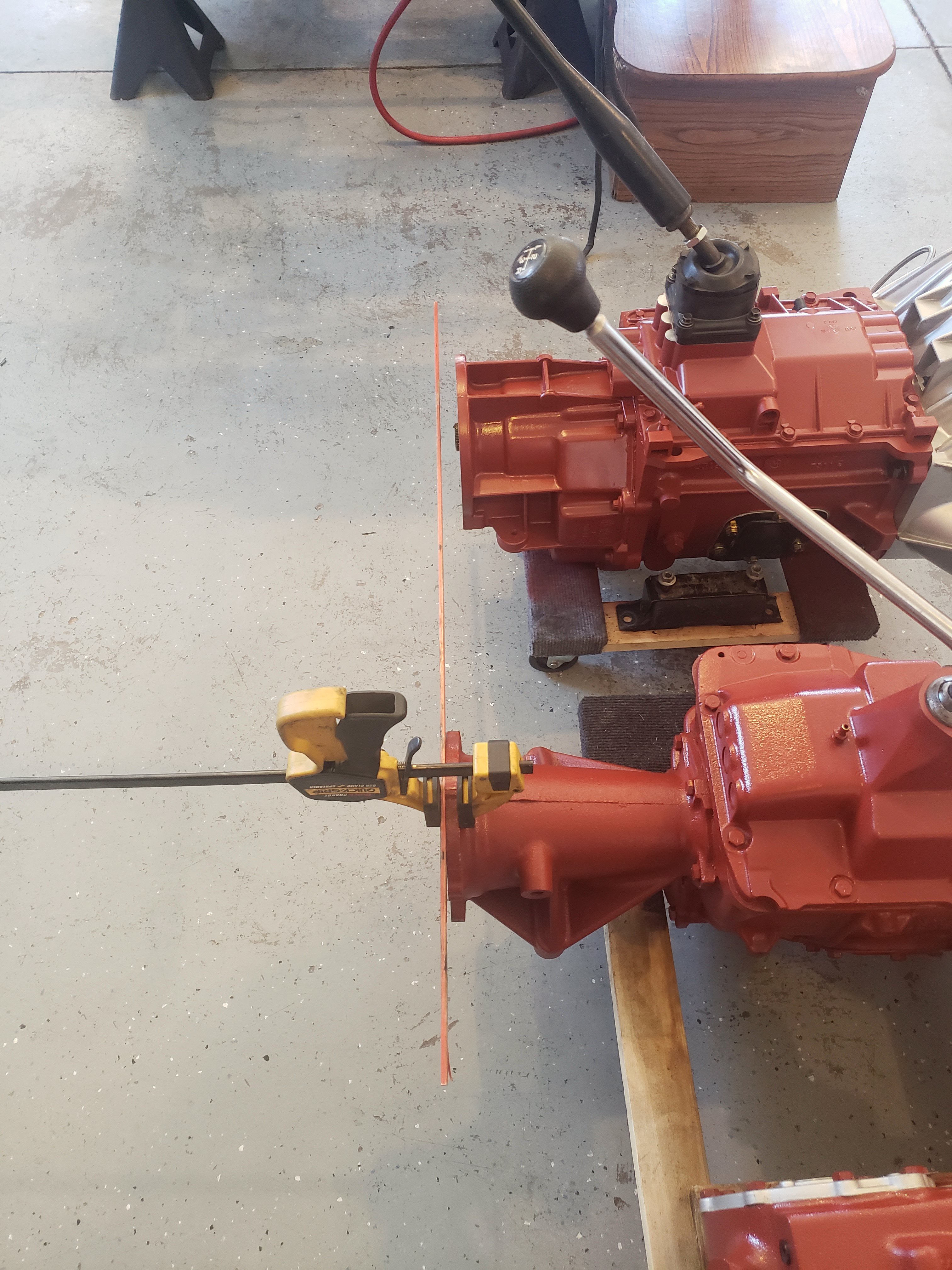

465 to 4500 overall length:

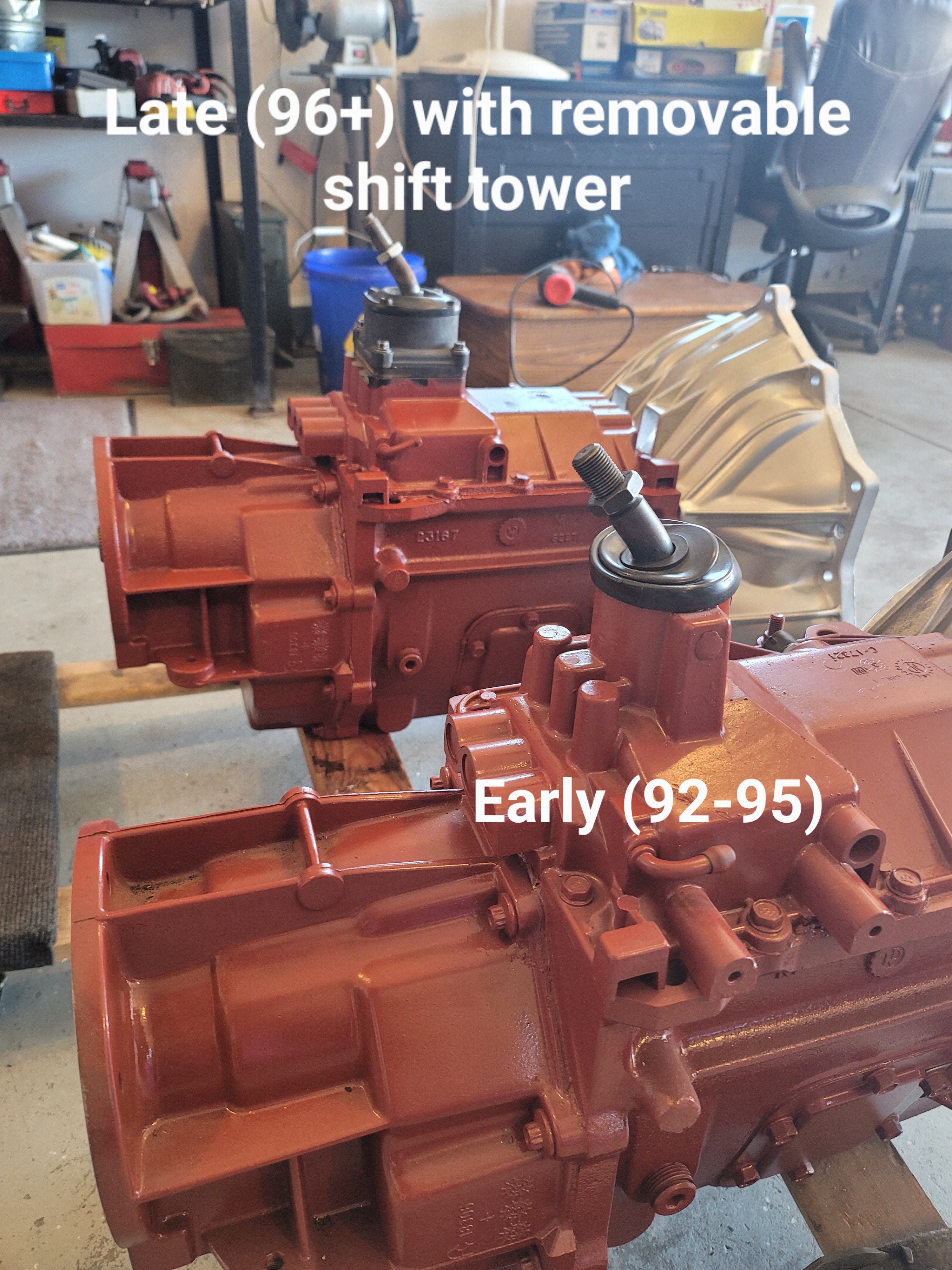

Early 4500, you can tell by the non-bolt on shift tower.
Comparisons:
Bell housing comparisions:

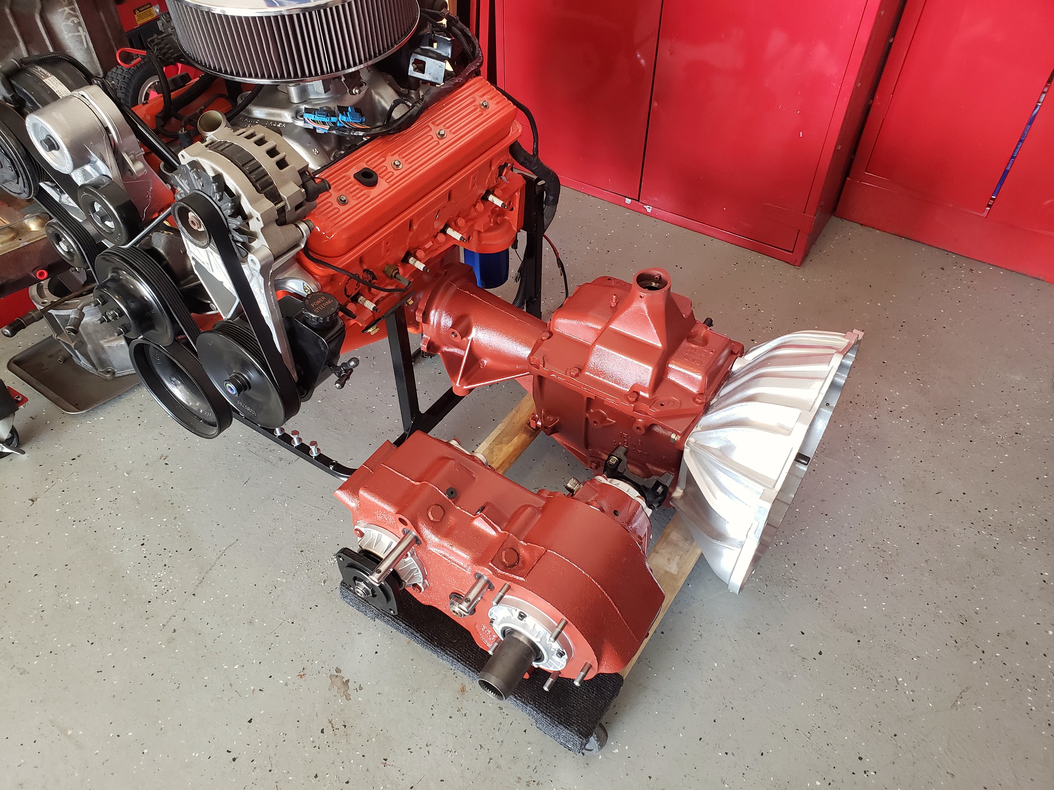

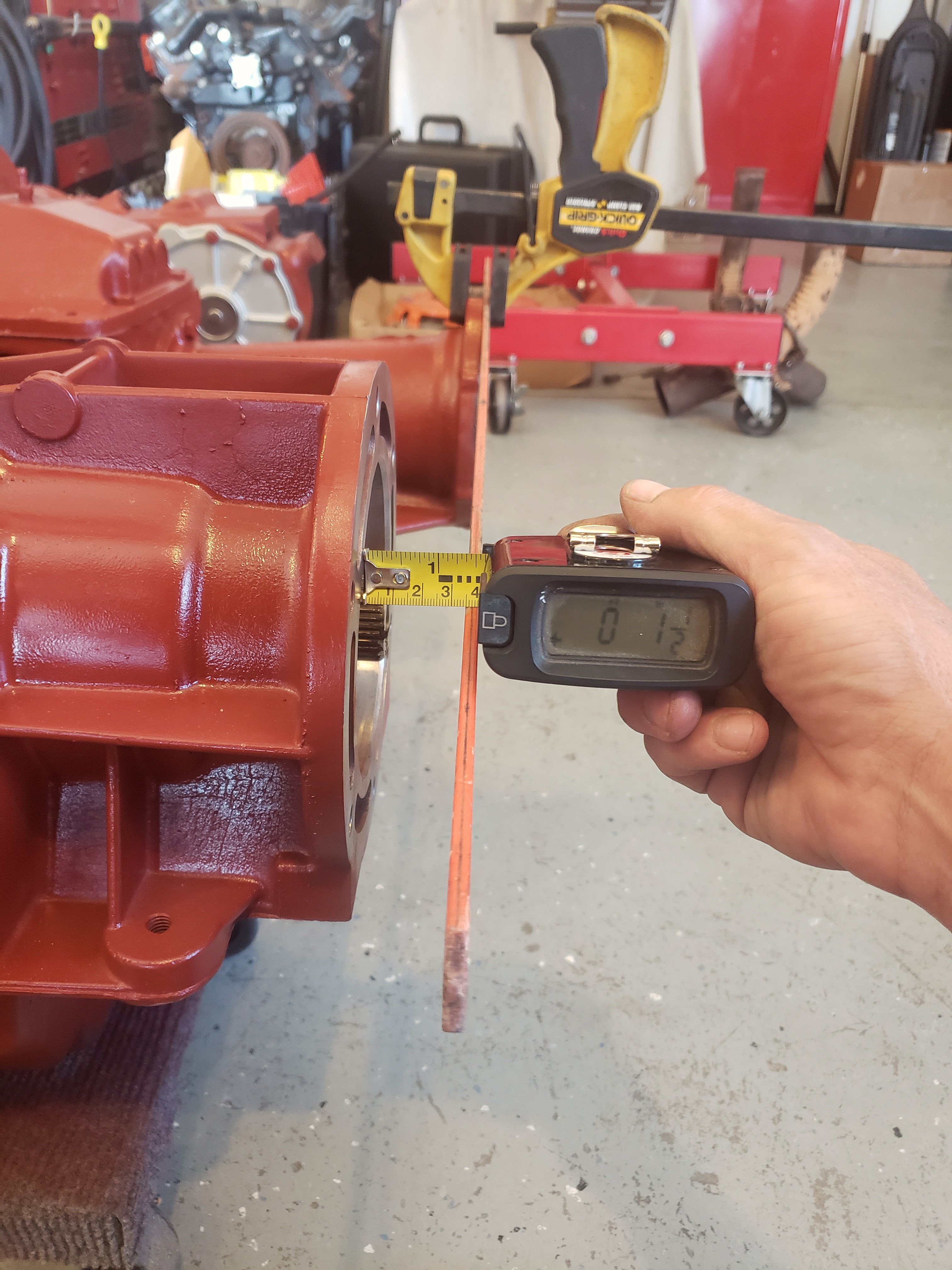

Overall length difference to 465 with a round pattern adapter to 4500.

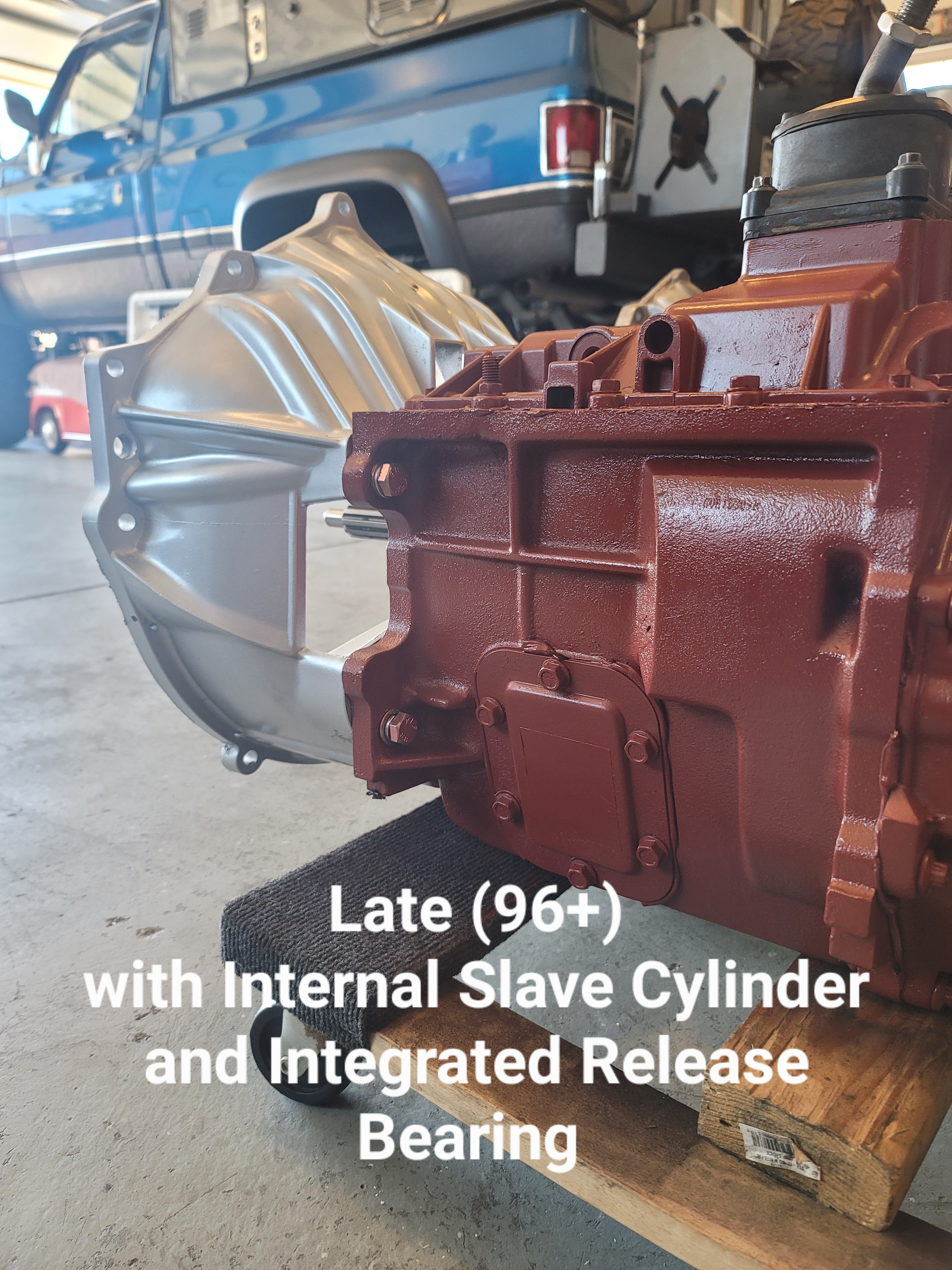

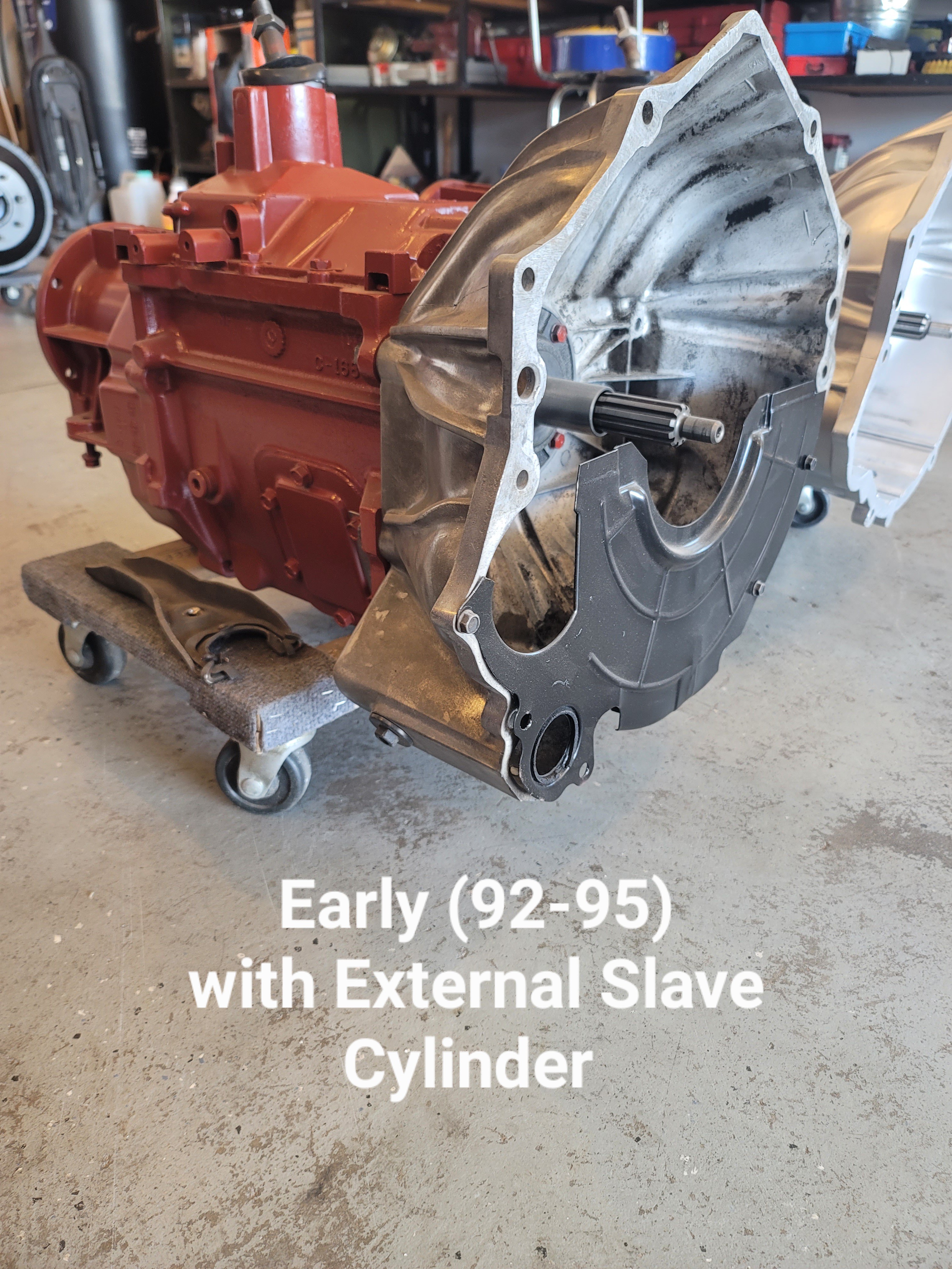

The hardest part is the swapping of the pedal set. Actually it’s not hard, just tedious. I’ll admit it was much easier with the engine out of the way.
Finding a hydraulic pedal set is probably the hardest part. Other than that it’s a pretty direct swap. The late 4500 integral space adapts to a stock square body clutch master cylinder pretty easy with an adapter on each end with a -3 AN line. Clutch feel is dang near identical to the factory hydro clutch in my s10.
Don’t waste money on an advance adapter bell housing to use a stock square body external slave. It’s not needed if you get the right bell housing. The early bell housing with the slave on the passenger side can work if you are running at least 4” of lift. But the late bell housing is perfect on a square and if you use a quality integrated slave you really don’t have to worry about it.
