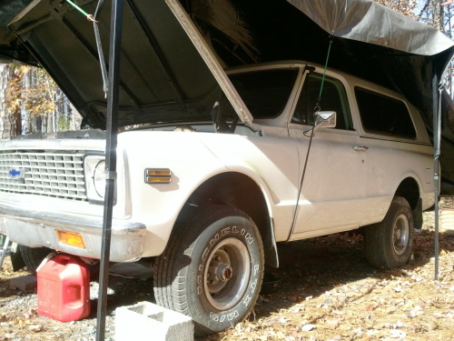

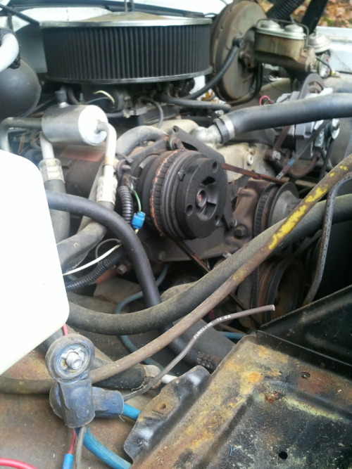

I finally started working on the Blazer after letting it sit in the yard for 3 years. Replaced the ignition switch a few years back. It was the only visible thing that fried. After many days of seemingly random testing with a multimeter, Dad and I found the 4” section of fusible link hidden under the battery box. It was crispy toast. Quite a few random wires hanging around, but if the basics work I’m not going to worry about it right now.
It's Alive!
After we replaced the 4” section of blown fusible link, I disconnected the fuel line and ran it straight from a clean 5gal tank. Held my breath and cranked it up. I was pretty shocked at how easily it started after sitting in the yard for 3 years. Sounded like hell and dumped a smoke screen on the neighbors, but it was great to hear "Grandpa Dave's truck" running again.

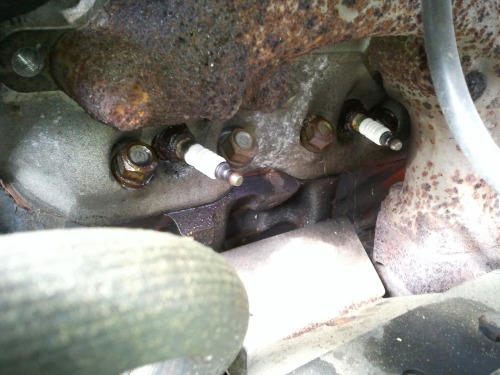

Switched out the plugs today with some E3’s. I was surprised I got the old ones out without breaking one off. I did manage to screw up a wire. Of course these are fancy racing wires (Accel 8.8mm). Was able to track down a set on ebay to avoid a $100 price tag. I really only needed one, but $40 seemed reasonable for a backup set.

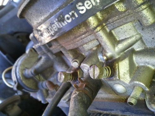

Did some work on the carburator today. At one point was joined by my Dad and two neighbors, David and Mike. It was kind of fun to stand around an engine and speculate. Always valuable bits of wisdom to be acquired from those guys.
I was hopeful that the dieseling problem was just some varnish or crud in the cylinders or carb. I started with probably way more Seafoam than I should have. For whatever reason, most of it landed in the left-side bank. I spent the next hour or so letting it run and then shutting it off as the white smoke was sticking around a bit longer than I anticipated. It also starting streaming out of the exhaust manifold which made me nervous.
I picked up 5 gallons of 93 and switch to that fuel supply. Cranked it again, but this time I just let it run and brun as I adjusted the mixture and idle speed. Eventually, it calmed the hell down. Still a bit of white smoke from the left side, but not too bad. After running it longer than I’ve done in the past few weeks, I shut it down. No dieseling, no run-on, no pre-ignition. Sweet!

Also set the mixture while I was at it using a vacuum gauge. Not sure if I got it right, but was able to hover at ~16"

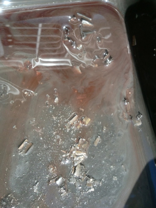

Transmission Surprise (TH350)

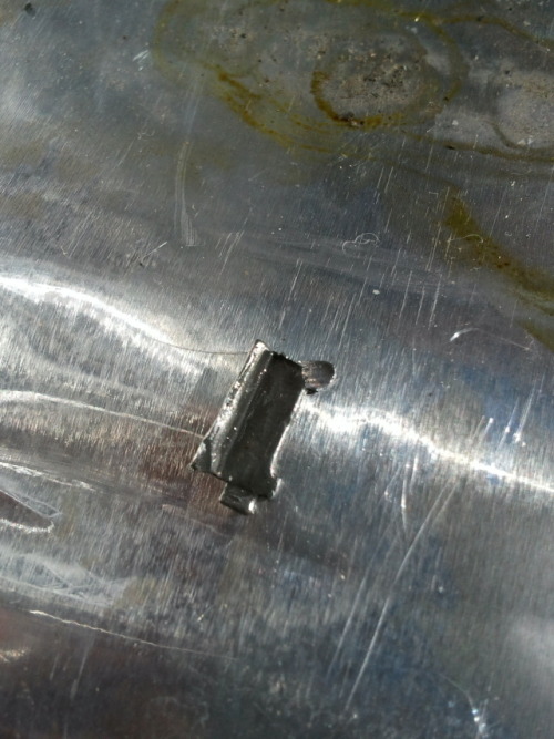

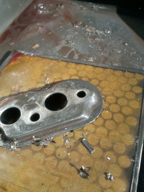

Transmission filter, gasket came in so I started in on dropping the pan and doing a refill. Found the one thing I didn't want to find in the pan - what seemed like a ton of metal chunks. The last time the truck was driven was over three years ago, but not by me. Not sure how much time is left on the this TH350, but I guess I'll add "learn how to rebuild a transmission" to my list of things to do in this lifetime.

Sweet. Thanks Martin. I was kind of hoping to hear that. I'm a little worried about cost for the transition but would totally prefer a manual.
Cost wouldnt be too bad. Just a little more time consuming. Fyi the th350 i have been told by my tranny guy is one of the the easiest transmissions to rebuild. And can do it pretty cheap. Just sayin :whistle:
FYI 465s and 205 are nearly every where and I have yet to rebuild any that I have. I think you could use beer as oil if you were in a pinch it wouldn't know the difference. Unless you are racing it in the sand I would go manual.
