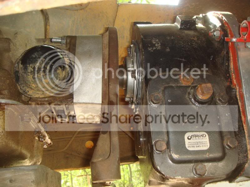

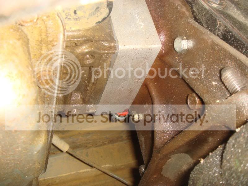

well i ran a 700 with the spacer on my doubler cause i got the spacer for like 30 bucks used...it was super simple..like when we were done that was it??here is a pic
Isn't that the 350 to 203 adapter? My question was for pics of the 700 to 208 adapter redrilled. Has anyone even done this or is it just talked about.

i ran a triple stick on mine no problems...what do you mean
Dude, from your pics that you posted earlier, you ran the th350 to np203 adapter with a spacer. So there would be no problem to run the triple stick bracket where ORD wants you to put it.
