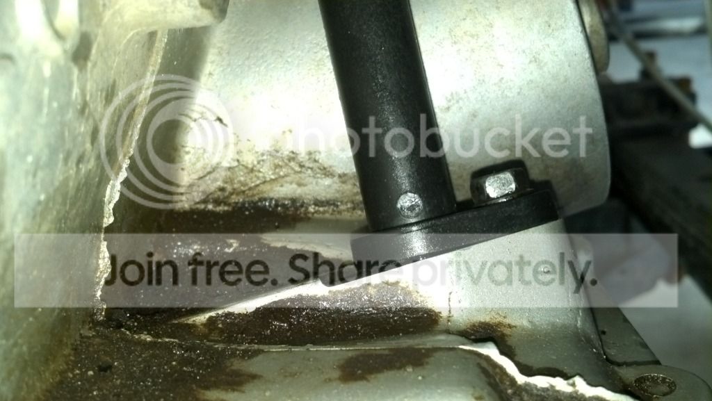

I found the source of the leak. The cable housing wont seat into the case. Help! What am i doing wrong. What can I do? Thanks!
Are you able to seat it so that it's flush and then it pops out of place? Or are you tightening the screw down while is out of position?
willie
When I installed mine, I didn't think the top of the rubber sleeve was above the lip. I thought it was flush?
Ok, i took it completely off and did it different. I put the rubber sleeve in the hole then seated the cable body. Then screwed it in. Just need to add fluid and see if it leaks. I think i got it though.
Thanks guys.
I see what your talking about. Best it could get. This should fix it. Sick of this leak.
