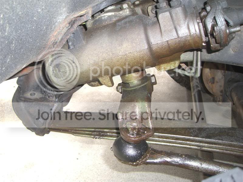

My Tuff Country 2 inch Lift Kit is on its way for my '71 Blazer. I will be running 32x11.5 Cooper Discoverer STTs on it. Can anyone advise if I need to get a dropped Pitman arm, or an adjustable drag link, etc...?
This is what I have on there now, i dont know if it is dropped or not.
Since I have the solid, non-adjustable drag link, do I need to get one of these?

wow, never knew there was a solid draglink. Kinda dumb IMO but o well.
Yes, you need an adjustable one. I would put the kit on and then see if you need a drop. I would think no, it wont be that bad. You don't want the draglink going UP from the pitman arm, so going down some is always ok.

So should i order an adjustable link with the kit, or wait until the kit is installed to see if i need one?
If it was me, I would get an adjustable one right now. One...I have never seen a solid one like that and two, regardless...An old truck like ours, the Drag link ends and Tie rod ends are one of the first things that i would replace. Especialy if i were putting on a lift.
So yeah, My opinion would be to get the adjustable one, and i wouldnt worry about a pitman arm for your 2" lift. And since the ends on your drag link will be new, it wouldnt be a bad idea to replace the tie-rod ends either.

if you don't have adjustment, our steering wheel and steering would be all fudged up after the lift.
Unless you're doing full restore, Napa can get you the same parts for the draglink, if not better.
