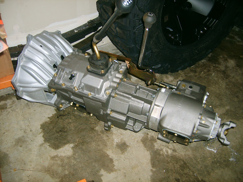

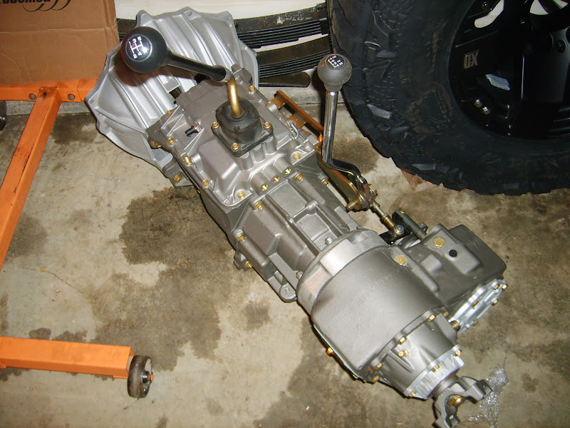

K, also had a little issue with this tranny... is this an easy fix? I bought this unit from a guy on ebay. Great guy, just wondering if he slipped on something with this combo.
Off to sell the old 3/4 ton setup!
Can you take a direct overhead photo of that linkage?
I think I'm seeing the issue, but I can't be sure.... it's not a twin-stick or anything right?
It looks like the shifter is hooked to the closer of the two shift rails, and there is a strip of metal that connects the front and rear rails together. When you shift, there is too much freeplay in the joints and the outer shift rail won't move correctly.
If that's what is happening, it might be as simple as moving the linkage from the shifter over so that it pulls from the center of that strap instead of from the one side.....
Hard to tell without a clearer photo.

In the video, your bracket bolted onto the trans is flexing around a lot and it looks like there's slop in the shifter bolt. It does take a lot of leverage to overcome the detents in the 205. If you dig though my build thread in the 69-72 forum, you can see how I fabricated an extra brace where the shifter pivots to tighten it up.

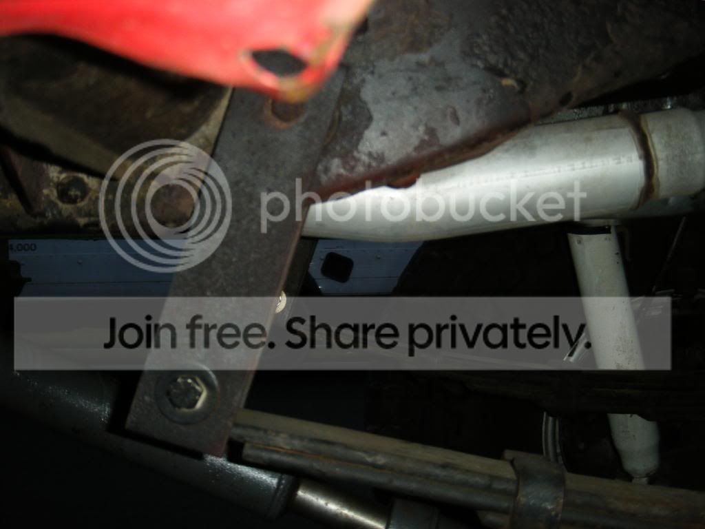

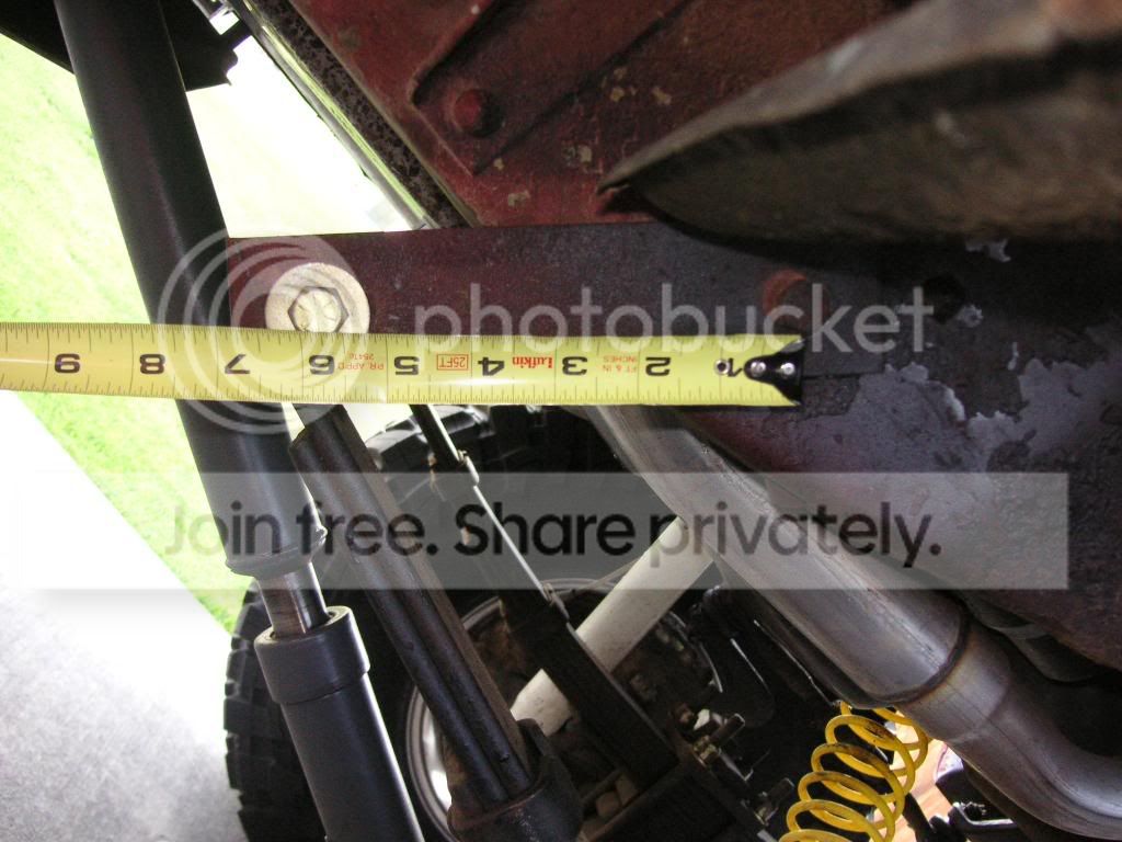

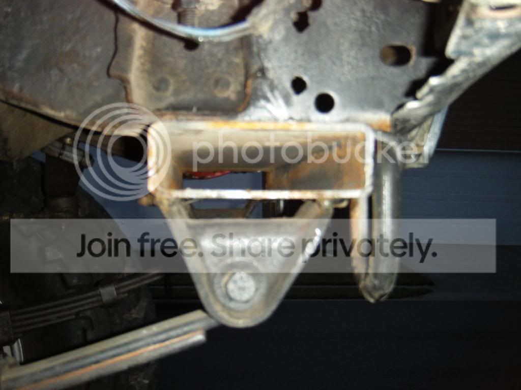

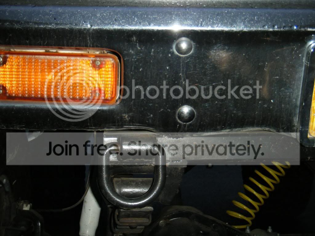

Instead of pming you back Ill just post here. I got the 8" 73+ springs and 1" zero rate to work decent with 38x14.5s and just mall crawling, The zero rate was installed stright up, not moving the axle and just adding lift.
The first time I tried to take it out it was painfully obvious that something needed to be done. I ended up Cutting the rivits out of the front spring hangers and then welding in a piece of 2"x6"x1/4"wall rectangle tubing across the frame. Then welded the factory spring hangers back in place after measuring 500 times. This let me move my axle forward and center it in the wheel well. This also let me get a better angle for the springs to work.
I took it out wheeling memorial weekend and It was night and day difference just driving it up to go wheeling. The front crossmember tightened up the front end tremendously It gave me quite a bit more lift too. I have alot nicer ride compared to before since the rear shackle can move like it is supposed to.
Antother thing that worked out great with the cross member was that I now have a place to mount my D rings for a front recovery point. It also tucks up under the bumper so that you dont really notice it as well.
If you are going to use the 73+ springs this is defanatley the way to go.
Here is a before picture of shackle angle and wheel placement and afters
Afters

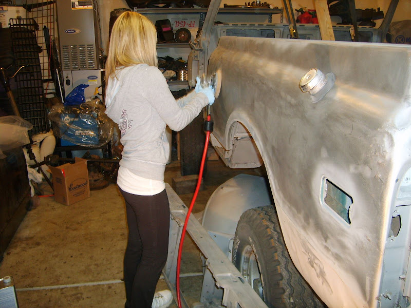

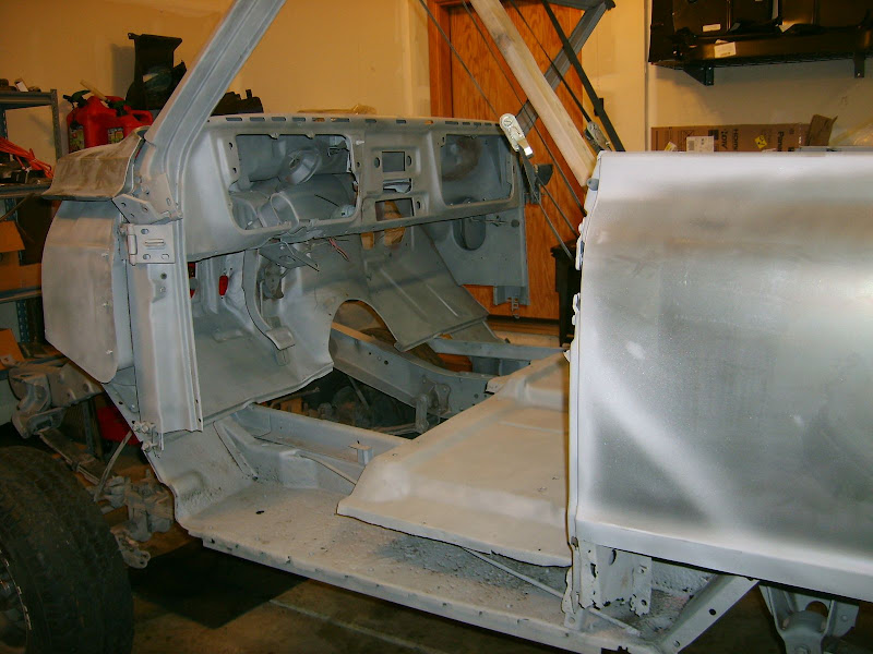

2/4/2010 Truck back from Sandblasters and PREP!

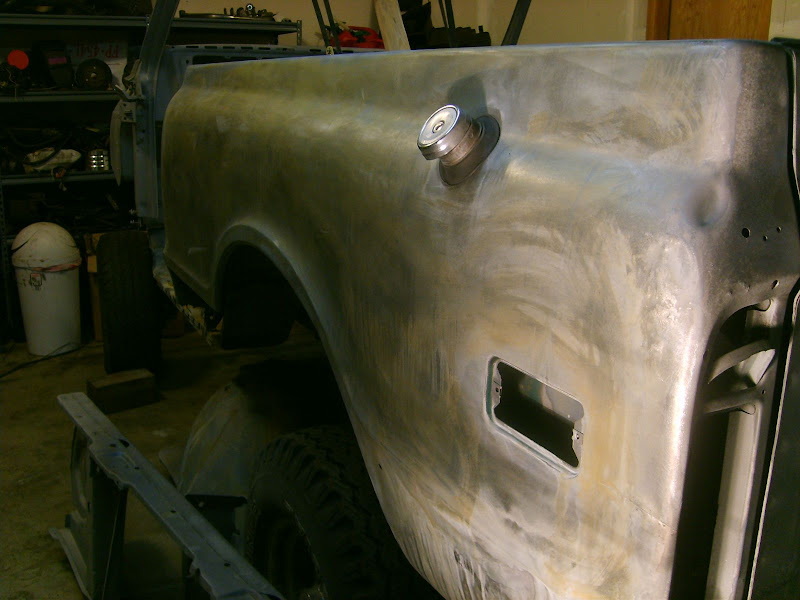

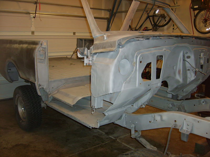

Truck came back from the Sandblasters about a couple of weeks ago. Been trying to make some progress before priming. Found some nasty spots that showed up. Did a little sanding where they media blasted for prep. Put some Zinc Chromate on the bedsides, and now on the look out for some good LH and RH front fenders. Swap meet in town next weekend should help. Also installed the ORD Shackle Flip. Set the body up on some wood so the Axle can roll out from under. Hoping to paint the frame this weekend if the weather permits!
