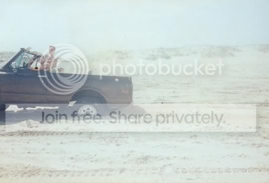

i picked up my Gen I back in March '02. it was brown, with a white top, 350/th350/np205, 32 BFG ATs, D44/12 bolt with 3.08s, and stock lift. this pic is of when i got it stuck out at South Padre Island, TX about 2 days after bringing it home.
