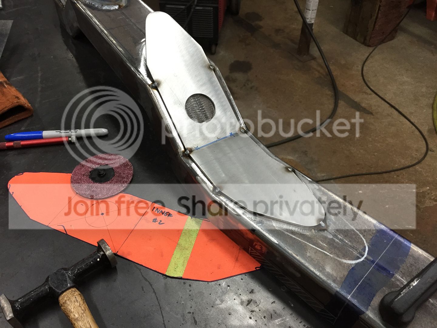

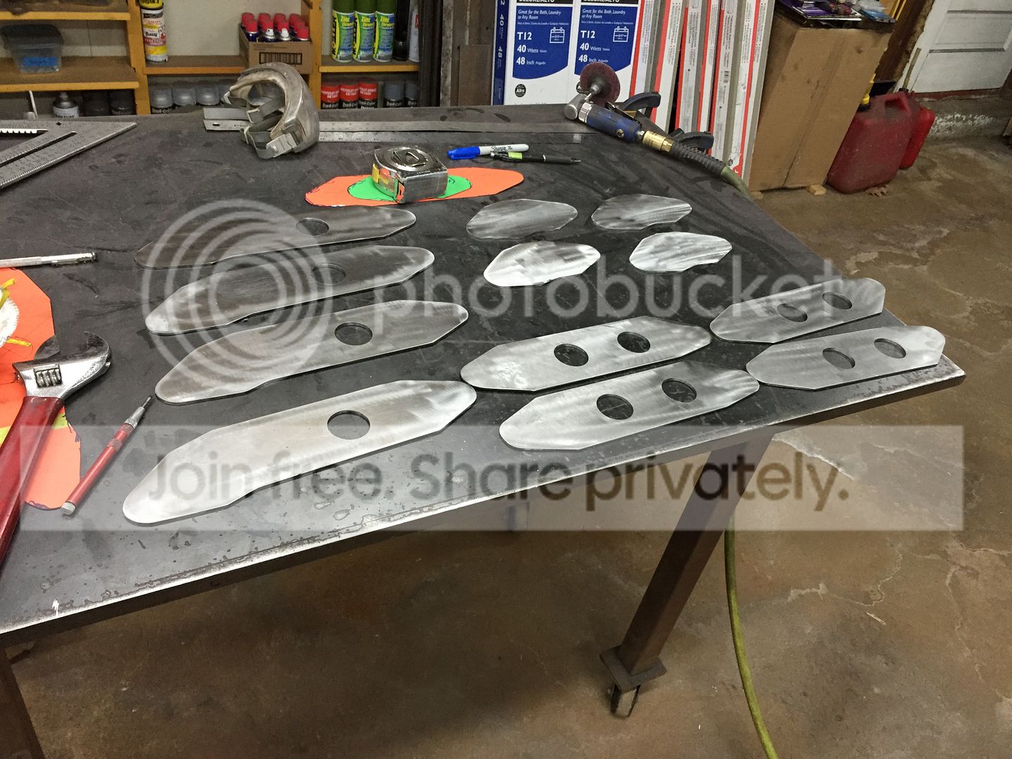

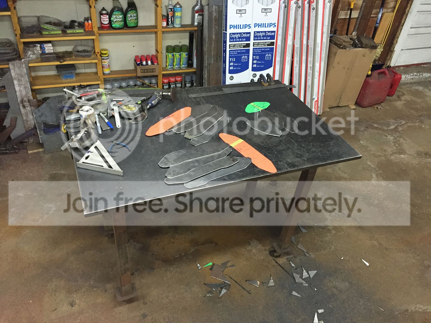

The pair of rear framerails were finish-welded but still needed a lot of platework to strengthen up all those vertical cuts where I'd manipulated the tubing for either a horizontal or vertical clearance of some kind. I did some cardboard templating (and counting) and then knocked out the 12 plates that were needed to get everything finished....
Rough cuts:
After some disc-sander and holesaw lovin'....

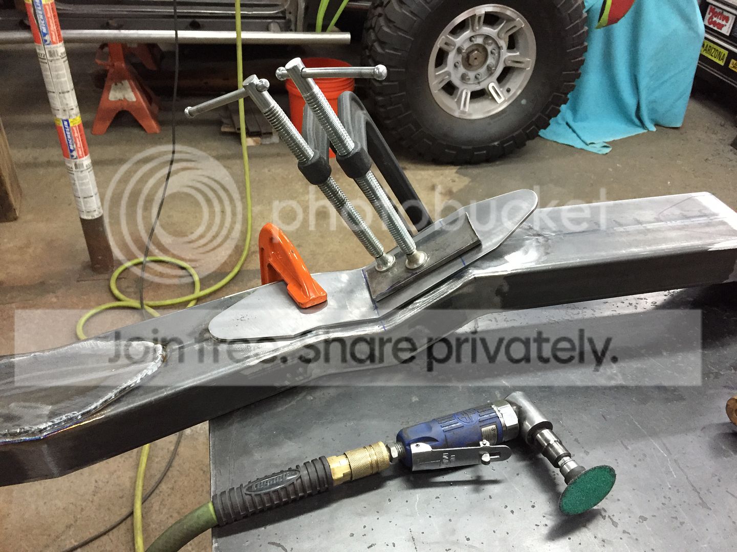

The smallest plates were easy. I just clamped and welded them to the framerail with no drama. The remainder of the plates required 2 bends each... so I decided to do the "inside bend" first. Since these plates are only 1/8" thick material I was able to just stick them in my vise and hit them with a deadblow hammer to get the first angle...
...then it seemed to work well to weld the sections leading up to the final bend so that the metal was nice and hot where I needed to bend it again. A few more hammerblows and the last section would lay down really nice and flat.

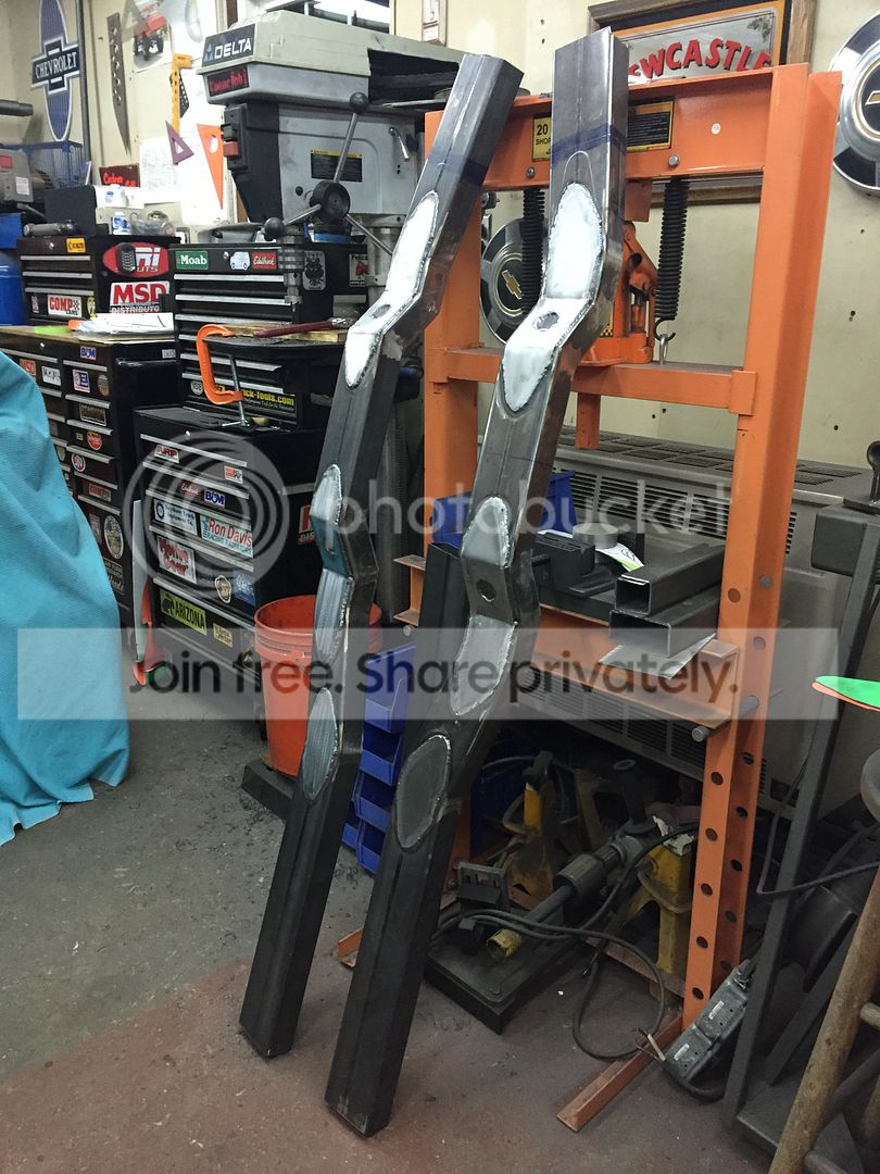

Eventually, both rails were completed (one side only)..... so when I get some more time the last of those fishplates will go onto the other side.
Of course, I still need to do a plate across the bottom and top of each rail (the 2" wide dimension) so that those seams are also plated and beefed up.... fortunately, the weather has gotten a bit warmer (mid-20s) so my chances of staying warm in the garage are substantially better than when it's only about 5 degrees outside!

Very nice Greg, I can't tell on my phone but are you stitch welding those?
Nope. Continuous welds in maybe 4" sections.
It was harder than I remembered trying to lap-weld 1/8" plate. I played around with the welder and brought the voltage down to 17.0V to prevent melting off the edges.... And brought my wire speed down to around 190ipm. They aren't the most consistent and pretty welds I've ever done (some passes are nice, others are kind of "meh") but they are all nice and strong. By the time these are all painted and in place I doubt I'll have any complaints about the finished product.
If I was better at TIG it would have been a great place to show off some nice beads....

Fully welded joints + fish plates = more than strong. I don't think there is any need at all for plating on the top and bottom
Not to mention the rigidity the cage adds
As a man of many fish plates I agree. You would literally have to tear the crossmembers apart from the two frame rails to show the weakness of not fishplating the top and bottom. So yeah, good luck with that :laugh:
Thanks birthday boy..... You just saved me 10 hours!
-G
Glad you piped in Eric, I was shaking head thinking holy crap, Greg building a tank ?
Remember the only thing that the rear frame pieces are holding is the tank and the back cage. What you did will be fine, well more then fine.
