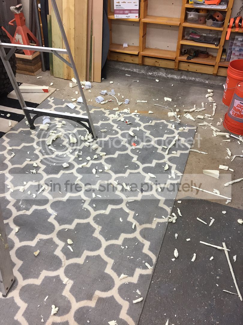

Typical crumbs of insulation and excess sprayfoam trimmings...

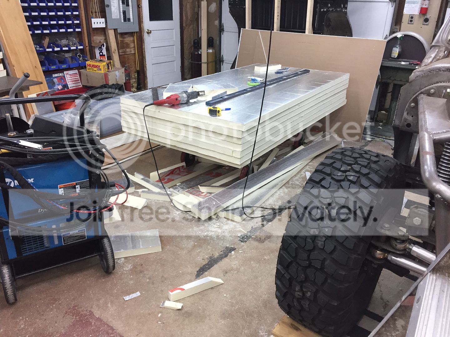

The working pile of foam sheets. I installed 12 sheets before having this pile delivered.... and this pile started off with 12 sheets also. The Saw-Z-All with a bi-metal blade does a beautiful job of cutting it to length with minimal damage to the foil.

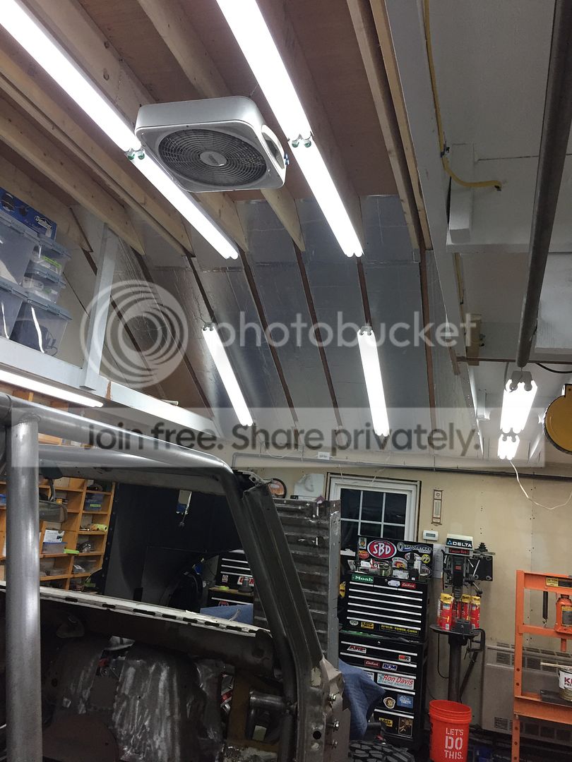

There are now 2 layers in each cavity (4" total thickness) with an R-value of 24. Not great, but I do have a fan installed up-high now to blow warm air back downward. And I'm carefully sealing all the gaps with sprayfoam and foil tape so that the "Cold" part of the attic space won't overwhelm the heated areas that I'm spending a fortune on LP to keep at 60F. :)

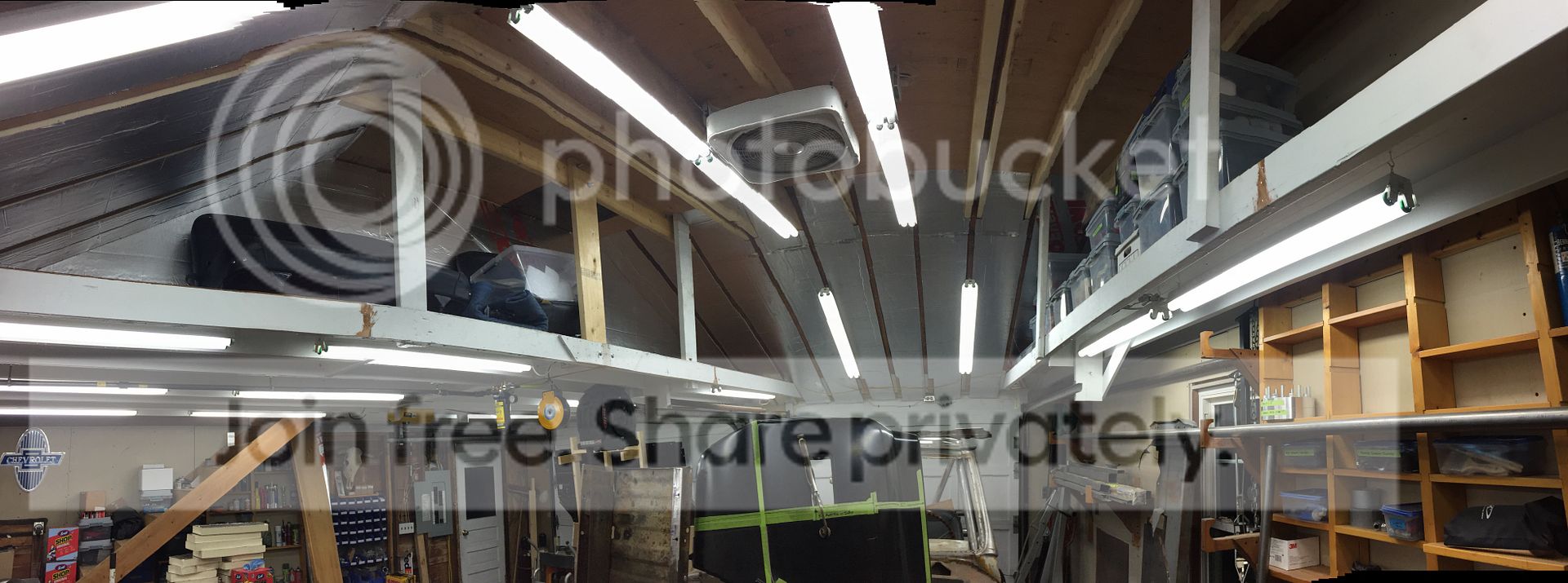

This panorama taken from my toolbox area (along the back wall of the shop) shows the upper storage shelves that were created on both sides, as the rest of the "cold attic" was sealed off. This is a decent amount of space for seats, and other stuff I need access to occasionally.... the cold area of the attic can still be used for long-term items like large sheetmetal sections, etc and is still accessible enough that it shouldn't be a problem when I need to find them again.
