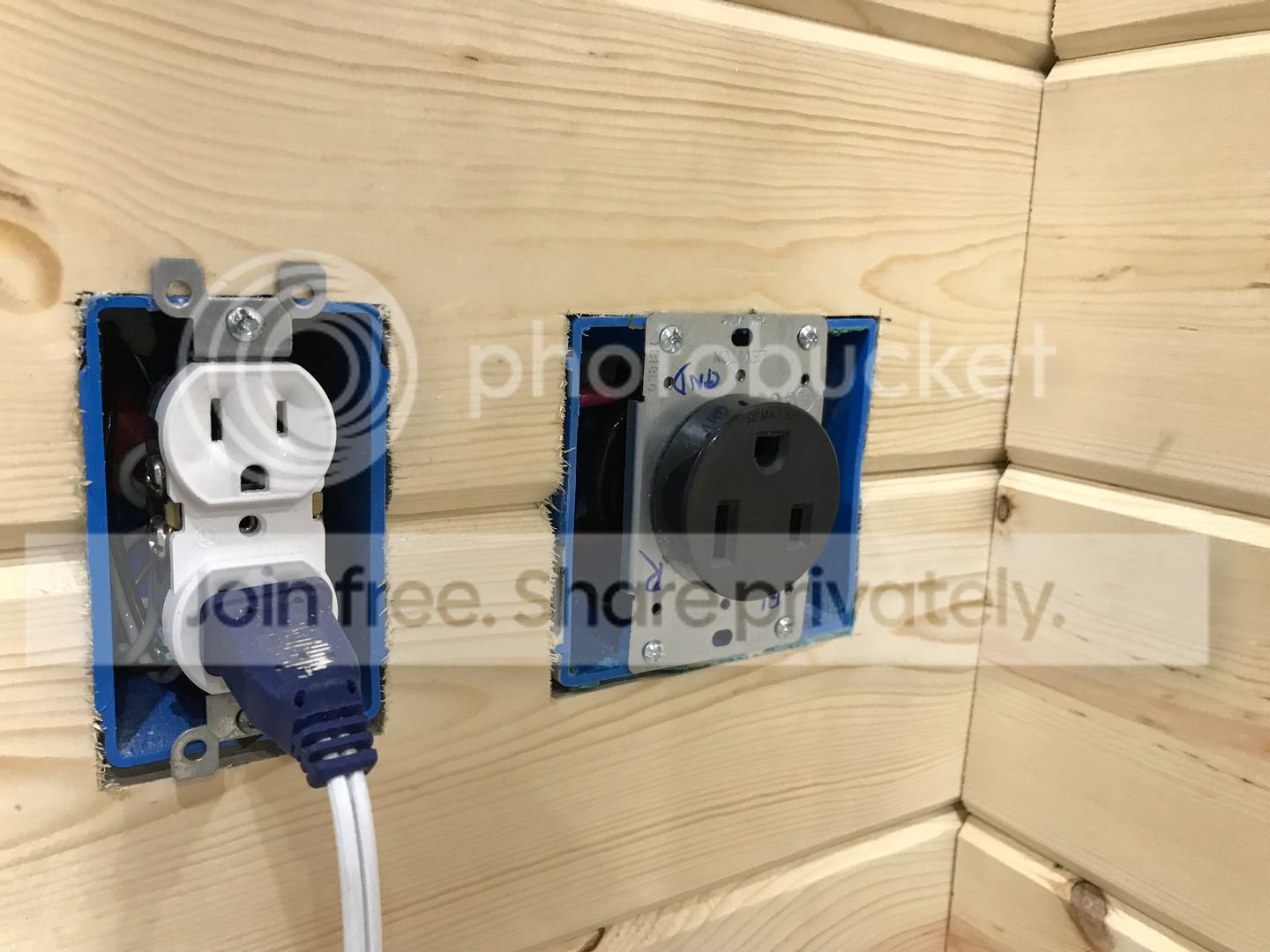

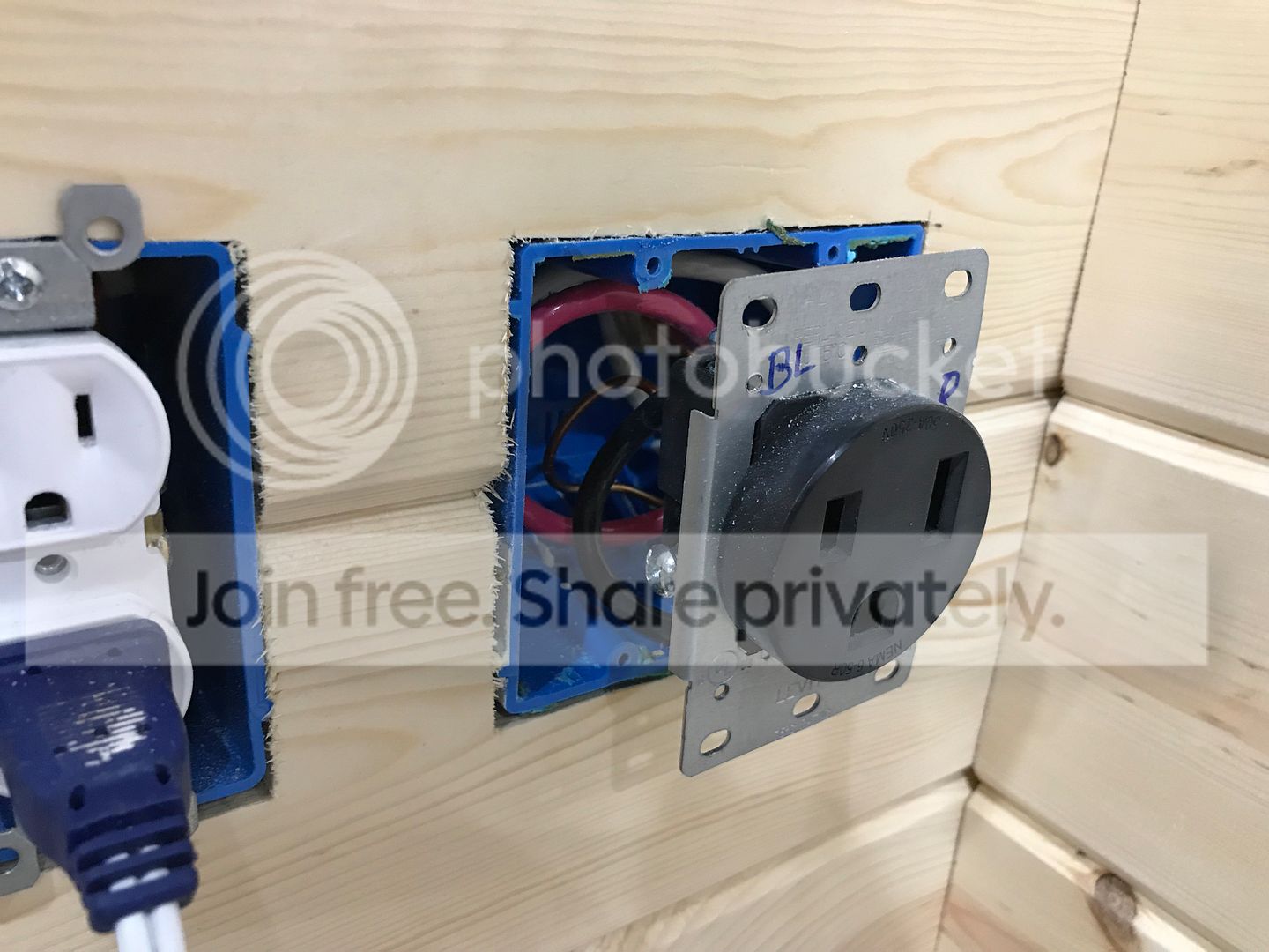

Here's a neat trick that someone might want to use later on. When installing new electrical boxes, you can get a really neat look and keep the outlets from wiggling and collapsing into the wall when plugging items in by mounting them slightly too far OUT into the room. Then when the finished walls are installed, use a flapwheel to carefully "dress down" the edges to make them flush with the surrounding walls! Perfect alignment, outlets end up strongly mounted and the cover plates fit perfectly with no gaps around the edges. OCD People Unite!!! :haha:
.... and when I'm wrong, I'll say I'm wrong. It's been so long since I've working on an actual truck project that I misremembered which way the 220V plugs work. Turns out the ground IS on the top...just like people were telling me. I could have sworn it was the opposite way... but sure enough, all of my existing 220V devices are "ground side up". A quick 180* rotation and all is good again!

I'm also suprised that those don't look like hospital grade outlets :thinking:. I would have assumed that an 'Overkill so it lasts' mentality would have used those.... That's ALL I'll put in my place. Because that's my normal mentality too lol.
I just buy the adjustable gang boxes and once the sheetrock (or in you case shiplap) is up then adjust the box accordingly then install the receptacle and plate.
I like using retrofit boxes (with those little flip out “wings” even on new construction for a similar reason... always perfect and flush. Seemed like a hassle for the T&G
-G
I had such a hard time getting the holes in the right place for my outlets. Now I'm gonna have to cut openings out of thin metal or wood and then use spacers in mine to get a nice solid plug
HD sells plastic rectangle spacers that work well for overly deep mounted boxes. I had a few outlets mounted to twisted 2x4s which made the outlet box crooked too..... flapwheel love on the spacer allowed a perfect asymmetrical fitnent and the receptacles fit flush, plumb and perfect!!

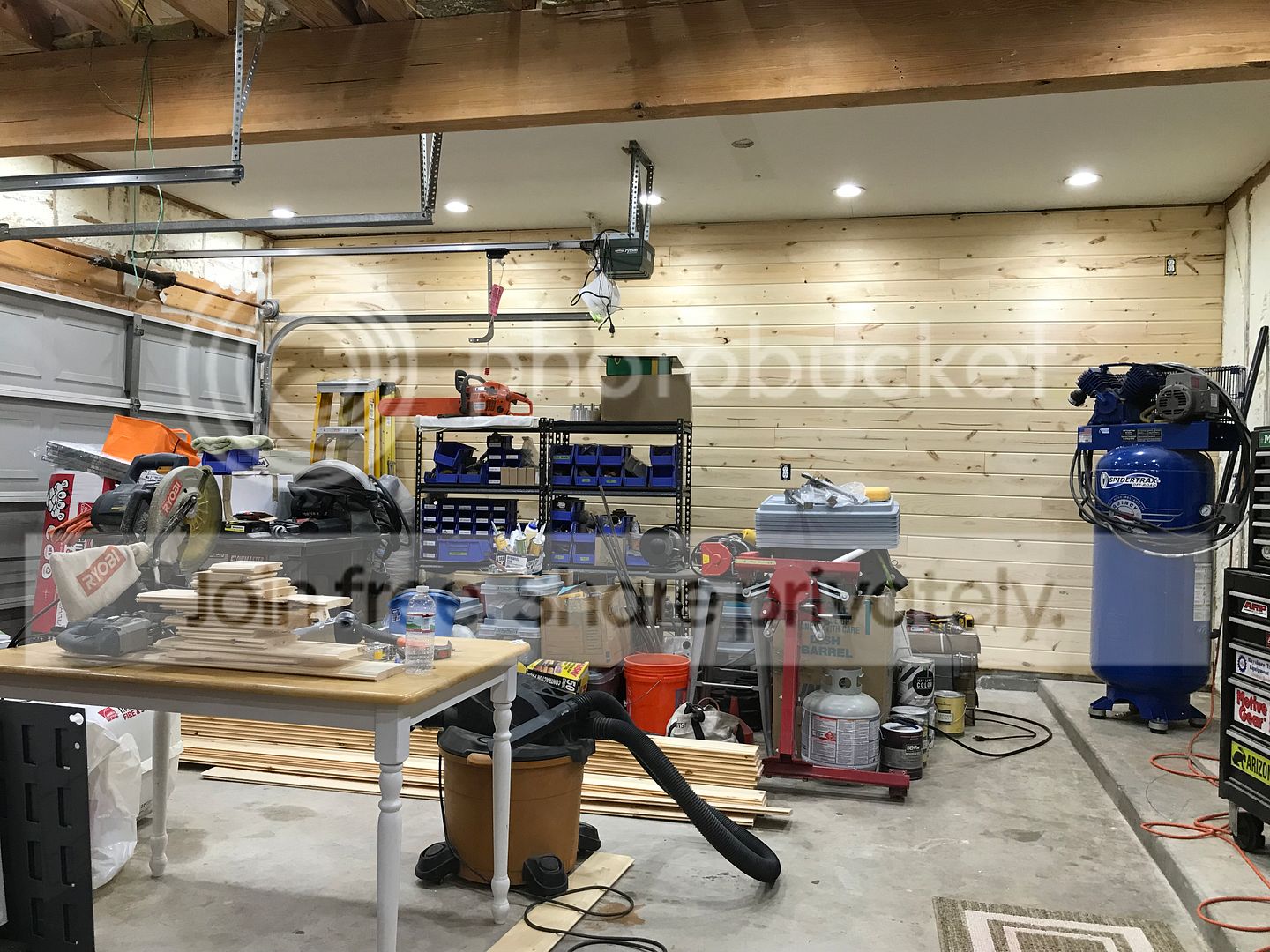

A/C install is critical now. 100 degrees every day here in Austin for the next 2 months...
I've still got a huge pile of equipment / parts under a blue tarp in the side yard. It needs to come safely back into the garage
That requires the overhead storage area to be completed.... I'm probably 75% complete with that.
Overhead ceiling is still not cut-out to create the vaulted ceiling.
Finish the 220V wiring in the breaker panels
More 110V outlets along the back wall where my toolboxes and workbenches will need to go.
