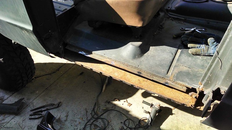

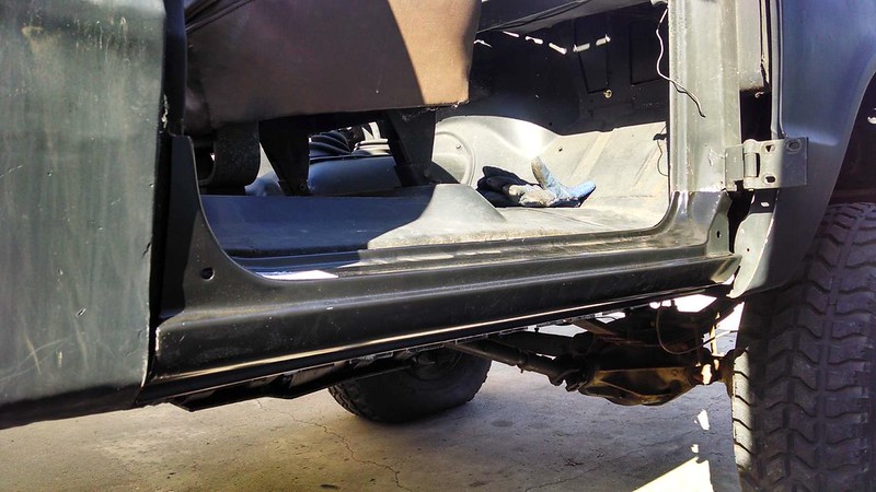

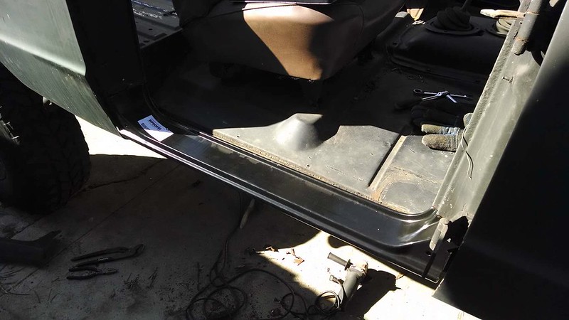

Here's what I started with.

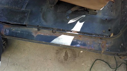

Drivers side:

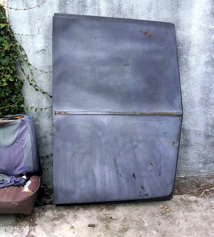

And in order to go further... off with the doors!
(heard these were a pain to get off, but I took them off myself no problem..?)

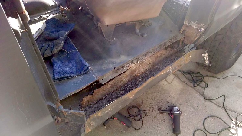

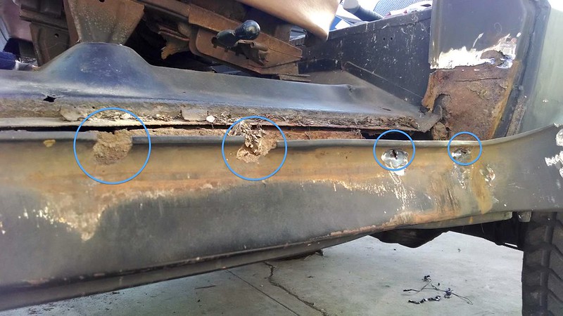

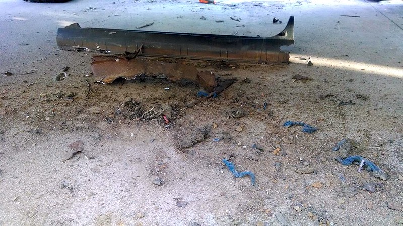

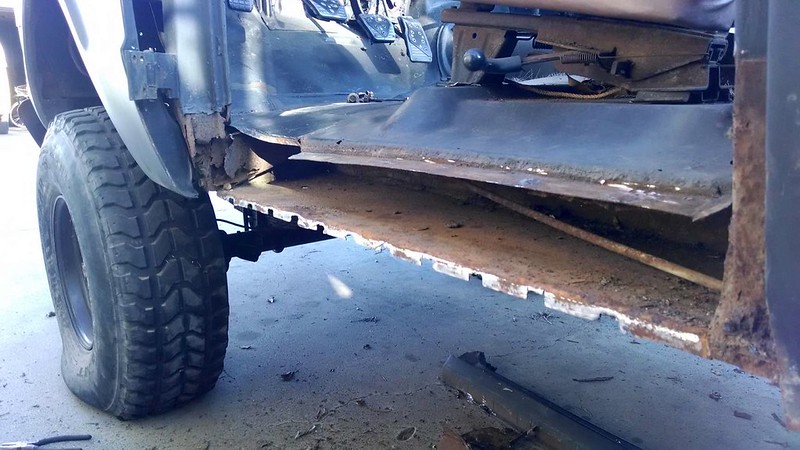

Removal of the rust begins! Not too tough to take off the rockers, since they were barely welded on to begin with..

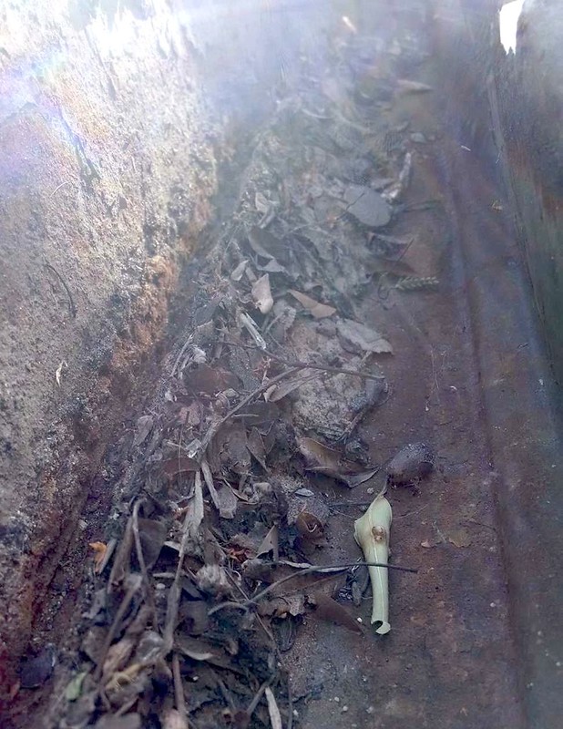

Look at all the crap inside there! :)

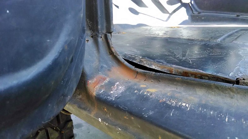

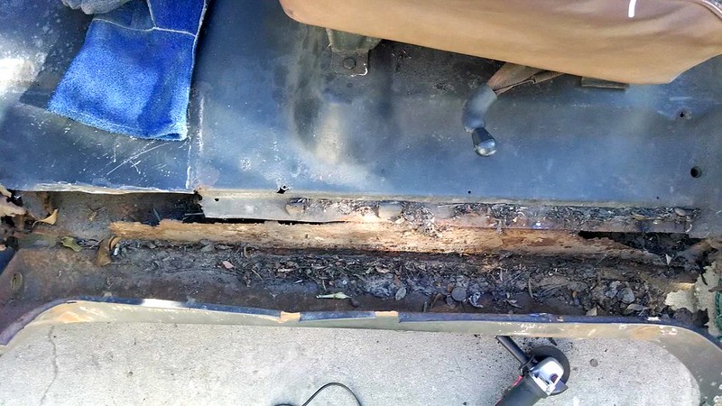

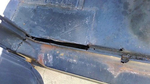

Only 4 spot welds along the top of the rocker (and 2 of those were totally rusted out):

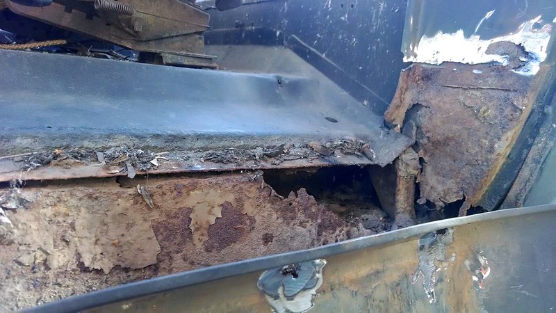

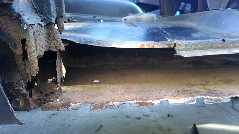

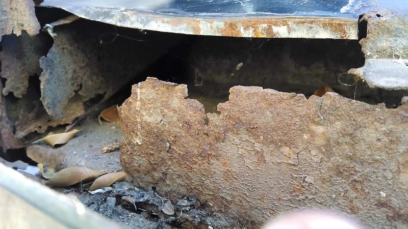

Discovering some more rust behind the rocker.. not much of an inner rocker here:
rocker off, inner rocker (remnants) off, and a nice pile of crap from inside:

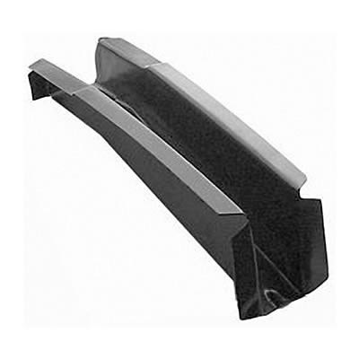

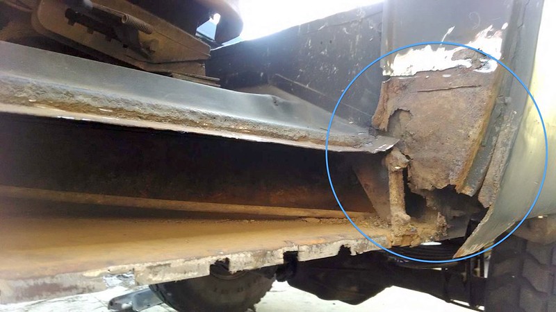

With the rockers off, I'm finally able to assess the situation. I could see the rusted sections that needed new metal, but the tricky part was I wasn't sure which patch panels were sold or what they were called. After hours of scouring replacement metal distributor websites and restoration threads, I was able to piece together what I needed.
Here's the driver side door jamb. It sits at the bottom rear of the door opening. It gets covered by the outer rocker.
Summit patch panel

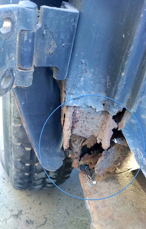

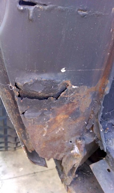

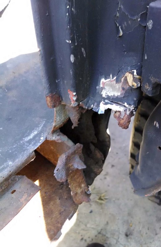

Here's the driver side door pillar. It sits at the bottom front of the door opening. It bolts to the floor support (also rusted out) as well as the fender. Without this, the fender will shake all and make wonderful rattling noises. Ask me how I know :)
Summit patch panel

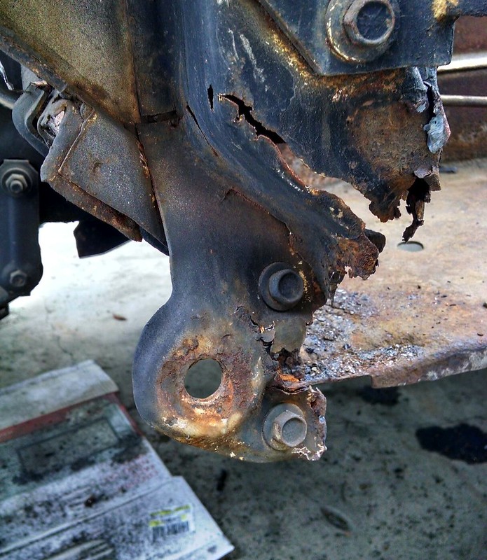

A better shot of the door pillar (with fender off):
Guess I didn't get a good shot of the floor support. Its a metal channel that sits inside the rocker box, towards the front, and supports the floor. On left side of this photo is a straight on view of it (driver side):

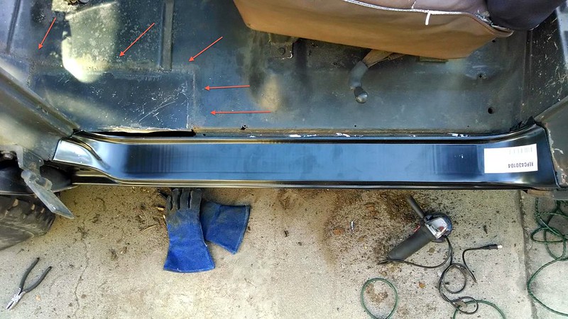

Note the lack of flanges that connect it to the other pieces. It's supposed to look like this:

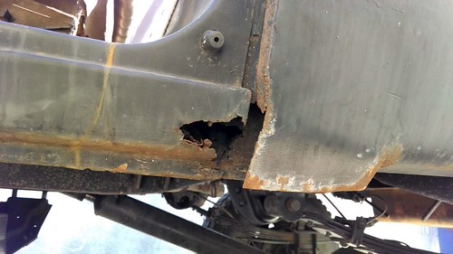

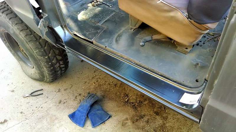

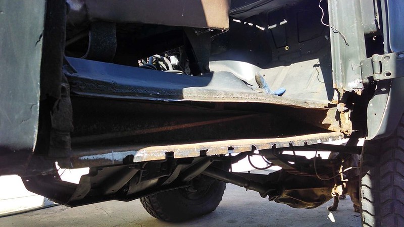

Passenger side had a similar situation. Here's the rocker off (there was NO inner rocker!):
Passenger side door jamb, bottom rear of door opening:
Summit patch panel

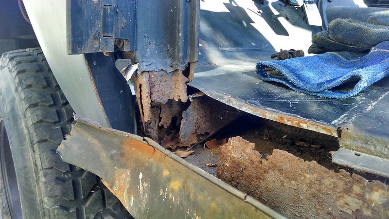

Passenger side door pillar, bottom front of door opening. This one was actually worse than the driver side, it was totally missing. LOTS of play in the passenger front fender.
Welcome to hell....
You should probably order up some front floor sections while you're at it. There's no way you'll get those front cab supports installed with the floor in place (unless you completely remove the torsion boxes from underneath)
There is a structural section available for that b-pillar area. I've got pics in my thread that show it. The part you ordered is the cosmetic top piece only.
Finally. If you ever want your doors to fit again you'd better get those openings braced up SOON!!! There's almost nothing left to keep your truck from folding in half in the door area.... There are plenty of builds here that show detailed images of those repairs.... Read as much as you can until it starts to make sense.

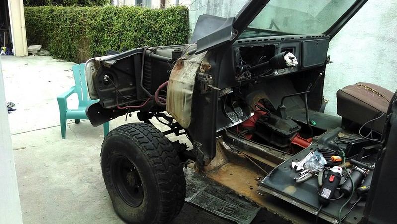

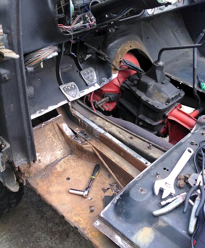

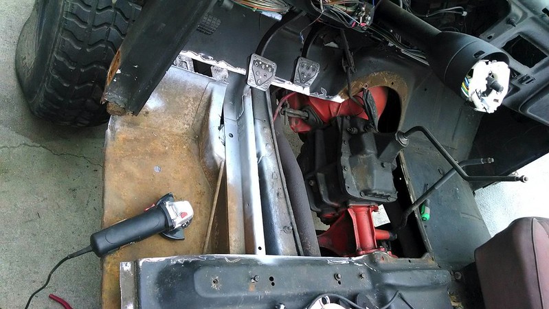

Alright, I'm going to get some crap for this next part. I KNOW you're supposed to use as little replacement sheet metal as possible, but I couldn't resist replacing the whole drivers side floor section.
About 1/3 of this section was crap thanks to PO floor patch. The rest was mostly solid but had some pitting. My big issue is that PO hacked up the fold joint where the floor and firewall meet, and I didn't think I could fab up a seamless fix. My solution: remove the seam altogether, replace the whole floor section.
The sheet metal cuts were easy, but grinding out the factory spot welds was a time consuming pain in the ass. When I started, I didn't have a spot weld drill bit so I used a small and large bit. This worked, but took away a bit too much material (note the holes in the longitudinal floor support).
I didn't get a shot with the floor support still in, but that thing was the worst part. Glad it's gone now, will not be repeating that on the passenger side.

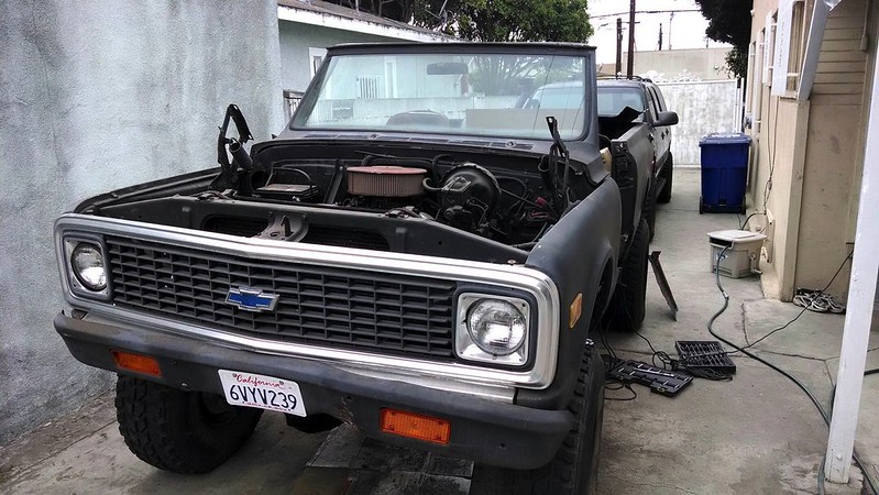

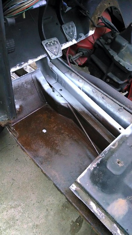

Needed access to the front floor pillar, which requires removing the fender. Not sure if removing the hood was necessary, but I took that off too. BYE HOOD!
The funny thing? ALL OF THIS IS HAPPENING BECAUSE I WANTED TO FIX MY TAILLIGHTS. :whistle:

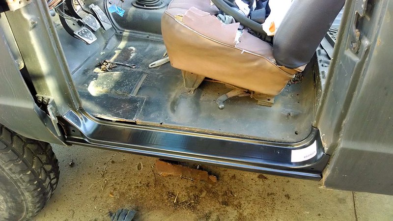

Some good news is that the rocker boxes are rock solid. Only minor surface rust. YAY.
Getting ready to put the new floor support in. Primed all exposed steel, applied rust converter / inhibitor to surface rust. Too cheap for POR-15, and there's a limited selection of chemicals for sale here in CA. This stuff should be better than nothing at all.
