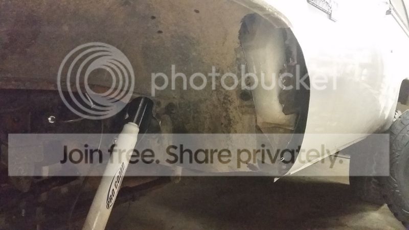

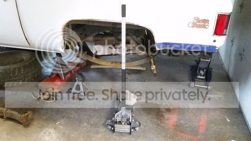

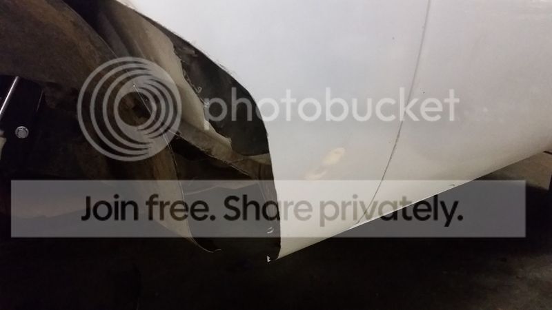

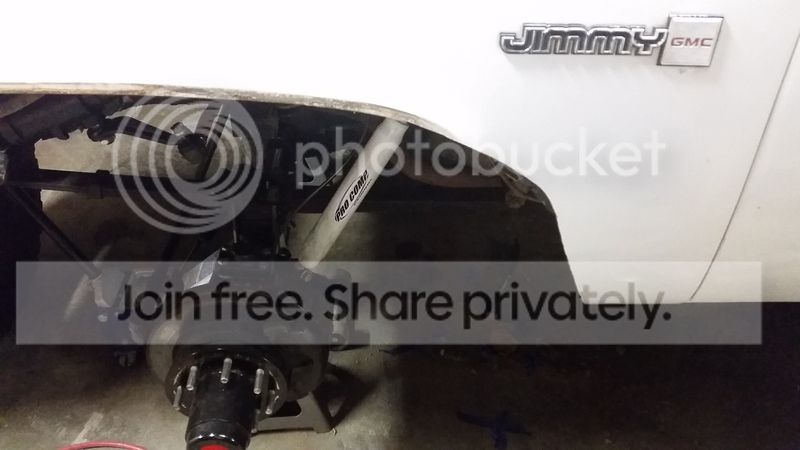

I worked on it a bit. Its still not perfect but im not done with it yet. Next time i trim the fenders ill just have them water jetted lol.
Still needs to be rounded more at the top but i taper it at the bottom.
I also cut the inner fender some. not sure where to go with it at the moment. Ill either hammer it back and attach it or cut off the lower portion seen here...

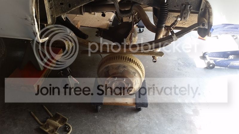

I wish i could say well. As usual im fighting 30 year old hardware. I have the old rear end out and im glad i took it out, I didnt need a socket to get the u bolt nuts off...they were finger tight. :doah:
I then rounded over the fitting on the brake line on the frame which didnt allow me to get it out so i literally had to sawzall the the hard line. So i bent up new hard line which i really need to do over becuase its a bit long.

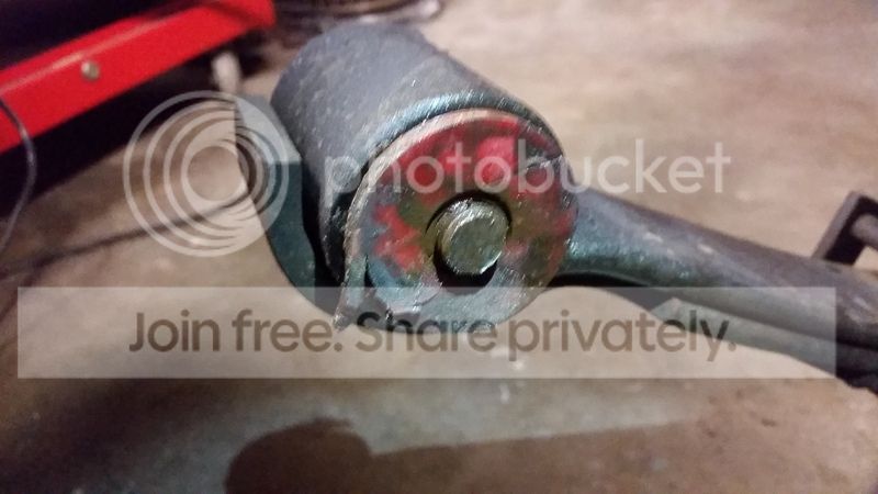

After i got through that mess i started working on getting the leaf springs out which unbolted easy from the shackle hanger. Then i started unbolting the pivot bolts for the leaf springs and conveniently there stuck in the leaf spring. Ive completely soaked everything in aerokroil with no success. Ive beat, pried and tried every trick in the book. So i took the sawzall to the bolt in between the bushing and the mount. Got one side cut off and the other side wont cut because the metal bushing is spinning around the bolt and i cant get it away from it. So at this point i have 4 hours invested in cutting one leaf spring off.

Pivot bolt is the front bolt on the rear spring right? Sawzaw should fit in there no? If not cut the bolt head off and get a punch with a BFH. IIRC mine were a bitch too.
Those setbacks bring the suck.
Yeah correct. The metal bushing on that side is acting like a roller so it wont cut and i cant move it. Im cutting the head off for sure. What an adventure. I live for the day when all the hardware is new on this truck. Its easy to bolt stuff up but this crap takes forever. I have to drop the tank for the shackle flip...that should be interesting but luckily i only have a 1/4 tank.

cut it and beat it with a punch and BFH. That should do the trick.

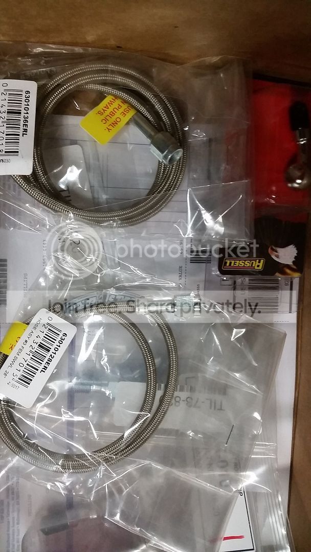

Got all my brake parts in early this week. Earl makes some pretty nice lines!

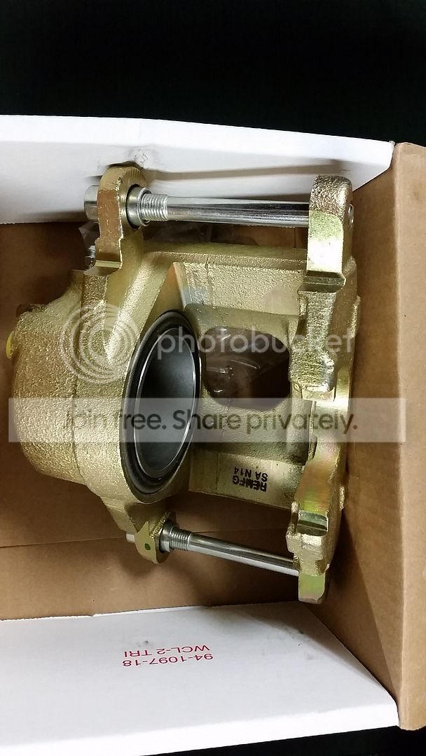

K20 front calipers. They were loaded except pads for $35 a piece.

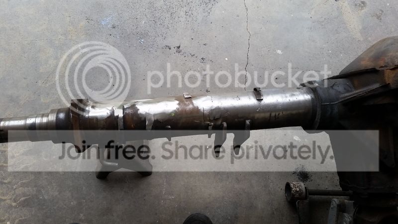

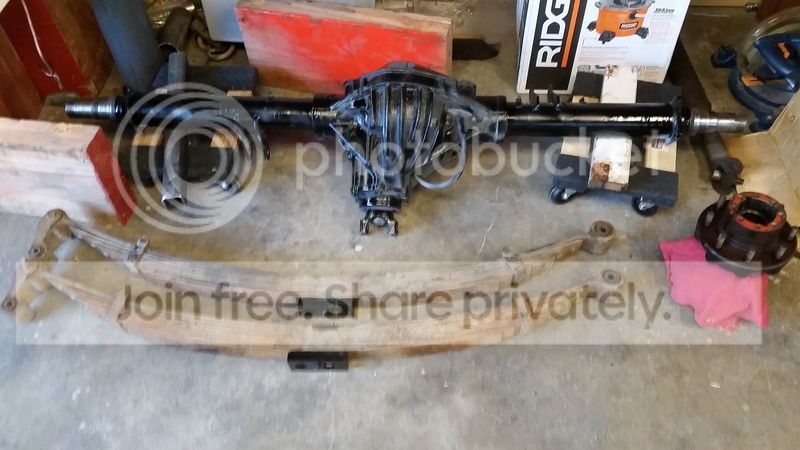

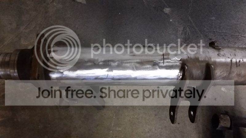

I cut off all the old stuff off my 14 bolt...spring perches and what not.

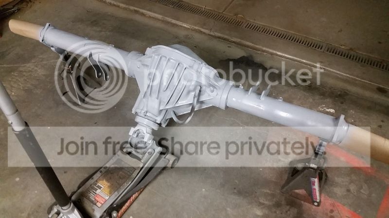

Primered it up

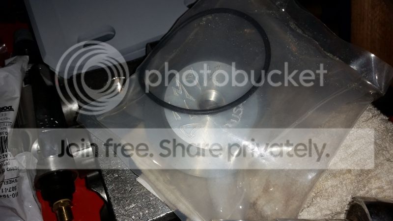

Slapped paint on it but after it dried you can see theres still a layer of road grime on it. The axle will come back out in few weeks so i said to hell with it. The 56's need to be cleaned up as well but thats happening soon. I used the DIY4x zero rates as opposed to Ez inches and i was a little upset they didnt come with center pins or bolts. Just means i had to source it somewhere else instead of being included like ORD's :confused:
After sawzalling the hard brake line off from rounding over the fittings...i was on my way. I didnt even need a socket to get the u bolt nuts off. They were finger tight at most so id say it was a good time to swap all this old stuff out.

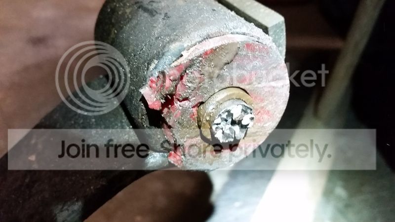

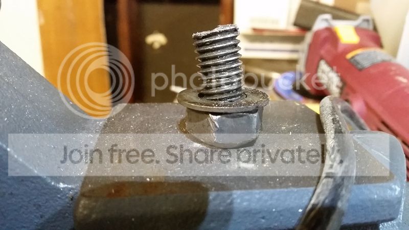

Next i tried to get the leaf spring pivot bolts out which ive mentioned was pure hell so lets just show the damage instead...

I'm pretty sure I received center pins with Kert's blocks :dunno:
WFO has them and they're notched which is nice. I actually just ordered 4 yesterday because the threads on mine are fubbard after removing the shims.
http://www.wfoconcepts.com/cr/Center-Pins/3225/4385
Only way to get a good looking paint job on the axle is to strip all that $hit off. Pressure washer, wire wheel, pressure wash again.
Aren't loaded calipers supposed to include the pads?
Also why paint the axle before welding on the new perches?
It's weird because some sites say loaded means with pads and other say unloaded doesn't come with the springs and bolts. I suppose there half loaded lol.
I have to put the axle under the truck on its own weight so I just figured I'd blow the paint off with a wheel when I'm ready to bolt it in. I could have waited to paint but didn't see the benefit.

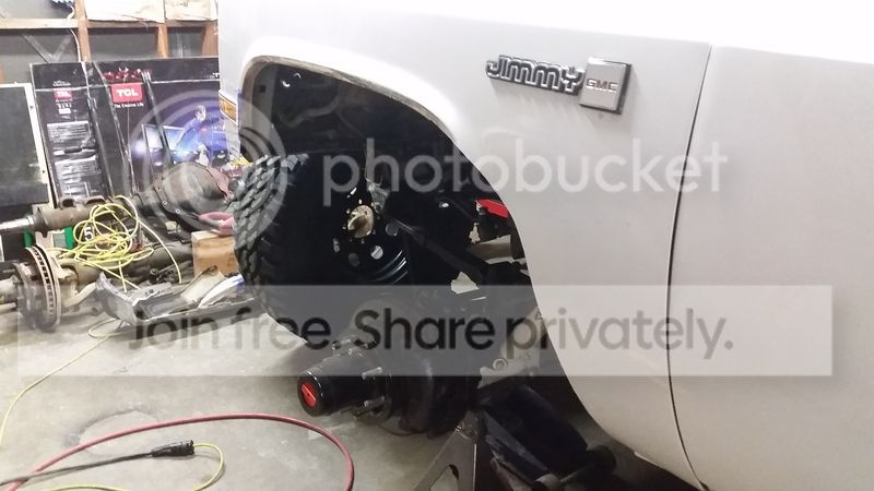

On a side note i got the other leaf spring off! Now i need to read up on how to lower the gas tank so i can get the shackle flip bolted on.
Scrap lumber and a jack. I love my ATV jack for this
http://www.harborfreight.com/1500-lb-capacity-atvmotorcycle-lift-61632.html
as it has a flat lifting surface, as opposed to trying to balance the tank on a bottle jack.

Oh yeah thats a pretty good way of doing that! luckily my tank is near empty so i wont have to fight too much slosh force. I guess its just a few bolts and it comes down?
Im not sure what to do about the sender with the hard lines on it though. Dont want to break anything.
