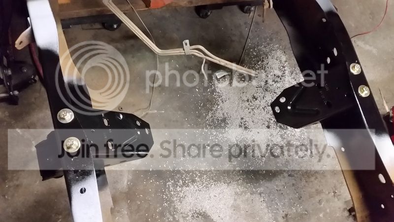

Got the holes opened up for the front upper shackle deals. Waiting on paint to dry to bolt them in.

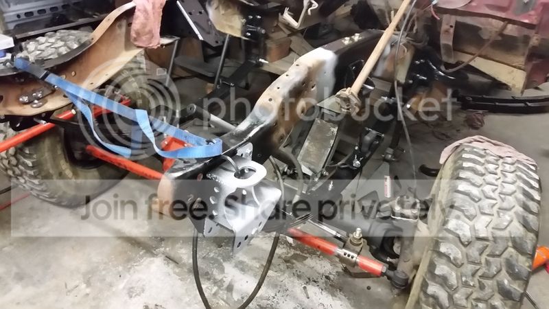

Pulled the 56s off the 2nd gen 14 bolt and got them on the frame, painted em as well.

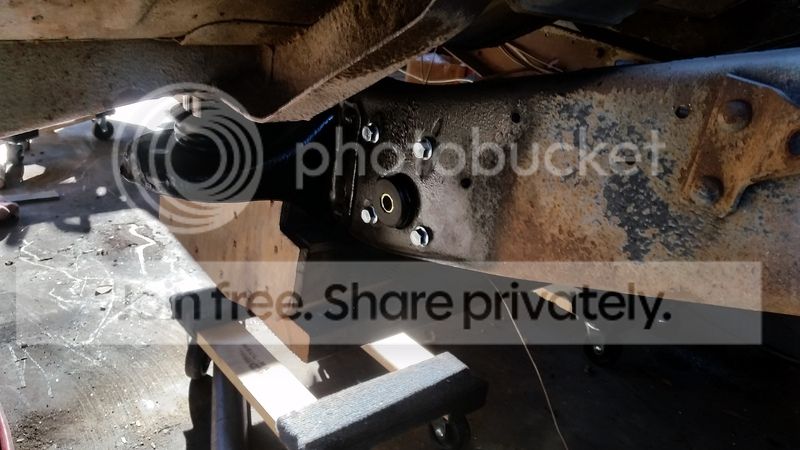

I need to figure out the dimension between the centers of the poly motor mounts since I dont have any crossmembers in the front yet. Last thing I want to deal with is putting the motor in and finding out I locked the frame in to narrow or wide for the mounts.

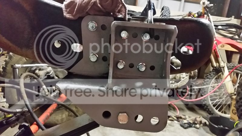

I'm beat. Worked my ass off on this truck today. Rear end went smooth but the front put up a fight. For the life of me I can't understand why passenger spring plate doesn't line up with the center pin of the leaf spring. I know factually I'm on the 1 inch forward setting...same setting as before, which obviously worked. It's off by a mile. Nothing I can't fix tomorrow but damn! The springs are far more arched then the lest set were so I could see the center pin pitching but this is off by 3/8" or so.

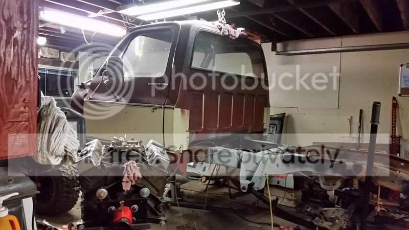

The truck is insanely tall. I am at full droop in the front though so maybe I'm judging too quickly without the drive train and the trucks weight on the front. I need to also get rid of the wood skids...they're preventing the shackles from going back, again making the truck stupid tall. I'm 6'3 and the bottom of the window is eye level...kinda cool but not for what I'm doing lol!

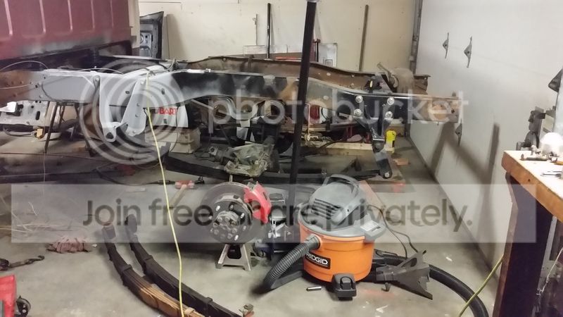

The rear looks very close shackle angle wise but it has the trucks weight on it. However there's no bed so it's real light back there.
I can't get far away enough to take a decent picture.
Hopefully I have this on right?
Rear endarrino
Front is gonna have 1000 lbs + on it. That will settle those springs quick. I wouldn't worry
Ok cool! I appreciate all your help!
