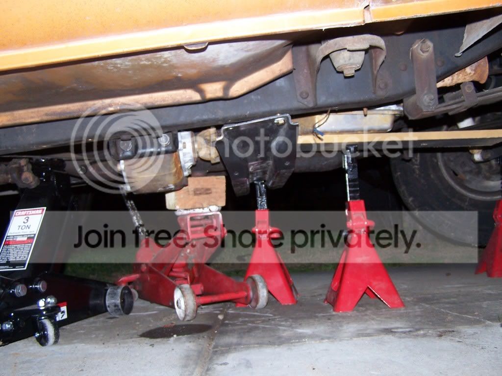

Right under the gear reduction housing, like I have my jack in the picture. Put the chaincase over the jack instead of the tranny, and you'll be good. Then just put a strap or two around the tranny for good measure :thumbup:

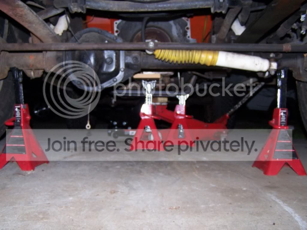

I come bearing good news, The tranny/tc are in place and bolted up to the 2 bolts on the passenger side of the t-case. Heres some pics of how it sits now.
Front
Passenger
Now onto the problems. I put one bolt through the frame and cross member that the adapter bolts up to and went to do the other side and the crossmember is 1/2 inch towards the driver side. Is it possible the 2 crossmembers are slightly different sizes and i should use the one with the heat shield for this?
Nope, your frame rails are spread in. My 74 is spread apart and it is a pain to put the crossmember in. I have to put bolts in one side, stick a pry bar (or a alignment punch) though the holes on the other side. Pry the holes close, stick a bolt in the open hole after I align the hole between the frame and crossmember. Now, if I take the alignment tool out of the hole, it would shift out place. I have to tighten the bolt while the alignment tool in place. after the bolt is tight, I remove the alignment tool and put in the last bolt.
