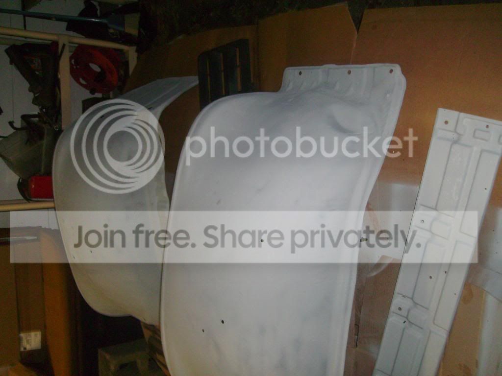

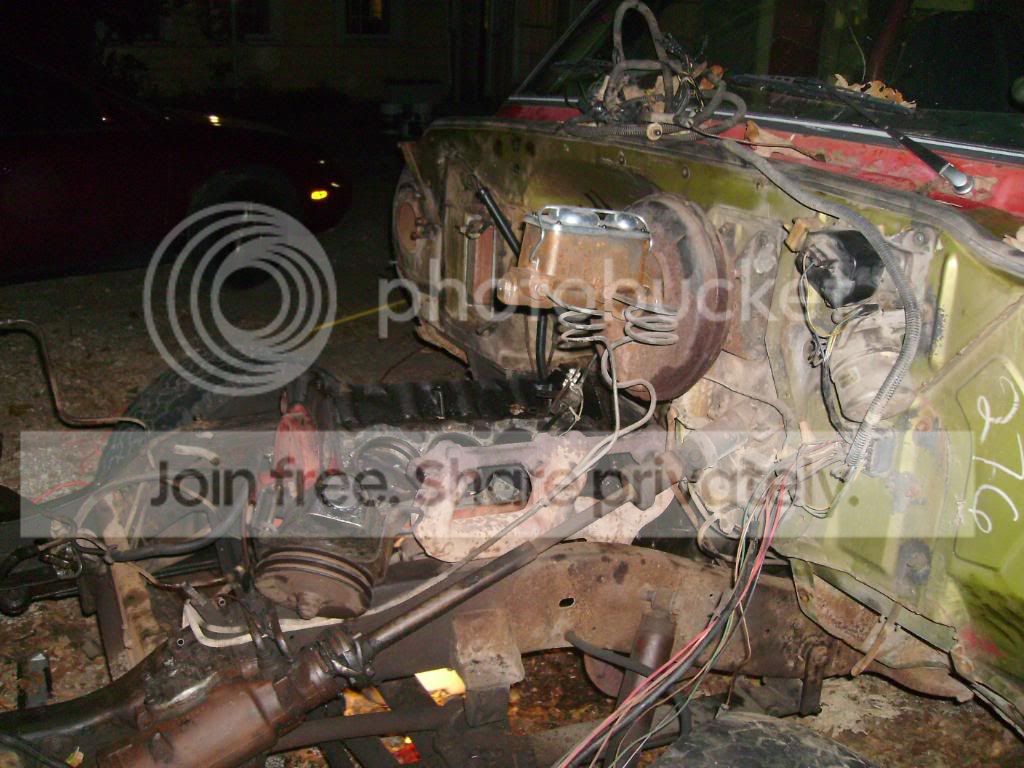

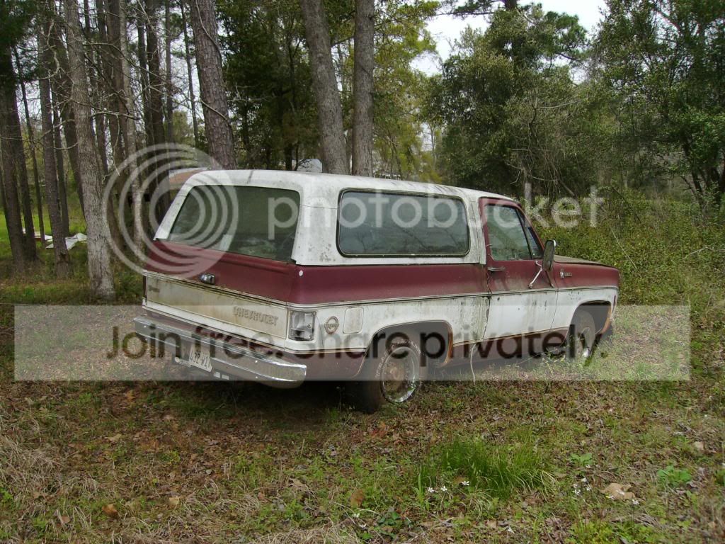

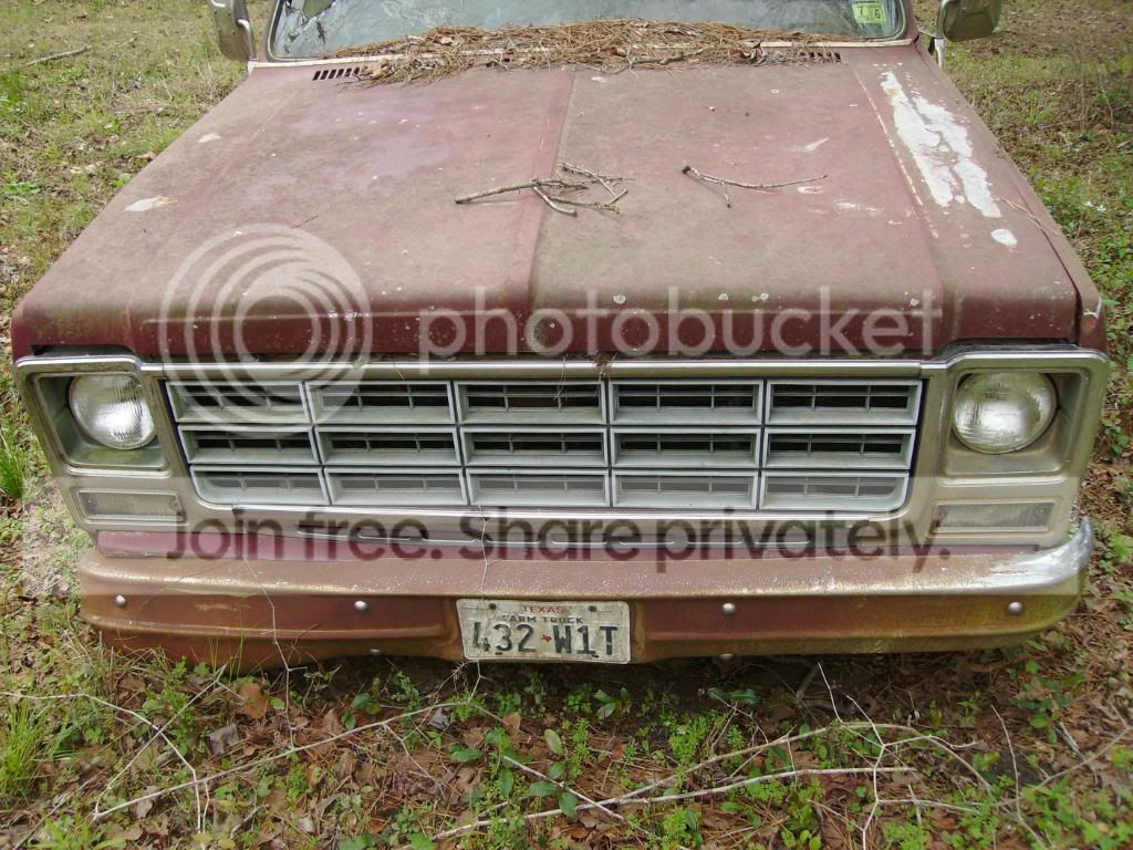

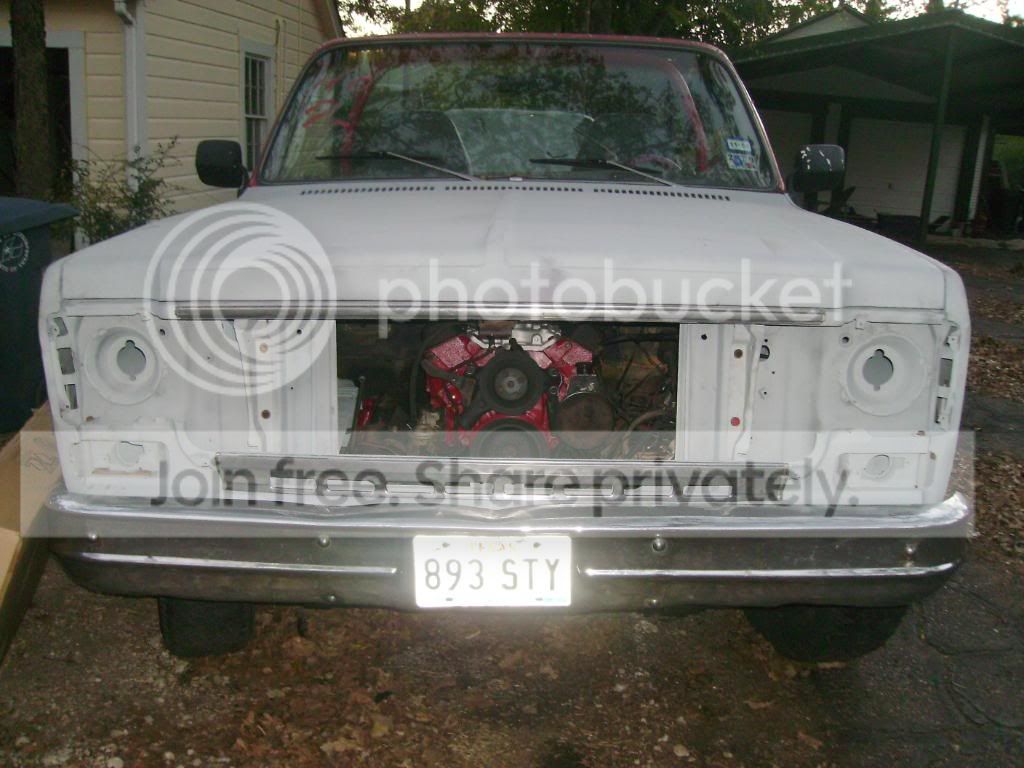

A little after that I found a '79 2WD Blazer with a solid 350 block and a good front clip.
So I began the teardown of the donor vehicle and had the entire front clip primed and ready to install.

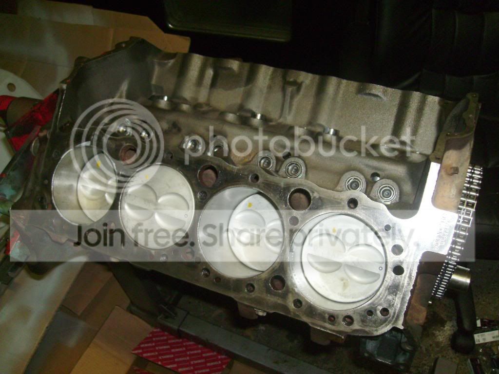

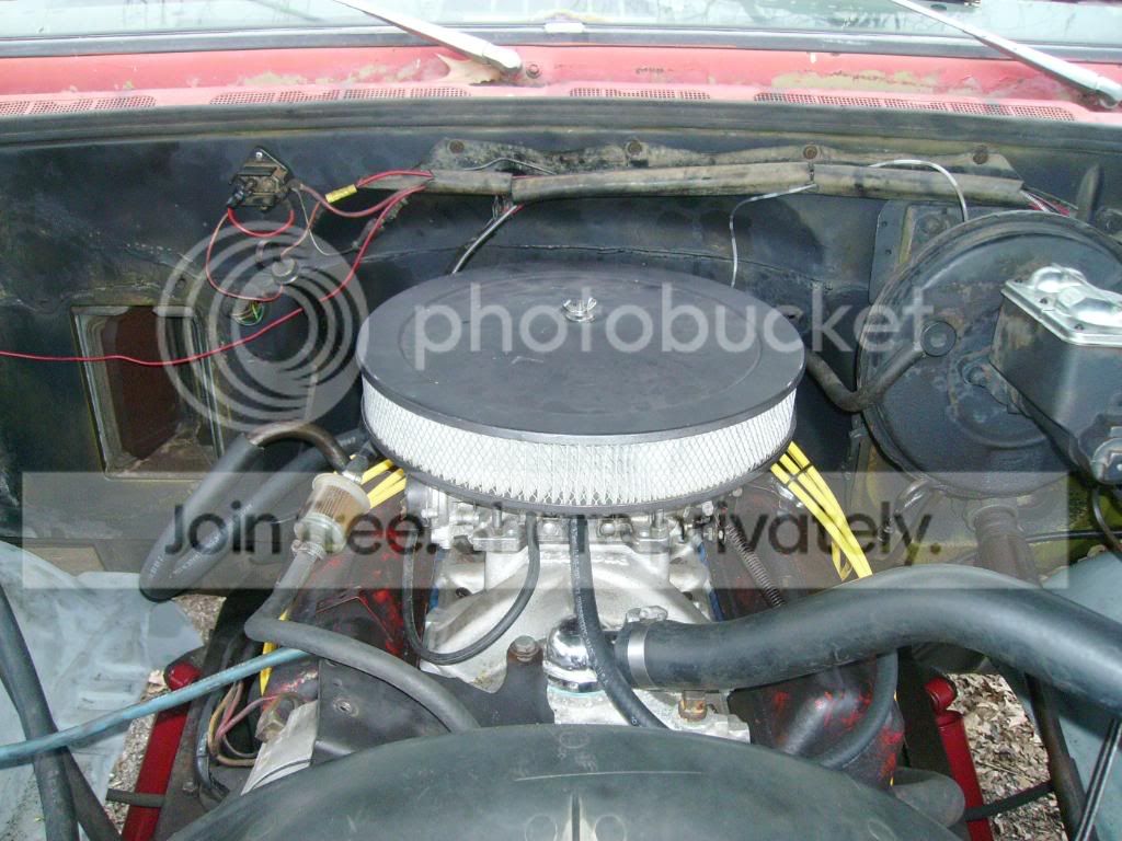

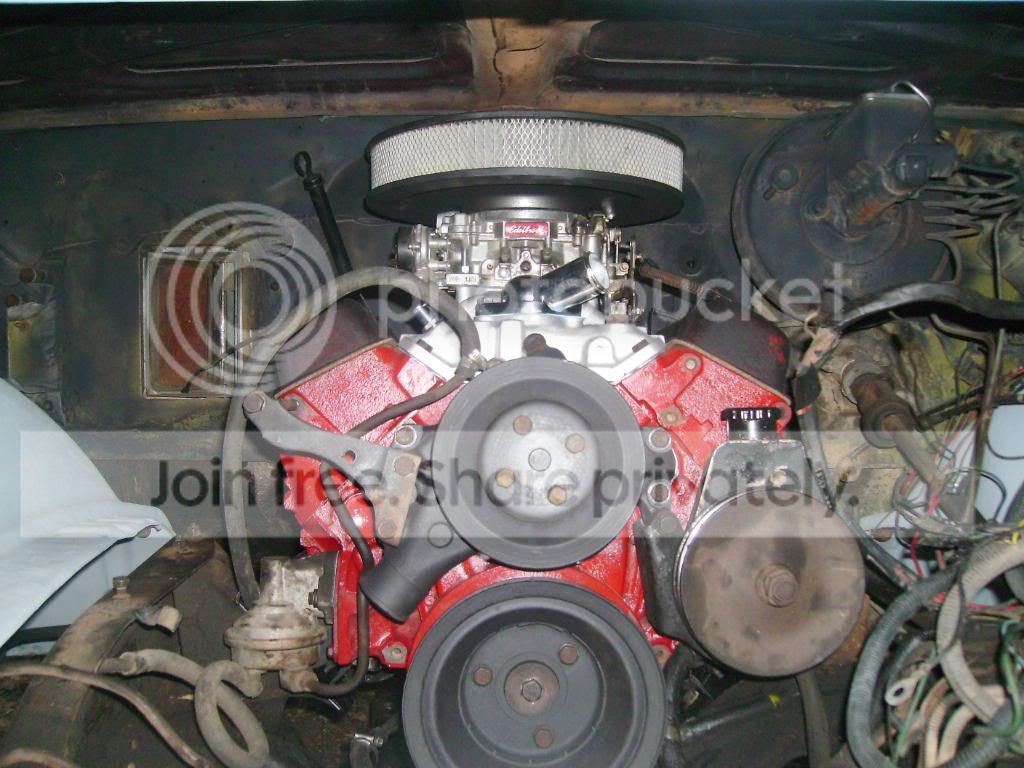

The plan for the new engine was to have a reliable, strong motor with a wide powerband and good torque right off idle. Here's what went into it:
  • Comp Xtreme 4x4 cam 12-235-2
  • Flattop pistons w/moly rings
  • Cloyes True Double Roller Timing
  • Edelbrock Performer EPS Intake
  • Edelbrock 600cfm 4bbl Performer Carb
  • MSD Street Fire HEI Distributor
  • Hedman Headers

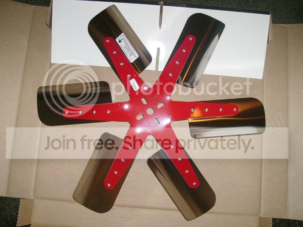

  • Flex-a-Lite Stainless Steel Flex Fan and Red Anodized Spacer
  • Dorman Harmonic Balancer

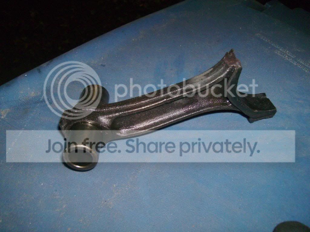

However, the heads from the donor engine were both cracked and unusable. This meant I would have to pull the heads off the existing engine to finish the new. However, before I did that I had the bright idea of running my 2 1/2 ton, beast of a 4WD truck in the 1/4 mile at the local drag strip:dunno:. It ran a 17.84 at 75mph, not too bad if you ask me. The bad news was that run created a stress riser that eventually led to a thrown rod:doah:.

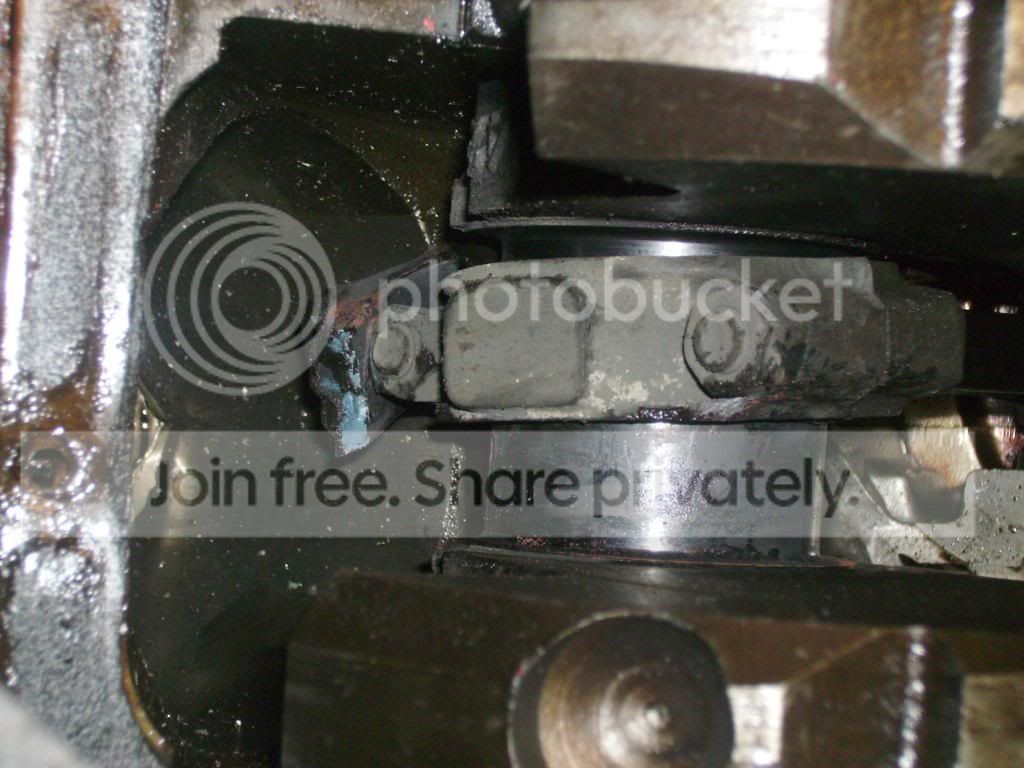

So the teardown of the '73 started:
After some trouble with the wrong torque wrench putting on the heads (It was in Inch/lbs:doah:) We finally got it all back together and running, and installed the new front clip.

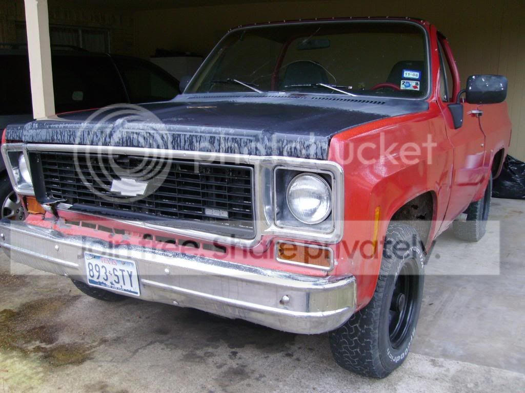

I had custom exhaust installed, it's 2 1/4" true duals with FloPro MX500 series mufflers and turndowns right before the rear axle.
Some other mods are high back bucket seats out of a fullsize ford van, a grant gt steering wheel, tailgate swap from the '79 (it latches now:D), '79 4-row radiator, 15x8 Black Rockcrawler Steels, and some other assorted small stuff. I have 3 tops: the factory hardtop, a full softtop, and a custom soft top that creates a cab and leaves the bed open. (I'll post pics of the tops eventually)

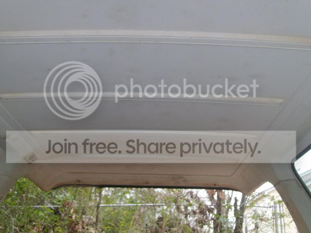

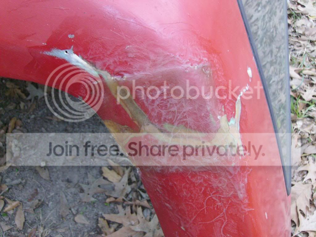

Well here's a few shots of the hardtop. It's in pretty good shape, and I recently repaired the rear corners with some fiberglass. Not too bad for my first time.
The repair isn't pretty, but it's strong, and I'm a firm believer in function over fashion anyways:D.

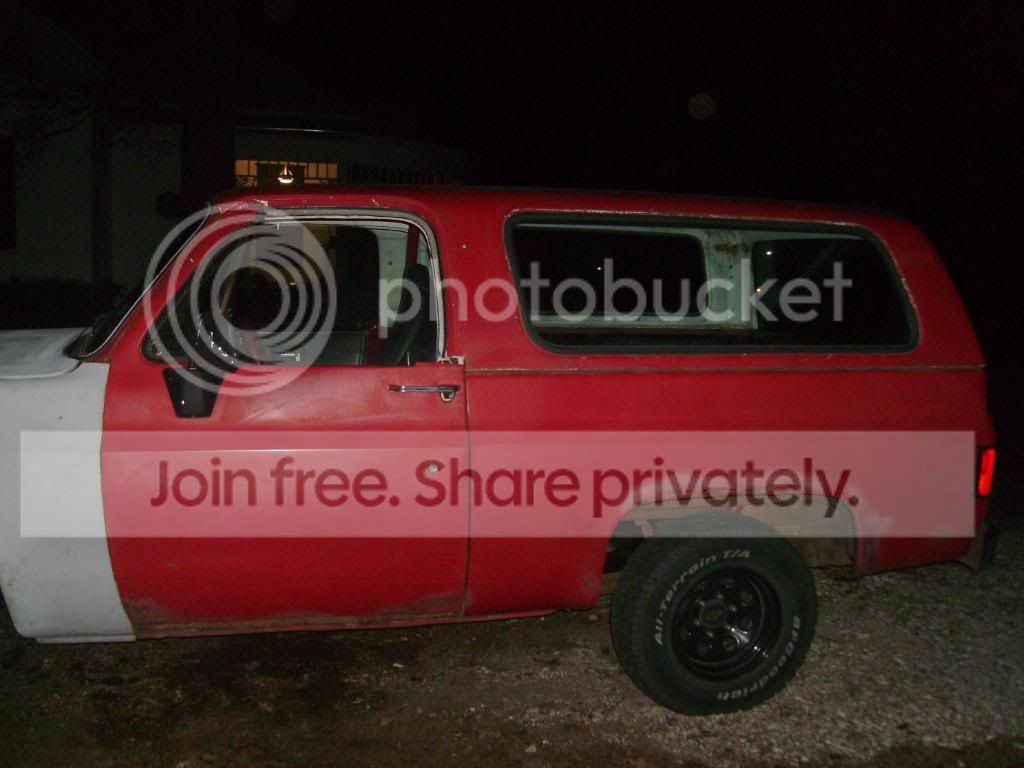

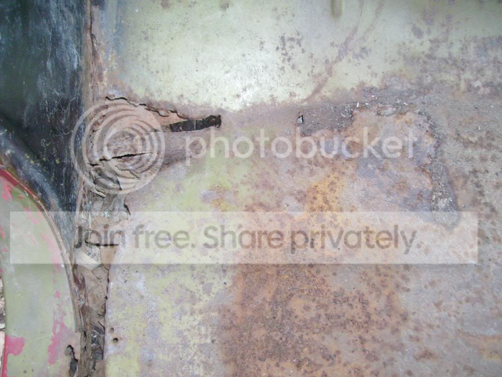

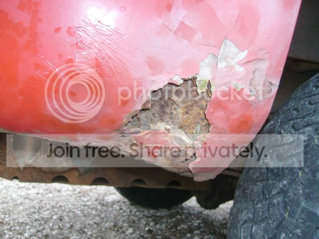

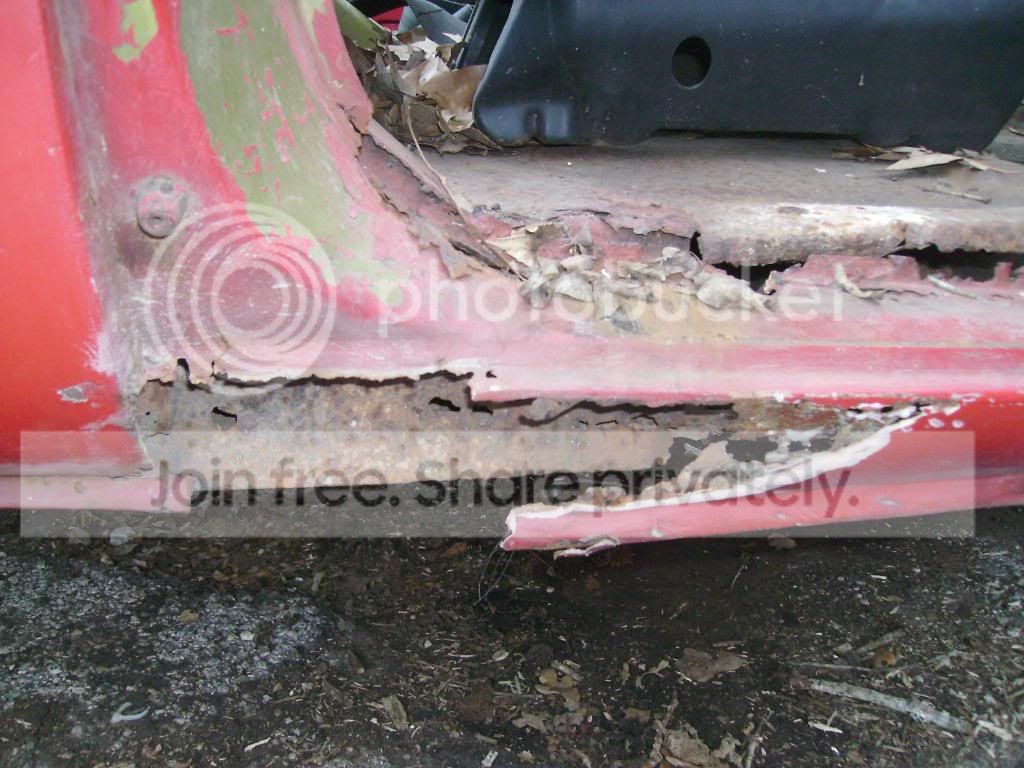

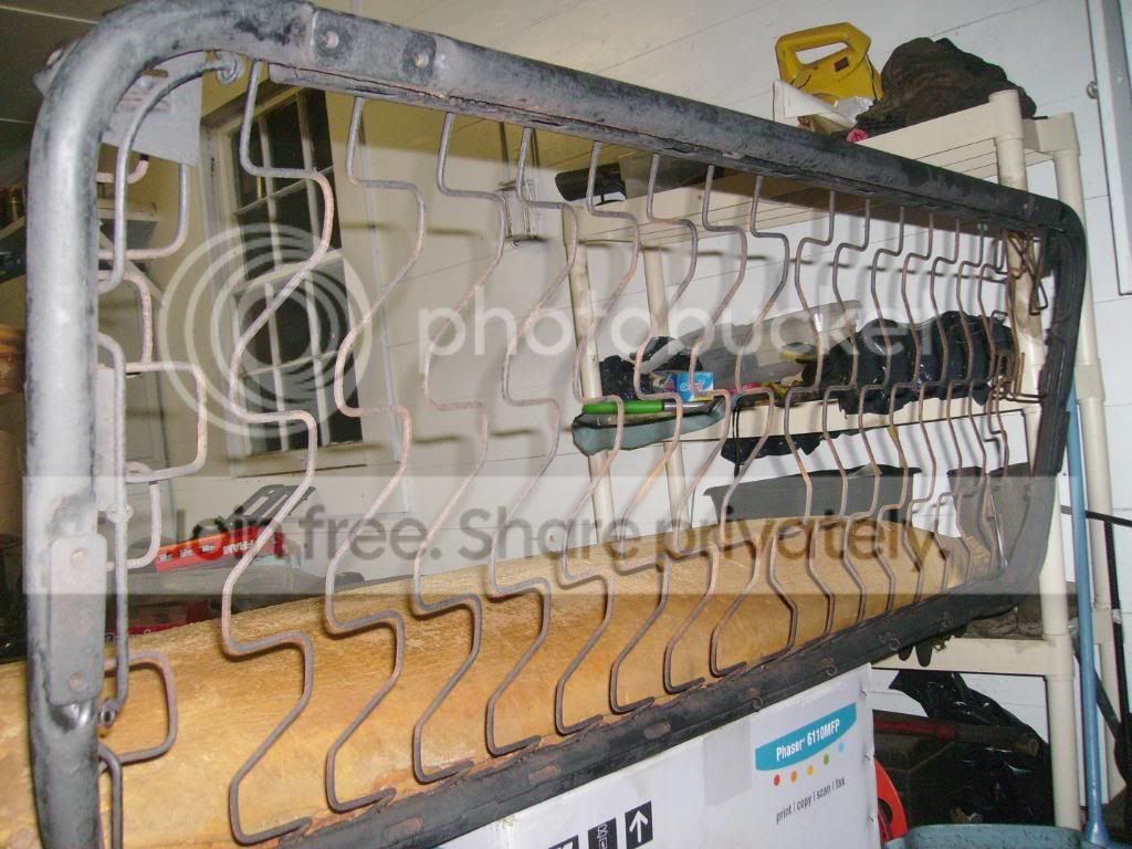

There are some parts of this truck in pretty good shape, and others that are completely shot. These are the major rust spots I have to deal with:
I plan to cut out the rocker boxes, widen the wheel openings, and lay down new floor board where needed. After new tires go on that will be my next major project, as I want to get rid of the cancer.

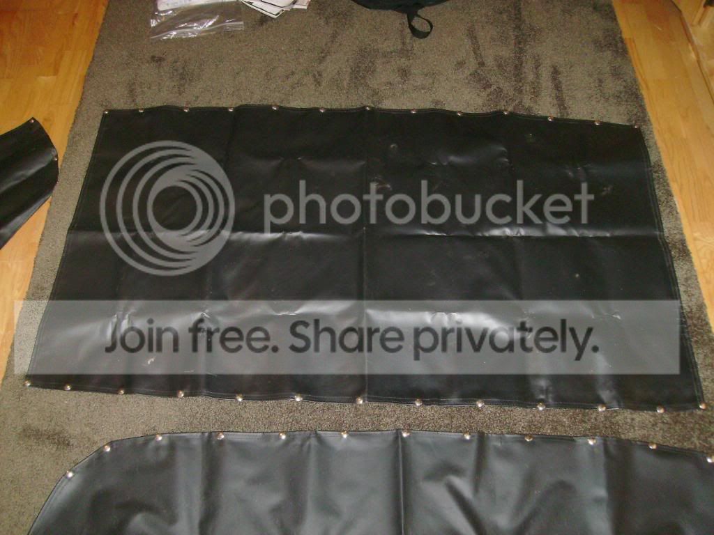

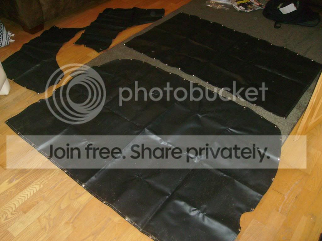

I've taken out the snaps on the windshield frame so the hardtop would go back on, but I can layout the soft top and snap some pictures to give you an idea.

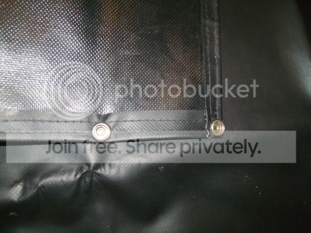

Custom Soft Top Pics

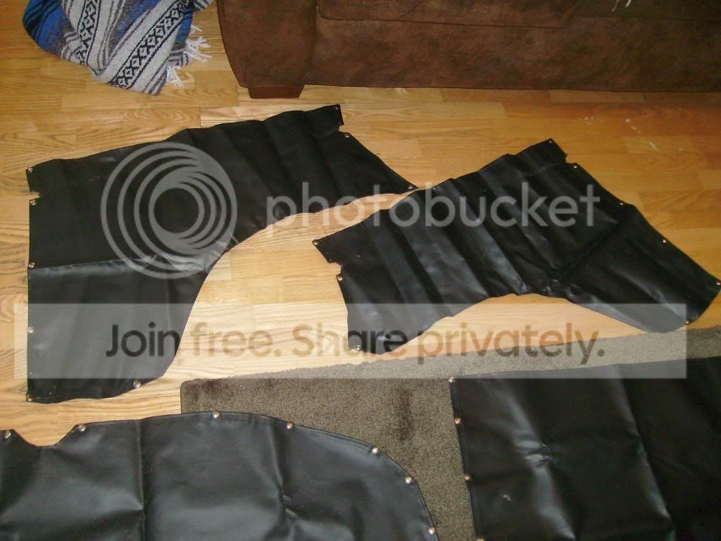

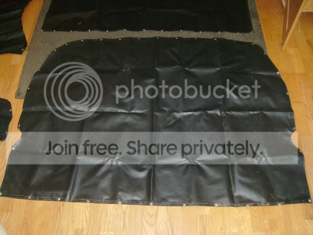

Alright here you go brockmub:
The top is 4 pieces, made out of some type of vinyl that is probably the strongest stuff I've ever seen, the snaps are the weak points. It uses snaps to attach from the header to roll bar, and roll bar to bed.
The top piece is what I use the most, only downfall is that it doesn't cover all the way out to the top of the windows, and water off the roll bar drips onto the seat or the back of my neck. Works very well considering we just showed up at the shop and told the guy we wanted a black soft top that made a cab...
The back doesn't have a window, but since I have large side mirrors it's not that bad to drive with. It snaps to the backside of the roll bar and the bed. It has cut outs for the support tubes that come off the back of the roll bar.
These sides cover the gap between the top, roll bar, and doors. I can drive the truck with them on, but it makes getting in and out of the truck a hassle since they snap to the door in two places. I did not originally ask for these, but my dad instructed the guy to add these on.
The stitching is super strong, and so is the fabric. The guy engineered the top so that it would overlap the sides and allow water runoff, it works well. However the top doesn't overlap the back, so water still gets in that way, but not enough to bother me.
Total cost was $400, he's even repaired the snaps for me, no charge. It has worked great for what we needed it for, until I could get the hardtop on. I also have a full soft top that has never been fully installed, don't know if I have all the parts. I am hoping to make a bikini top that will use a jeep-like rail on the windshield frame, run over the roll bar and down at an angle for a foot or so, and then attach to the bed with a couple of straps. A little bit easier to get on and off. Hope this gives you some ideas.

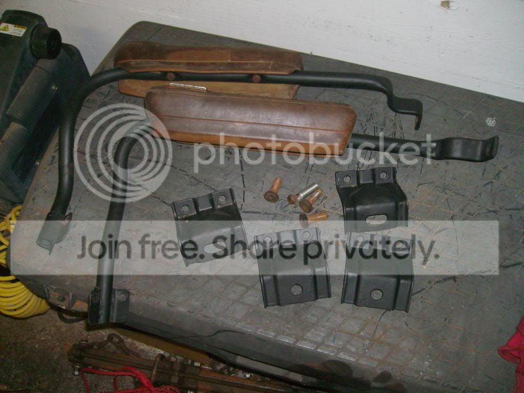

I've also started the disassembly of the doors off my donor truck, I'm hoping to turn them into some half doors until I can get some tube ones from Kert. The passenger side door is completely cleaned out except for the latch/lock mechanisms since I will need to relocate them somewhat. One I start cutting I will probably snap some pics as I build 'em.
Last, but not least, I bolted in the rear seat and slid in my plastic/composite container that'll eventually be some locking storage for tools, etc. (These will be pulled for the metalwork/bedliner, but I'd rather have them in the truck than in the garage)

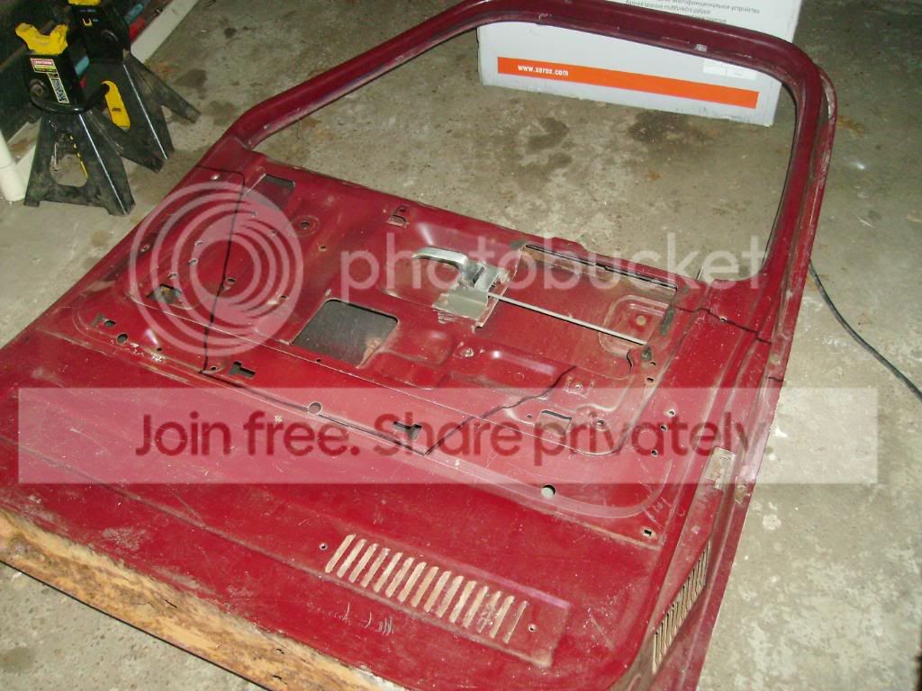

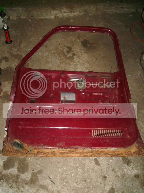

Here's the passenger side door completely empty except for the latch mechanisms:
The bottom is pretty rusted out so i'm gonna need to fab up a patch panel after i finish all the :hack:.
I plan to cut the rod from the inner handle and just relocate it closer to the latch, something like this:
And last but not least, the inner cut line:
The cut isn't set in stone, I may move it up or down, but I like the top front and back to be the same height. I would have started the :hack: tonight, but I don't think the neighbors would have appreciated it, I'll torture them later...
