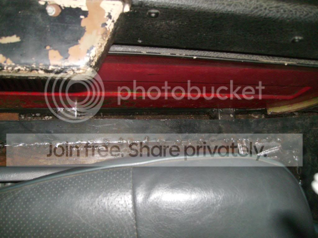

Anyways, I cut out the patch panels from a sheet of 16ga for the floors and got those in. They're not fully welded, but I did a solid tack every inch or so. I chopped the bottom off of the doors, and they will still need work to function correctly, but they close enough to drive it. The seats are back in until I do the POR-15 and Herc. I plan to bring it back to the house tonight and just work on it without having to rely on my buddy to open the garage whenever I need to work...I just won't have access to the welder.

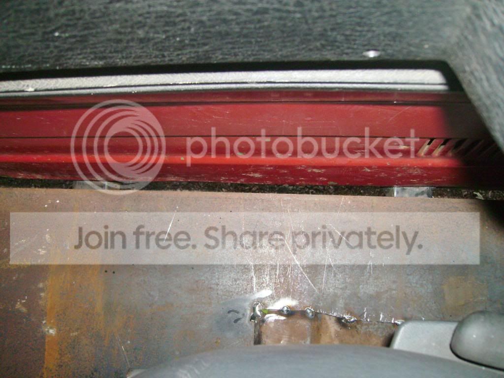

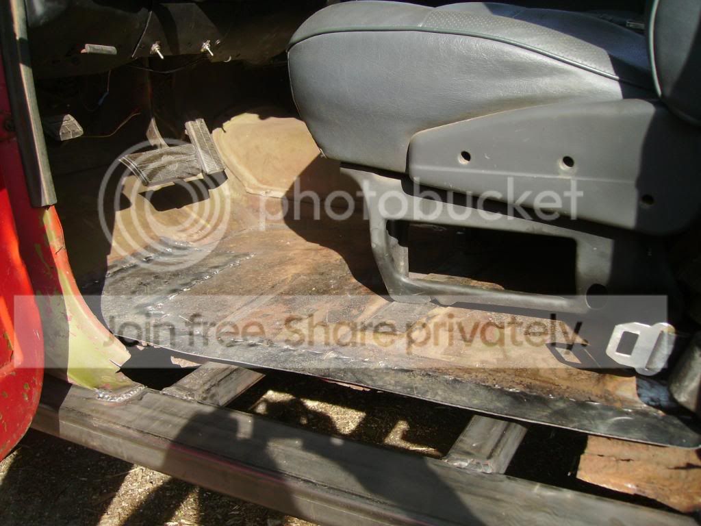

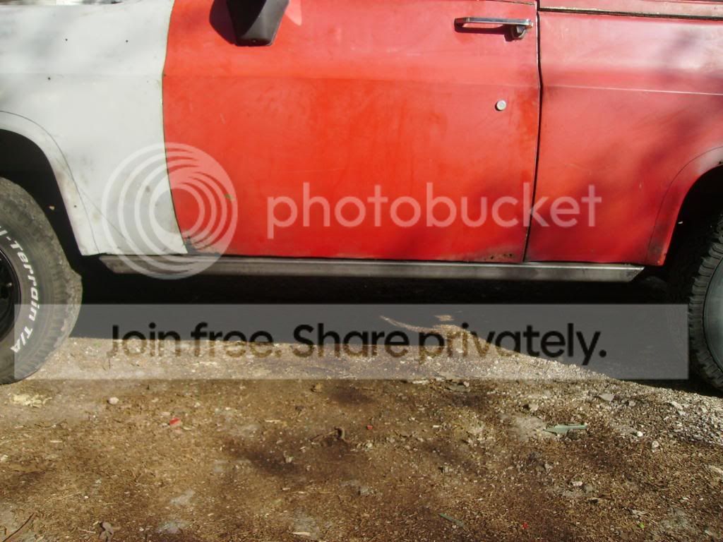

Ok so I brought the truck home last night. There's still a whole heck of alot of stuff that needs to be done, but it's driveable. Here are the pics I promised:
I've still got a gap to fill between the floor and the slider, I didn't have time to put the doors back on to check what shape it would need to be.

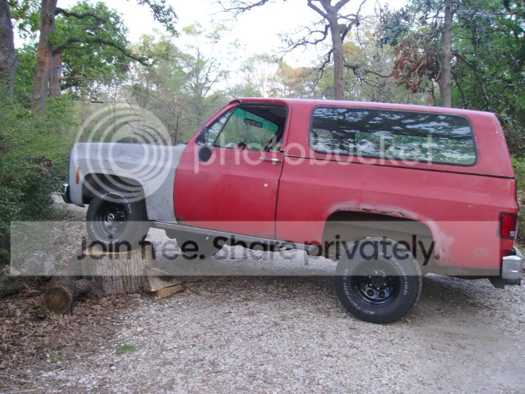

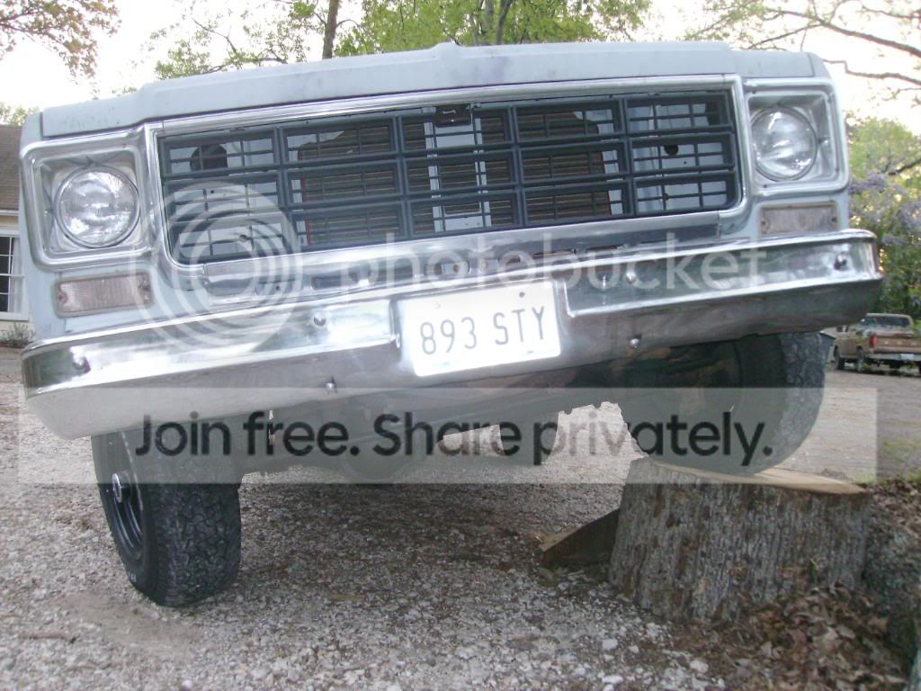

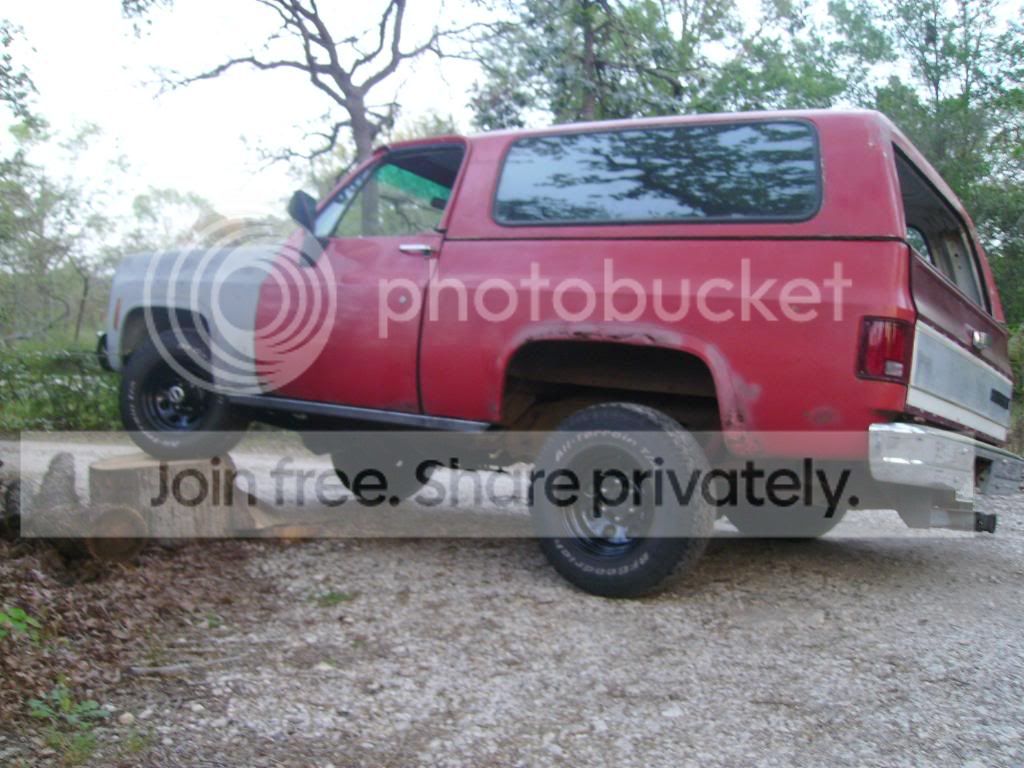

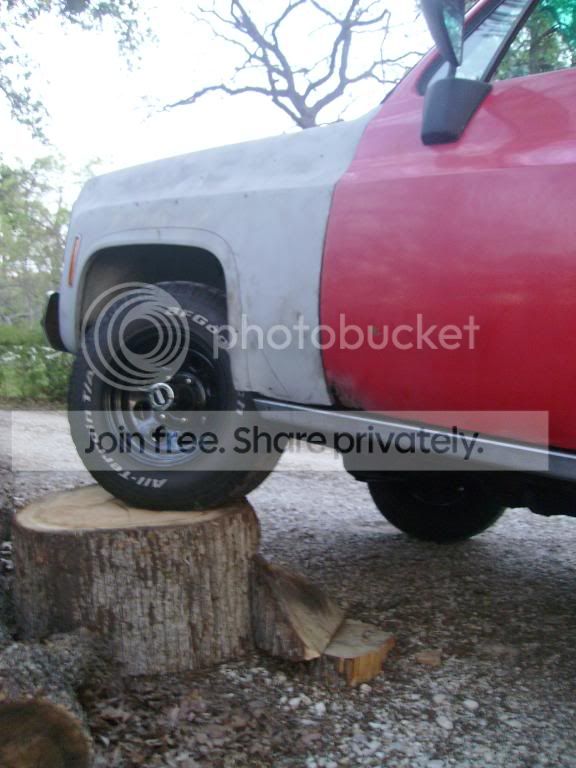

And then tonight I was bored and tired of working on my truck...but since I don't have any large rocks laying around, I rolled over a chunk of a tree we just felled and flexed on it. Yeah I know it's pretty poser, but I never have an excuse to drop it in 4lo and "crawl". It was actually quite relaxing lol.
