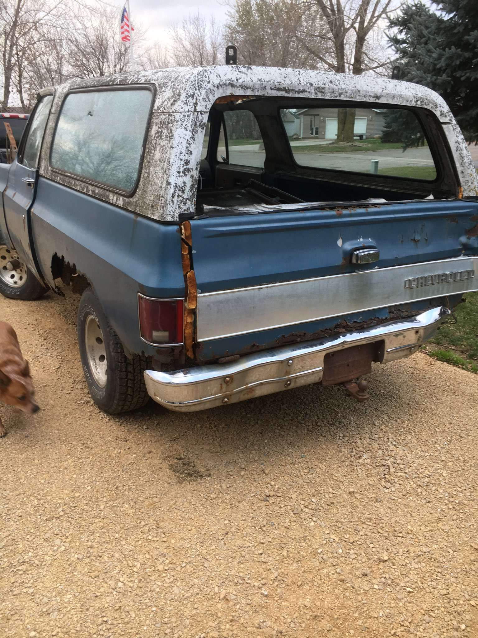

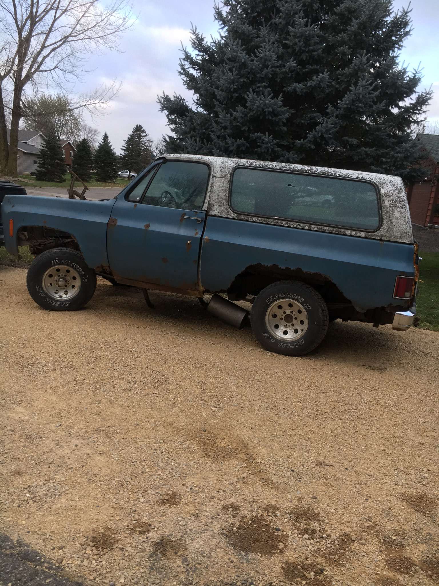

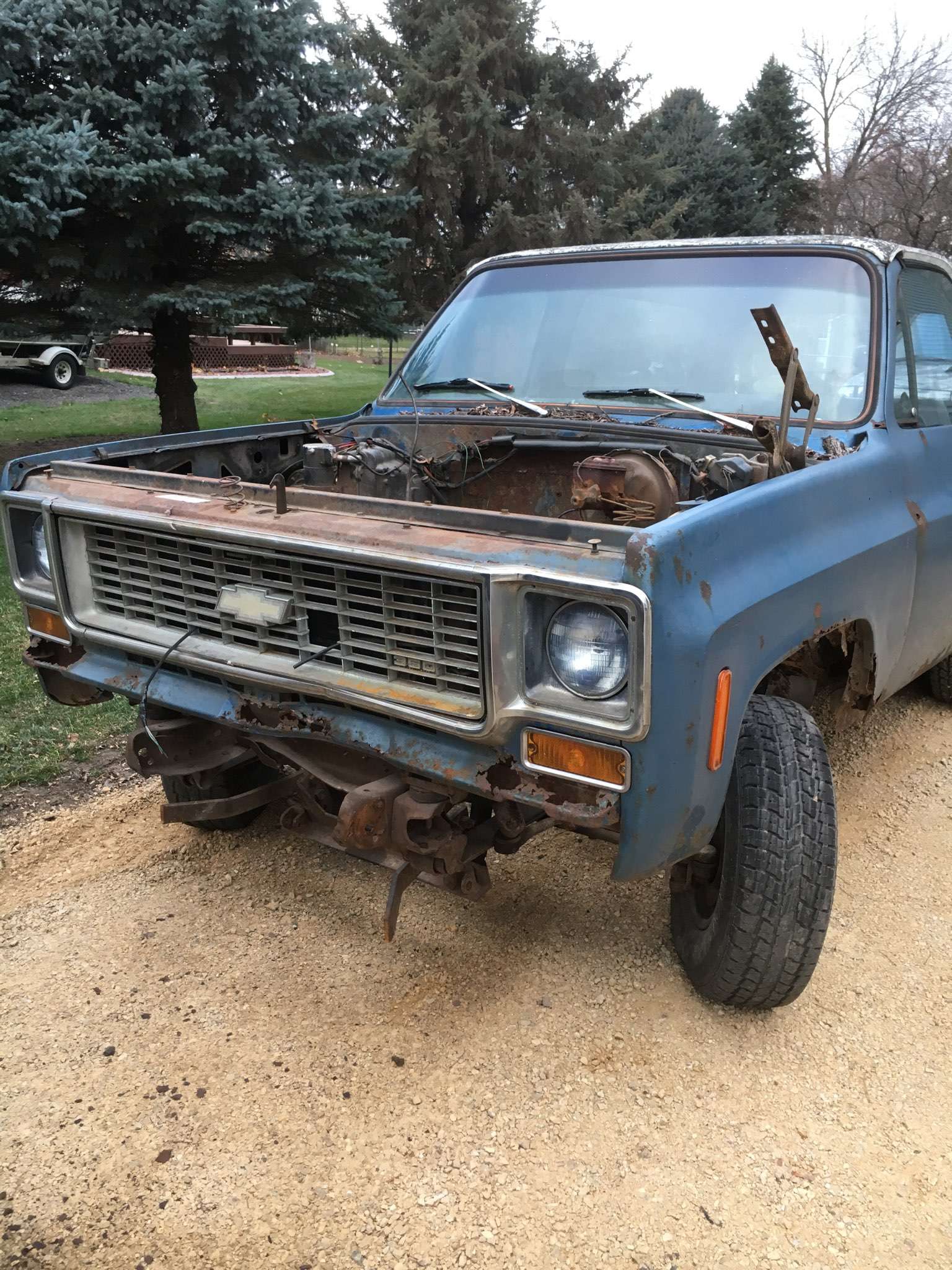

So I've always wanted a fully convertible (pre 1975) K5 Blazer but never really had to money to buy a decent one because they are rare and expensive. I somehow acquired one for FREE the other day that is in very rough shape.
My question is, do you guys think it's worth repairing? To give a little background of me I've never none an engine swap but am somewhat mechanically inclined. I've never done body work either but I do plan on doing 90% without hiring it out. Maybe give some friends beers to come and help out.
I haven't had the chance to fully go through this thing but I'm going to list what I've noticed it all needs while I was loading on the trailer:
Engine, Trans, rear end, full front clip minus hood, fuel lines, possibly fuel tank, door jam pillars, quarter panels, some floor work, seats, probably new wiring, driver side topper glass, rear topper glass, rear gate, rims and tires. Frame is solid, hood is good, windshield is good, and I think the front doors are salvageable.
This ^^
Worth it? It depends on your budget and desire. Know up front that it's unlikely you'd ever come close to recovering your money (if that were a concern).
Imo, it's too far gone. From your pics it looks like ALL of the sheetmetal needs to be replaced, even free projects have a point of no return. I'd do like Rivman suggested and salvage the full vert parts (windshield frame, top, doors and ALL associated hardware) and graft it on to a later Blazer that's in much better shape that will also likely be optioned better.
So basically I would sawzall the top off a different blazer and with some modification be able to use my full convert top?
Wow, that brightens my day up knowing its fairly simple. Now I'll be hunting for a different blazer. Maybe I'll actually have this thing road worthy by the end of next summer.
Thanks for your help guys
