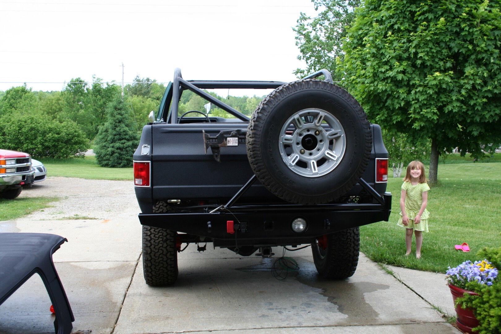

And here's an overall shot. Not a lot of space taken up, and tucked away nicely and safe from harm.
