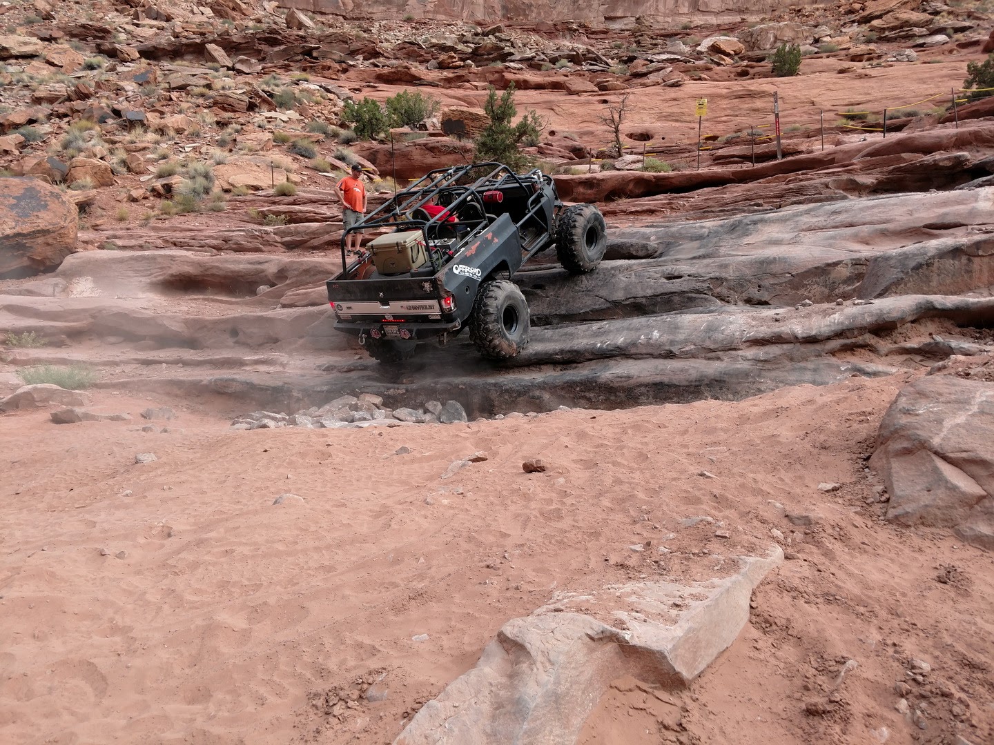

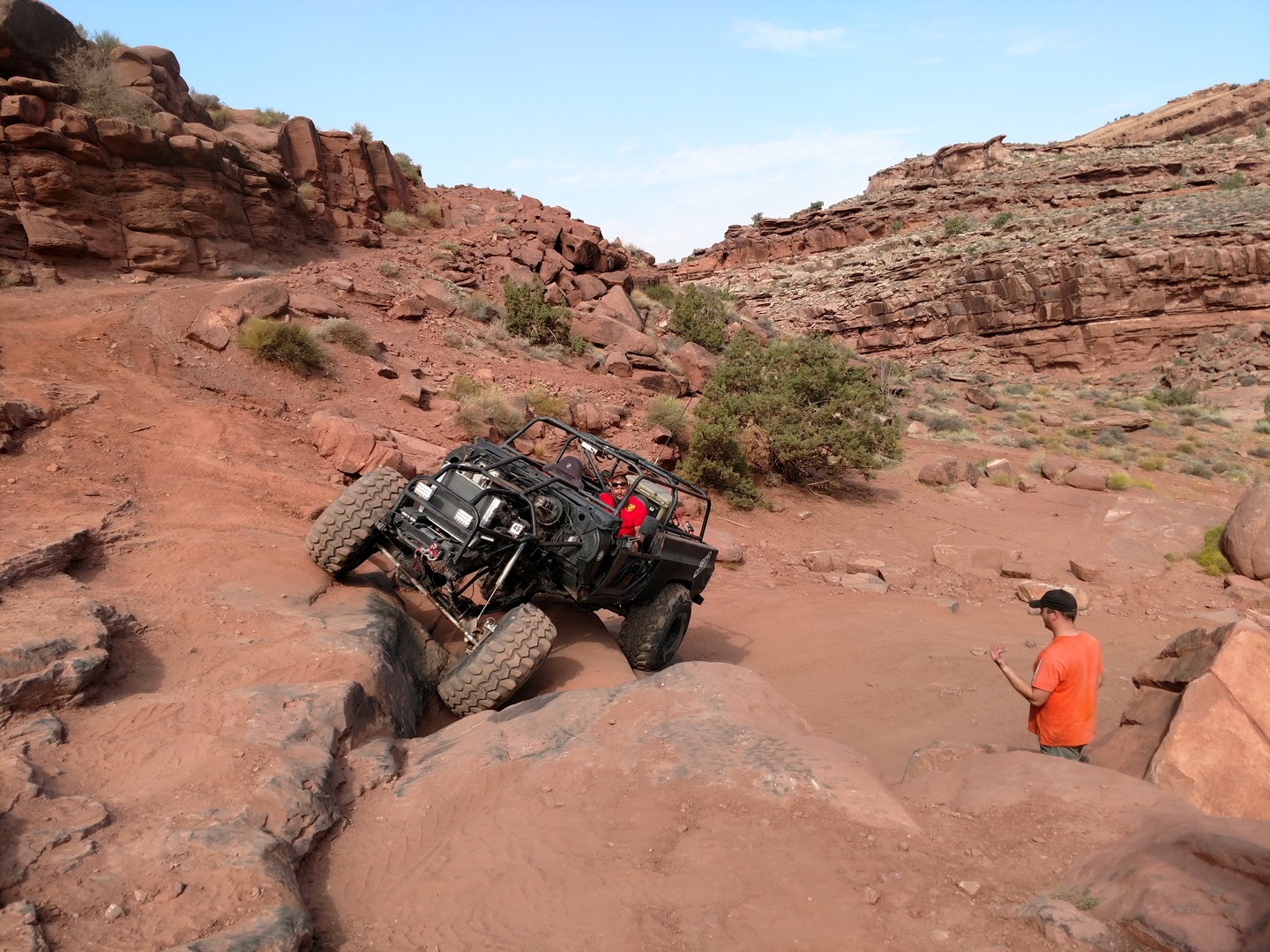

@ChrisPerry
What size wheel do you have on this rig. Diameter, width, backspacing?
I want to try and find a beadlock similar to your set up.
@ChrisPerry
Sorry for the late reply, I keep meaning to measure the back spacing for you. They are 15x14 procomps. I think the bs was 4.5" but not sure. Had to gring the calipers quite a bit to get them to clear.
Thanks for the info. I found a set of Raceline RT-81 Black Rock 8 17x9.5 8x165.1 (8x6.5) for $1072.00 a set of 4. 3.5" of backspacing. Going to go with 40"-42" super swampers.
I like the way yours are sitting on your rig. I saw it at BB17 and thought that would be a good set up for my 87 K5. :waytogo:
