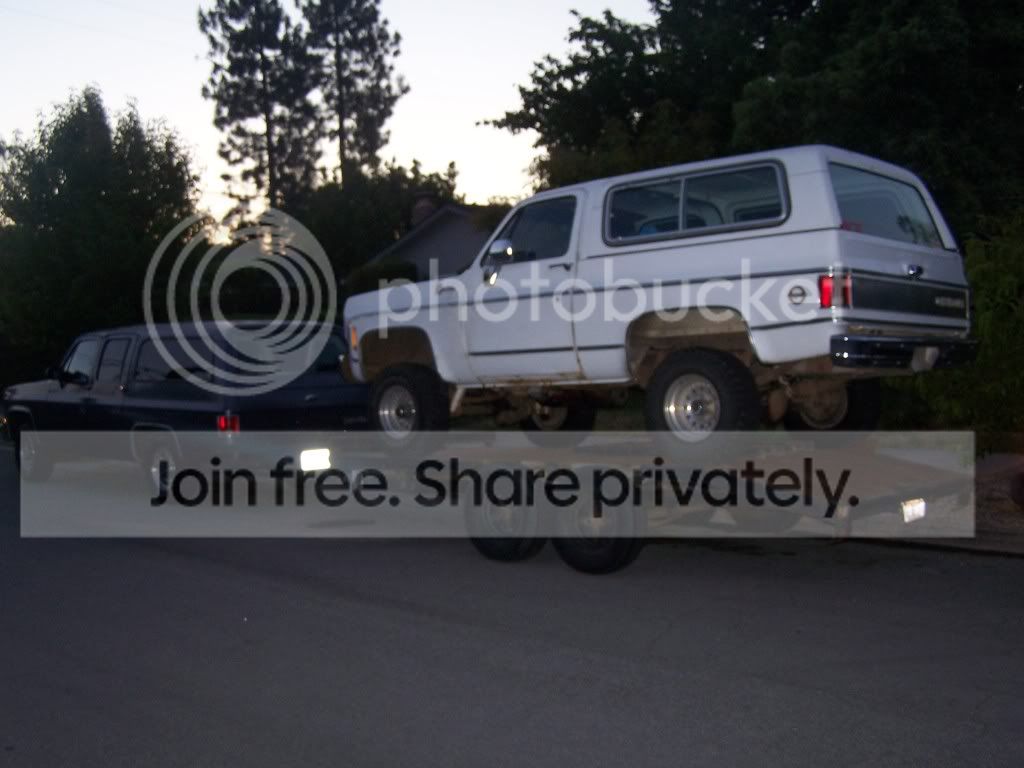

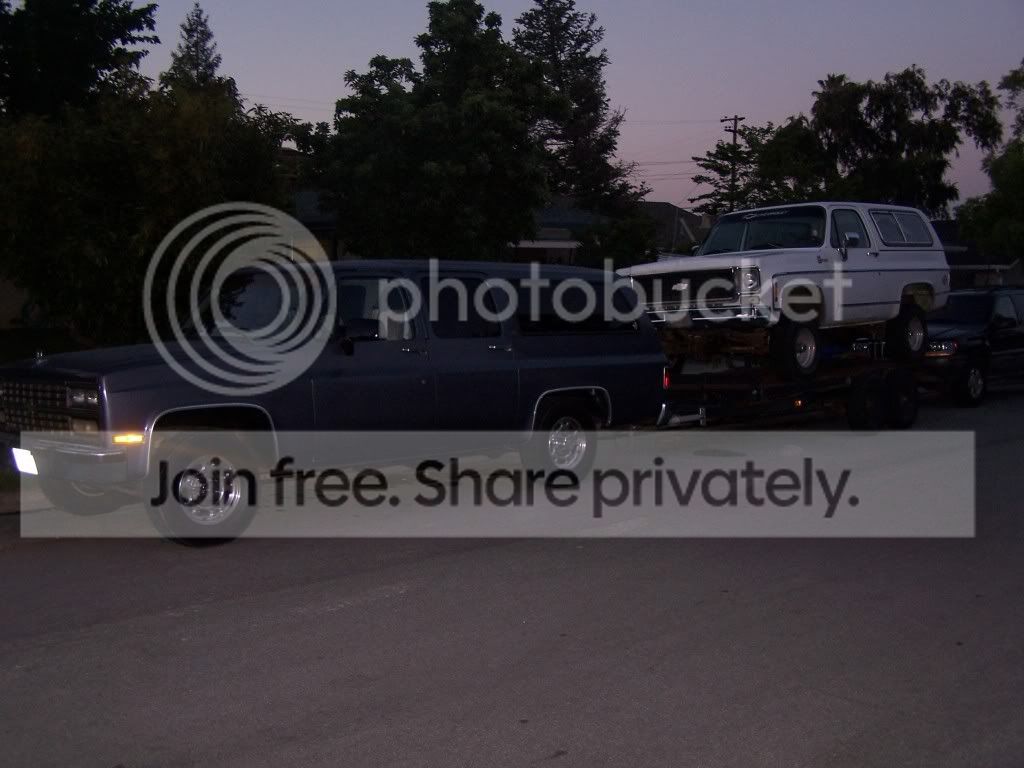

.Just picked up a trailer for the k5's. Its a bit small at 15 ft but i did the math and it works out. Its a deck over and 79'' wide so it fit my purposes and best of all my wallet. Has brakes on all 4 wheels.Yes, but most of the "Offroad" areas require driving on the road both before and after to fill up the tanks. every gas station has gas, but not all have propane and those that do don't always refill large propane tanks. Propane is interesting, but not "simpler" than TBI.
Things have been a bit slow with me focused on getting a trailer so i dont need to rent one for the move so progress should pick back up soon.Just picked up a trailer for the k5's. Its a bit small at 15 ft but i did the math and it works out. Its a deck over and 79'' wide so it fit my purposes and best of all my wallet. Has brakes on all 4 wheels.

I pulled mine years ago with a 16 footer and didn't like it at all... Never felt comfortable... You could add a beaver tail and move the axles back though...

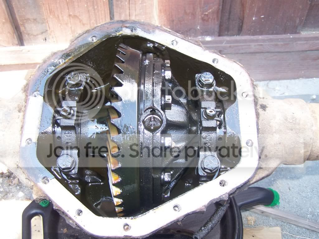

I suggest you pull it out to weld the gears. I dont feel like you can get enough material welded through the windows. and it really isnt hard to pull the carrier out and take it apart on a 14 bolt. Just pay attention to the adjusters and put it back exactly as you took it out and you dont have to reset the gears.
Ps.... You're gonna EAT tires.
Welded rears put ridiculous pressure on tires, around corners and such.
I don't know if you plan to DD this truck, or what, I'm just puttin' it out there.
Chris (NorCal Chris) has his 14b welded, and he puts up w/ it.
But, I, on the other hand, have a Detroit Locker,
and hate to chirp the tires around corners.
How on earth do i get these fockin ring gear bolts out. The stupid motherfocking carrier just spins on me no matter how i try to clamp/wedge it and according to specs these bolts are at 120 ft/lbs. No i dont have air tools available atm btw.
