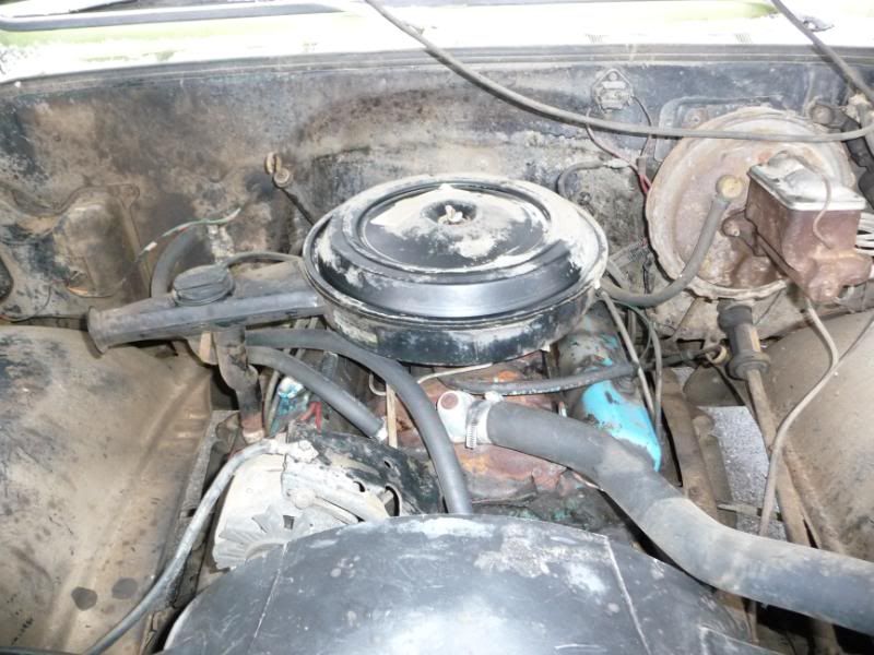

1977 K10 Heavy Half ton 34,000 original miles (after pulling the intake and valve covers I completely believe this to be true)
350 4bbl Emissions exempt motor

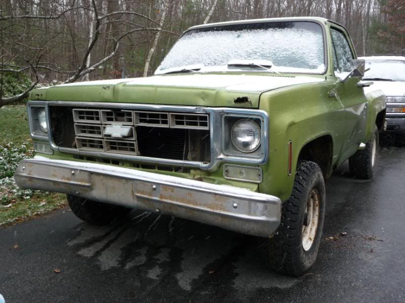

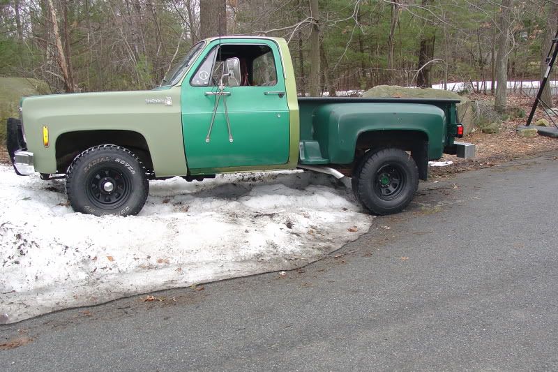

Here are some of the pictures I have right after we unloaded it.

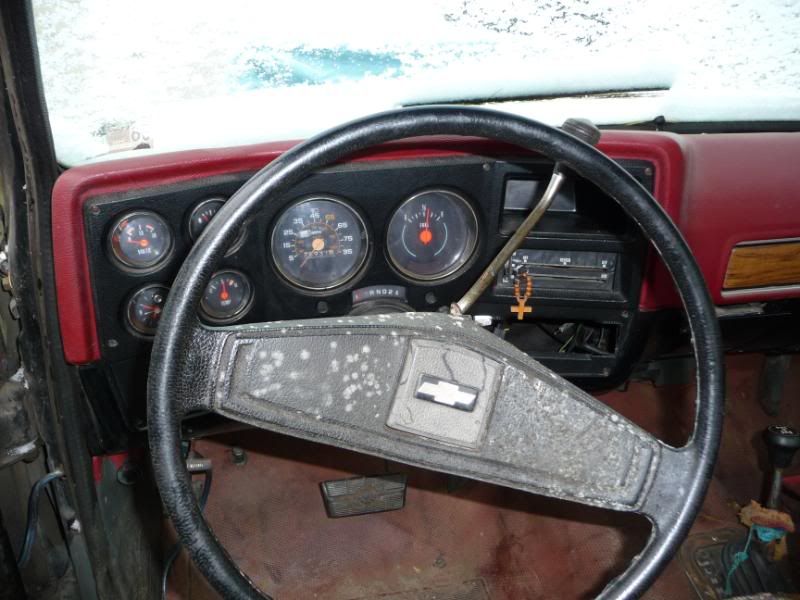

Hmm Mold hummm. And a crack free dash!
The first thing to do was to get this truck Legal and registered. I fixed a fuel and exhaust leak and tried for inspection.... Failed. Most MA inspection places are fools they see a beat up truck and fail it yet pass the truck with a rotted frame... Anyways I was bummed out cause the guy could of ttok one look at my truck and said no yet he took my money and failed me. That shop has since gone out of biz. Anyways it was time to fix all the stuff they saw wrong with my truck...

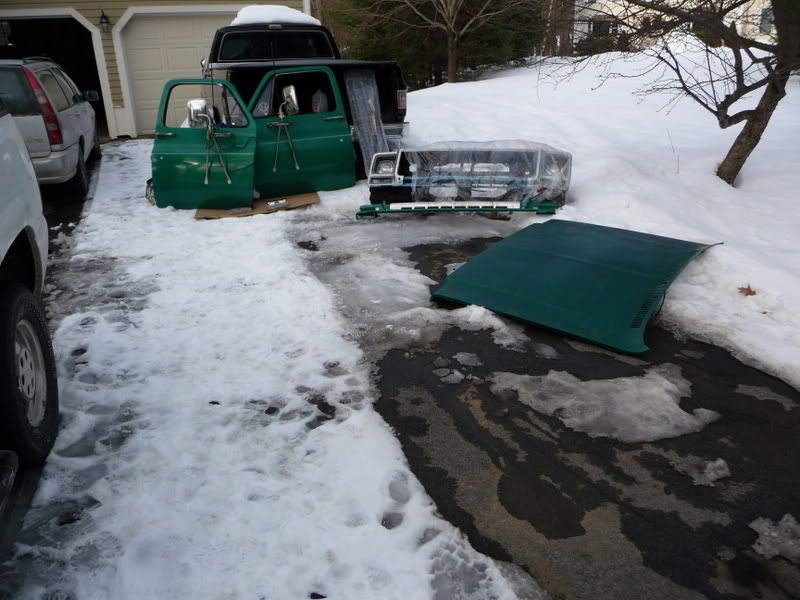

Working on trucks in the winter sucks but I needed to get this thing done. I quickly found out that parts for these chevys are priced cheap.
2 used front fenders = $30
Hood and two doors = $160
Stepside bed = $200
Bumper with brush bar =$75
Grill $30 with extra core support
Being in college at that time I had the Truck ready for re inspection by april 2009

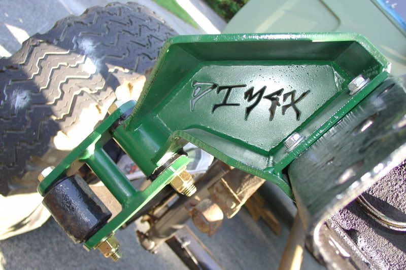

Some used 4 inch front leafs

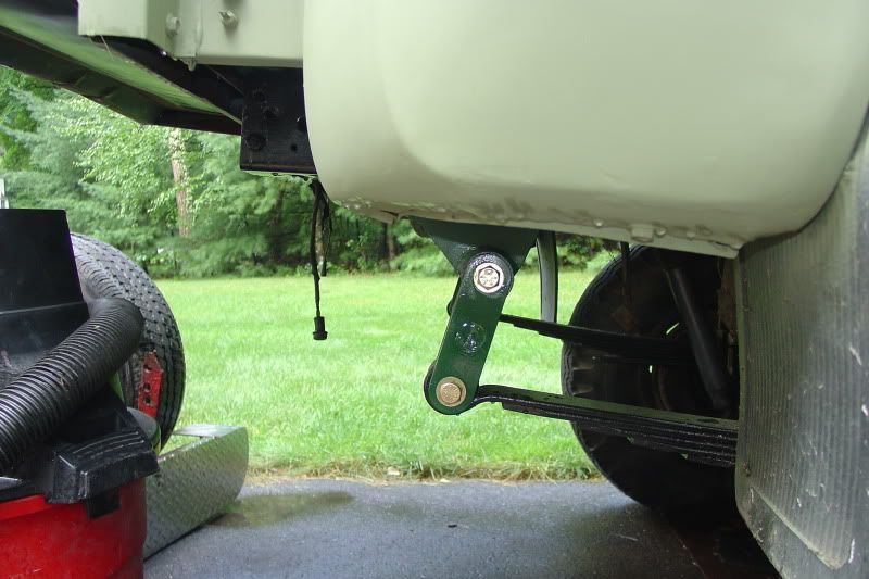

A DIY4x Shackle flip with 4.5 cross tied shackles
ORD Steering box brace
ORD Exteneded bracklines

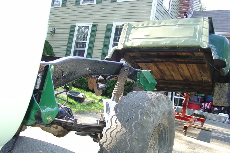

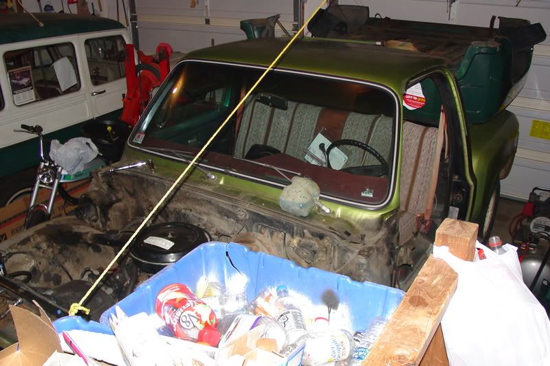

Rivits SUCK!! I did not have a dorch so Angle grinder became my new pal...

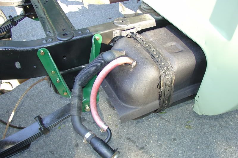

Cleaned and painted the frame and gas tank while I was doing the install.
My front rear spring hanger mounts had rot so I Replaced them with GM ones I got from LMC. Bolted on with Grade 8
Kerts parts rock! Great quality and very resonable price

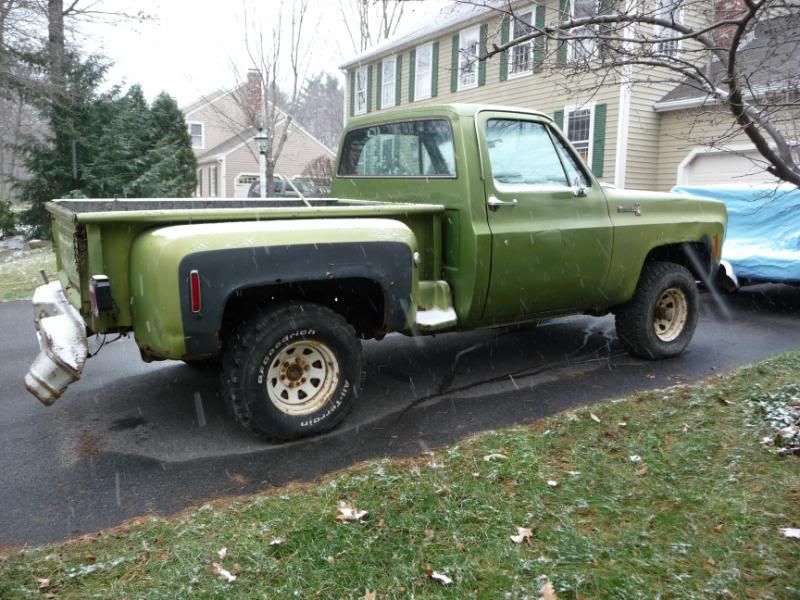

Also found this was a good time to paint the truck. It has some cab work that needs done so It got Rustolium Camoflage Green. I don't think you can still buy the color I had to order it on amizon. Not olive drab and kinda diffrent.

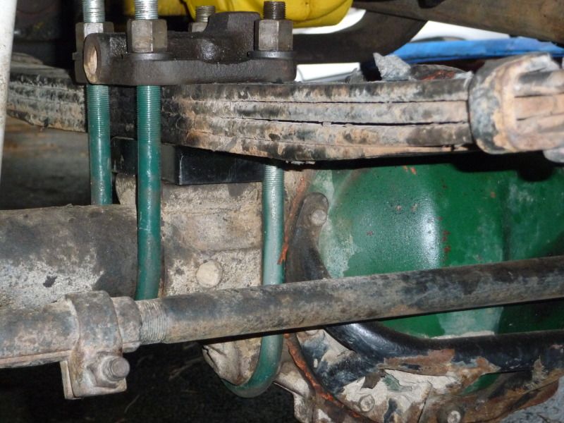

Shackle angle

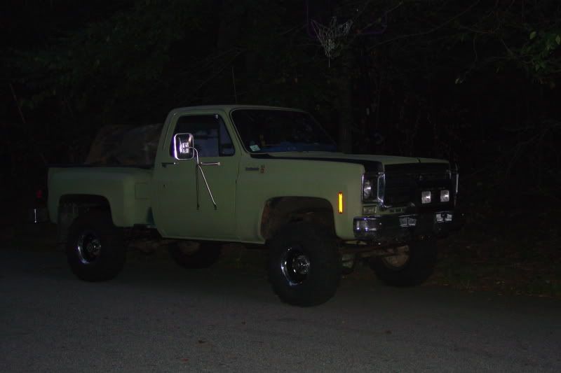

Picked up some used 34x10.5 swampers for $200.00 and it was ready to test.
VERY nice!!
BUT, you are going to have to fight someone else for the use of "Grinch" as the trucks name :haha::D

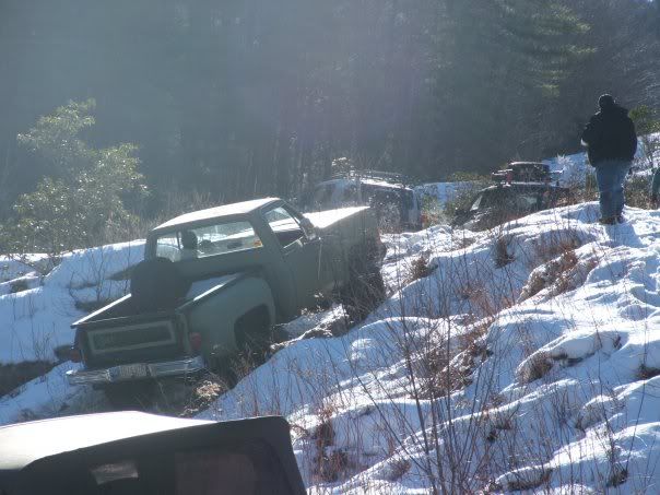

Wheeled it like that for a while. threw a part time shaft kit in the np203 and super which lock outs on the 10 bolt
While wheeling the winter of 2010 I ripped off the towing mirrors on some trees. It is just part of wheeling in the north east with a fullsize.

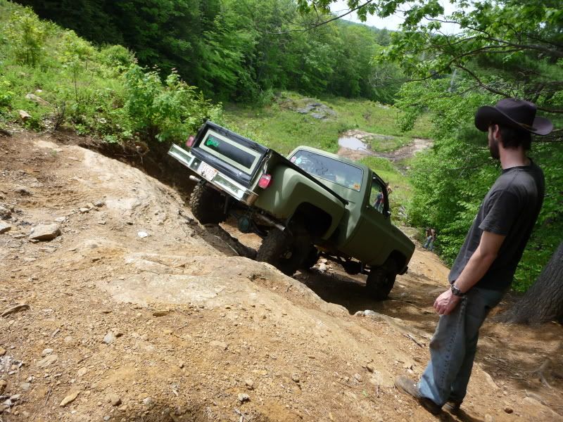

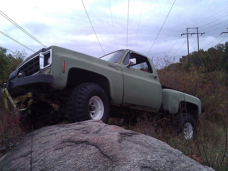

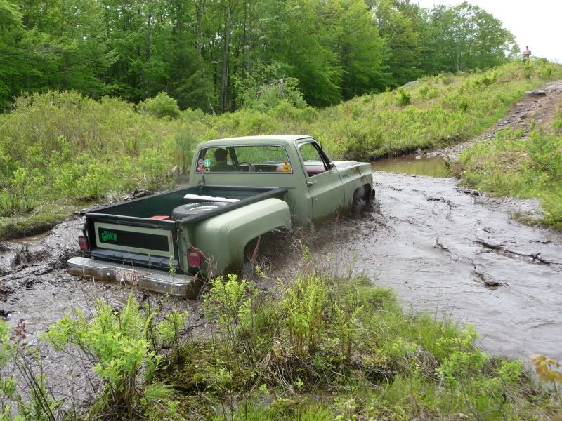

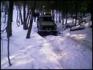

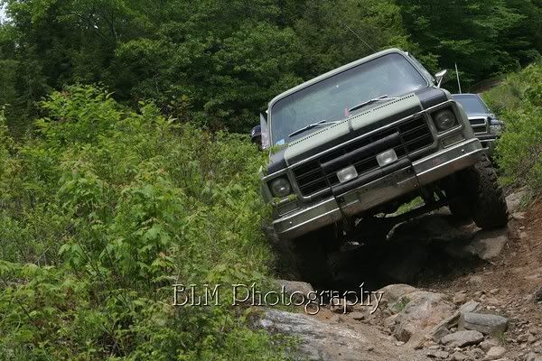

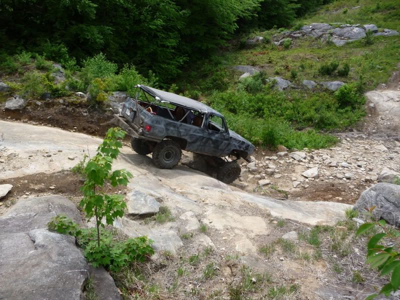

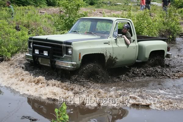

The spring of 2001 I wheeled the truck and just had fun. All wheeling was done on legal lands or private lands with owner permission. Wheel responsibly!
This run was fullsize rigs only we had a Dodge on 35's a k5 on 37's and myself on 34's

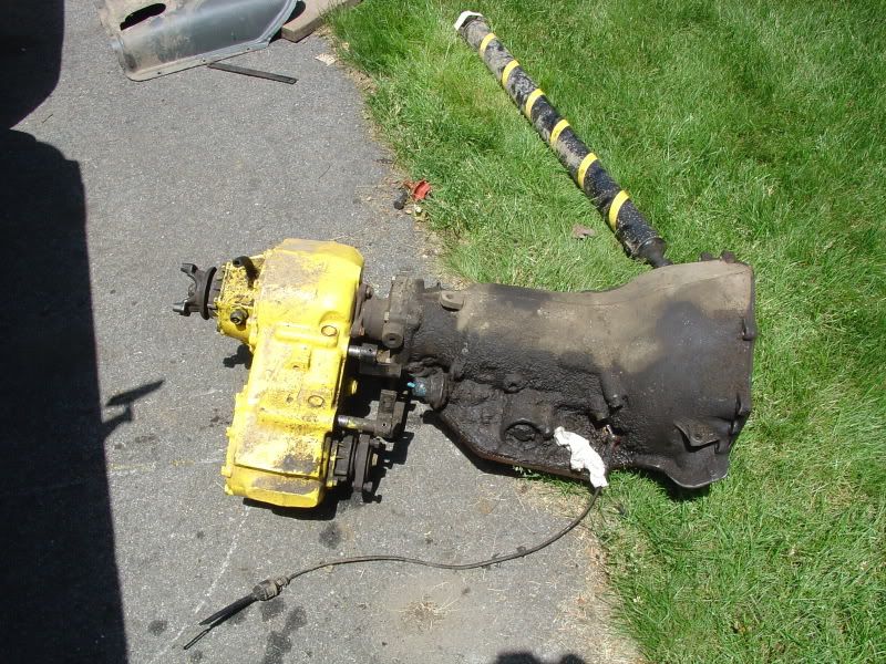

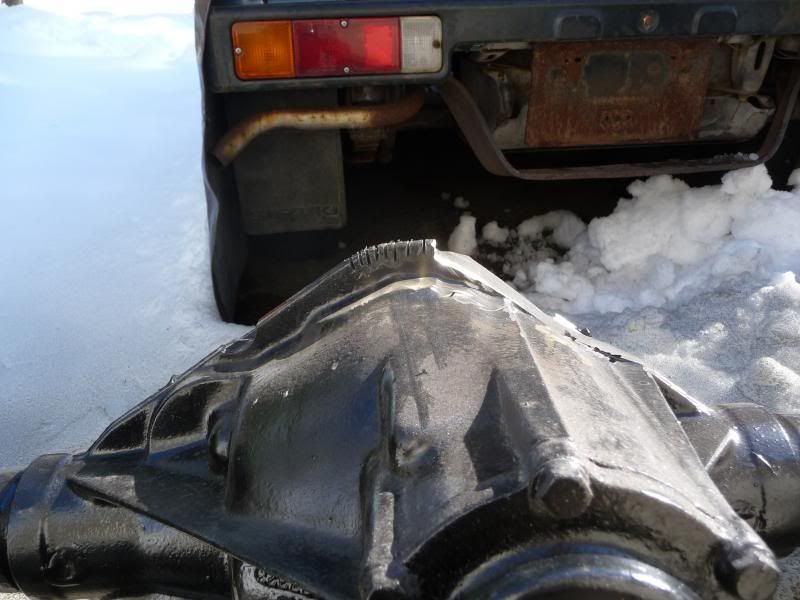

Later that summer this same hole ate my th350

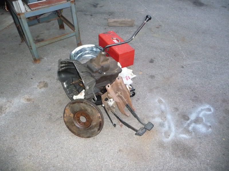

Later that summer my auto injested water and The truck had to be towed home (75 miles) I had always hated the auto and earlier that year had purchased an sm465 and twinsticked np205. I ground the shift rails to allow full twinstick function and got the heavy lump swapped in.
Got a pedal assembly and went with the 1986 and up hydro clutch. Transmission was supposed to be rebuilt but it blew up a year later and was swapped with another. The sm465 is so much better offroad then the th350. That Low gear makes rocks alot easier especially with 3:08's

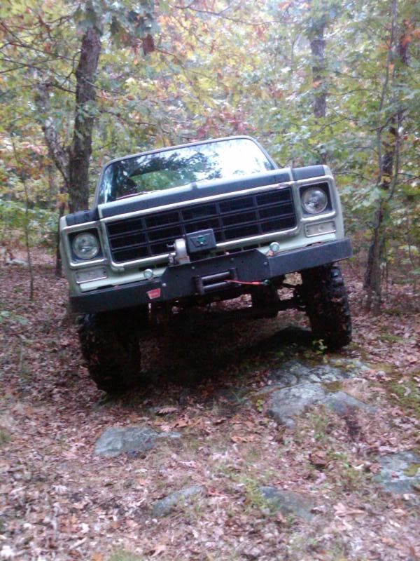

Since I do explore alot on my own I thought a winch would be a good idea. Picked up this 8274 with warn bumper $500. Compleately rebuilt the winch for good messure and bolted it on.
Then wheeled it that way up untill a few months ago.

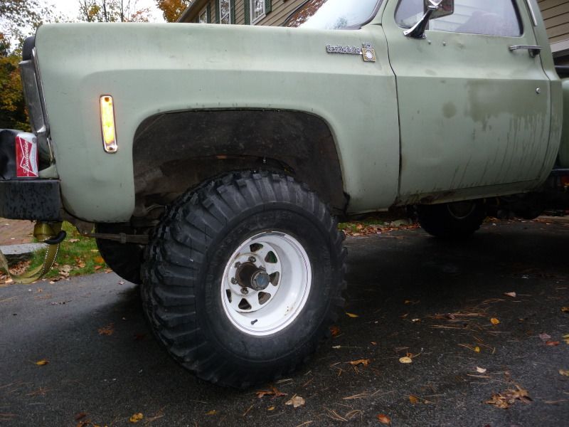

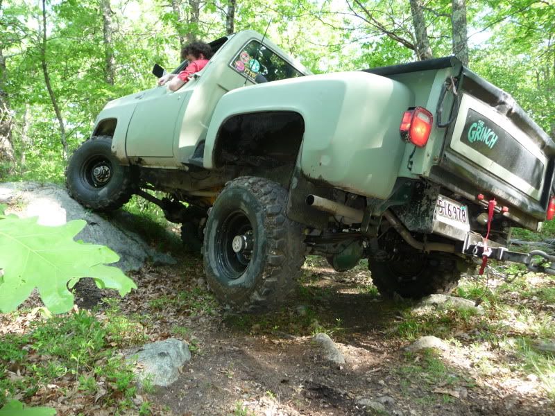

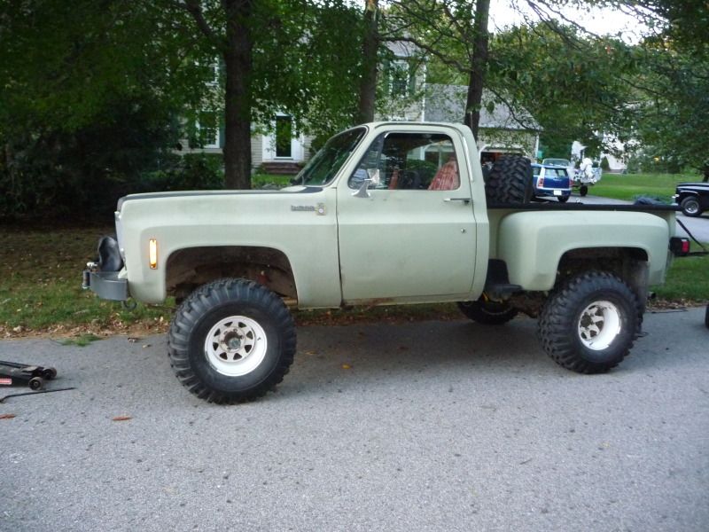

Scored a good deal on some 35x14 gateway gumbo monster mudders. Little wider then I wanted but the tread is 90% since they were on a mudrun truck and never saw street use.
rims have 4.5 back space and the rear clears fine but the fronts rubbed on the street so I did some minor fender trimming.
In addition I got a set of 4 EZ inch from Diy4x and a set of longer u bolts and new bilstiens from ORD.

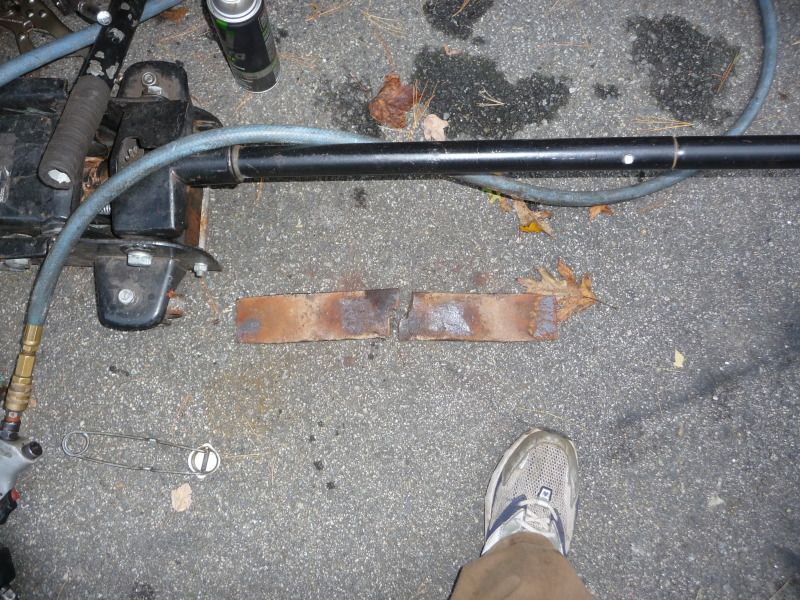

Found this nice suprise when I took the front leafs apart
Removing the bottom leaf from both ront packs actually makes the front ride alot softer which is nice!

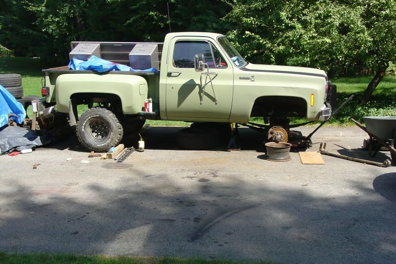

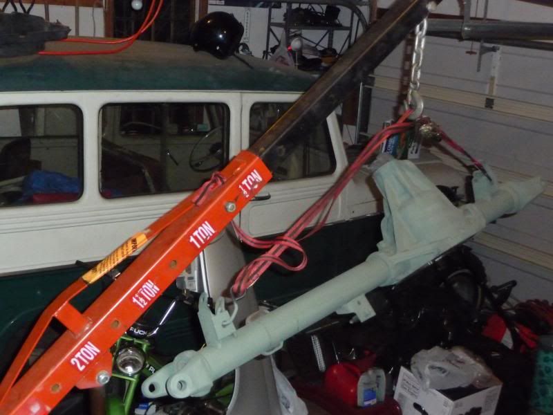

Time for an end of winter update....

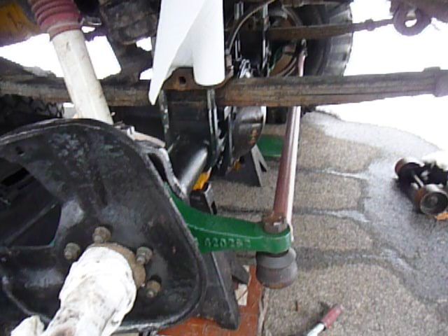

The guy I got my turbo 6.2 from was selling the axle out of the pig. I got the 10 bolt front and 14FF with 373 gears and open diffs for $200.00. The same time I picked up a 10 bolt from Rich in Ma. His username escapes me but he was a cool guy and I got his old 10 bolt front for free.

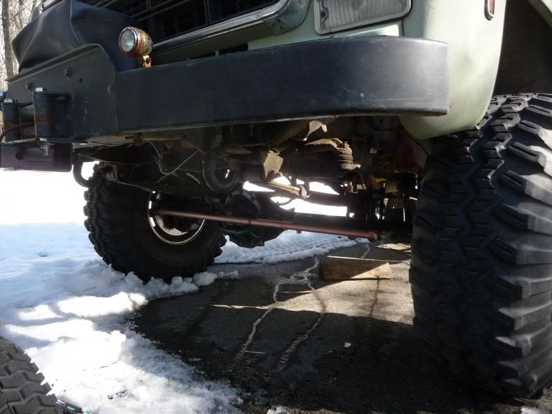

So I stripped down the Military 10 bolt as it had bad BallJoints and the wrong gearing
Using the parts I got from the 85 K20 I Converted the front to eight lug, put in all new Moog ball joints, installed the 3:73's, my front lockright, the better tierod, and proceeded to grind the calipers and brackets to fit 15's

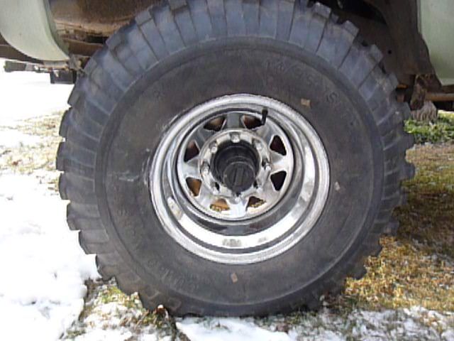

Grinding the backing plates and calipers was a PITA. I hate how wide my wheels and tires are and am NOT a fan of chrome. But I am outta money so these will stay untill I scor 2 more 16's and a set of hub caps.
15x10 chrome wagon wheels with 4 inch BS and 35x14.5r15 Gateway Gumbo Monster Mudders with near perfect tread but weather cracking
Also used warn full turbn hubs as my superwinch hubs stripped out....:rolleyes::rolleyes:
Finished front axle. Clear coated the military diff cover because it was kinda cool with the stamped date and all.
And I gave my 14 bolt a quick shave. Every little bit helps with these anchors.
I also got a set of 56's with the axle I plan to install this spring. I am saving up now for a yukon grizzley or Detroit for the rear. Then the Drive train will be finished for a while and I will get back to swapping in the 6.2 diesel, fixing the cab, Paint, And this project will be for the most part DONE!
