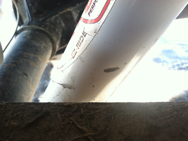

All this shock talk reminds me, the other day I noticed marks on my rear shocks from where they made contact with my leaf springs.
I thought you just replaced your spring eye bushings. Seems like that should prevent the springs from moving around too much. I wonder why the springs are contacting the shock bodies.
Something is loose. Either the bolts for the springs or the shocks or the u-bolts or the bolts for the shackle flip.
I'm sure bobbing the bed will cure this problem.
