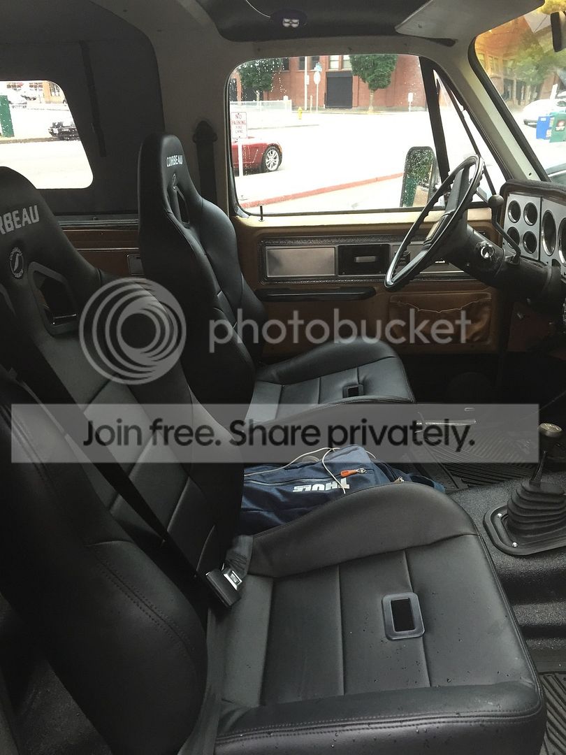

Not too much to add but I got both seats finally mounted. Anyone thinking about ordering for corbeau... be warned. The seat "brackets" are complete ****. Nor do they care that they are ****. The driver's side was not too bad but the passenger side was not close (had to drill new holes), you lose the "tumble" feature, and they are not well made. I knew I should have fabbed my own but was really hoping to save a bit of time using there "direct fit" brackets. Complete waste of money. I tried to be patient with them and give them the opportunity to make things right but they could really care less. Oh well, lesson learned.
That being said the actual seats are quite nice and seem to be good quality.

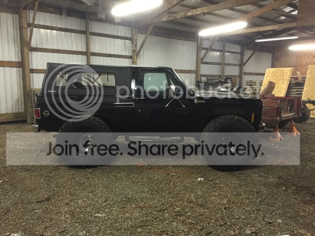

Also leaned the tires on the Blazer for sh*ts and giggles.
I prefer the stock seats.
Martin
I didnt care for them to be honest. Too low, wrong driving position, and kinda ugly. Too each his own.

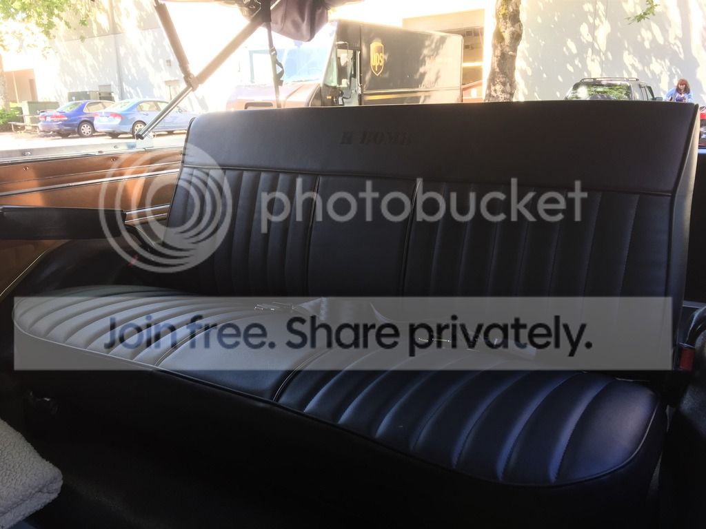

The rear seat is at an upholstery shop being done... I did have them keep it somewhat "stockish" looking although the material is going to closely match the Corbeau seats but in a "stockish" stitch pattern.

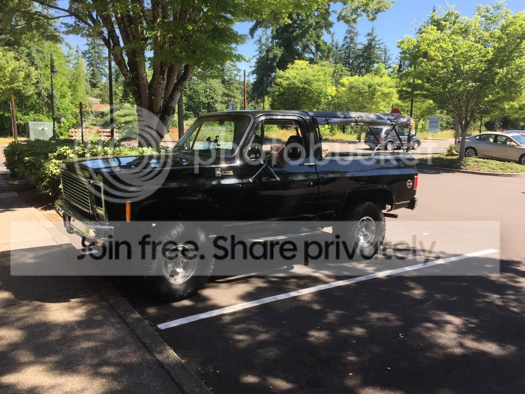

Man, that thing looks too nice as it is to hack it up and make it a crawler. Can I persuade you to get one in rougher shape to build out?

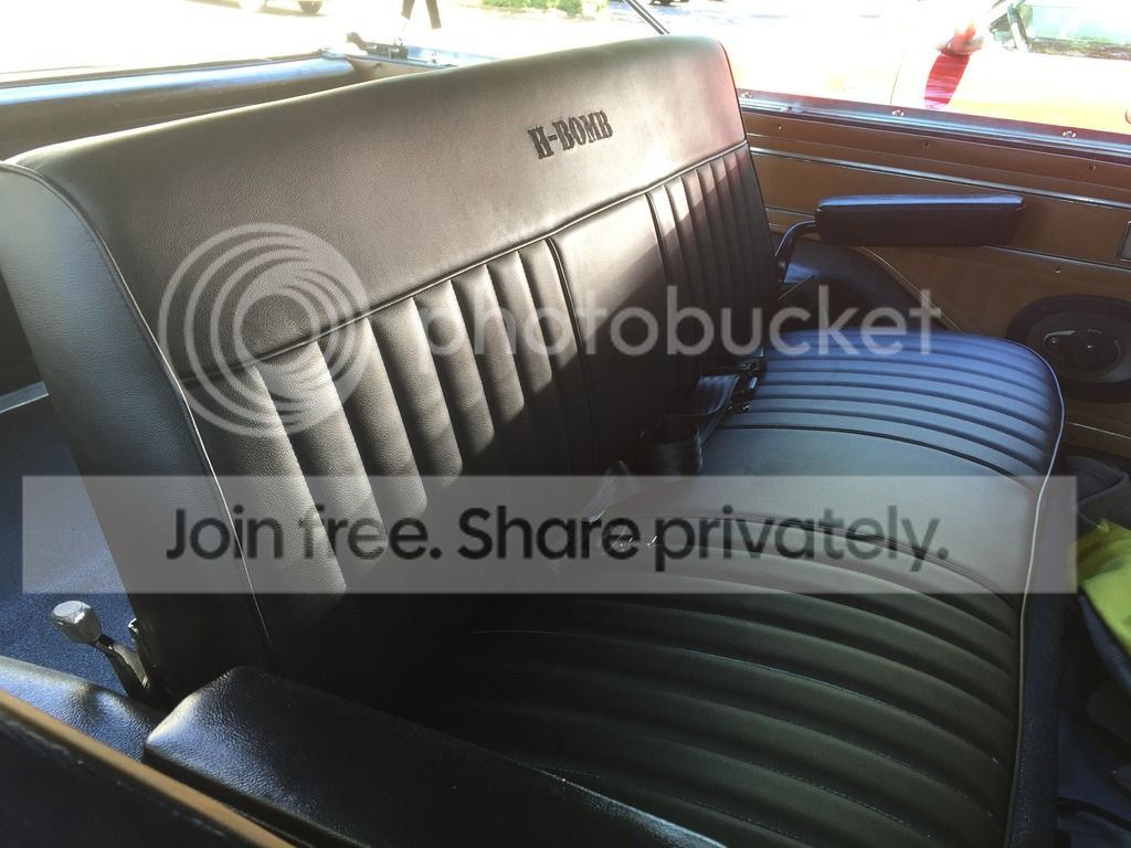

Just picked up my back seat. Great job by Beaverton Upholstery here in Oregon. Couldn't be happier with the result:

Lol, that's what the guys at the upholstery shop just said. People keep sayin' that. It's giving me a complex on what I should do with it. :doah:

back seat looks bitchin BTW
