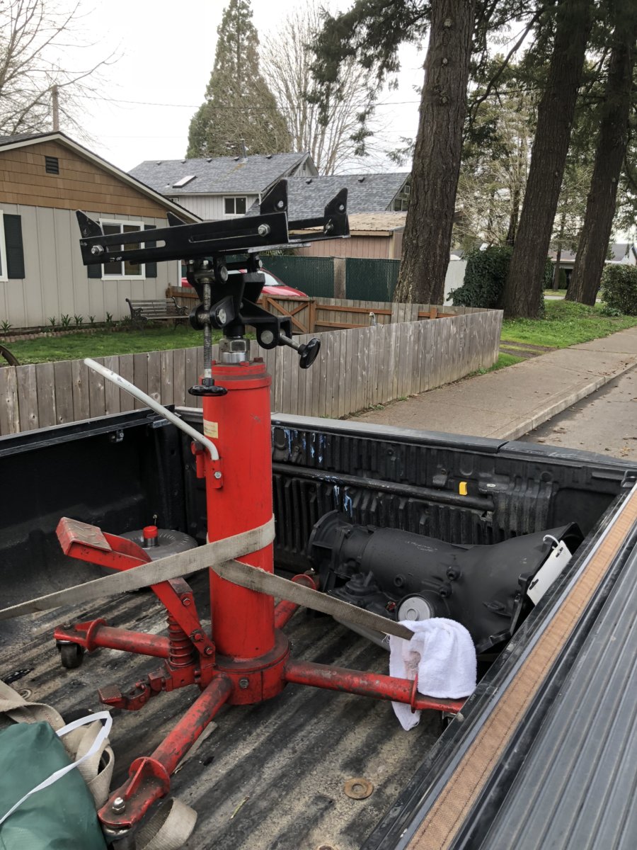

Picked up the 700r4 and scored a nice jack. The transmission guy upgraded his equipment and this was his “old one”. I happily took it off his hands to free up his shop space. :)
full
full
You're gonna need a lot of crib blocks to get your truck up high enough to use that thing!
