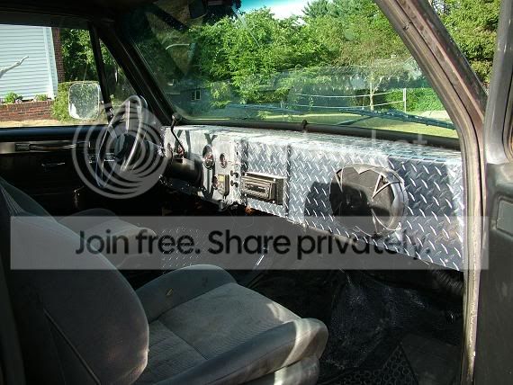

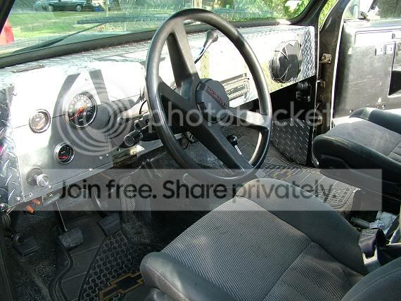

So the plans are to build the 79 pick up into what I had before.
For reference:
So im taking the running gear from the 91. Tbi 350, 465,208, locked 14bff, 10 bolt, 4.10's
Im taking the tires off of the 84, along with the front clip/ bumper.
For suspension im using the Rough Country 4" front springs, 1" aal and corrected shackle angle. In the rear im going to do a flip with usdr shackles, and 56" springs, 1" aal.
For the interior im gonna run bucket seats, bedliner the floor and eventually build an aluminum dash, much like my old one.

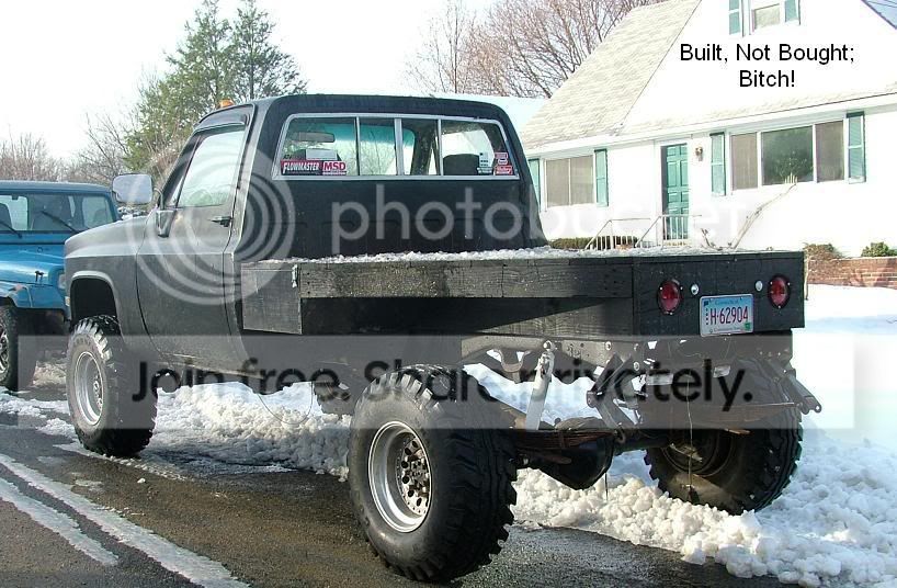

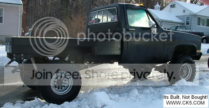

Yea it is. I only have one other pic on this computer, i might be able to find more on my parents
I used 2x10's for the main runners, deck boards on top. The front of the box flipped open. Fuel cells, battery and storage were under it.

Quick ? on the dash - How does the DMV feel about you relocating the VIN plate? I think if I did that here, I might get in hot water..
rr
To be honest I never really cared. No emissons no inspections. I guess I could leave the vin attached to the metal dash and work around it but I didn't feel like it.
