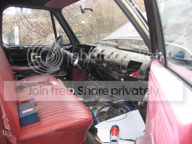

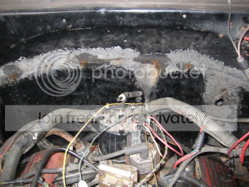

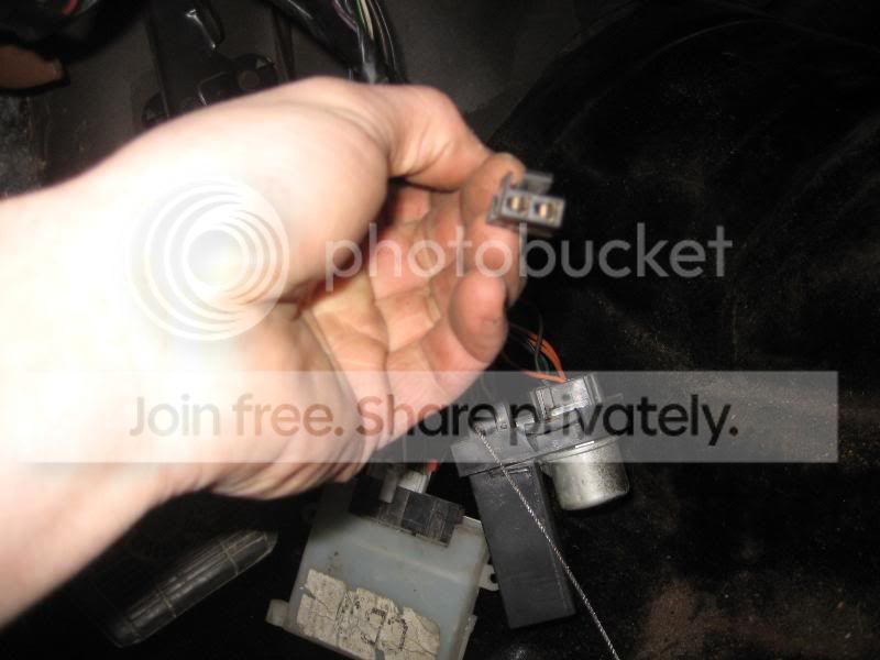

Ok so really the only things i have questions on are the gray wire in the second pic, just a single spade female connector, and the second half of the coil. I cant see any wires missing on the harness itself... Isnt that second connector part of the main harness? Also, where do those wires go to, if i had to splice it in?

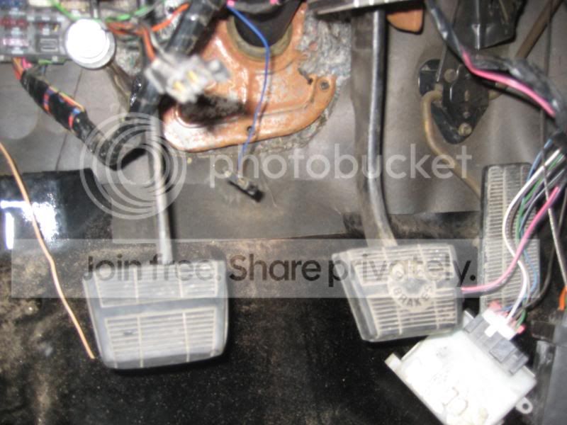

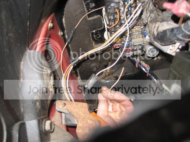

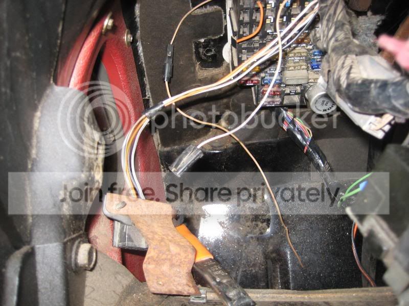

Well more questions now:doah::haha: Few more connectors, a few in the cab, one in the engine bay. I don't think they are anything important. I did cut a bit of the harness out that went to things I knew I wasn't going to use, so I don't remember if these are needed or not:crazy:
This connector has a single tan/ white wire
This wire is cut and is all tan (it leads to that connector in the back of the photo)

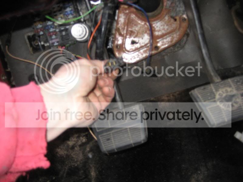

This connector has an orange and a black wire going to it, Black is striped with white, and the orange with a black stripe.
This connector has a pink and a purple wire going to it
This connector doesnt really look factory, has a single blue wire going to it
Heres the one in the engine bay, single round connector
wow someone needs to lable more next time.
last pic might be the o2 sensor wire. is it a purple if so its o2.
Label, no way, I have mind like a steel trap!:crazy: O2 sensor wire is right:D I still cant for the life of me figure out WHERE THE HELL the other connector for the coil went:confused: What does it get wired to?
the tan/white wire is connected to your ebrake idiot light.

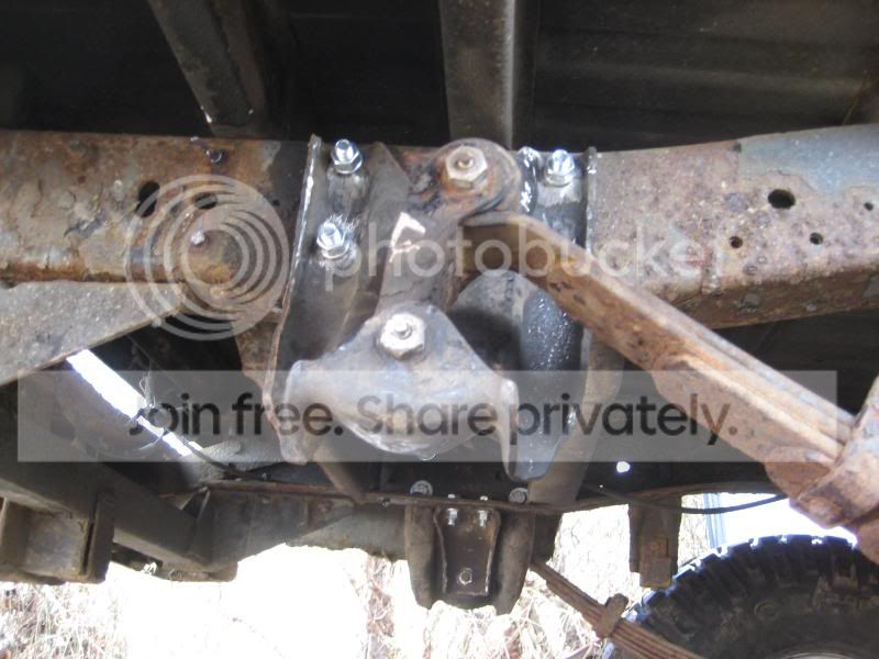

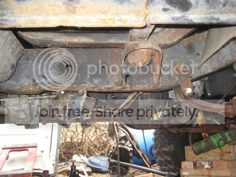

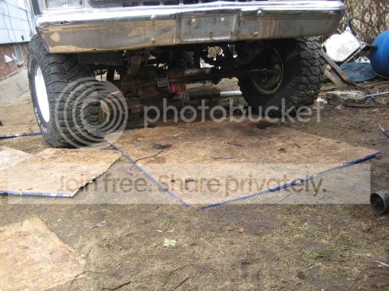

So I got ALOT of work done this weekend. Axles are in, springs are in (these are temp springs, until I finalize the suspension. Tranny and t case are in. The rear driveline is measured up. Hydro clutch is installed.

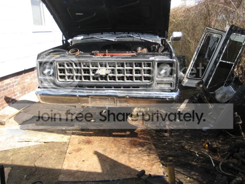

So what exactly are you using off of the blazer I sold you ? I see you put the tires and rims from the scrappymoble onto your truck. Did you say you were going to put the front clip and bumper onto the truck ?
what are your plans with it ?

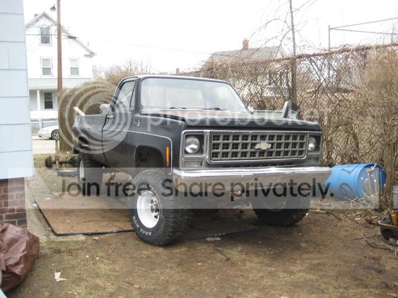

yup front end and bumper, still got her sitting complete out back.
Mike, gonna try... thats if its done. well see though:crazy:

Got some updates for you boys. 4 working days into the build
Truck is down to the frame, 3/4 of the way coated. Im using herculiner after I strip it to bare metal.
