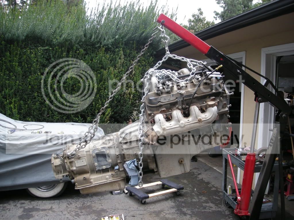

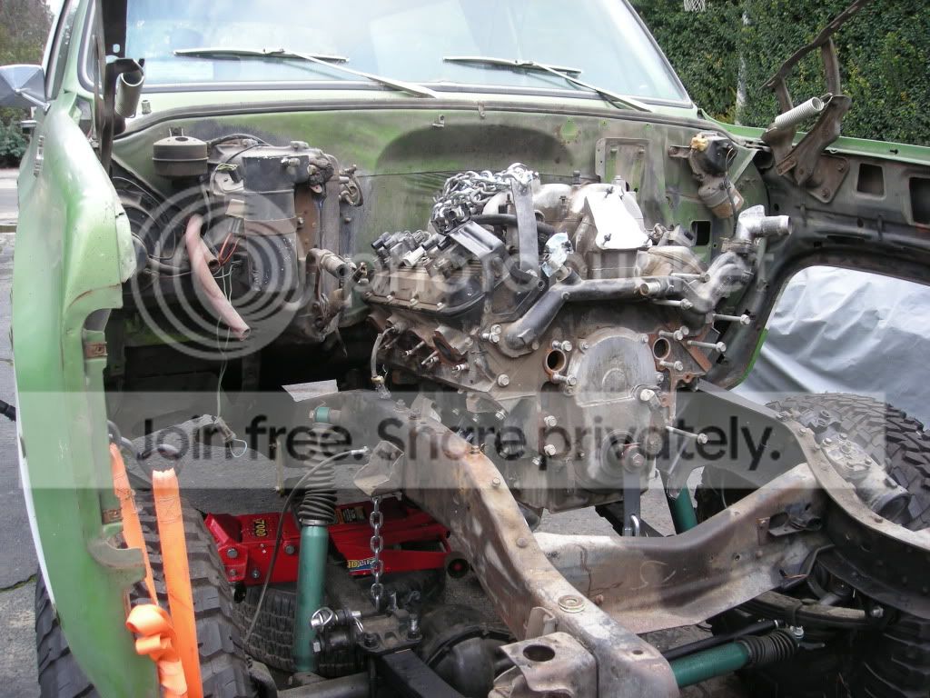

2/7/10 The 8.1 test fit:

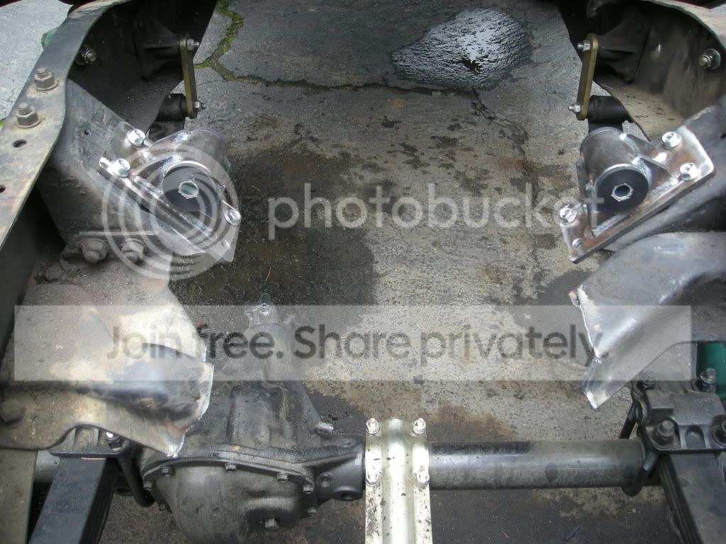

Stock engine crossmember had to come out:
The beast getting ready for install:
Engine installed:

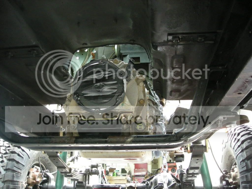

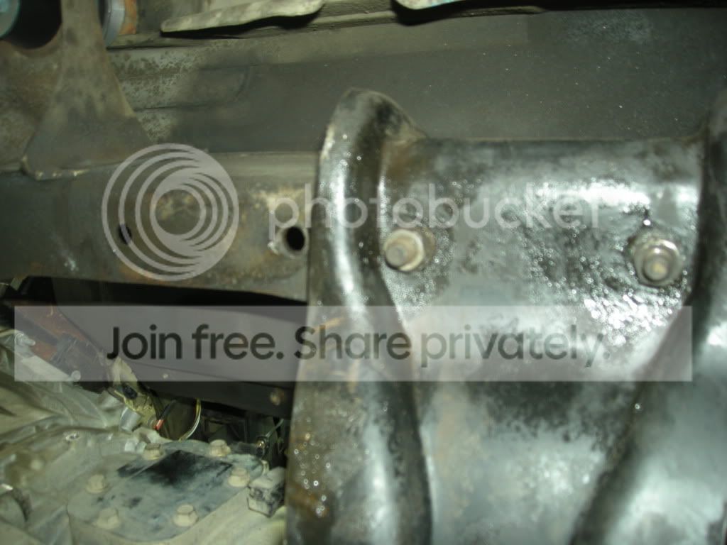

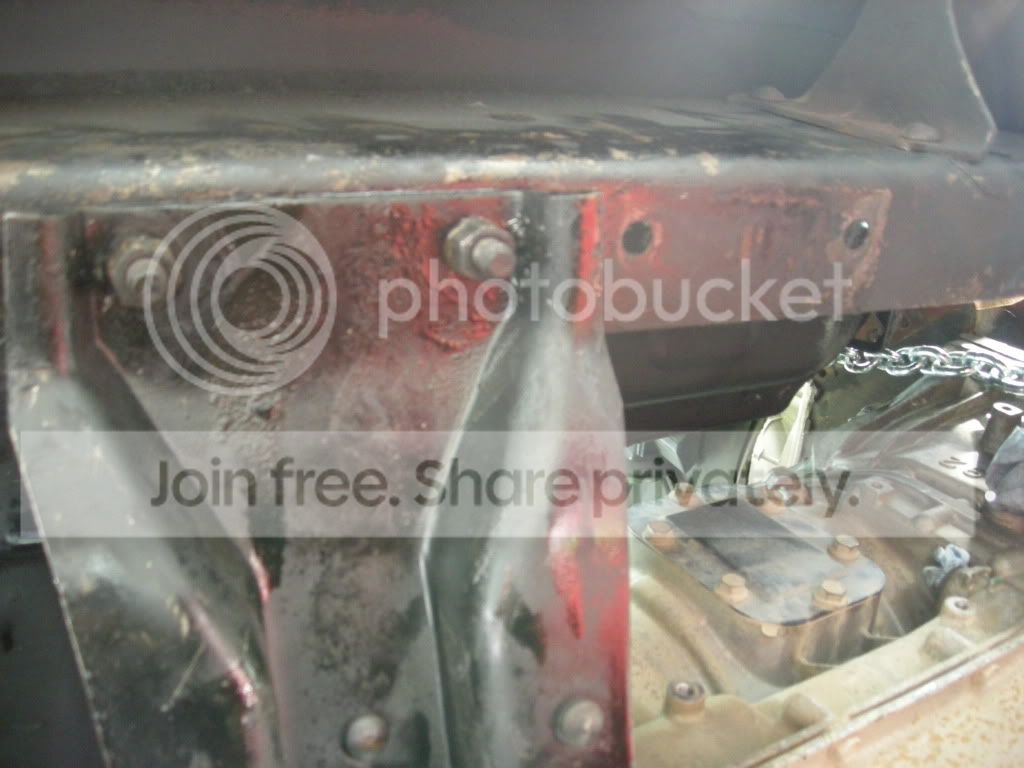

Trans Pics. X-member had to be relocated to the rear. I will need to raise the Trans about an inch. At least the I'll be able to get to all of the sensors.

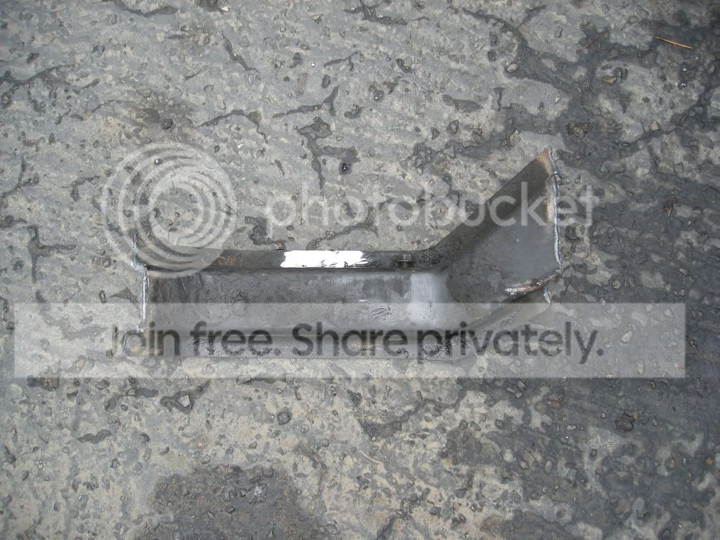

Trans X-member relocated to the rear. Passenger side is the first pic.
Driver Side:

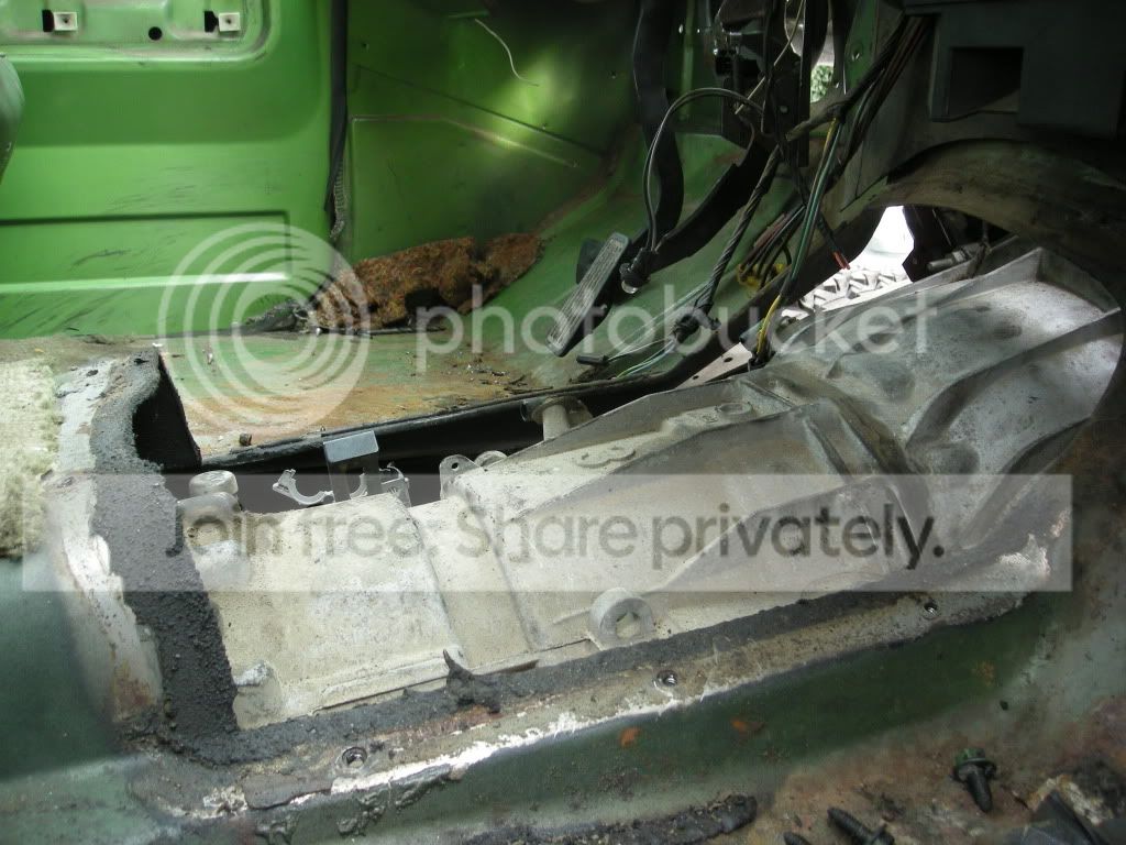

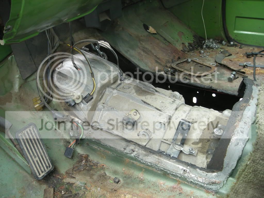

Looks like that Allison trans fits without a body lift or having to mangle up the trans tunnel unless your rig has a body lift on it that I'm not seeing.
Scott
Scott
Just a 1" and new poly mounts from ORD.
this is looking cool.....keep posting up.
I think everything clears so well is because the back of the transmission is so low. That is "tall foot" adapter with a "short foot" adapter. Isn't there like at least 2" different between the two style adapters, even though that mount has a 1" lift already.
Do you think everything would clear without the 1" BL?
It probably would, but, it was a bear to get in the way I have it. Plus you might run into tight wiring issues, especially with the Crank and Cam position sensors. As of now I can get to both fairly easy.
Also as noted on the pictures, the transmission needs to come up about an inch, so you lose even more clearance without a body lift.
Of course you could always hack the transmission tunnel :D, not something I wanted to do.
I will also be going to 16" rims with either 38" or 39.5" tires (not sure yet), so it just made sense to add the extra inch. I'll probably still have to trim the fenders a little, but that's life.
Currently the truck has a 6" spring lift with 15"wheels and 37"X12.5" tires.
