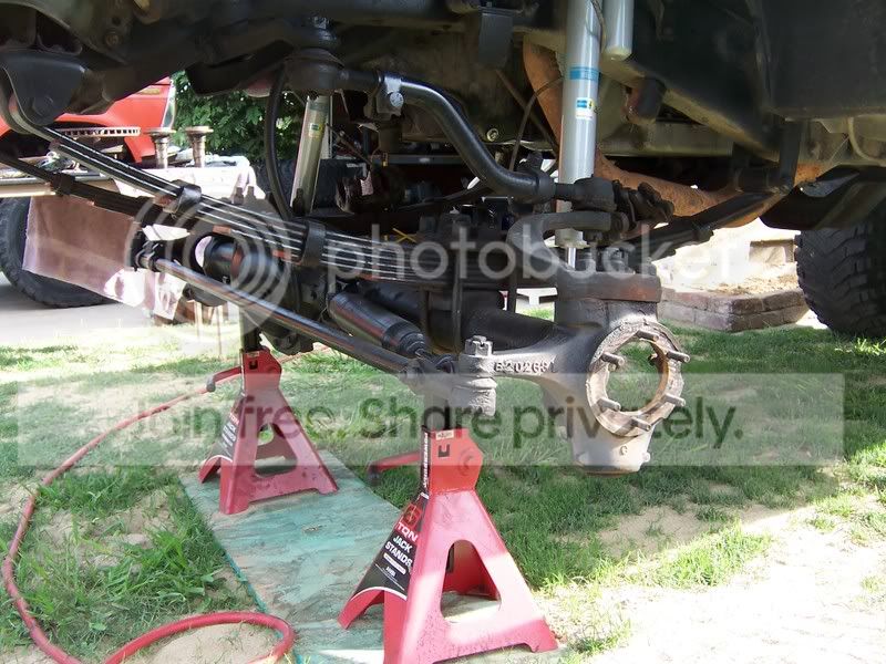

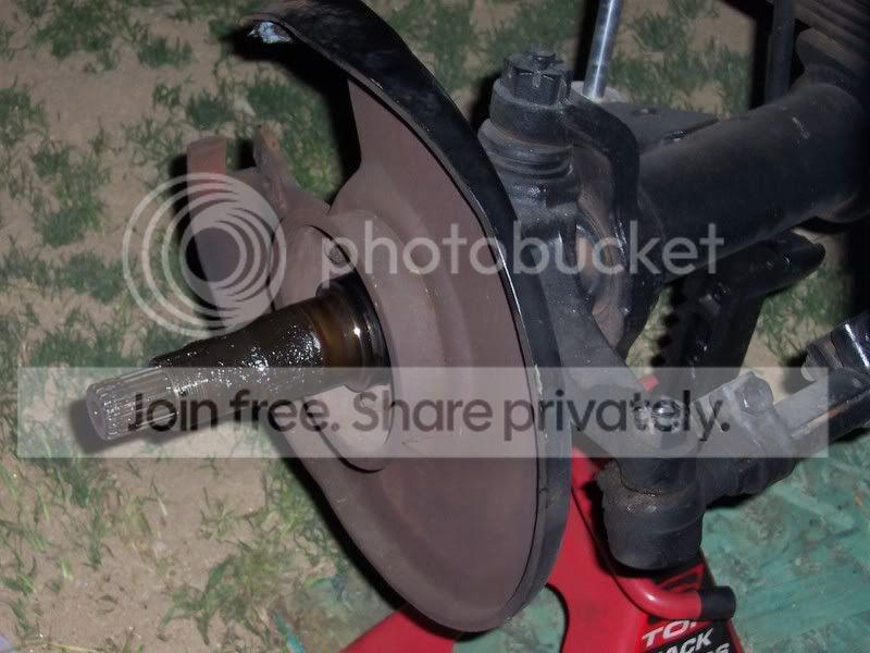

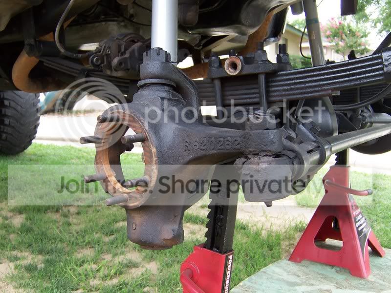

We're going to Pismo (aka Oceano dunes) in two weeks and I'm scrambling to get the k10 ready to be flogged on and something I've been avoiding is replacing my front wheel bearings...
I really had no clue where to start so I did a little research then dove in head first and figured that I could figure it out as I go (at least to get it all apart)...
I did pretty well... this is where I sit as of now...

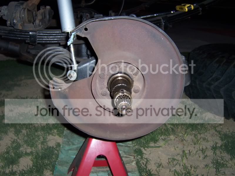

The scary part is when I got to the spindle nut (the second one that's aparently supposed to seat the main bearing in place as well as hold the rotor on) I didn't have the right spindle nut socket so I figured I was done for the night... BUT I decided to give it a little love tap with a chisel...
I kid you not... ONE light tap and the sucker came loose and I spun it off by hand...
So I'm guessing that needs to be addressed when I put it all back together... I'll look tomorrow when I'm at the auto parts store getting new bearings and seals to see if they have a manual for a '78 K20 'Sub since that's what the axles in my k10 are out of so I can figure out how to torque stuff down and get it all seated properly...

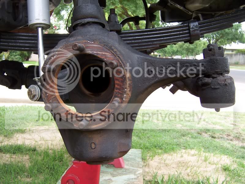

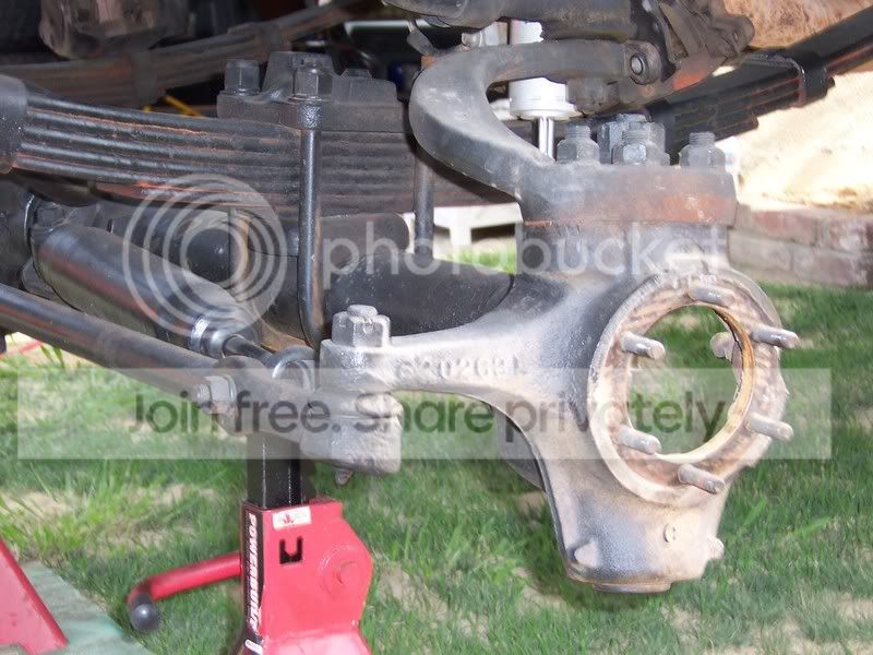

As long as I've made it this far I wanted to replace the front u-joints while I'm at it...
Can you get to them where they are (I know it'd be akward)... or do you have to keep pulling stuff off?
You gotta pull the whole hub off to get to the Front Ujoints. I've blown enough up on my 10 bolt to know.
soooo.... pull the castle nuts off? then how do you get the knuckle to come off? pneumatic pickle fork or does it just fall apart? I noticed the lower nut is on the "inside" unlike the top castle nut that sits on top... I figured there's some signifigance to this...

It's all stripped down now so that's good...

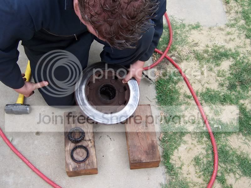

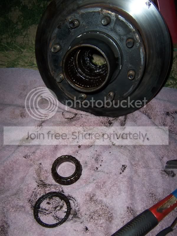

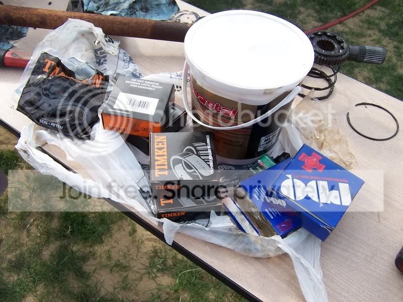

I went to Auto Zone and picked up new inner/outer bearings, and two seals (the one that presses in behind the inner bearing on the back of the hub)...

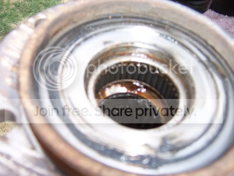

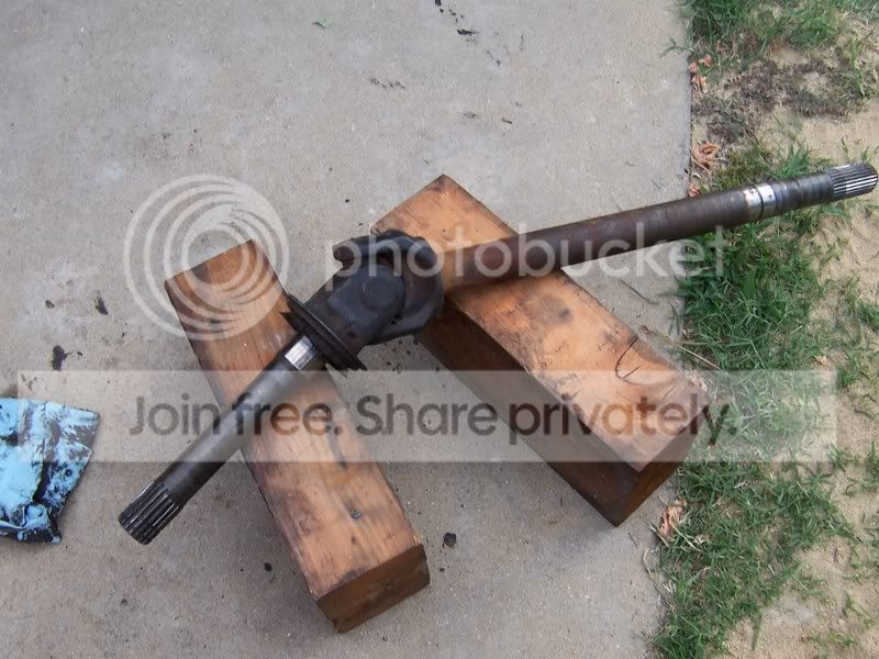

I came back home and tore the other side apart (as pictured above) and when I pulled the spindle off to get the axle shaft out I realized the little bearing inside the spindle was completely shot on this side... so I sent my dad back to see what they could find...
They had one in stock so he snagged it...
This one is in great shape...
But this one from the driver's side is the one that's shot... so luckily they had one in stock...

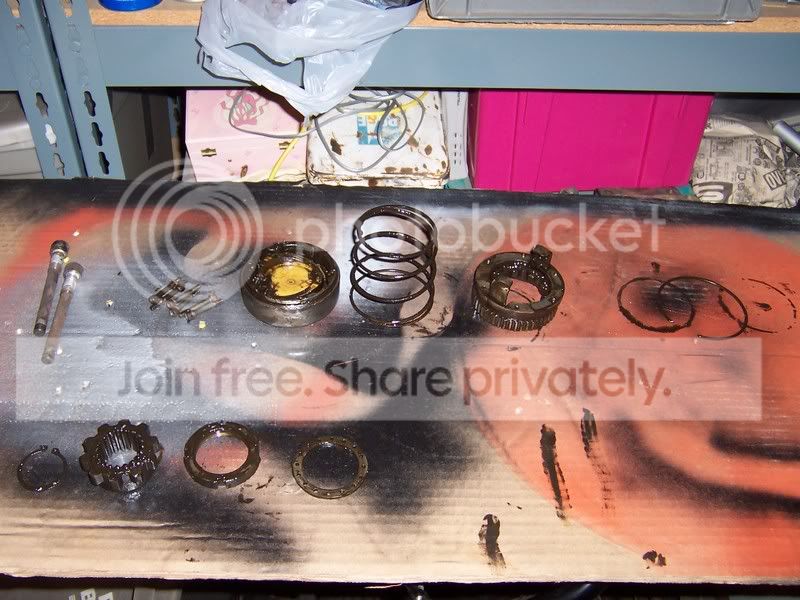

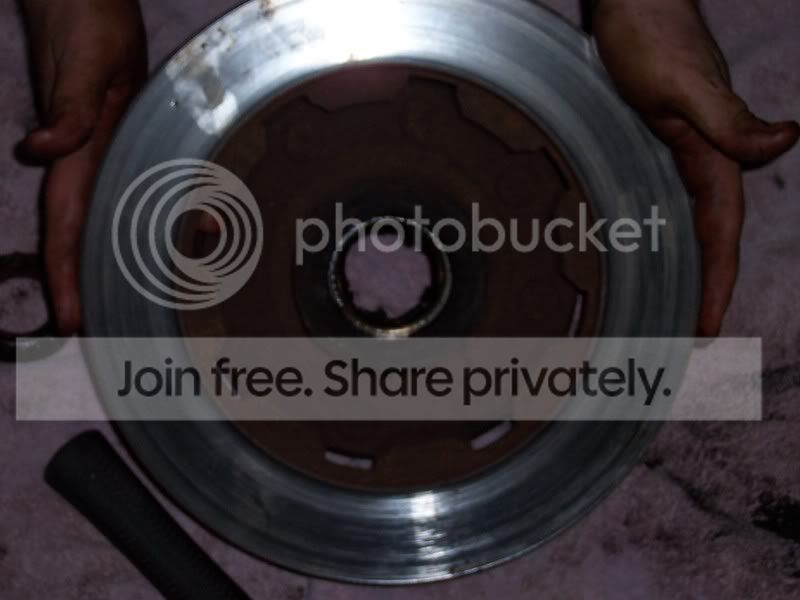

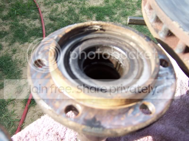

I popped the bearings and stuff out of the hubs but that was about it for today...
I'm waiting on a kit that has 4 new spindle nuts and two "holie" washers as well as a couple of seals... they should all be here tuesday so I can get back to work tuesday night.
So it looks like I'll be good to go... once the parts come in I'll just put it back together in reverse order... pack stuff full of grease and torque it back down as per the instructions bp71k5 posted...

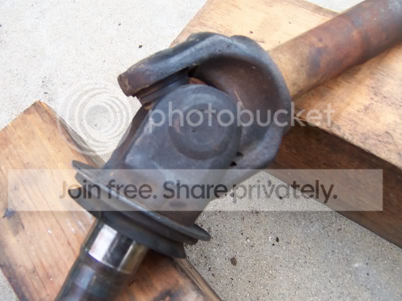

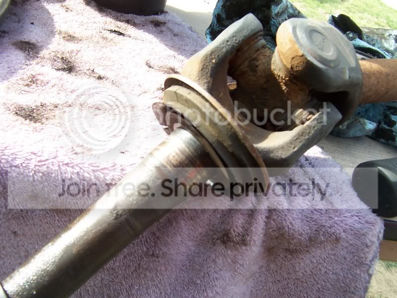

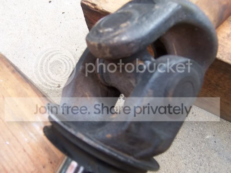

The only thing I can't figure out (or at least haven't messed with long enough) is the stupid u-joints... they're different than the ones I changed out on my front drive shaft. Tips/tricks?
I hear some people say they can remove those easily. It was a pain for me. I gave up and took them to a driveshaft shop and they replaced them for $25 parts and labor. It's well worth it if you can.
they have little c-clips on the inside of the ears, pry that iff with a screwdriver or something and then theyre just regular joints.
