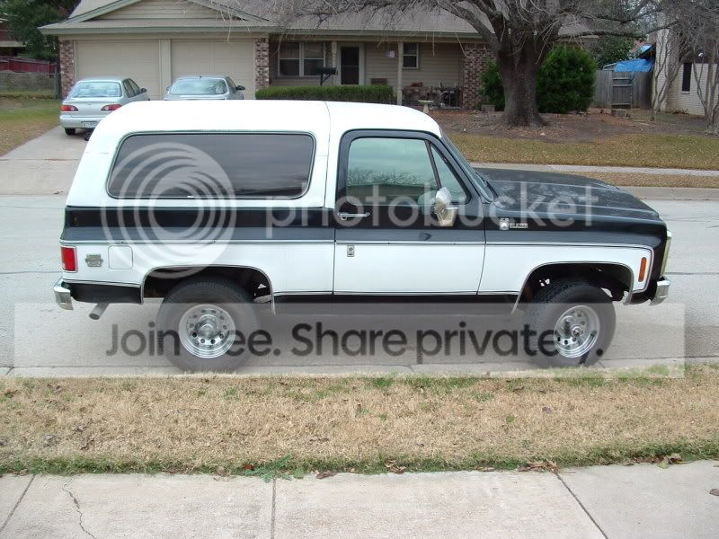

Got some pics up today

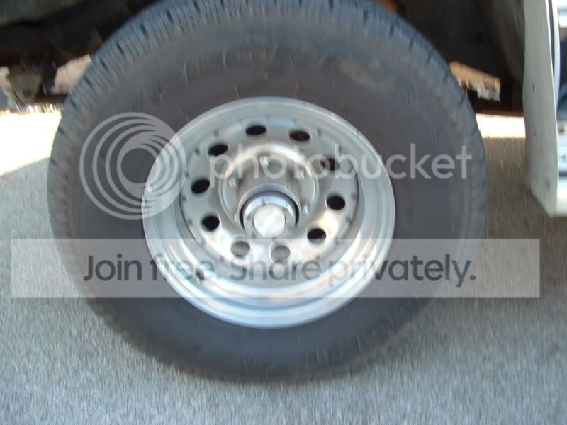

35" tires on 15" rims

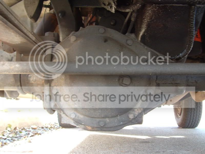

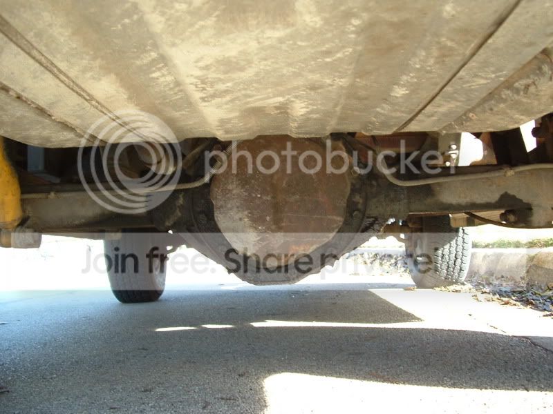

10 bolt front
12 bolt rear

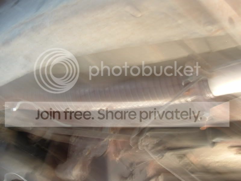

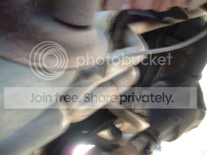

Blurry Exhaust pics

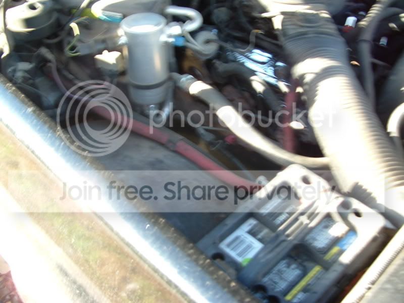

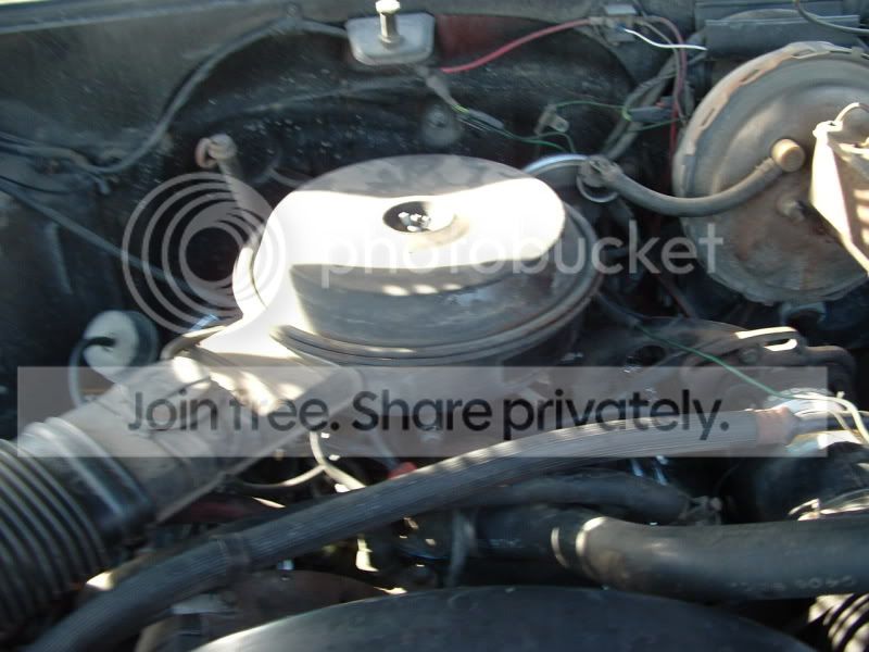

The 350
and a misshot of motor...showing off the new AC that doesnt work :o

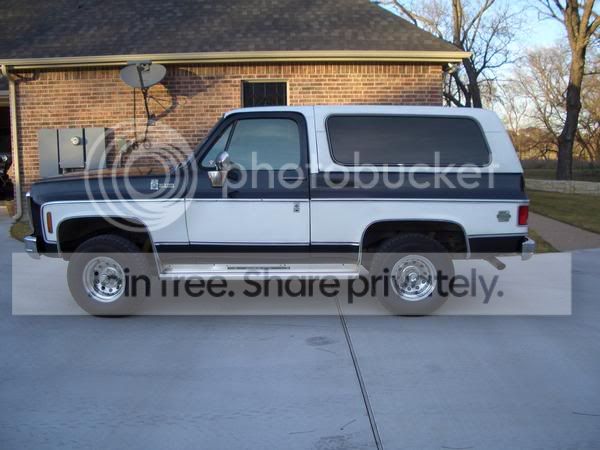

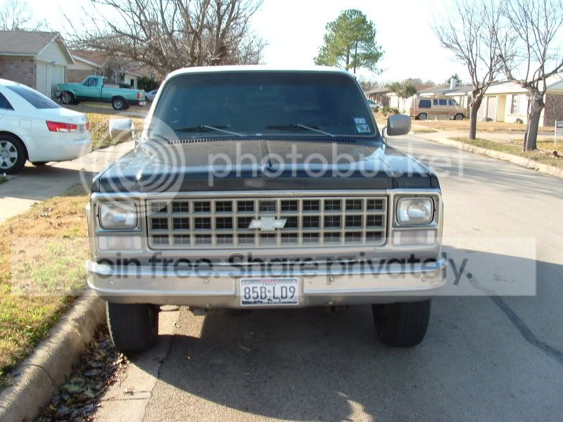

alrighty hows she look now?
:p:
