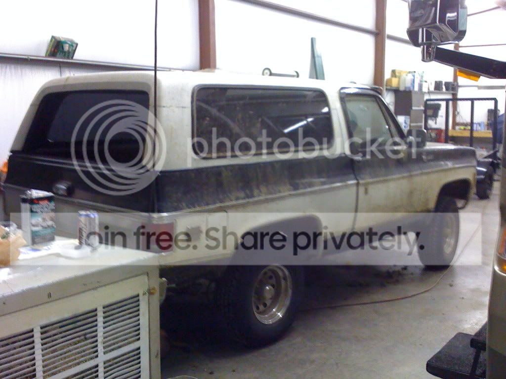

80 K5 Project 454

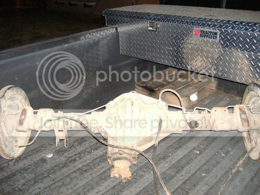

Also where can I find some 3/4 ton axels? and how much would they cost? also how hard are they to instal? andthing online that would help me?
First of all you need to do some research! Someone already answered the question you just asked IN THIS THREAD! I would stick with a 1" body lift max. You can find axles on craiglist. Even with 9" of lift you are going to have to trim some fender with 40" tires unless you drive straight down the road and don't flex. As soon as you turn and start flexing your front tires will rub some. Anyways your rig looks great! Look into doing a spring swap and shackle flip. I would go with 1 ton axles if you can afford it.

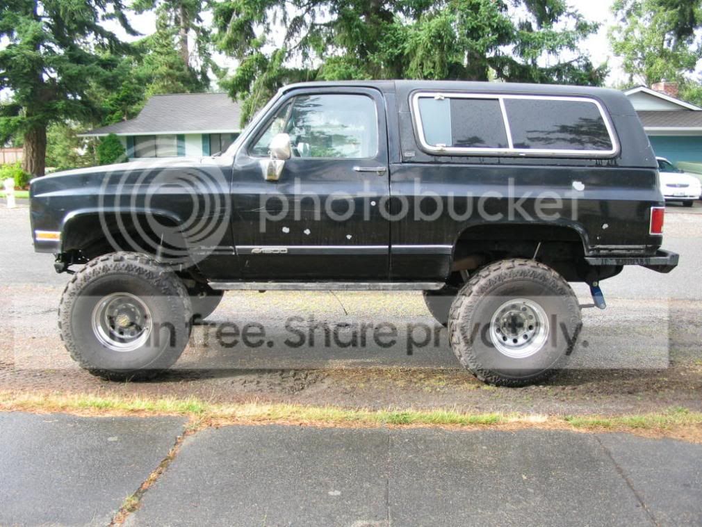

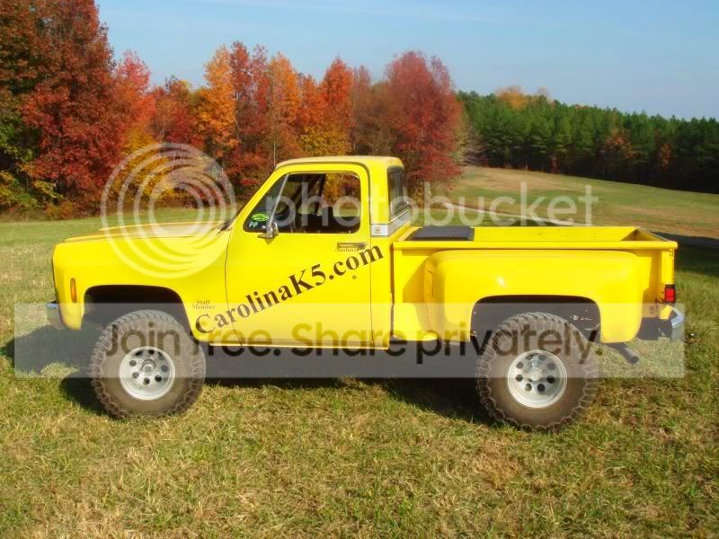

It doesnt have to be hacked or drastic cutting, but you will have to lose the rea part of the front fender, and as I mentioned above if you move the front axle forward it will help with the rubbing too, but then you have to cut under the park light as well.

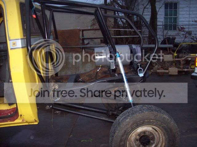

Here is mine with the front axle 2.5" forward and ~5" of lift with 37's. They dont rub except maybe at full stuff when I'm turned. Before the axle was 1" forward they just rubbed on the inner fender.

Does it matter what year of vehicle I get the axels from? or is there a certain type of vehicle/year?

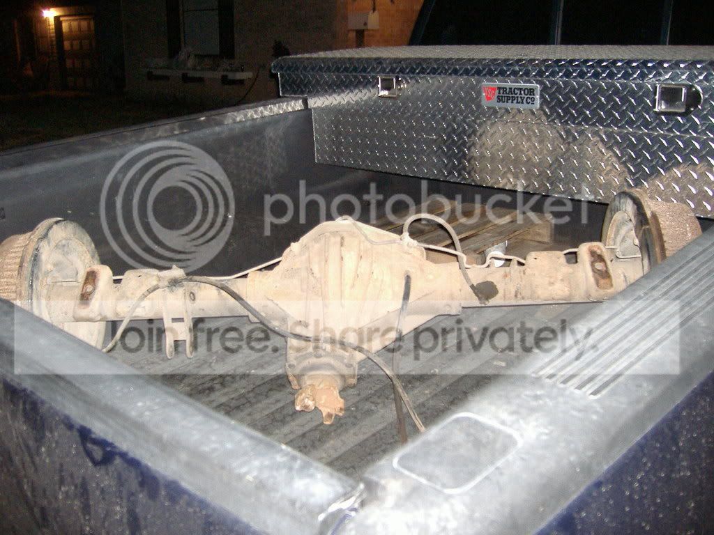

also I should get 1 ton preferably if not 3/4 ton correct?
I would go with one ton stuff. All I know as far as years go is you want to get a 1980 or newer SRW D60 in the front. I would say anything from the 80's or newer should be fine.

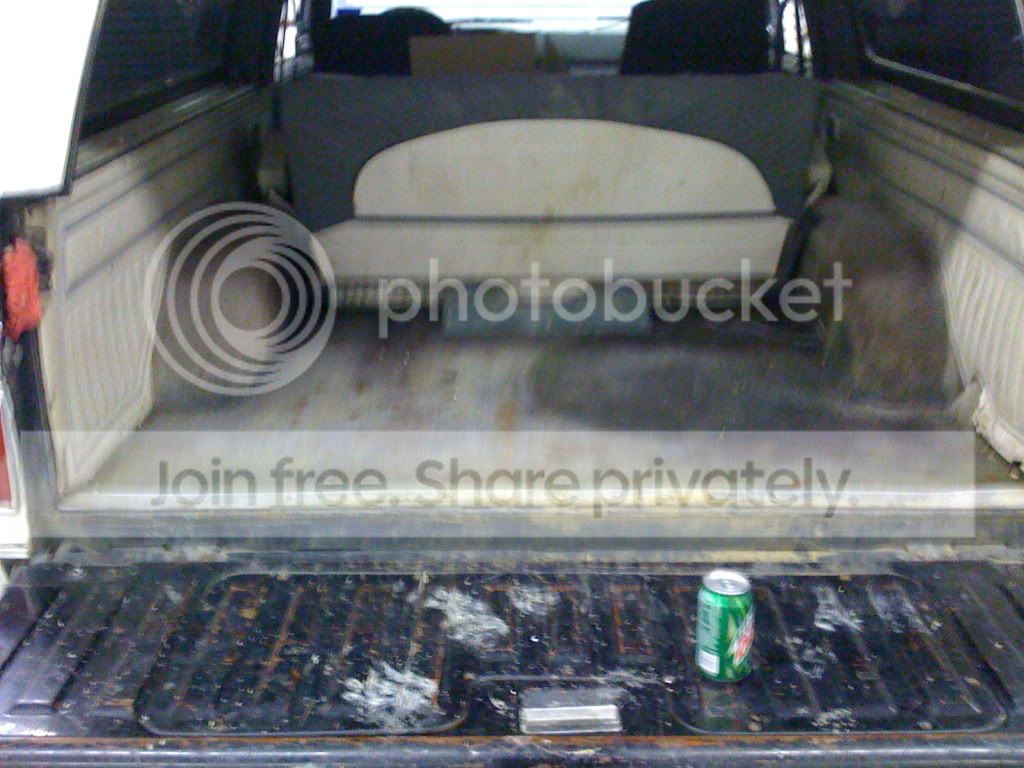

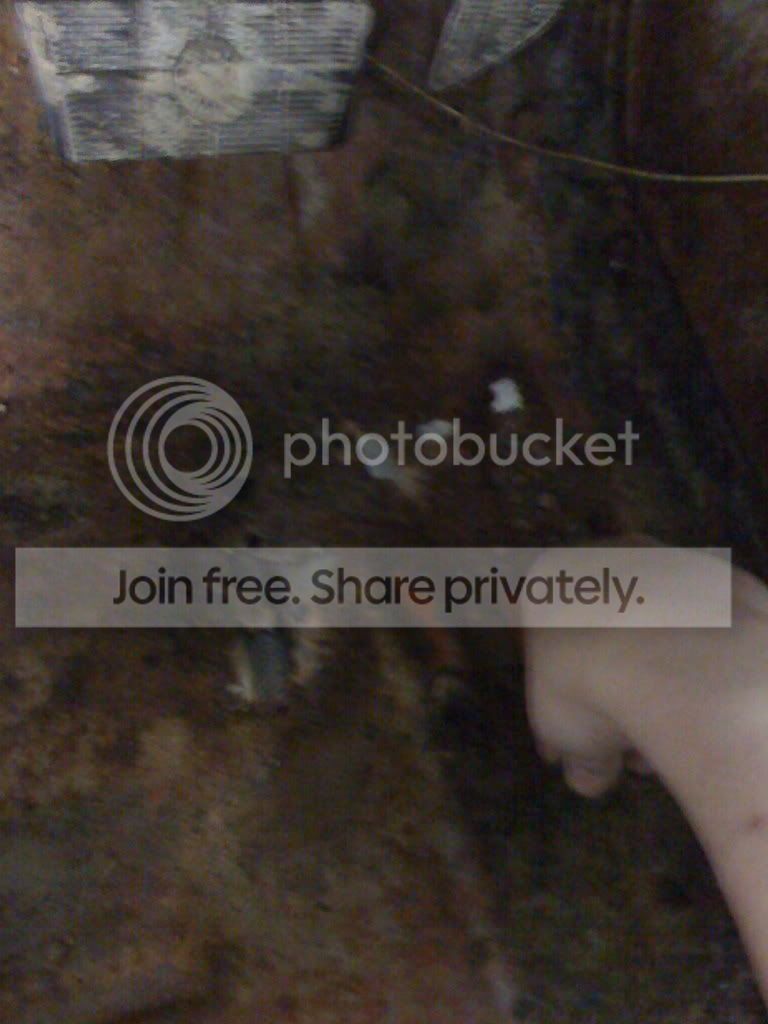

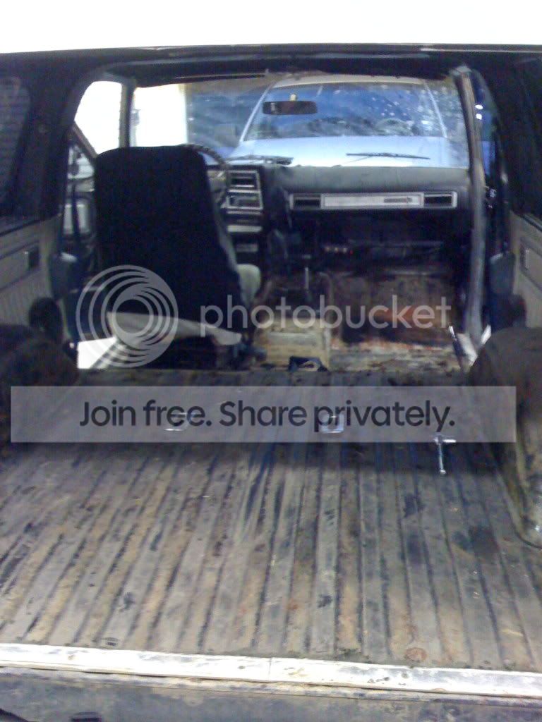

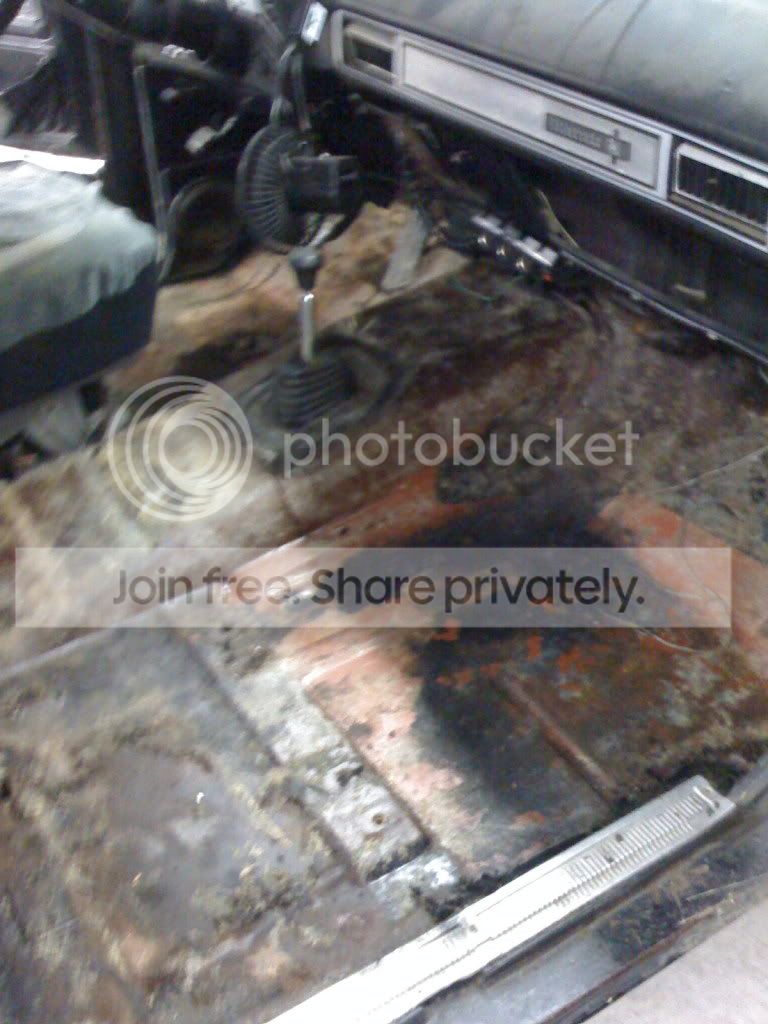

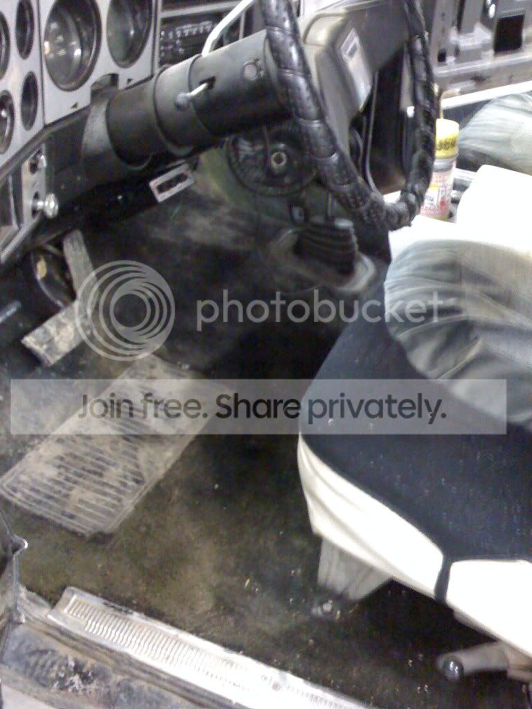

Nasty Carpet

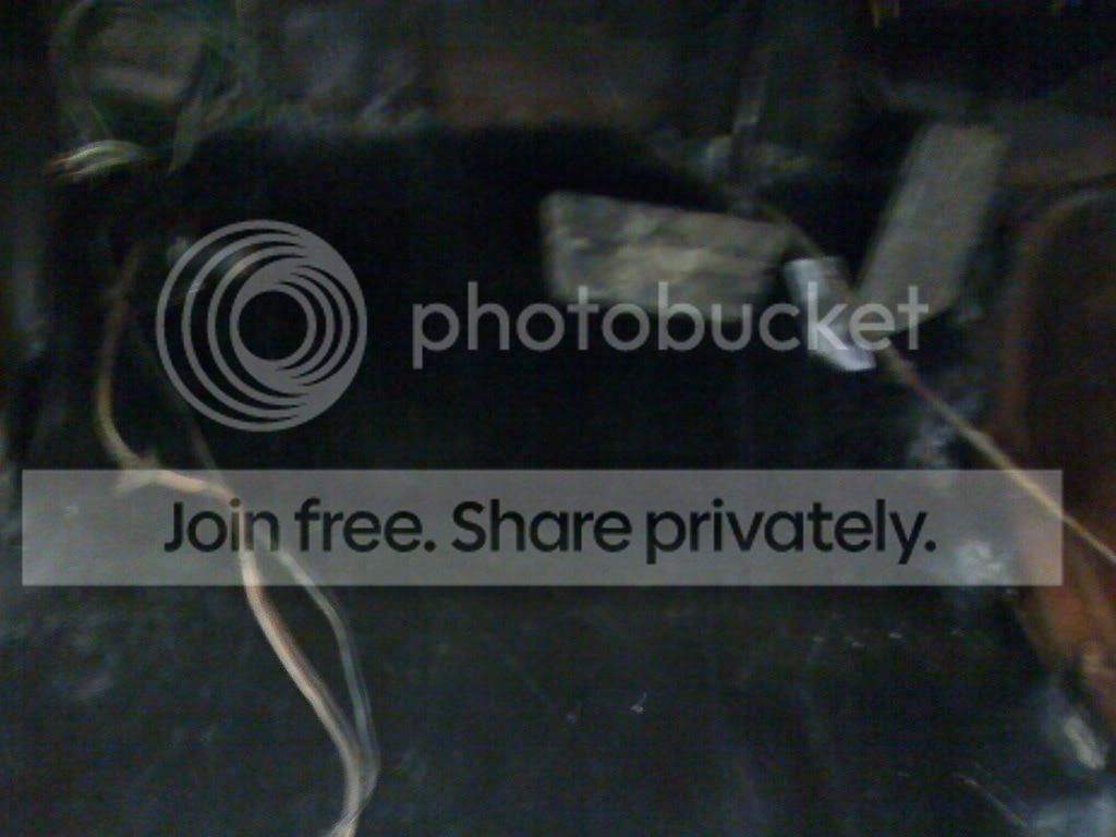

Carpetless

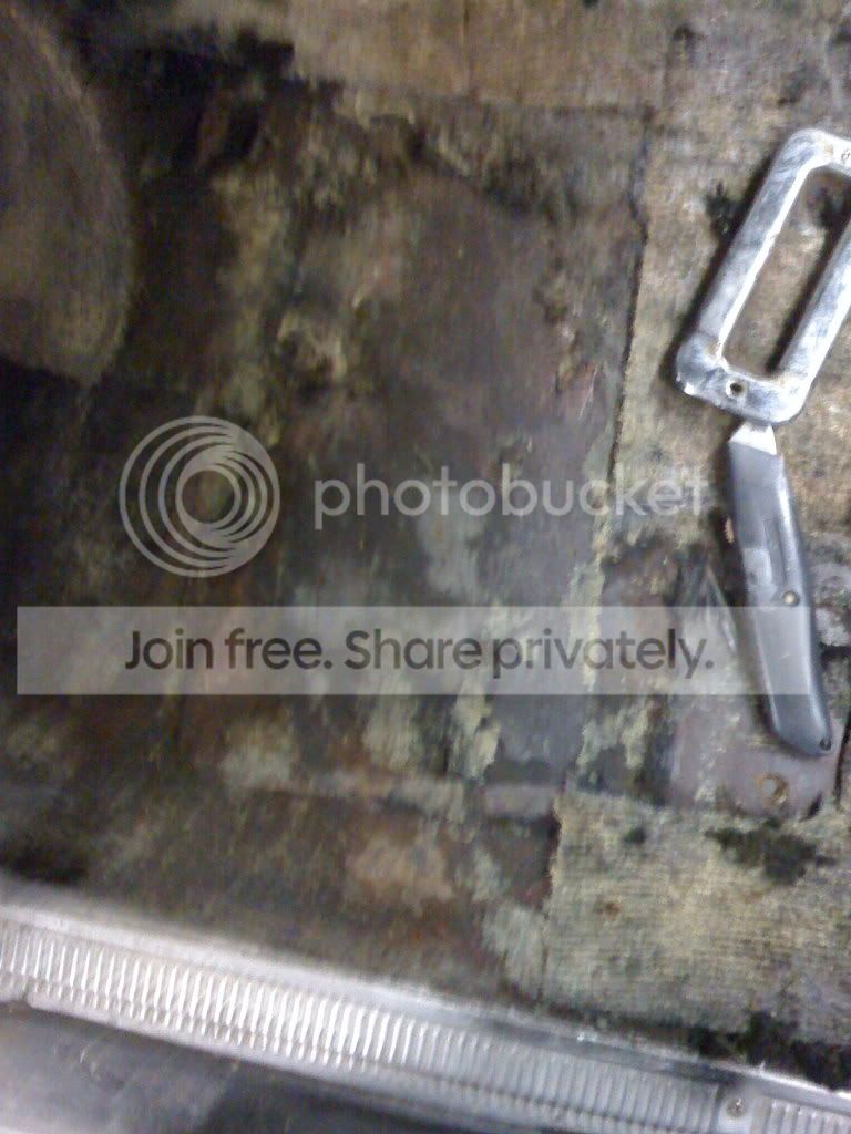

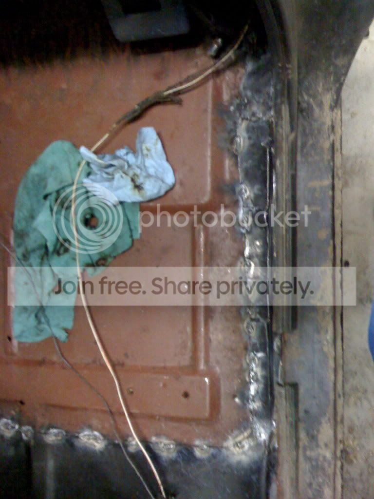

Rust

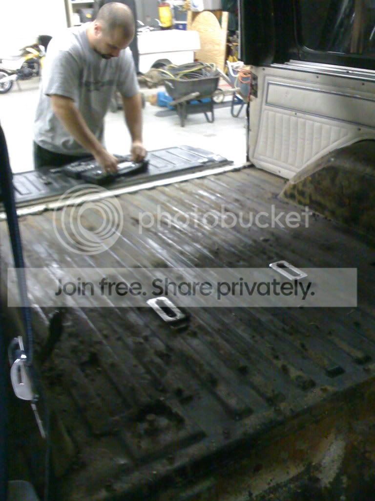

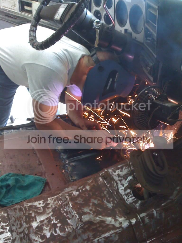

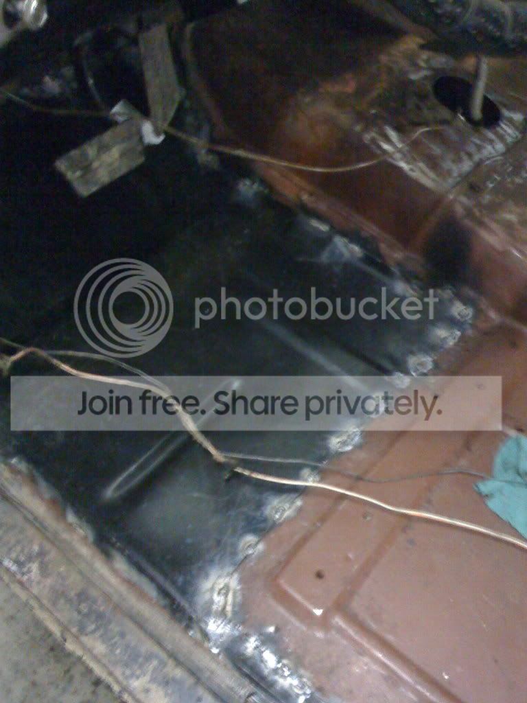

New floorpan and my pops :bow:

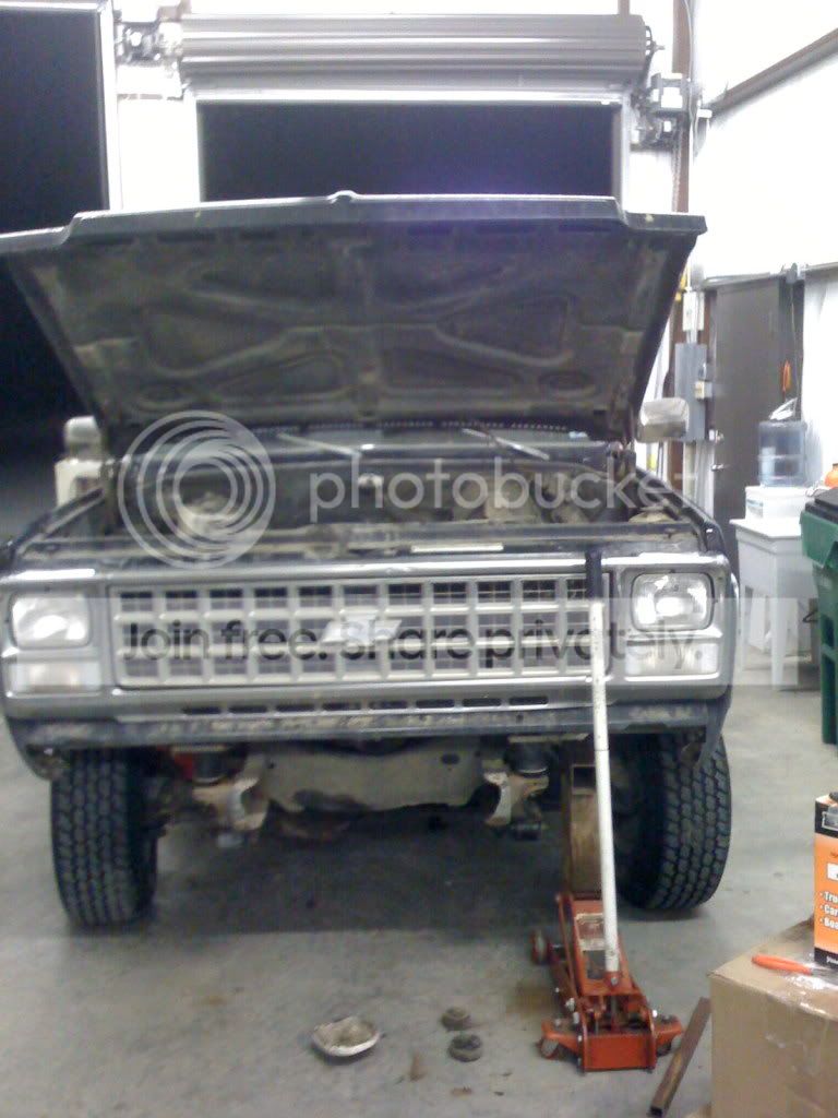

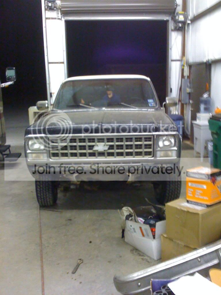

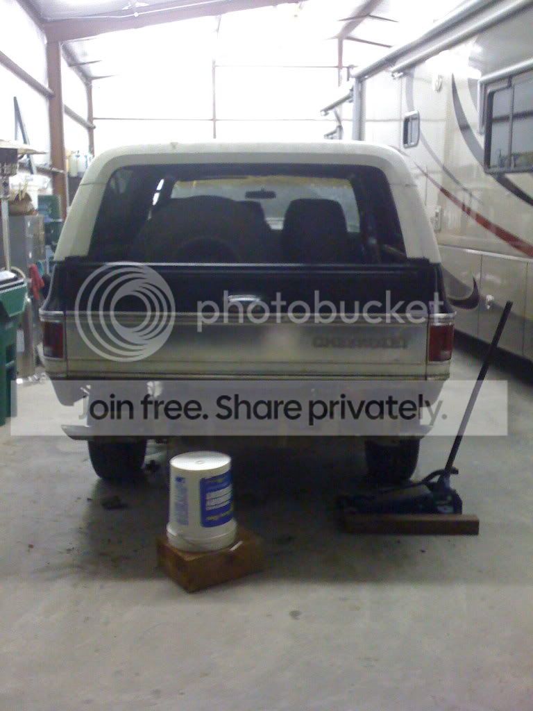

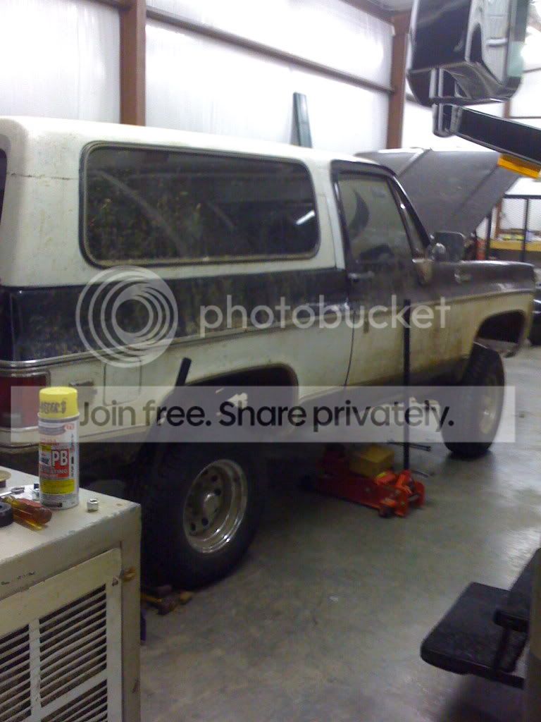

Body lift time :D
Pre-lift

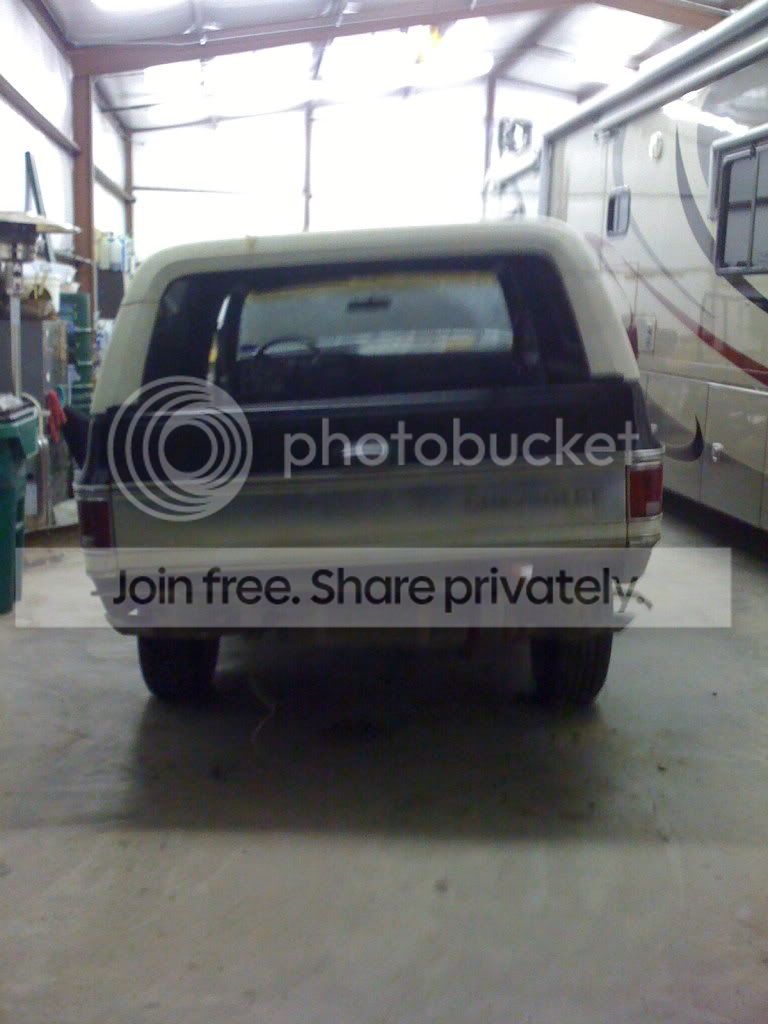

Post-lift
Half-lift:confused::haha::haha:

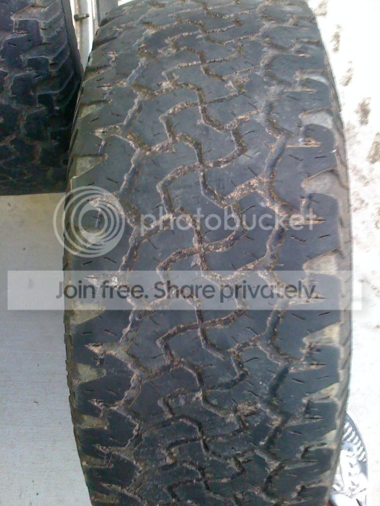

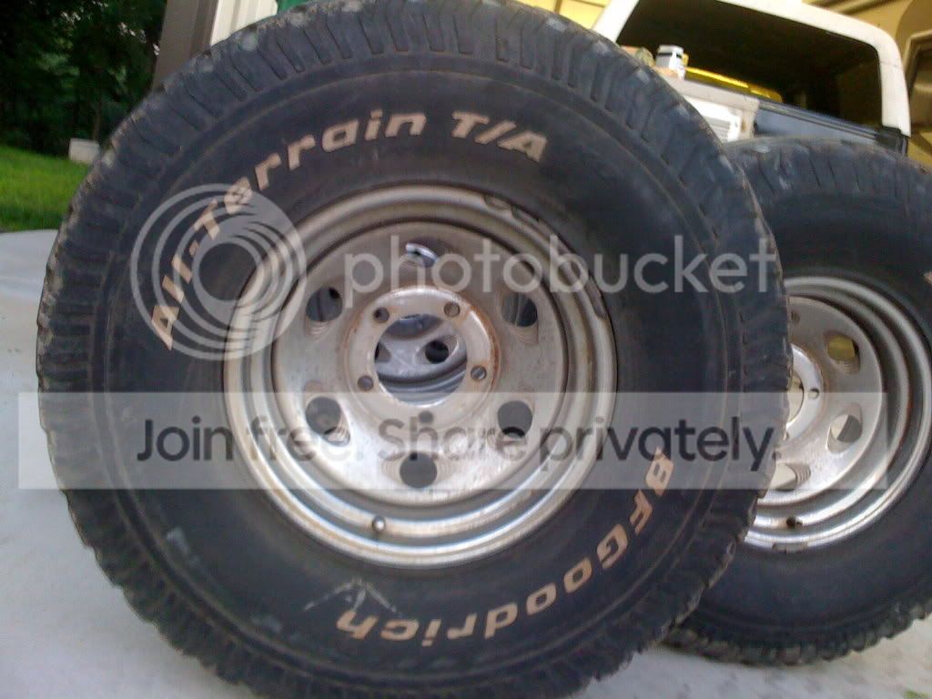

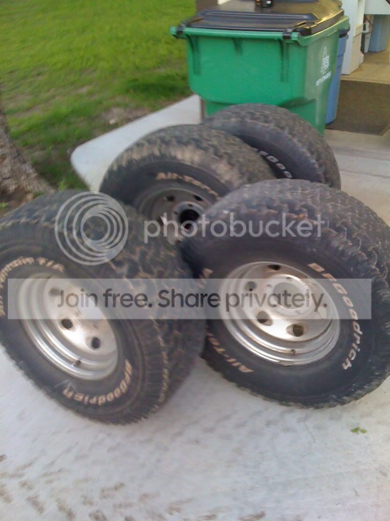

New (used) tires that I got for free, soon to be mounted 33's

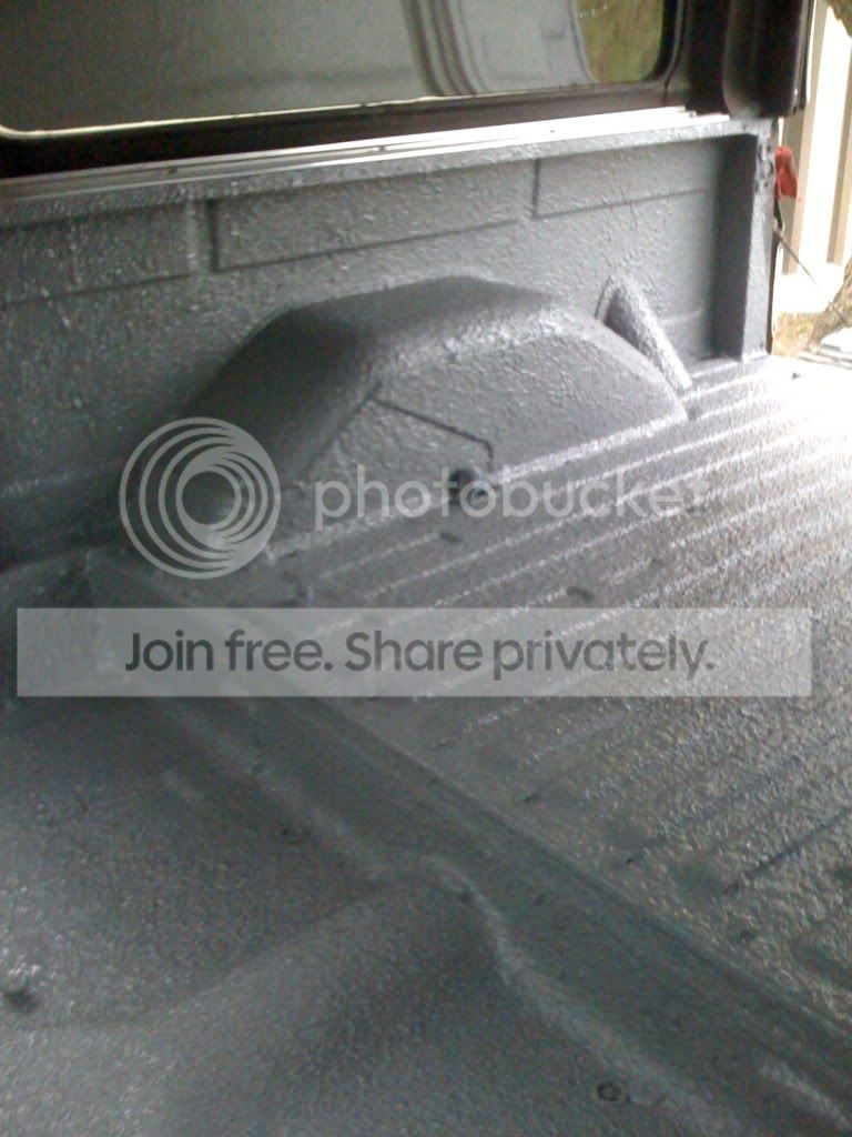

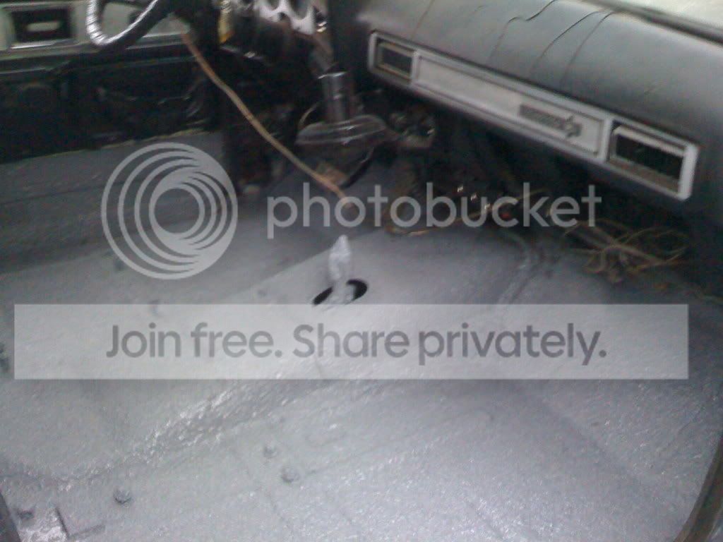

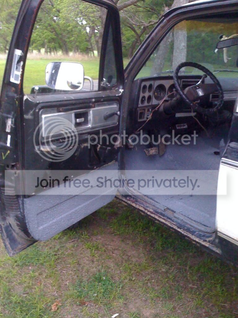

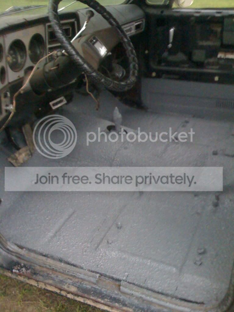

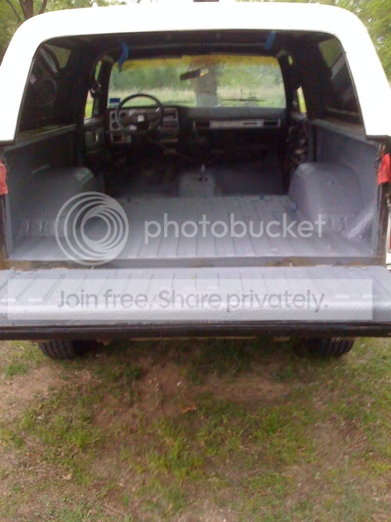

Al's Liner (did it today, was easy and pretty fun to do. Got the hang of it by the front. :p:)
That's all for now, hopefully she'll be driveable soon. Just lined her tonight, tomorrows agenda includes bolting interior back and a nice wash :wink1:

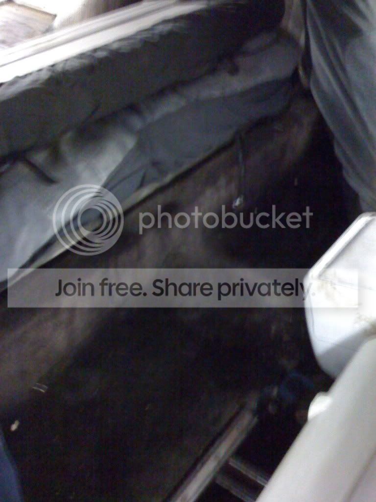

gotta love the shaved carpet... :tongue:
and wow that is some thick liner
