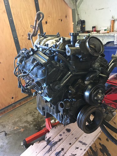

So, i finally came across a 8.1l somewhat local to me, so i went and pulled it.
IMG_0959 by Kcpeltz, on Flickr

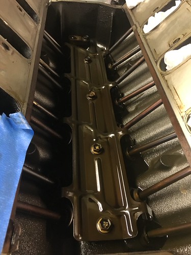

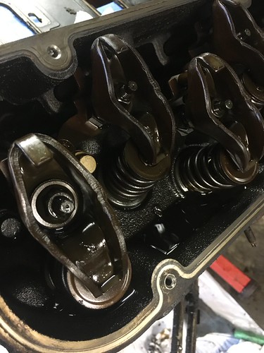

So now im just going through the 8.1l since i wasnt able to hear it run, odo said 265k, but after pulling the valve covers, intake, and pan its been extremely clean.
No gunk at all.
IMG_0966 by Kcpeltz, on Flickr
IMG_0969 by Kcpeltz, on Flickr

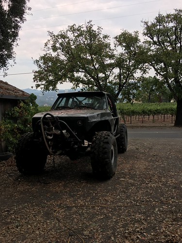

And a shot of it safe back at the house after the fires were contained
