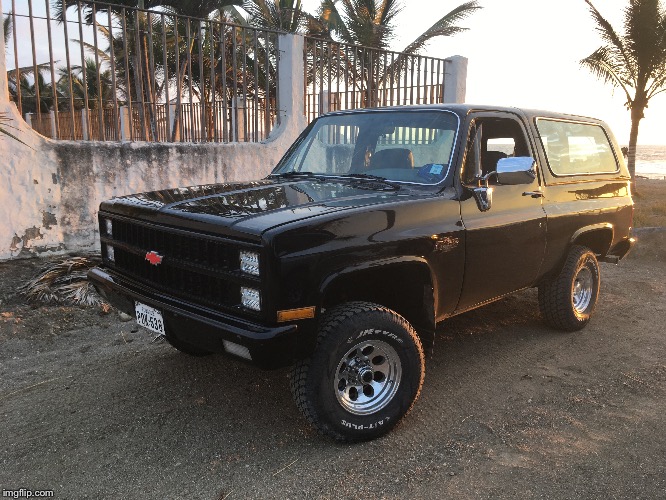

How she sits now with the new rims, believe me she looks waaaay worse in person. Haha! Oh yeah also swapped the auto hubs for Mile Markers and had to fab a front driveshaft because...of course, it didn't have one when I bought it...

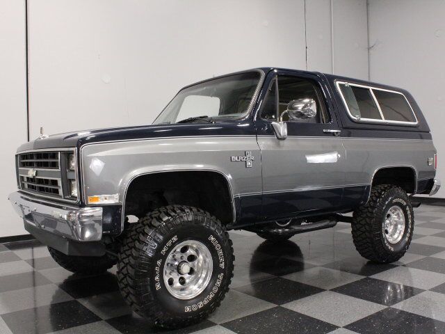

Goal for the build, love everything about this...
That's a solid 20 footer right there. But yeah I bet there are sins hiding under that shiny paint.

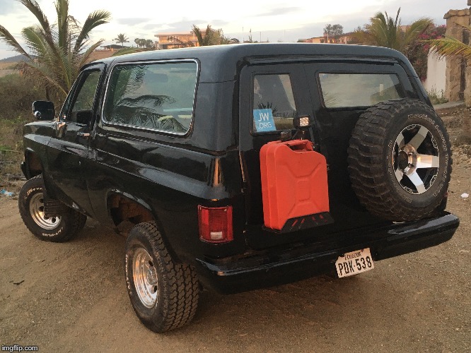

Update. Rebuilt motor, new axles dropping ratio from 3.08 to 4.10, def helps in the mountains. New q-jet carb, stainless exhaust front to back. completely rebuilt the body, hood, fenders, doors rebuilt, cut out and welded in a new diamond plate steel floor, custom rear barn doors. And soooo much more I can’t even remember..Went a blue black with the paint. Still need to redo the interior and finish installing aftermarket a/c system. You were right about the suns under the paint... there was more bondo then metal on the bedsides, cut all that out and welded new skins. I’ll put up more pics of the process and whatnot when I can.

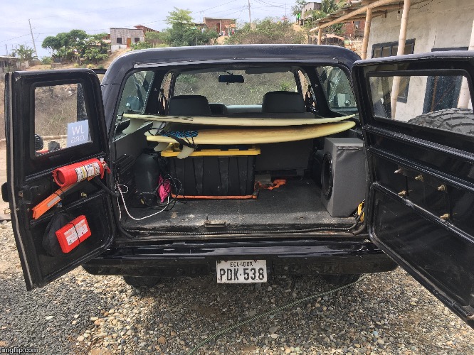

Wow. You need to share the details on the barn door conversion. That looks really slick. Great work!
That's a cool conversion :waytogo::saweet:
