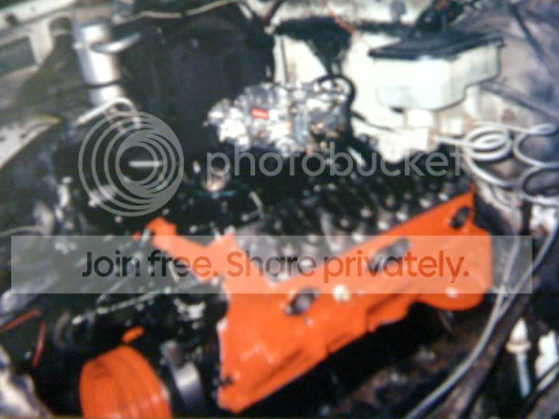

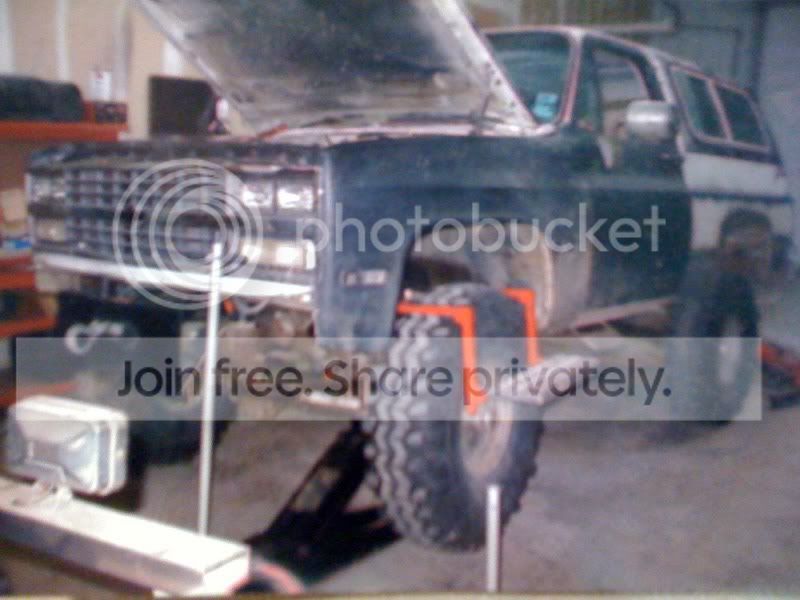

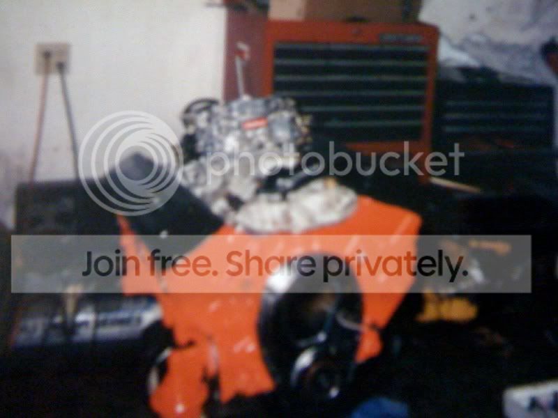

first thing I did was get a rebuilt motor and trans
Of course I had to climb under while everyone watched
And its in.

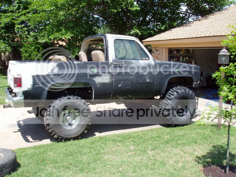

After getting it running I drove it for a while and started to sand the peeling paint off and prime it.
Then a guy I worked with made me a great deal on a set of 38/12.5 tsl
and i couldn't resist.

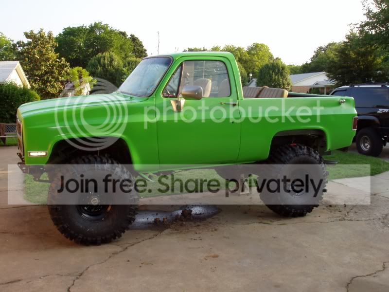

But they wouldn't fit so I through on a three inch body lift.

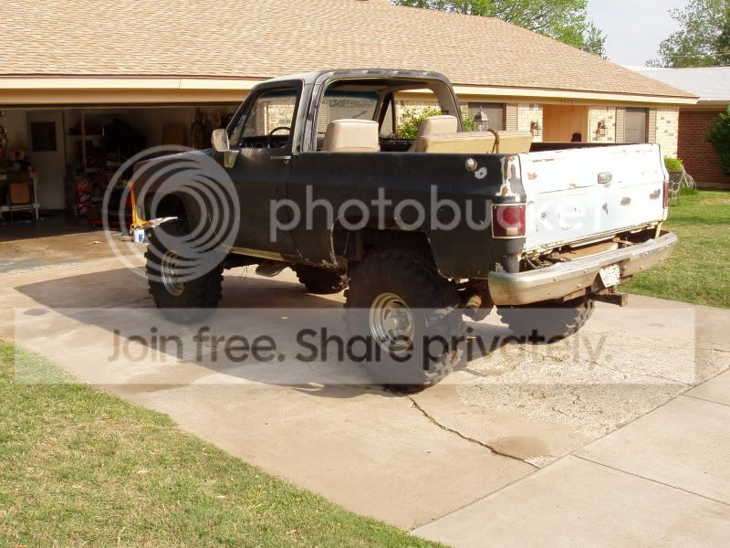

Then the top came off and I drove it for a few years in this condition made a few offroad trips to some small areas around dfw.

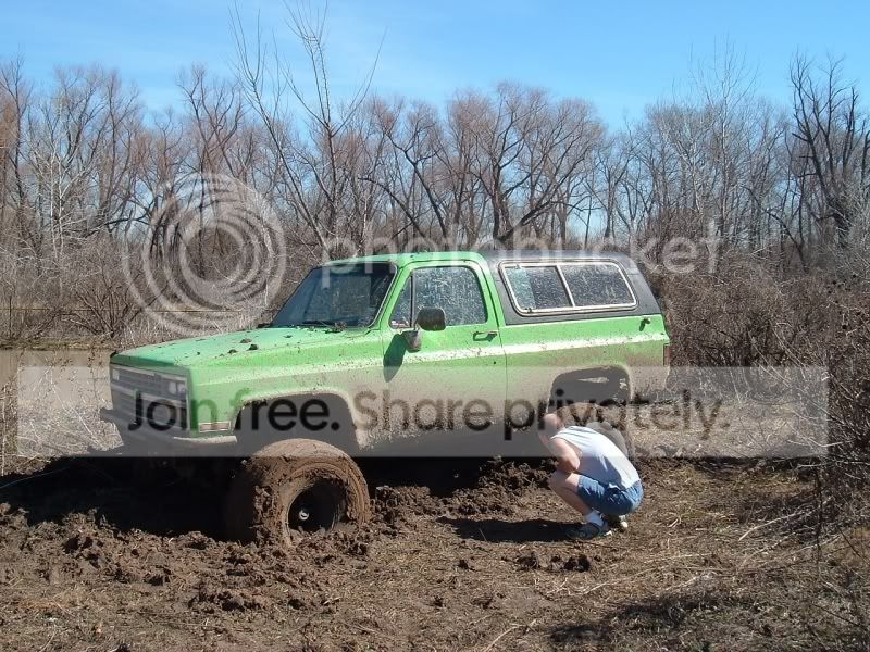

After a Trip to marshal creak with my bro.
My brothers blazer which got stuck alot that day MT bajas suck.

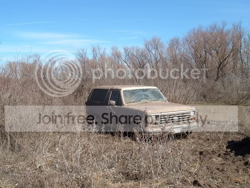

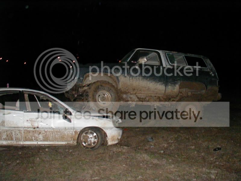

Got these pics out one night in the river bottoms found a stolen car the was wrecked and some guy was stealing the seats out of it.

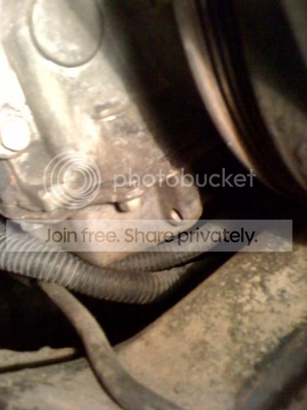

Some time shortly after this i went out to start my blazer one morning and all i heard was the starter spining crawled under and a starter bolt was gone pulled the starter off to take a look and the outer bolt hole on the block was broken off.:flipoff10:

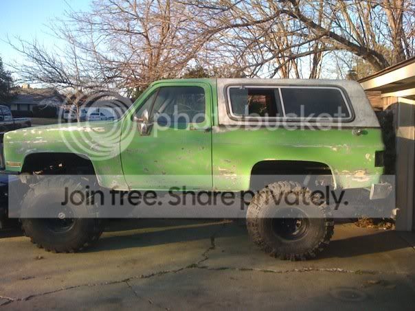

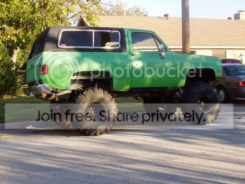

So the block was trash after that I decided to finish painting it and swap tires, wheels, and lift.Previous lift was 4in suspension and 3in body swapped it to 8in springs front with ord shackle flip and 4in block in the rear.Also gonna install a rebuilt 350.
Test fitting the tires before lift went on.
39.5 boggers on 15x12 wheels.

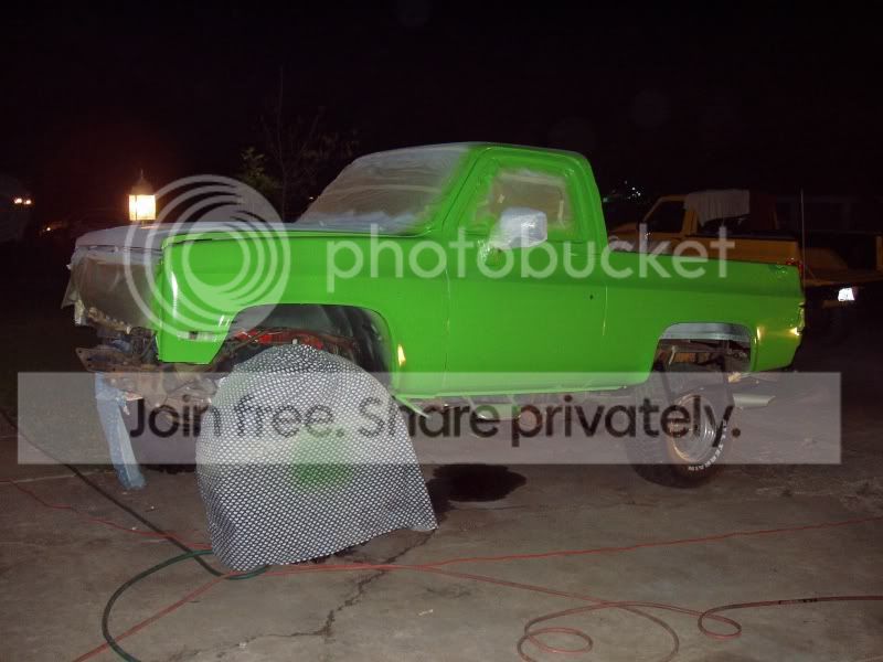

Pics of the paint
Managed to get some more pics loaded from another computer.

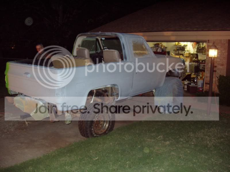

After a full day of three people sanding got the primer and one half the blazer primed before it got too dark.
Finished up the paint the next day and installed the wheels and tires that i had at the time either the wheels or tires were back ordered so for a while I only had two.
Now looking back wish i would of stuck with the small lift and just trimmed the crap out of it.

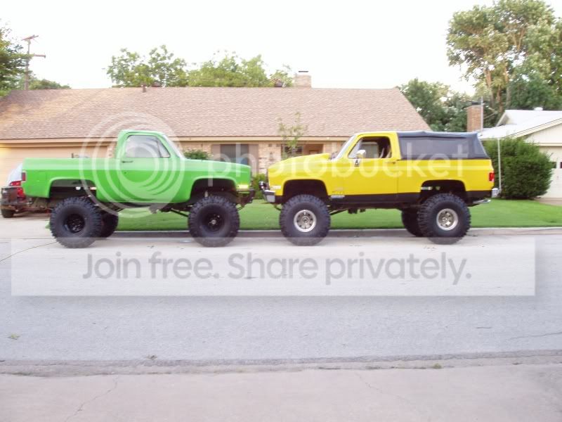

Mine and my bros parked nose to nose.

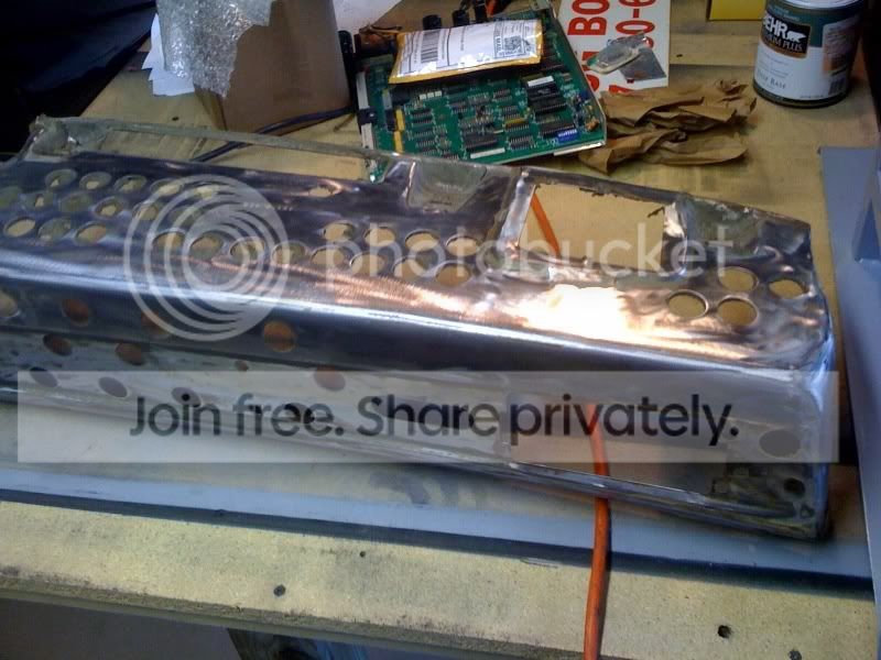

The top on and the start of a winch bumper.

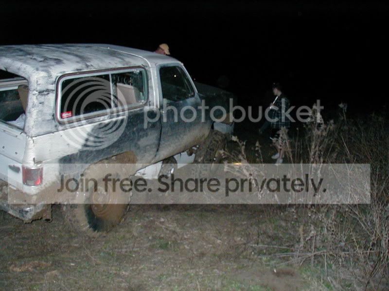

If someone calls you up on valentines day and ask to pull them out say no. I went to pull this guy out with a half done bumper and riped the winch off my bumper and then got stuck and had to leave it out there for the night.
This was the second time he got stuck the first time I pulled him out it ripped the winch off the second try got me stuck. Pulled up in front of him to see what the problem was and when I got back in my truck it had already started to sink and it just wouldn't move after that.
This side didnt look bad but on the other side the right front was almost gone and it was down to the axle in the rear.
Had to get a high lift jack on a sheet of plywood in the front and my buddy pulling almost 90 deg to the left to get out only place he could stop and not get stuck himself.

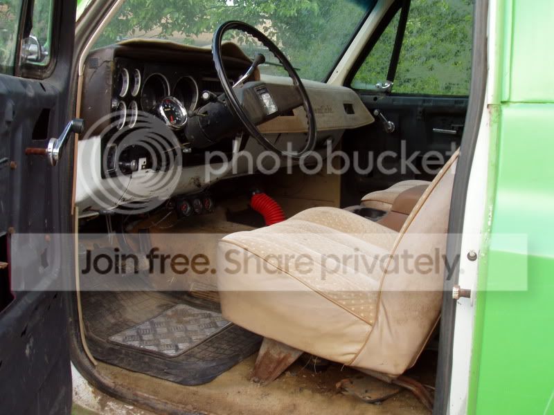

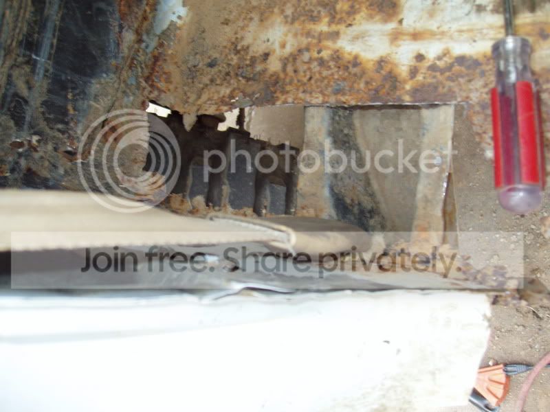

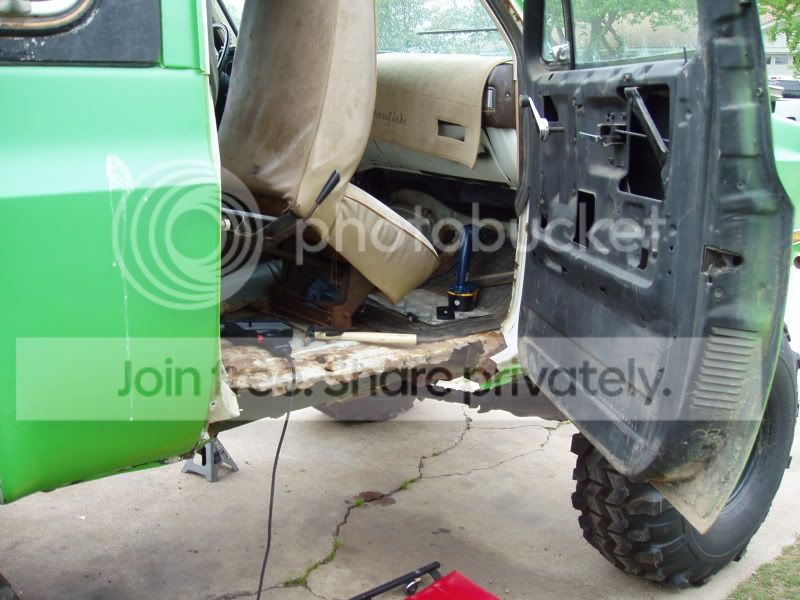

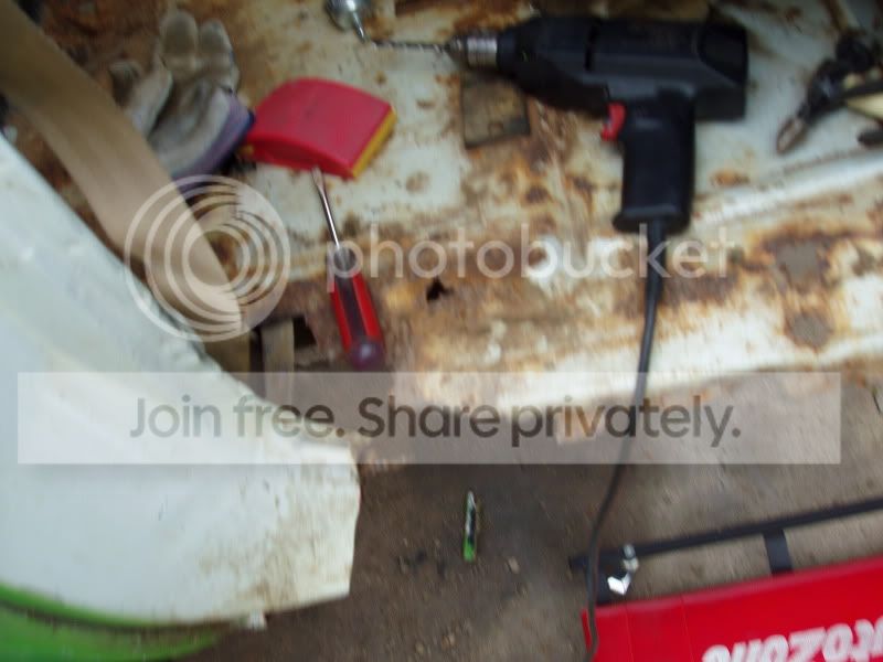

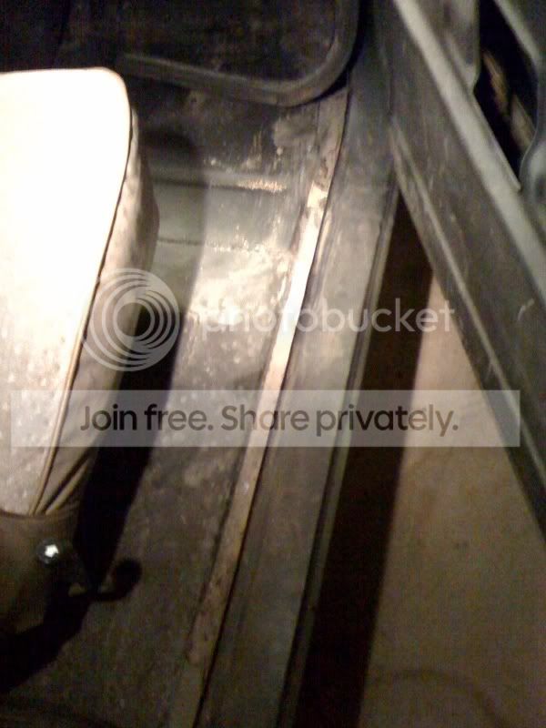

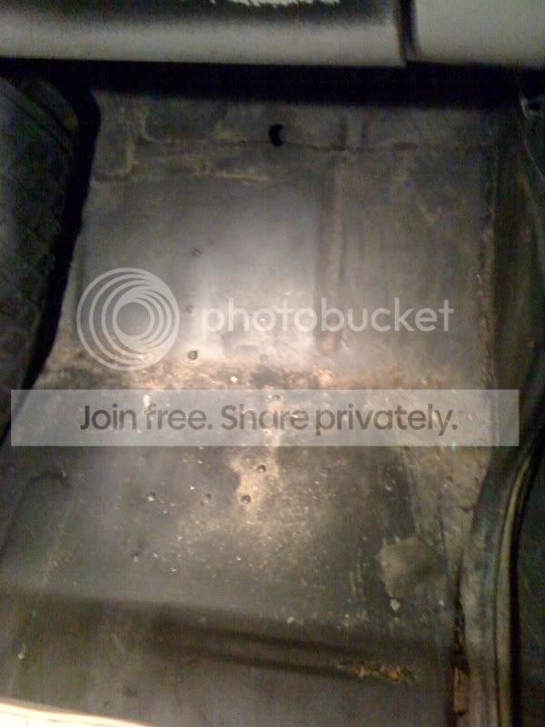

The next project after finding out the heater core was bad was to pull the old nasty carpet out.

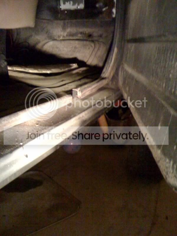

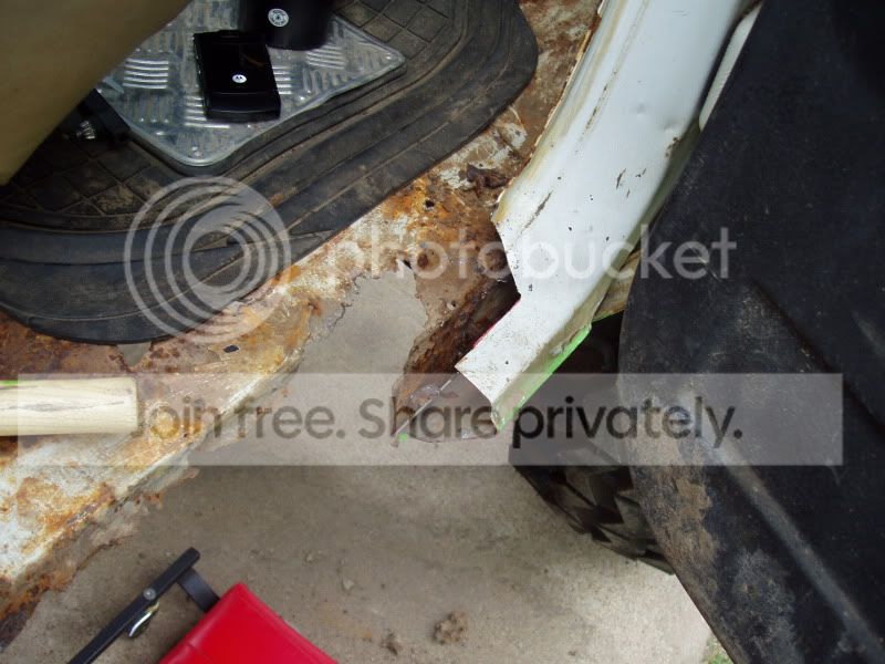

After I pulled it out i found the floor board on the passanger side was rusted much worse than I had thought. So i got some new pans from LMC and started cutting out the rust.
Hello rear tire.
Ended up going all the way to the trans tunnel on the passanger side.

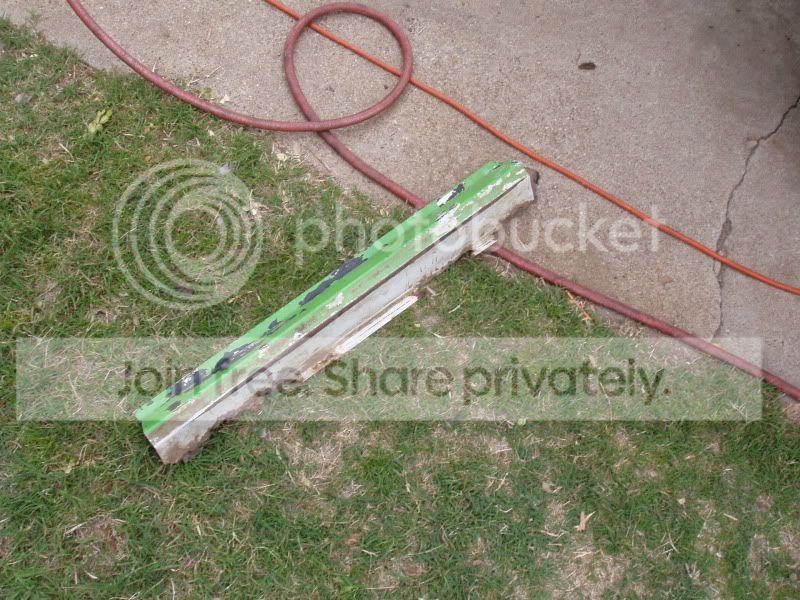

New rocker

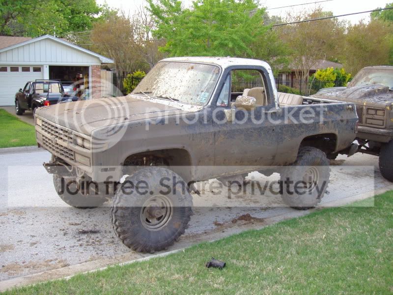

I realized last night i had no after pics so i took some late last night trucks a little dirty.
Floor board replaced.

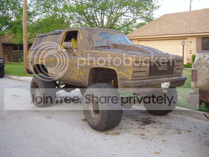

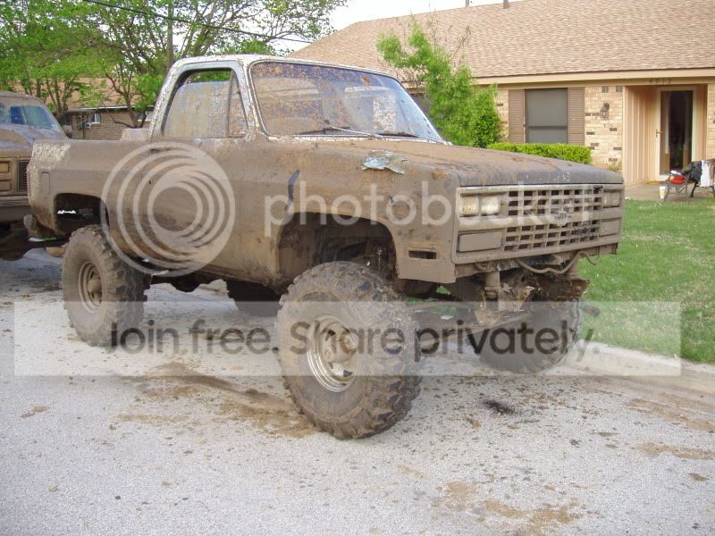

Nice looking mud trucks. Certainly wont lose them in a parking lot...
I know the main theme around here is low lift, cut n' stuffed. But I will always like the look of a big ol mud truck with boggers
I'd say time for an axle upgrade soon tho...

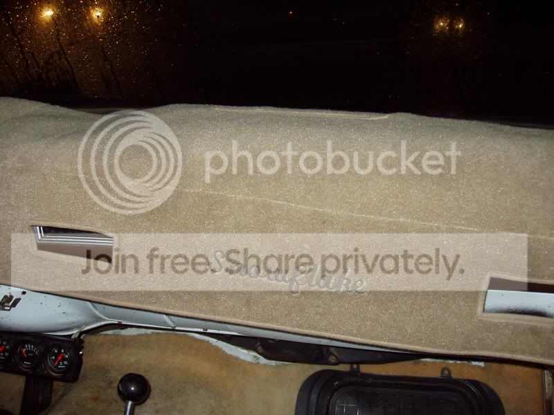

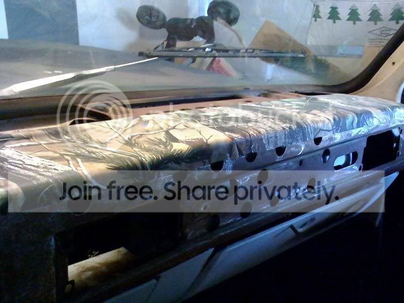

After that i pulled the dash pad out and removed all the old padding to get it down to bare metal.
Them i ordered a small peice of vinyl wrap to test out.
It looks pretty good and hides all the holes with out having to weld the whole thing up.

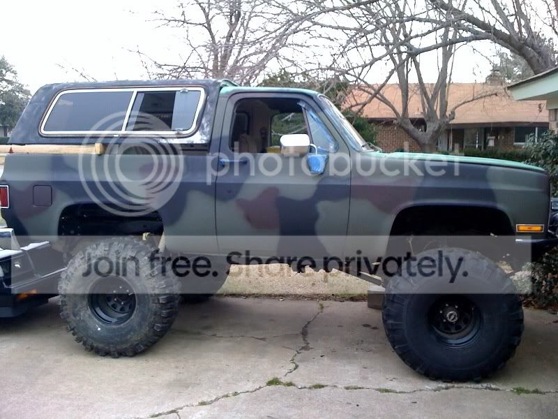

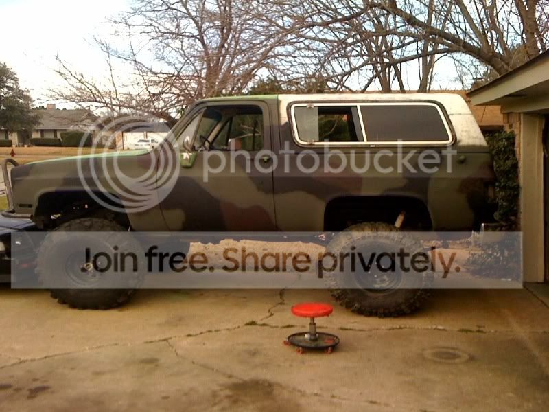

At the same time as the engine swap I was working on getting the blazer painted but didnt want to spend big bucks on the paint job since I knew it was going to take a beating. I decided to paint it like the M1009 CUCV blazer so I got to sanding. Also in this pic I had takin the 4in block out of the rear and went to a 2in.
After this I got to painting found the military camo pattern on a web site steel soldiers.
After getting the paint done I yanked the old 350 out and sold it. Started on doing the wiring harness on the 5.3 since i didnt get the trans in the deal I decide to just stay with the turbo 350. Dont have any pics of the harness being modded to run as stand alone but heres what i pulled out of the harness thats not needed.

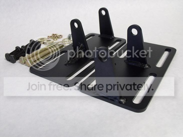

Next was the matter of getting the motor mount adaptors there are many different chocies out there for this but I didnt want to move the trans crossmember like you have to with most. I did some searching around and found a company Dirty Dingo that make a adjust mount so i ordered those up.
Installed the 5.3 in the blazer and with these adjusted all the way to the rear it Bolts right into the same position as the old 350 and clears the engine crossmember for the most part. There is one little tab on the corner of the block behind the assesorie bracket that hit but it has not structual bearing on the motor so i trimed it off.

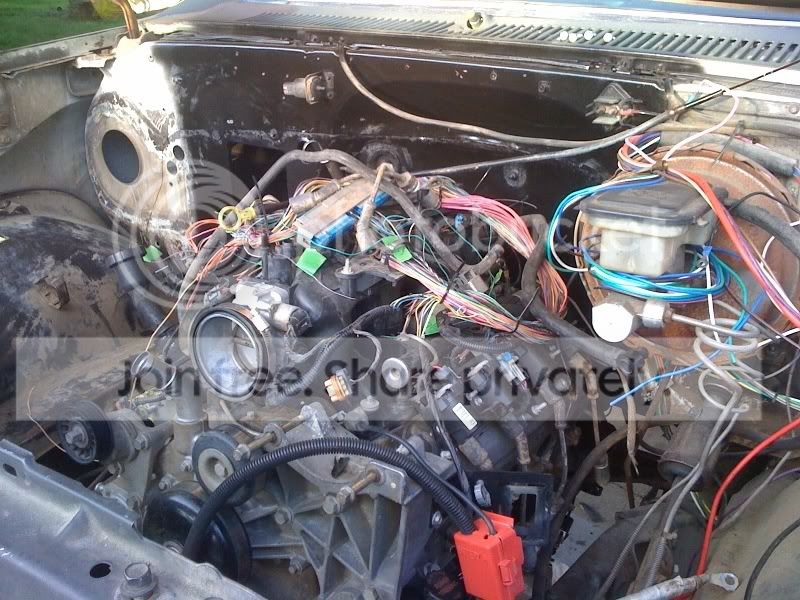

More 5.3 pics.

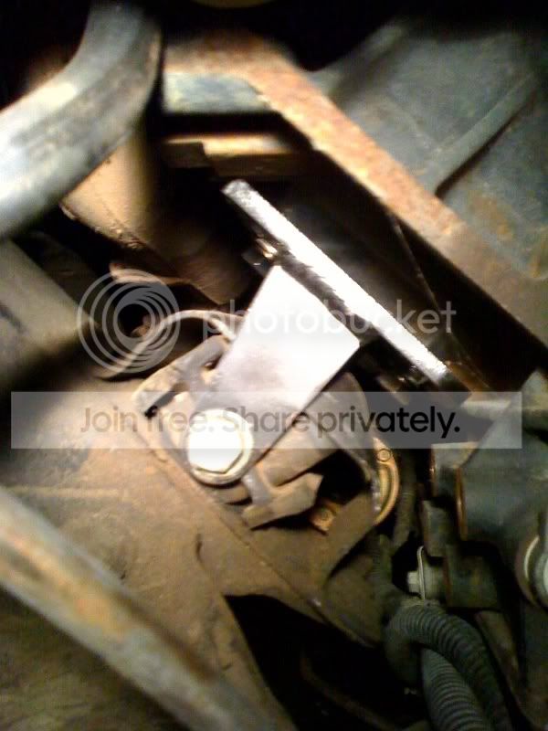

Got more pics of the 5.3 install. Most of these pics have been takin with my cell phone cause I never had the good camera with me while working on it.
Here is another pic of the motor mount adapter looking down the passenger side frame rail.

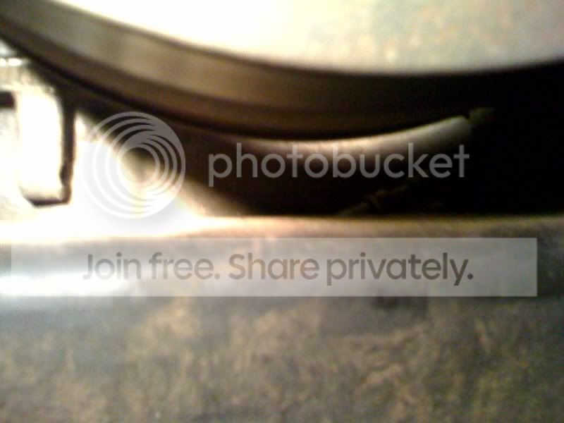

After getting the motor dropped in and bolted to the trans I had one clearance issue to deal with at the drivers front of the motor with the small tab I talked about. Looking at it I found that it was not used for anything and has not structural bearing on the engine so i decide to trim it rather that cut up the engine cross member.
Since the engine rolls to the passenger side it didn't need to go far and if need be i can still trim more but i don't see any reason to.
Its hard to see in the second pic cause the sun is right on the spot but its looking down from the top.

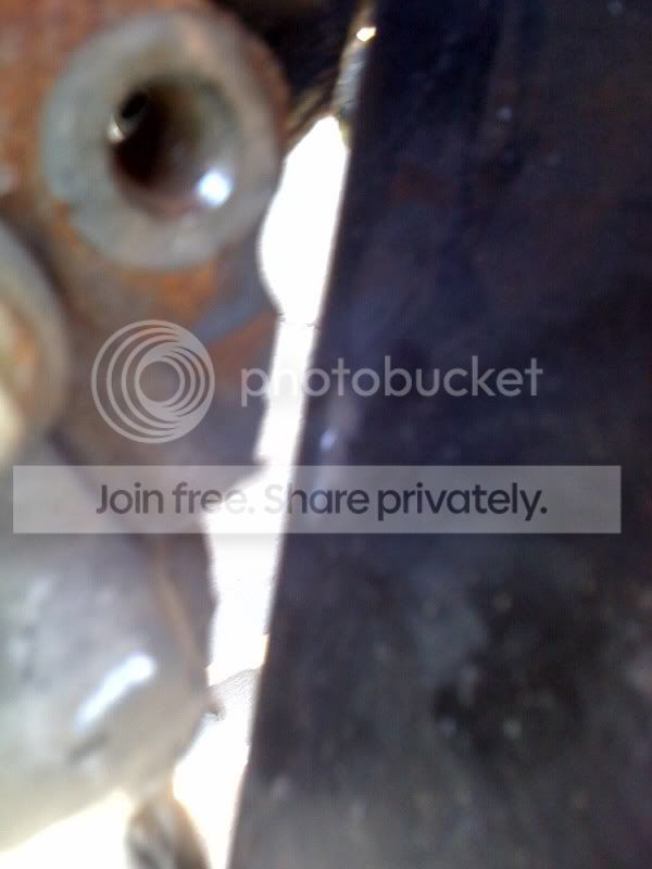

Here is a pic of the clearance for the crankshaft.
The clearance on the right side is no problem theres plenty of room between the engine and cross member.

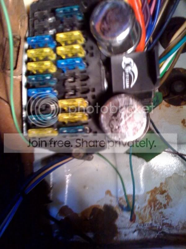

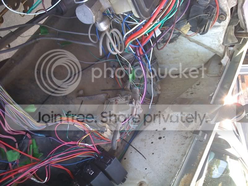

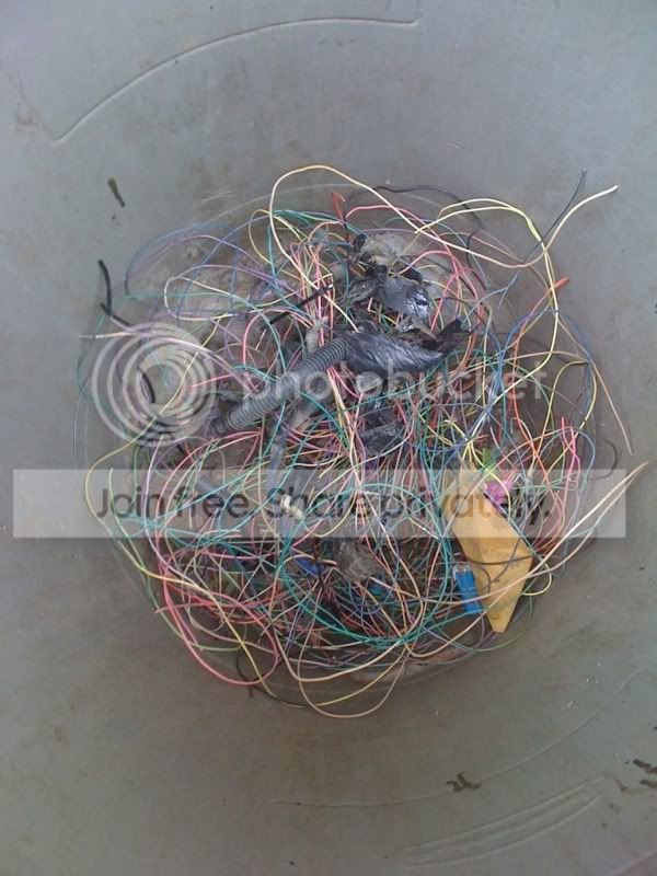

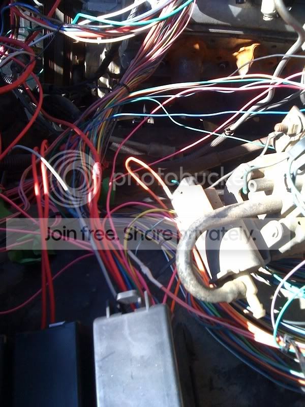

Now that its sitting in the blazer I had to finish the wiring for the stand alone engine harness. I had already remove all the wiring for the emissions and trans so all that was left was fuses and relays. I didn't want to build my own fuse block so I found a company current performance wiring. They sell a complete harness or just a diy fuse block.
This is a very nice piece has all the relays and fuse I need and even a extra switched and constant 12v, relays for dual fans installed all the wires are labeled. The instructions are easy to understand and even include diagrams for the relays. It took me like two weeks to get everything wired even after the two months prior that i had spent looking at diagrams of how to do it. Wiring is a pain in the butt.

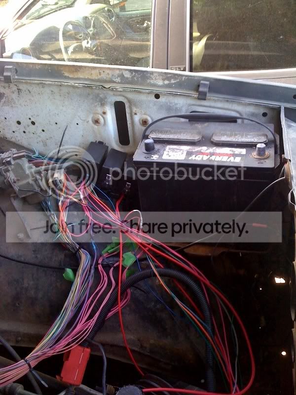

I decided to move the battery to the drivers side and also mount the pcm in the corner near the fire wall so everything was close together.
Battery moved and the engine fues block mounted about half the wiring done. All the pink wires need 12v switched and the orange get constant.
Its a little sideways but you can see where the pcm is going to be located and the fuse block lots of wiring real looks bad with no loom.
Another shot of the wiring.

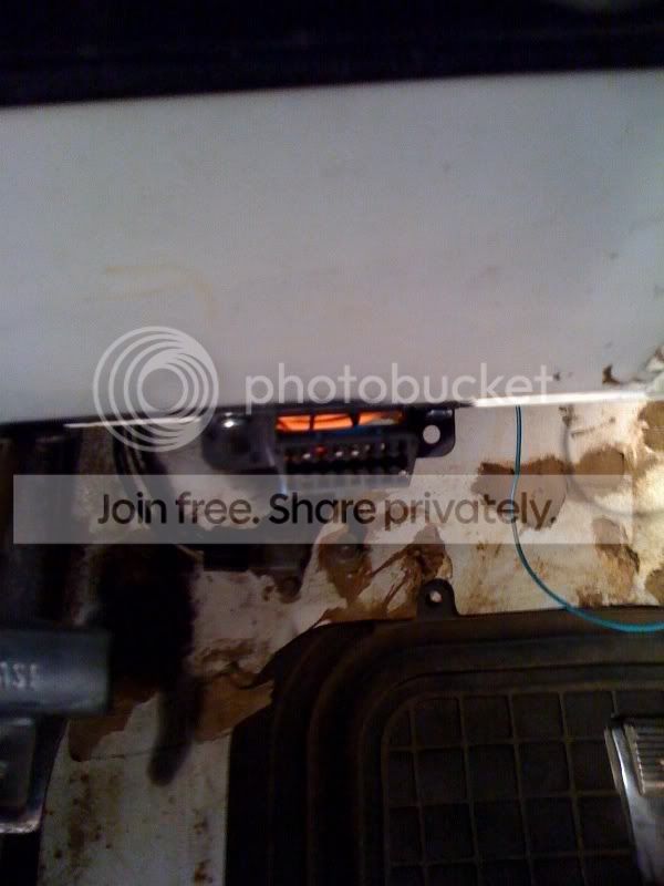

The DLC mount to the bottom of the dash. Didnt get one with the harness and didnt want to spend a ton and the dealer for a new one. While doing research for the swap I found a company that sells all the individual parts to make a DLC so I ordered that stuff ended up only costing me like $7.
It's easy to wire up Just a power wire, two grounds, and the data wire from the pcm.
