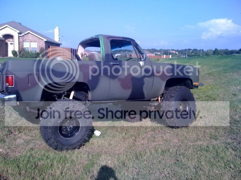

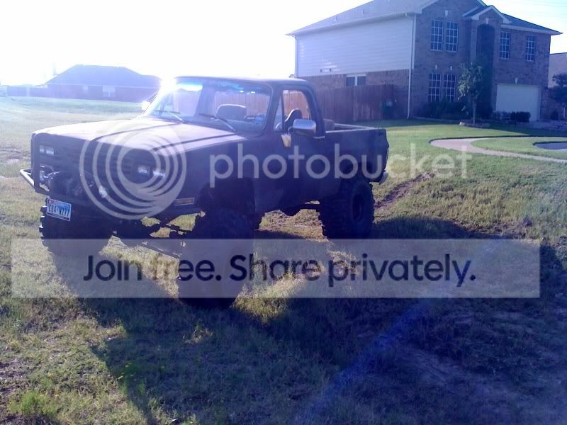

Just some quick pics while I was checking to see if I trimed the fenders far enough.
Fenders look great, how do they work?
Well, they bolt on over the inner fenders. The main purpose is to continue the body lines to the grill area of the truck and provide a nice surface with which to apply a final coat of paint. They are also used to provide a nice surface to mount items such as emblems/logos, turn signal/marker lights and antennae. They are also useful for locating items on a narrow trail such as the lone rock that could cause any damage or a tree. Sometimes with the tree you can see how old it is but with the rock you almost always are able to tell how old your body panel is.:surepal:
Yup thats about right.HAHA
The passanger side I got trimed and looks all pretty but the drivers side had been mangeled by the tire so the cut didnt end up like I wanted it but I just gotta adjust the inner fender and it should be fine.

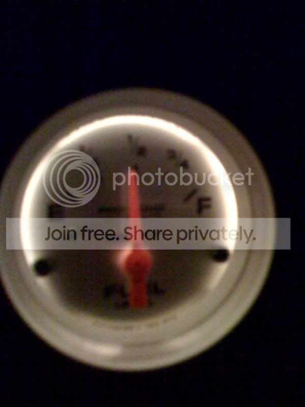

A little update I got my gauges installed. I picked up a auto meter water temp, oil pressure, and fuel gauge. All work great except for the fuel level I thought my factory gauge was bad but I guess I was wrong. So I dropped the fuel tank. I thought it only had about a gallon or two in it I had been adding about 5 gallons at a time and driving it but I guess its not using as much fuel as I thought cause its looks to be over half a tank. Pulled the sending unit and ohm tested the sender its shot ordered a new new should have it Monday. Only pic I have now ill get some pics soon.

Got the new sending unit installed and the tank back in gauges all work now first time to ever have a working gas gauge in the blazer.

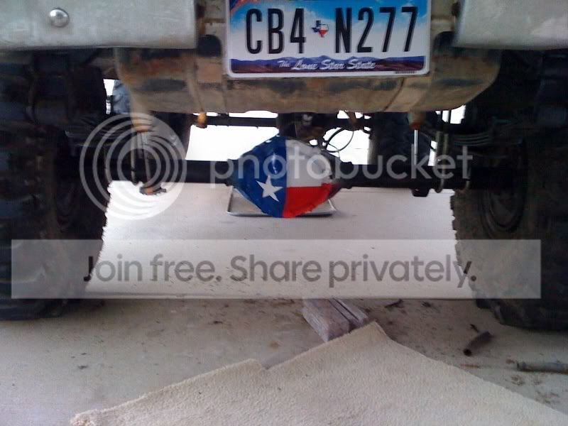

Also thought I would try something out on the diff cover see if I like it. I highjacked it from another member.
Let me know when youre gonna do your axle swap. If I'm in town I will come by if you need a hand.
