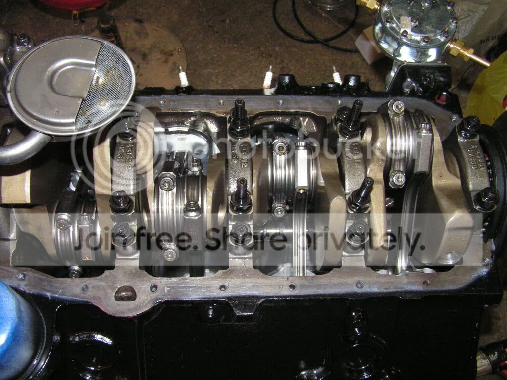

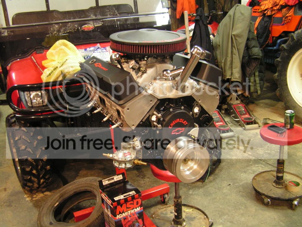

After purchasing the truck I began looking for a replacement motor for the 2 bolt main 350 and found a 383 forged stroker with dart Pro 1 aluminum heads and complete comp roller valve train.
I then began the tear down, I got crazy and completly disasembled the truck. At the time it sounded like a great idea.

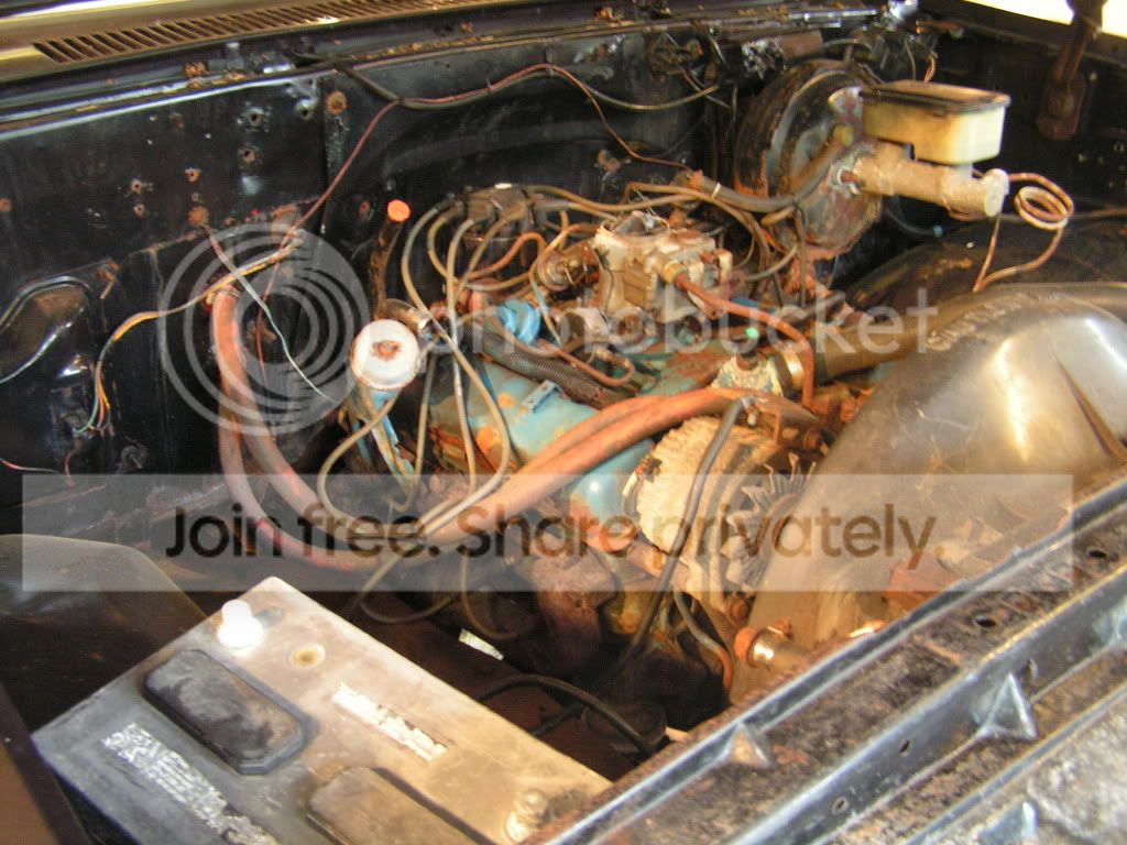

This was my reason for purchasing the stroker the motor, as you can see the original motor had seen better days.

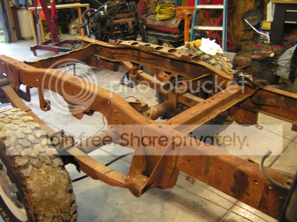

Aside from surface rust the frame was still solid.

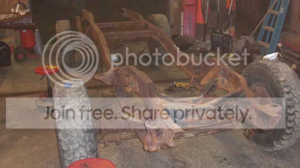

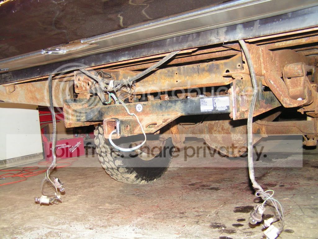

After removing the bed I found the the rear crossmember was bent, so to fix the issue I removed a straight crossmember from my donor/parts truck.

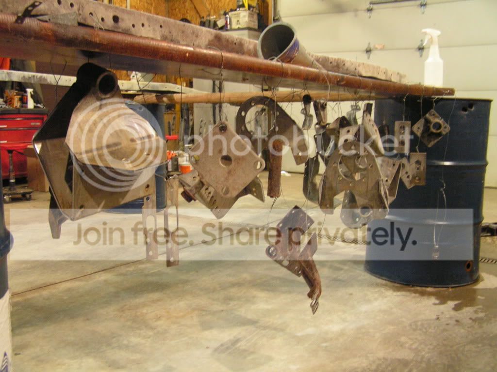

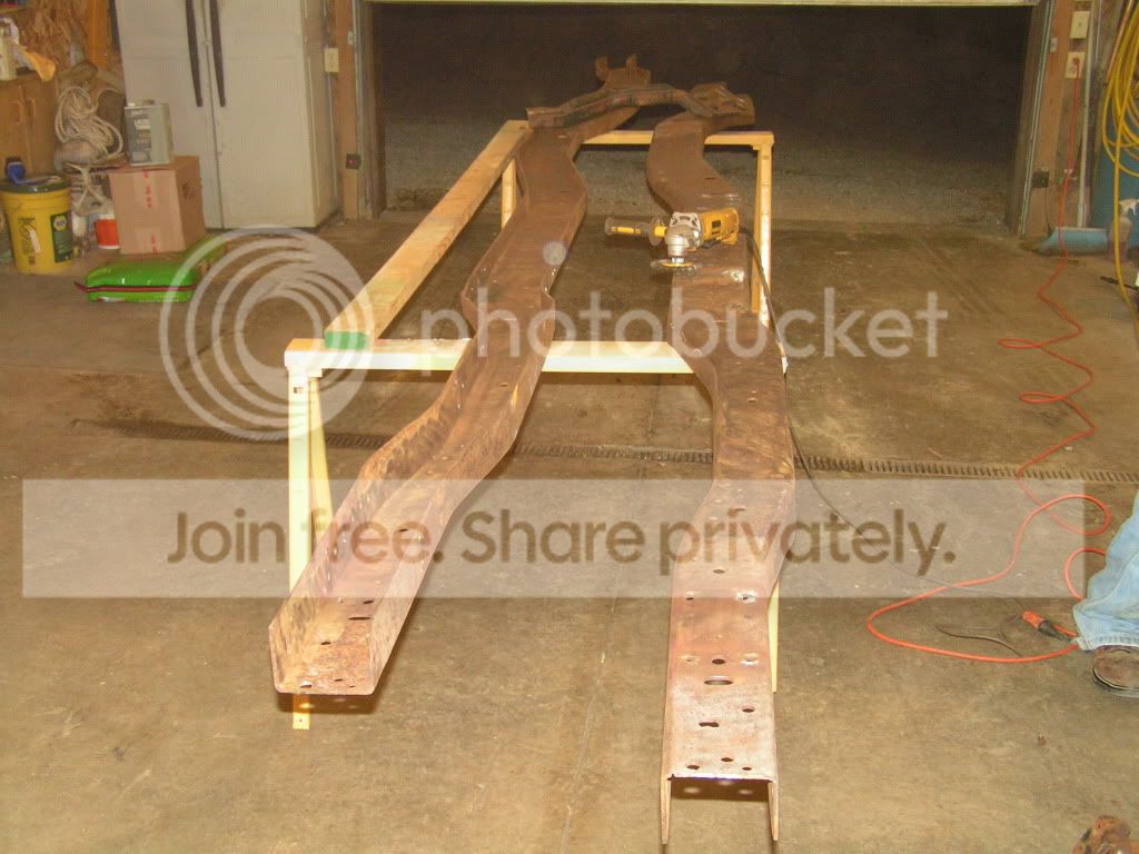

After I got the cab removed I began taking the grinder with cable wire wheels to the frame to remove the rust.

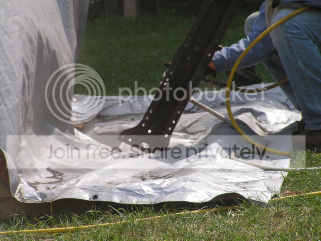

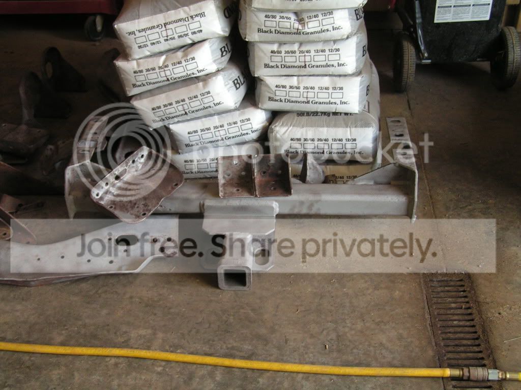

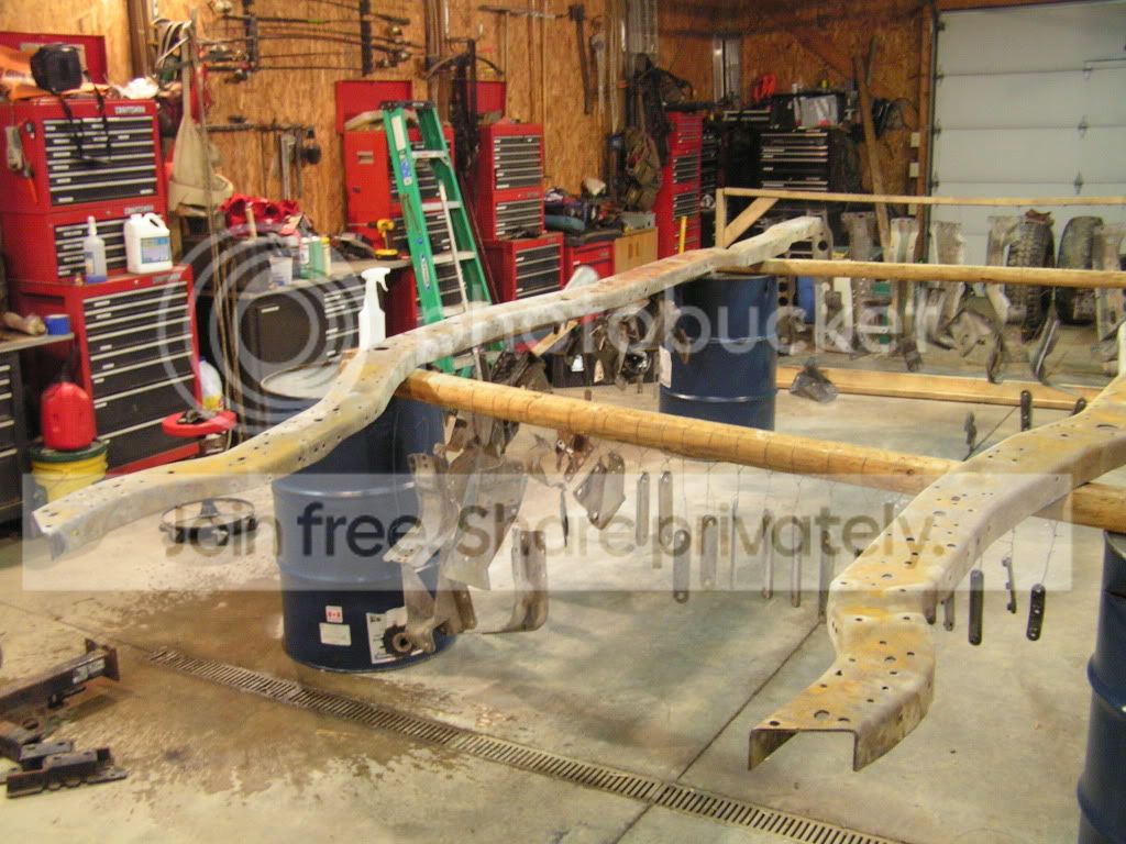

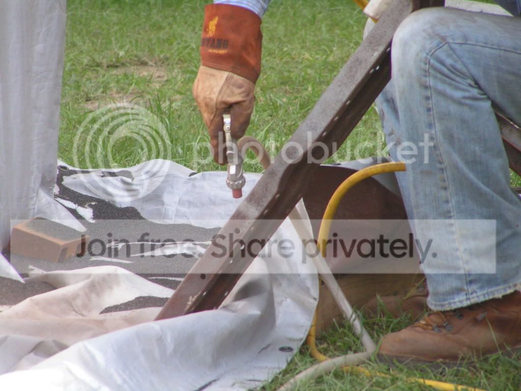

I then decided that I wasn't getting all of the rust off like I wanted, so I grinded of every single rivet and used an air chisel to pop them out. After this I upgraded my method of removing rust to sandblasting. Very time consuming but the results where worth it...

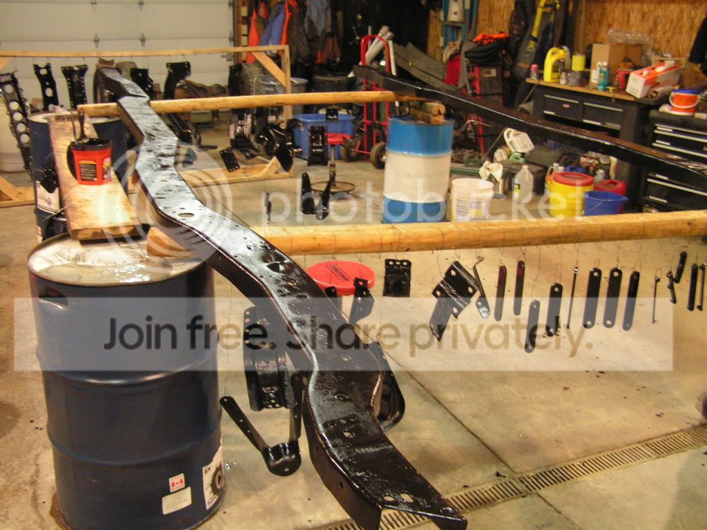

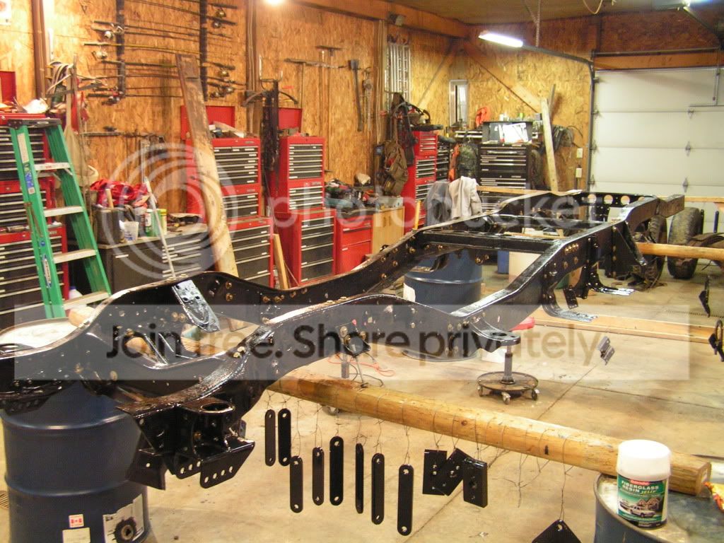

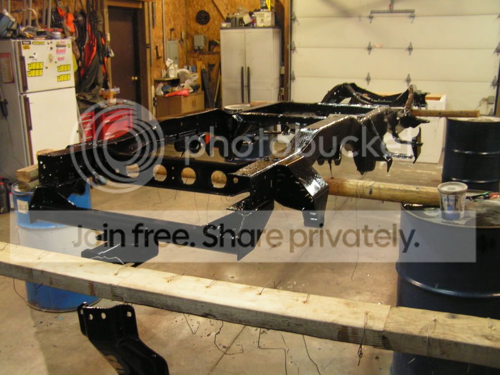

After blasting all of the frame parts I decided to use POR15 products of the frame. I applied three coats of POR15 and then applied another three coats of the their Chassis Coat. I am pleased with the result and will continue to use their products through out the build.

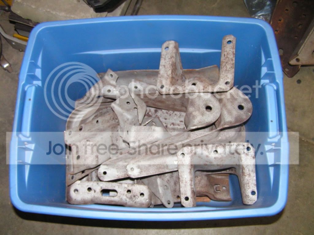

All of the parts hanging after being cleaned with Marine Clean and etched with Metal Ready.
Here are some of the goodies from DIY4X including the shackle flip, B52 mounts and front shackle eye hanger.
After first coat of POR15

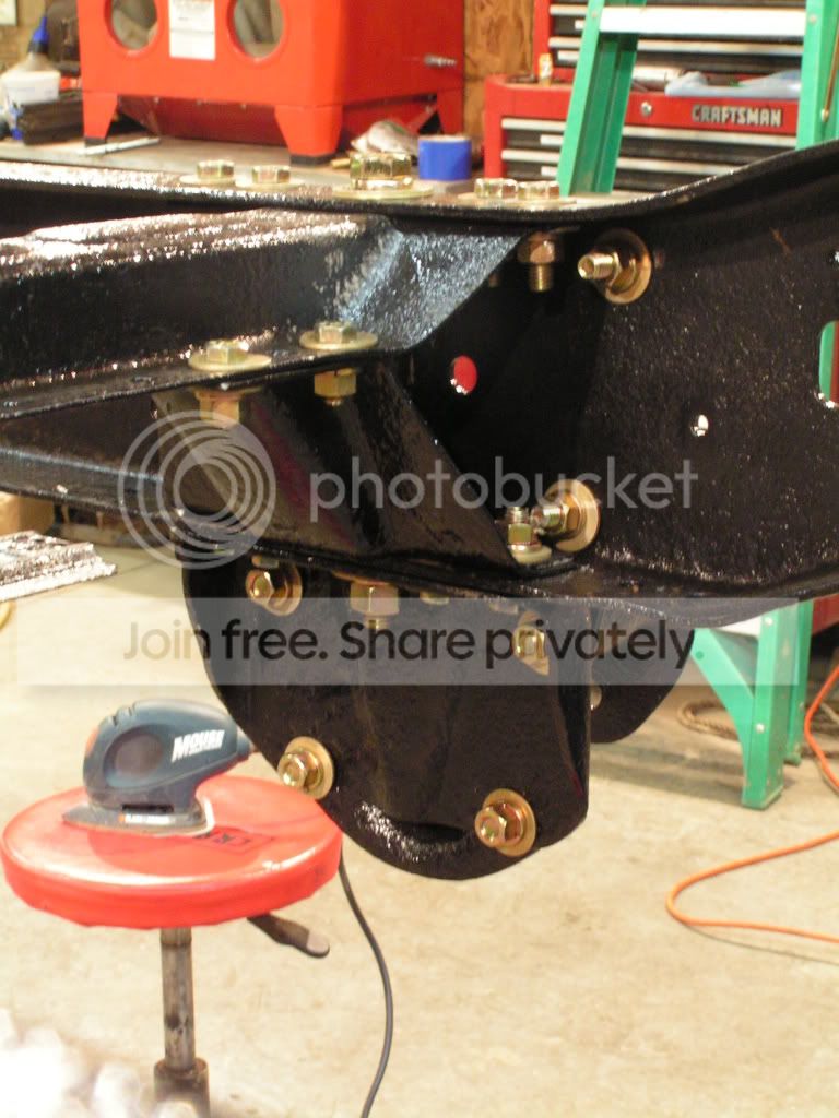

After the second coat was dry the frame was reasembled. For this part I used all Grade 8 bolts with lock washers and red lock tight. Every bolt was then torqued to spec. This part made me nervous, but the frame went together tightly and square.

Just curious, what is "spec" when it comes to torquing the frame bolts when they were originally rivets? How much POR did it take to do the frame parts?

It will be a long time before I take on another one, the amount of time that I have invested is unreal, and I found the specs on the bolts here:
http://www.engineershandbook.com/Tables/torque.htm
