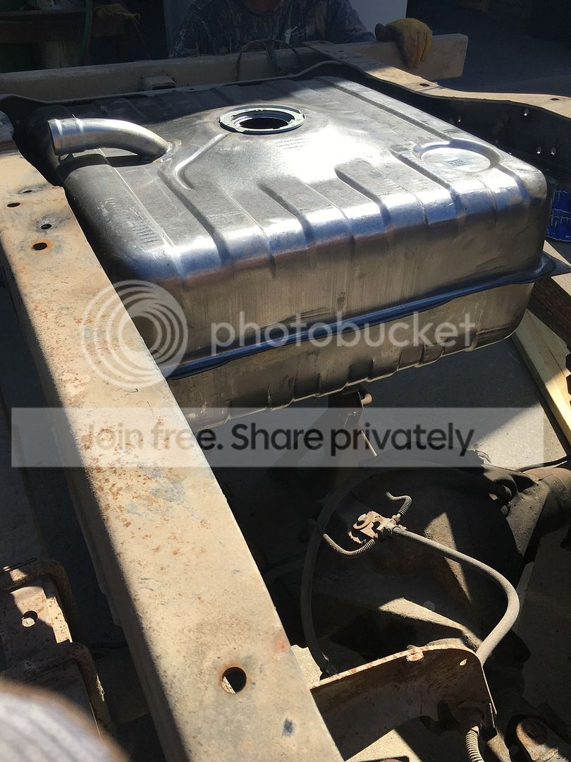

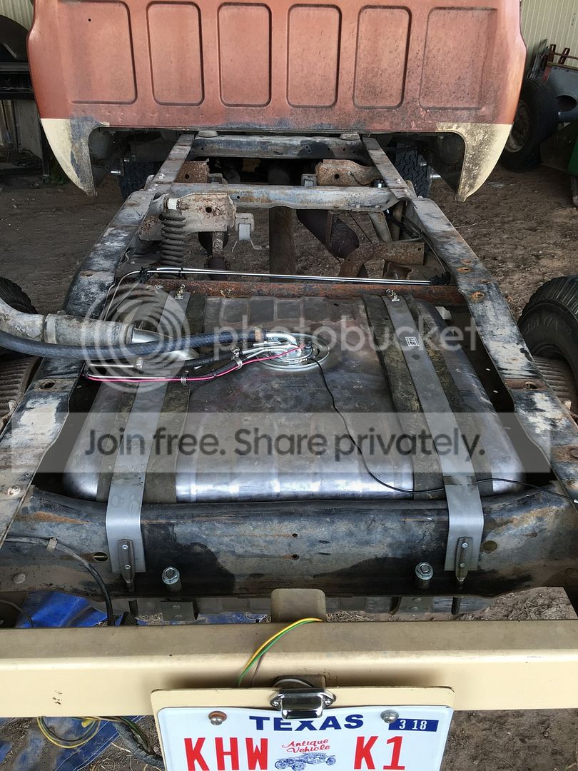

Managed to make a little progress this weekend on the suburban tank swap.
We started out Saturday morning and pulled the bed, Thank god for chain hoists.
After that we moved from the dusty dim-lit tractor barn to Pop's driveway where we had a cleaner, more level surface and less clutter. Got a few jack-stands under the tank and started mock up. Originally We had intended to go with a 40 gallon tank but we decided to proceed with caution and went with a 31 gallon.
(In the first few pictures you will notice the filler on the passenger side, we eventually spun the tank 180 degree's due to the contour of the tank bottom it would sit more level in the straps.)
Here's the mock up, then removing the passenger side spring perch and also smoothed out that back cross-member lip.
With no good donor vehicles around we took a swing and just ran with the factory rear cross-member and used a heavy piece of angle iron for the front straps... we ended up shortening the top straps and used them to limit how high the lower straps could pull the tank up. Then used some heavy rubber to insulate the metal to metal contact.
After all that, we managed to wrestle out the old tanks, organized the aftermarket fuel pump one of the previous owners had installed and figured out which wires we needed and spliced it all back in.

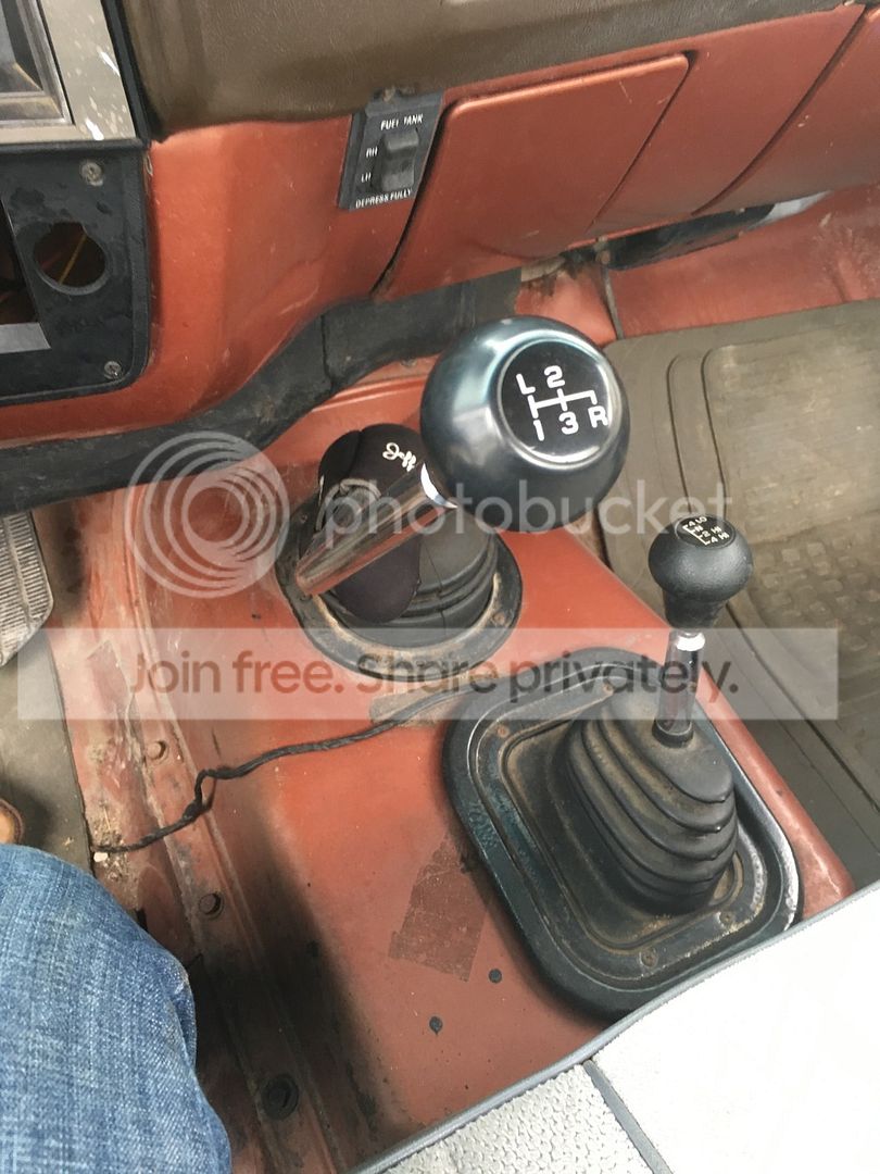

Also went ahead and decide to twin stick the 205 since I need to pull it and replace seals anyhow.
Any plans to change the filler location? Might be a tight squeeze between the bed and frame where it is now? I ended up using some 1" pucks to give me a little extra clearance.
I'm not really sure to be honest. Once the bed is back down we're going to address the issue. Right now I think I'll just run it up behind the driver side fender well
