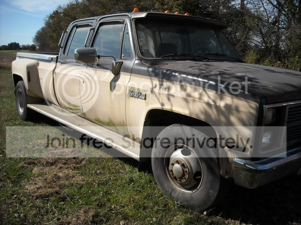

Back in October of 2010 I was really wanting to find a crew cab truck I was looking for a SRW 2wd or 4wd crew cab but all I could find in my area was 2wd duallys. So I bought a 1985 GMC Sierra Classic 1 Ton Crew Cab.

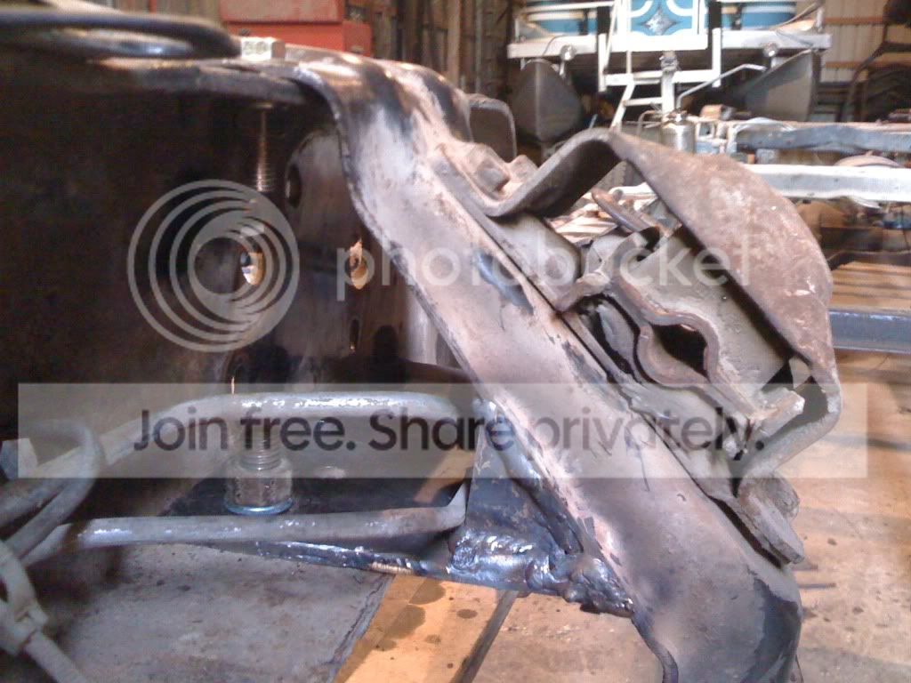

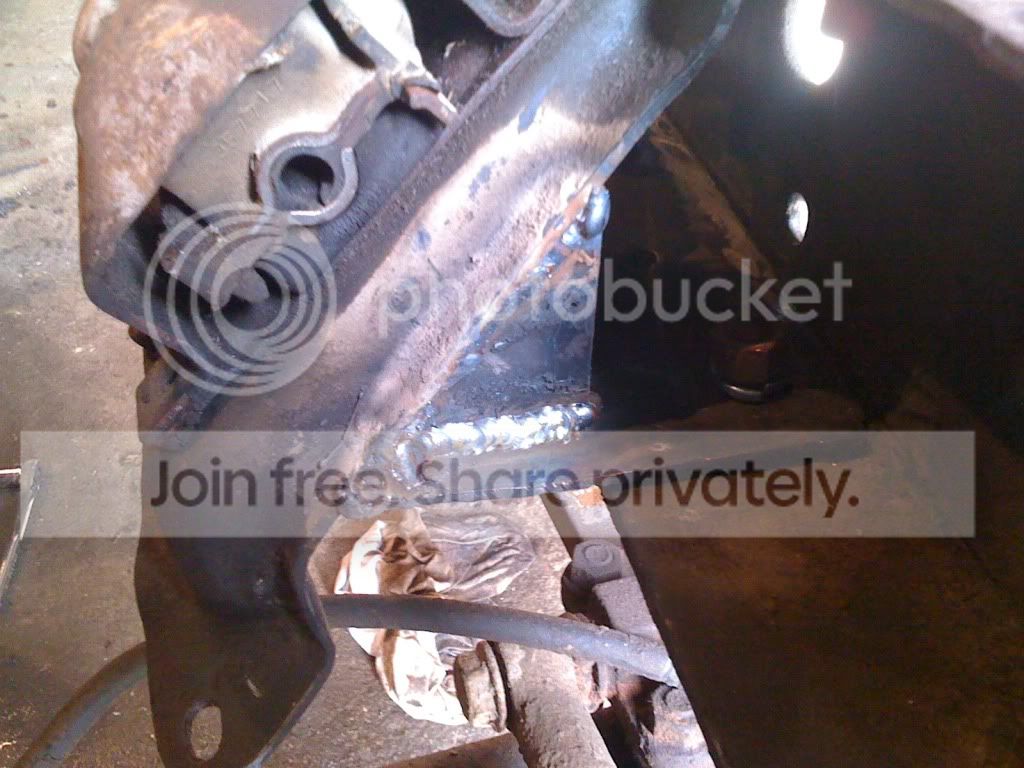

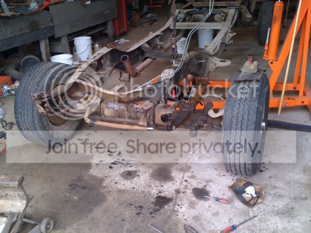

The truck looked to be in good shape but after I got it home and started tearing it down I figured I needed to find a replacement body for the truck. While I was searching for a new body for the truck I started to convert the frame to 4x4 using spring hangers off of an 86 k20 frame.
2wd stuff removed
Front axle half installed

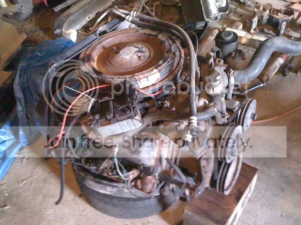

I then decided I wanted to try out a 6.2 diesel in this truck, figured it would give me better fuel mileage compared to the big block. So I found a guy that wanted to trade his J-Code 6.2 with a Th400/NP208 for my 454/Th400.

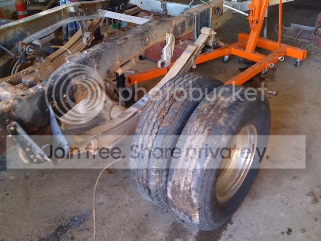

In all of this time I then decided I wanted to go back to a dually on the truck. I had to find some rear spring hangers off of a K30 so that I could get the correct height in the back of the truck.

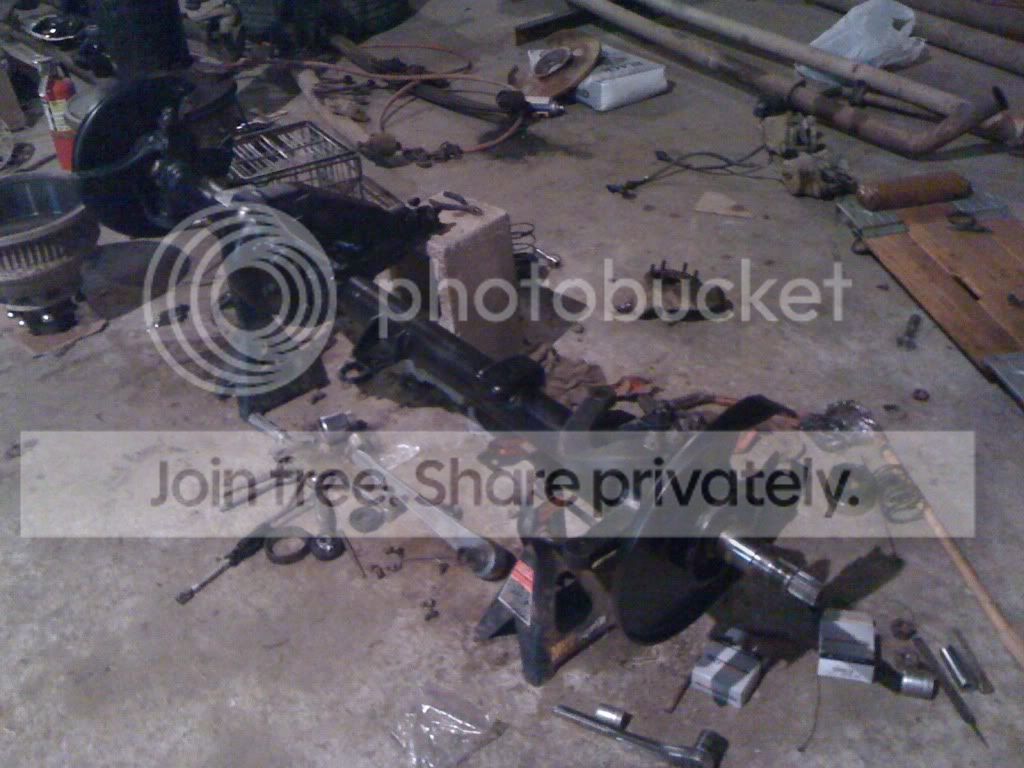

For the front axle sense I didn't have a D60 and couldn't afford one I just through a D44 under the front.
D44 almost back together

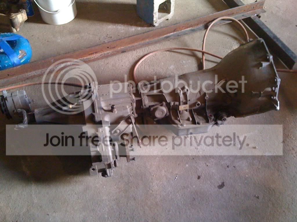

I then decided against running the th400/np208 and picked up a SM465/NP205 for the crew cab.

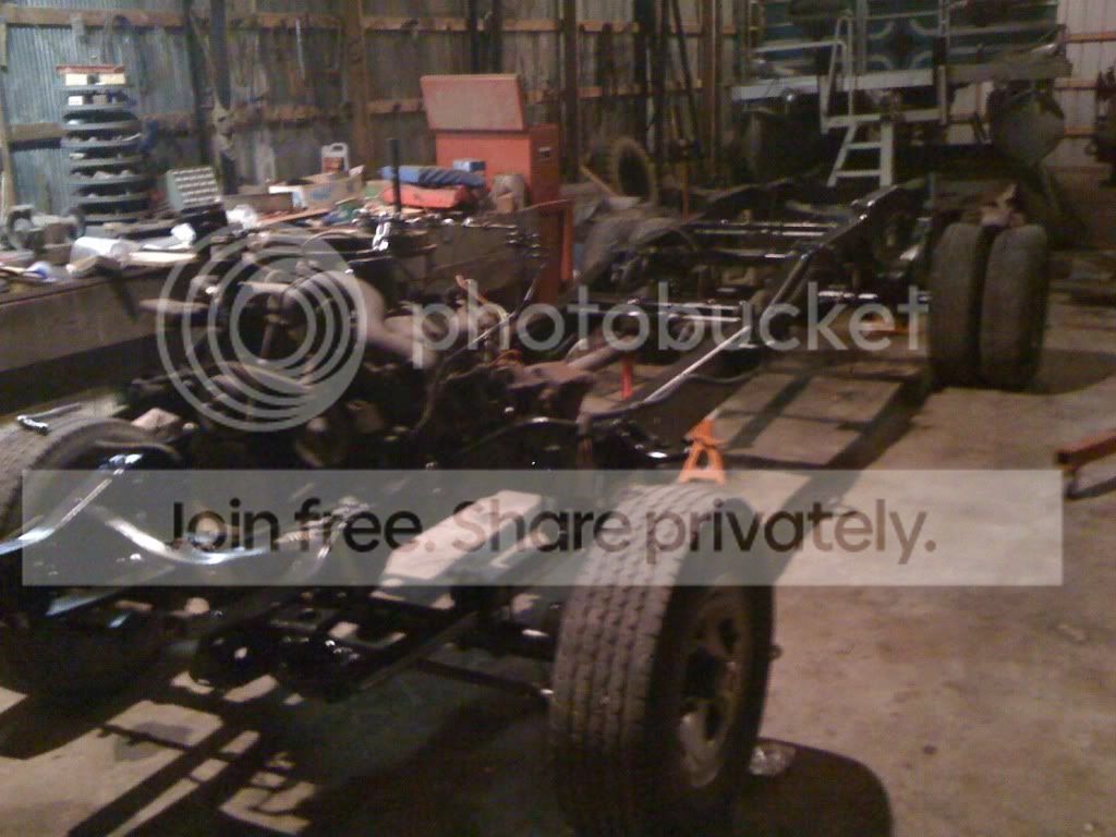

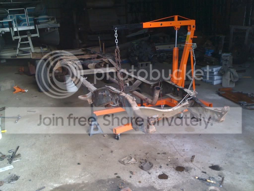

Frame painted with drive train installed.

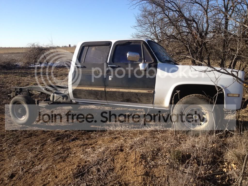

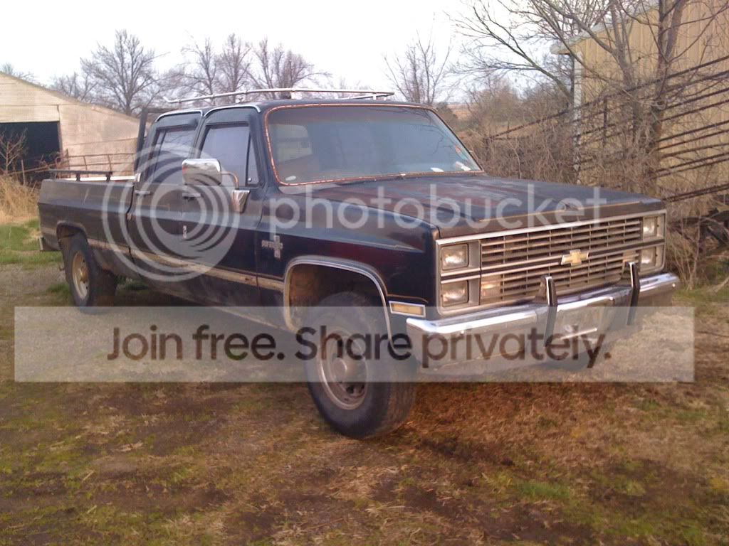

During all of this time I ended up finding a guy selling a 84 C20 crew cab without motor or transmission. I traded him my TH400/NP208 and some cash and had another crew cab setting in front of the shop. This was going to donate its body to the 85.

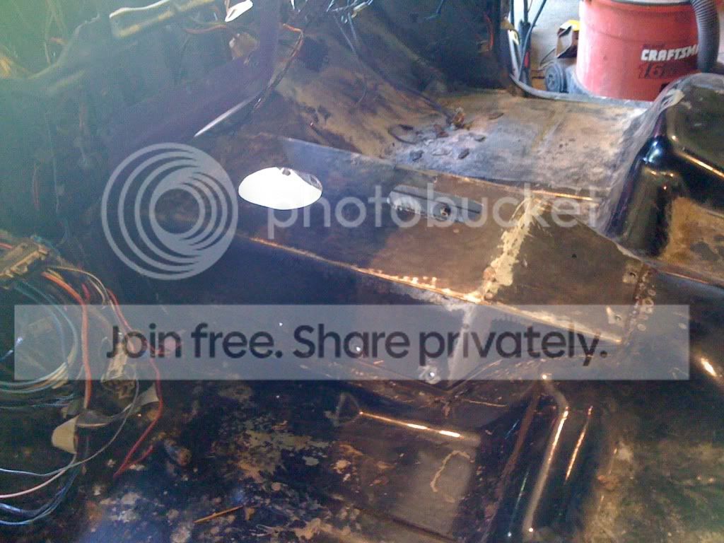

Sense the truck was 2wd and I was using a SM465 transmission the floor was not going to fit, so I welded together a removable transmission hump for my floor.

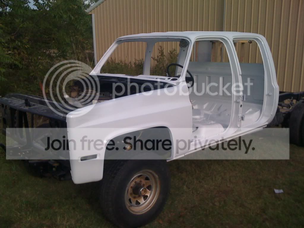

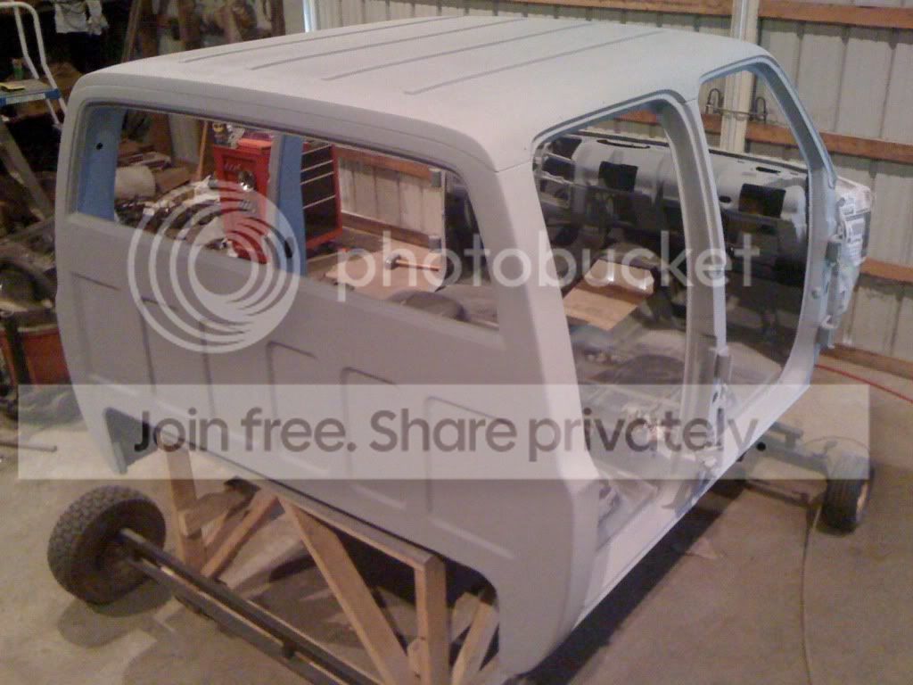

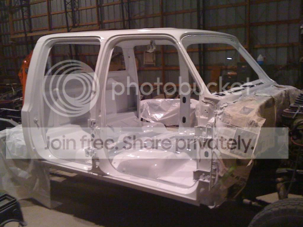

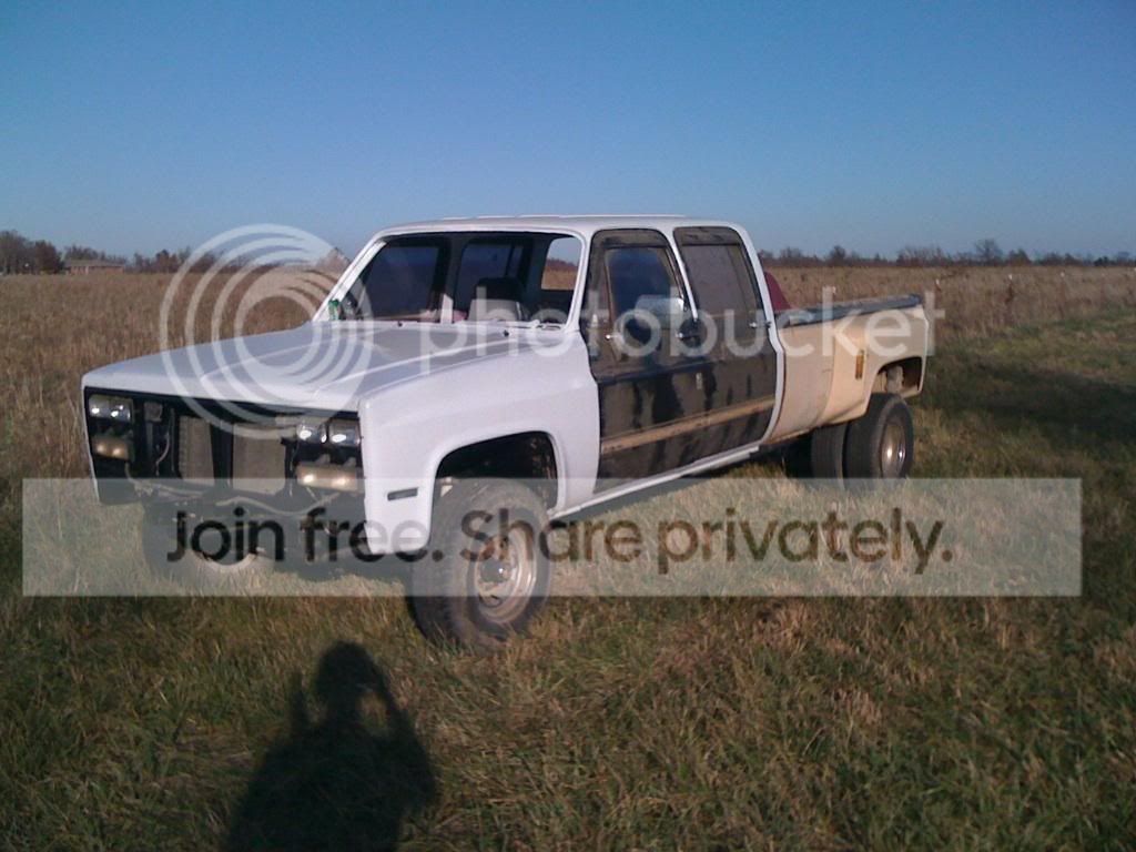

After fixing some rust it was finally time to start some body work.

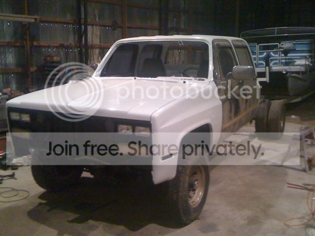

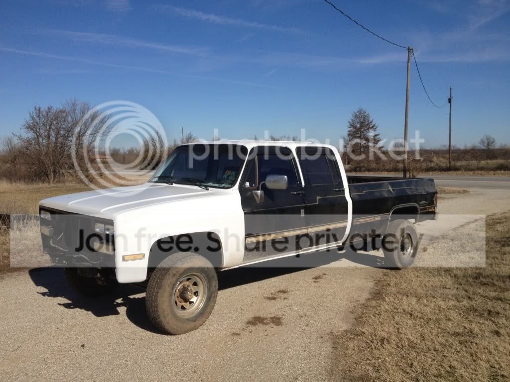

I needed new doors and a new bed so I just painted the cab and front clip for now. I then put it back together and got it running.
After that I drove it around some, but decided I wanted to go back to a SRW truck. So I just took the duals off and threw some singles on the back.

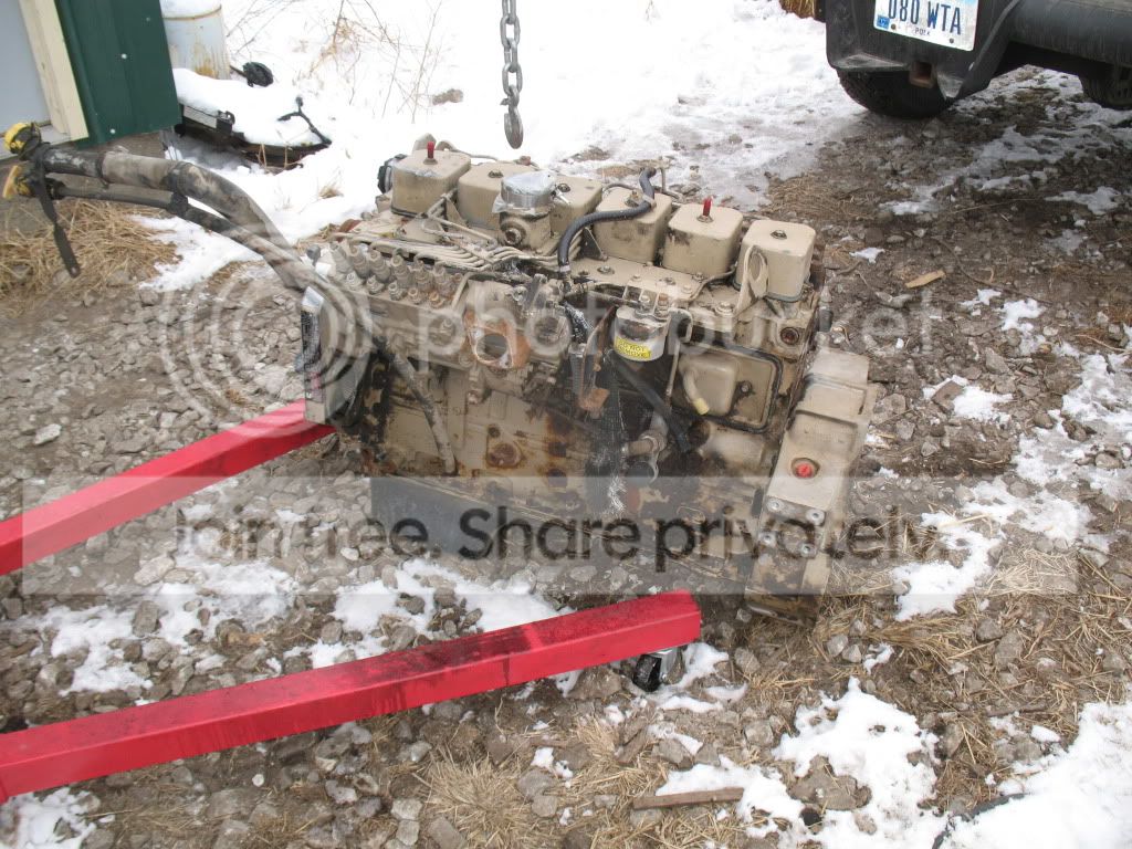

I then found someone willing to work with me so that I could finally put the motor in the truck that I really wanted. A cummins.
94 P-Pumped 12v out of a freight liner, HX35 turbo

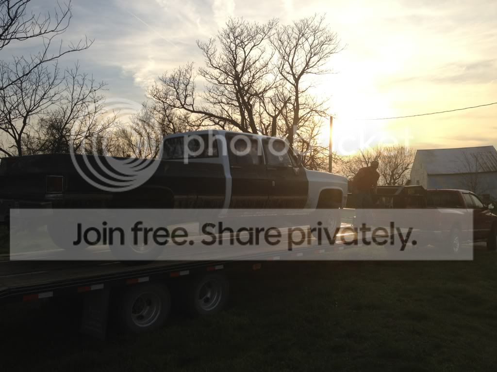

Bringing the truck home

I'd really like to know how you did the engine mounts since it was a 2wd?

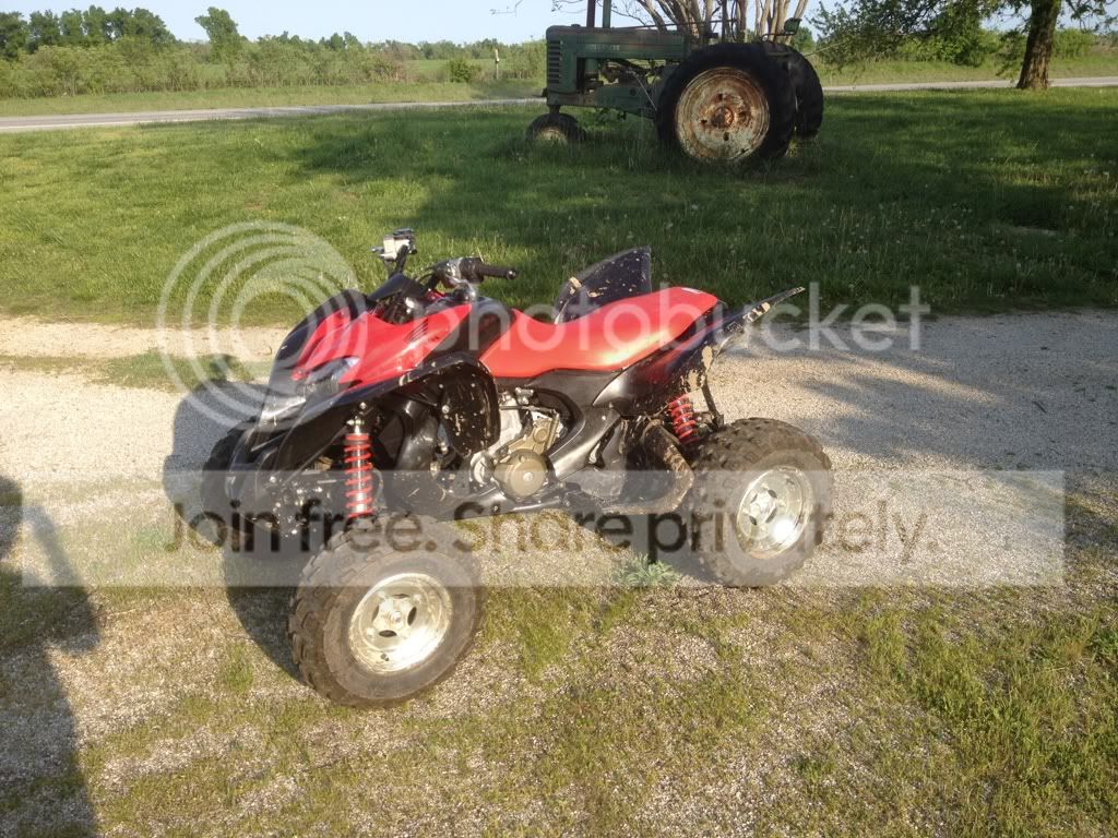

Well nothing new with this truck so far. Had a little bit of an accident on my fourwheeler that I bought about two months ago so I have been stuck in bed for the past few weeks and probably a few weeks more.
This
+ to fast around a corner and hitting a tree resulted in this
Thats why I only ride my quad in the sand :thumb: (its softerer lol and no trees)
Yeah, sand would have been way better. The best part is that I was in a State Wildlife Area and you are apparently not suppose to be riding four wheelers in there. I was not riding in the trees just in the road that runs through there and so I got the Game warden called on me and he showed up shortly after I crashed called the ambulance for me and then told me he had to take my four wheeler. So I get to go to court and pay some fines to get my four wheeler back. :doah:
