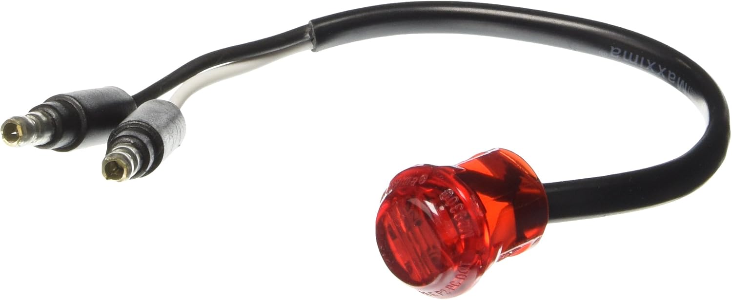

I love the trailer lights. Tons of cool options. I'd do some of these 3/4" ones or something similar on the sides. https://www.amazon.com/Maxxima-M09300YCL-Combination-Clearance-Marker/dp/B00L5204O4
