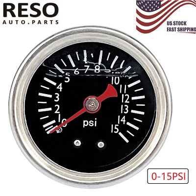

I’ve noticed over the last week or so it’s taking a few more GP start cycles before it starts. And today I couldn’t get it to start. Almost same issue as before. Have a clear line on the IP and it had maybe an inch long bubble at the top. Which has always been like that. While cranking bubble is gone. I’ve cycled the GPs at least 20 times today and had to connect the batteries to jumper cables. Cracked all of the injector lines and a few of them got wet. I can hear the IP click on and off when disconnecting the pink wire. Removed a few GPs and cranked no fuel spitting out. With the electric pump running I have a steady stream from the bleeder valve on the filter. At a loss what to try next. GPs are new. Getting power to all of them. I advanced the timing from one line width to almost two line widths advanced. I don’t see any fuel leaks anywhere. Was running great last time we drove it other than taking longer to start when cold. After it was warm she fired right up every time. I had to get back to work but I’m thinking I’ll remove all the GPs next and crank to see if fuel will spit out. Almost the same problem as before I changed the IP. Not sure what’s causing it.
Next step is to pressurize fuel tanks and check for leaks. There should not be any air in the fuel return. Loss of prime sounds like. Installing an in line fuel pressure gauge would be useful for diagnostics (See pic)

Link to in line fitting:
Link to gauge:
