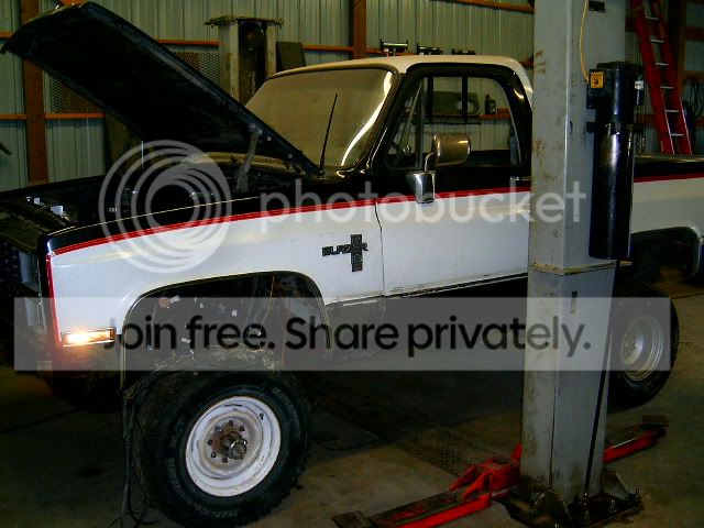

Project CK5!
Stands for cummins k5. Here's a few pics of my project!

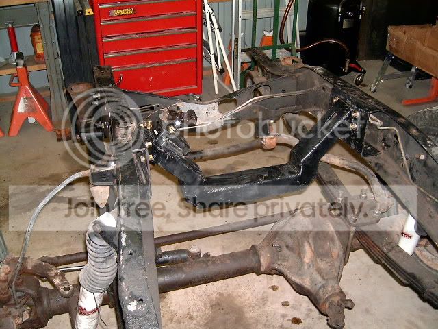

I was gonna ask why the hell is that crossmember so damn big...................Now I know why :wink1: :waytogo: BAD ASS MAN!!!!
Woulda gone with a 4bt but :bow::bow::bow: either way
Yeah the 3.9 is a sweet little engine and 300 lbs lighter but my k5 and the donor were cheaper than any 4bt I have found to date. I have bid on a couple bread vans close to me but never seem to win.
Thats the POOP!!!! Ill be watching this one closely as a cummins owner and avid fan!!!!

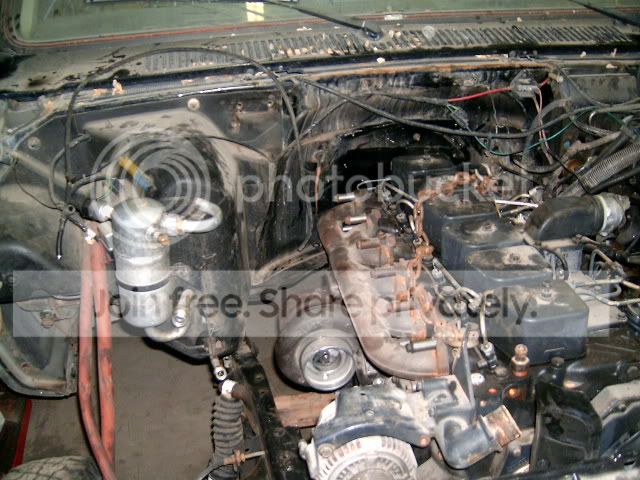

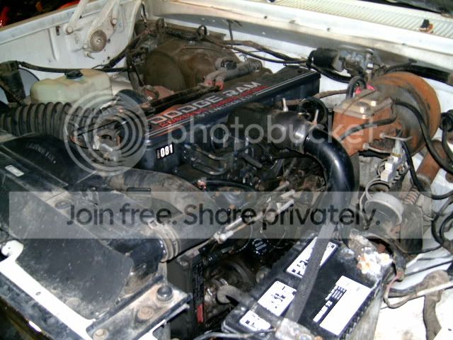

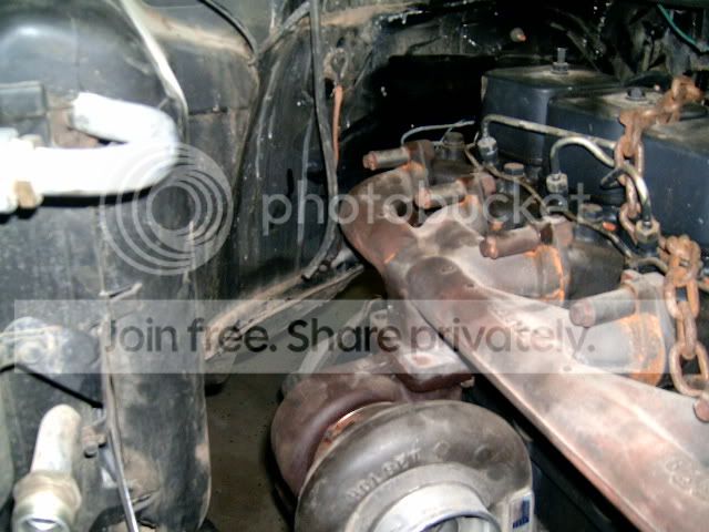

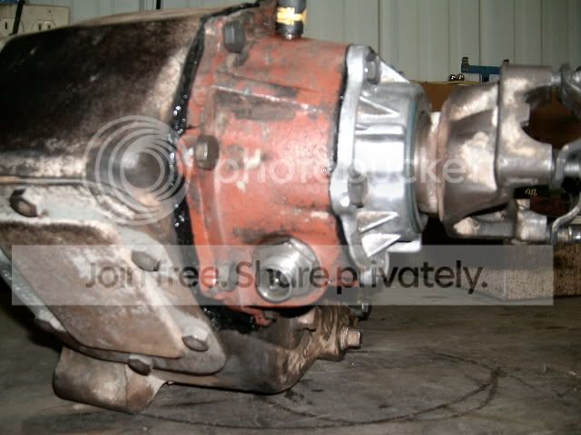

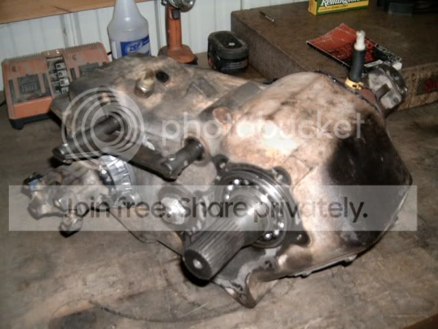

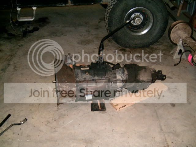

The specs are:
84 k5 with a 6.2/700r4/np208
92 cummins 5.9
97 HD Dodge nv4500
90 29 spline np205 with a chev rear output and housing for the speedo also front 1310 chev output
97 hx35/16 non wg
2003 cummins exhaust manifold
82 chev dana 60
74 14b both with 4.10
35" bfg AT on 16" rims

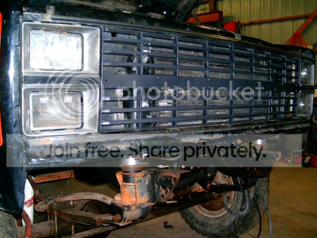

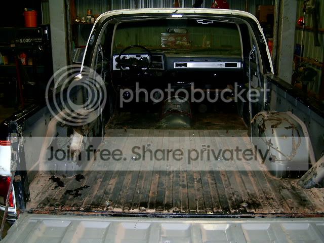

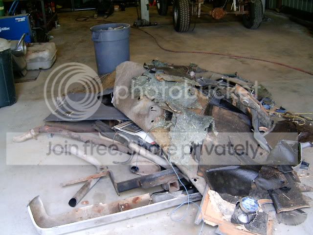

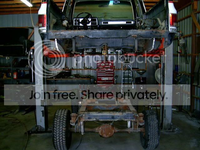

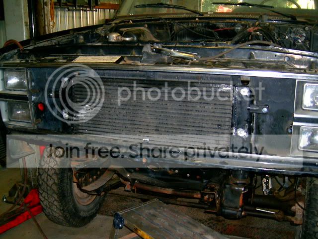

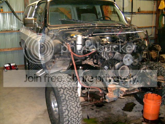

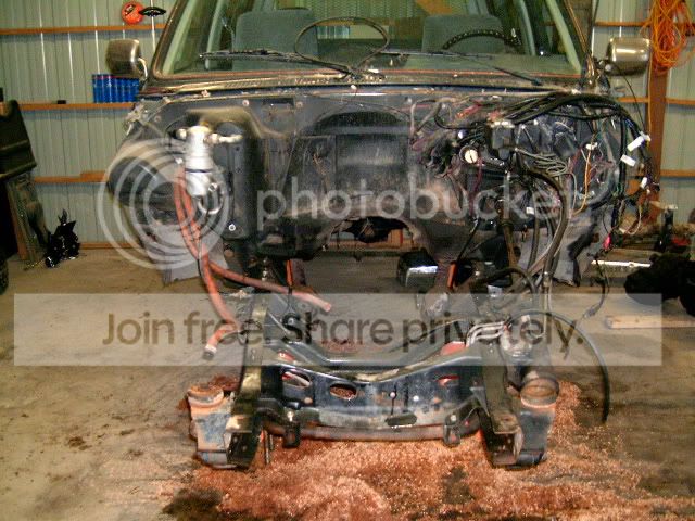

Here are a few pics. of my project before I found my lift, used for 500.00:D If I would of had the lift first I never would have removed the front clip. Also a pile of parts and interior pieces that arent going back in.
that is awsome :bow::bow: everytime i get that cummins in my k5 idea out of my head someone puts one up that is really cool, dammit now i am gonna start looking for a cummins again!:D
Are you gonna P pump it or is it already? I couldnt tell from the pics.
No I will stick with the stock ve, but turned up a little to about 250 hp and around 600-700 tq. Also I will fully box the frame to handle the extra tq.
My neighbor is building a crew cab one ton with a 12v in it I will have to post some pics, must be a Utah thing
I'm interested to know how this thing is going to run! I want to get a M1009 and do the same thing with it so everything your doing will be really useful!
is that an avalanche engineering crossmember? i'm diggin' it!
