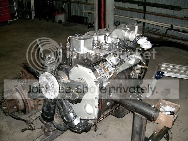

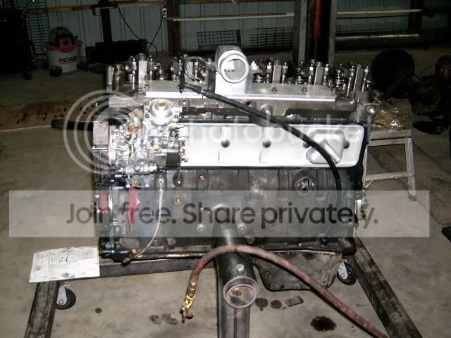

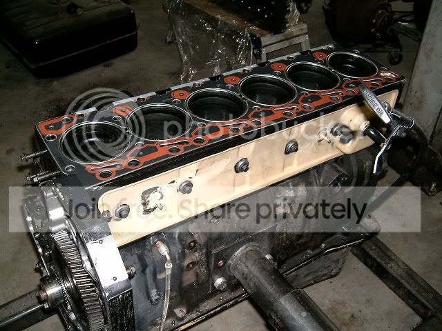

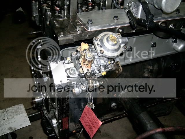

Small update!

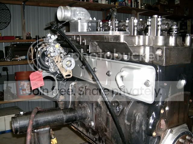

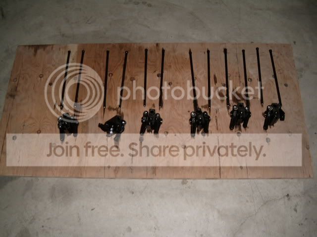

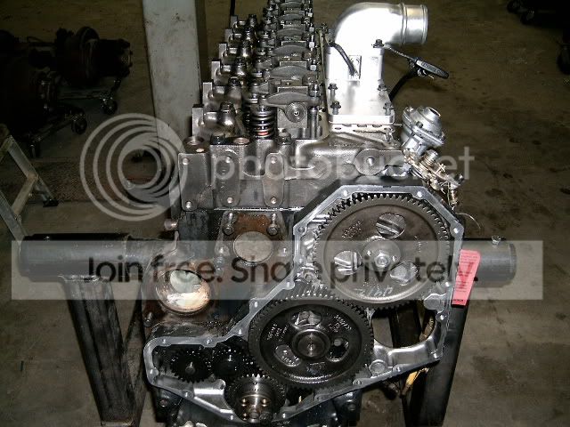

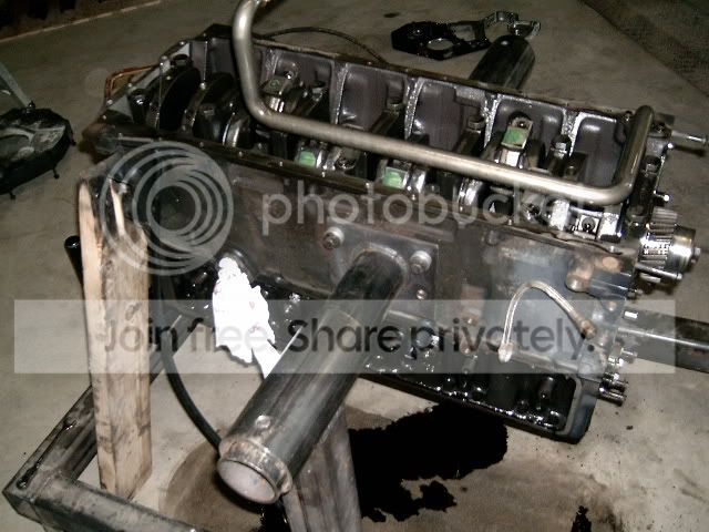

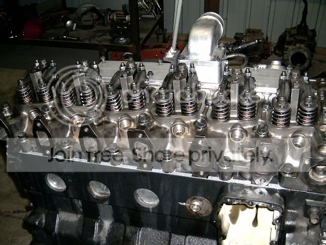

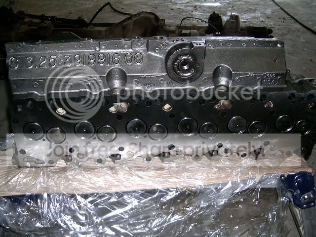

I got the engine completly re-gasketed, rebuilt the injection pump, 60lb valve springs on the intake and exhaust, 366 spring, 195 injectors, custom intake manifold and a complete recon head:D
Lol looks like 360 end to end too.
I was saying to myself, man a diesel doesnt look so different, then I saw the head lol

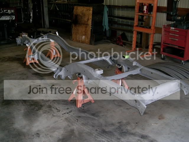

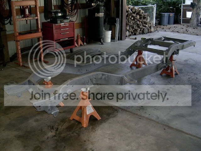

Thanks for sharing these pics! Did you find much rust on your frame? Any weak spots?
I see the body lifted overhead. What was required to remove the body from the frame? Any advice? Some day I would like to do the same with my k5, a frame off restore but I would install the 4bt.
I had very little rust, and plan on beefing up the weak spots before reassembly, I'll post pics in the coming weeks.
I see the body lifted overhead. What was required to remove the body from the frame? .
Un bolt the body mounts, gas tank connections, brake lines, e brake, steering, theres probably more but that's all I can think of for know.
