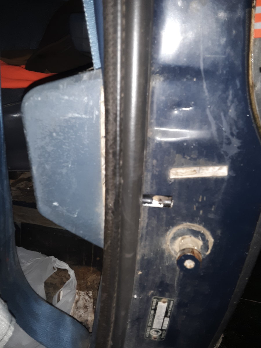

There's a plastic button/switch in door jamb which I am told has something to do with seatbelt release.... Mine are wasted and I can't seem to find new/replacements available anywhere....
which begs the question.. what exactly should this part do, and what will not work without it? Are there are workarounds for when/if the part no longer works? Or does anyone have a lead on where replacements or part #'s can be found for these?

Now that I think about it, this "feature" (was it an option to have tug/set belts??) is probably so you don't squash the belt in the door jamb. If you tug on the belt, it will "set" at that length. If you pull on it again, it SHOULD retract.
If you "set" the belt so it's not super tight on you, and don't tug it, but disconnect the belt end, it will just dangle there, extra belt material all over the place. As soon as you open the door, the button "overrides" the set/tug feature, and forces the belt to retract.

Interior light switch is at the front of the door opening, facing rearward. Seatbelt piece faces outward on the back side of the door opening, inline with the interior belt retract mechanism

I see how the thing works. The retraction part of the belt is mounted on the side of the cab on a K5. With pick-up trucks the retractable part of the belt is mounted to the floor.
I think the layout all has to do with a K5 being 2-door with back seat. When the door opens somebody might be climbing through that space and the belt needs to be out of the way. My 85 has the retractor button on both sides. Truck and Burb seatbelts are different.

'89 F250 has the same button. Normally the shoulder strap is lightly tensioned when I'm driving. If I pull it forward slightly, it will hold in that position and give me some slack.
If I pull farther, it will unlock and go back to tension. If its locked, opening the door overrides the normal locker and causes the shoulder harness to retract all the way so that it does not get caught in the door when I close it.
Due to many years of dirt and whathave you it tends to stick sometimes. I get out and the belt flops after me. If it bugs me, I just reach down and push the button in slightly and let it snap out. That causes the belt to retract normally.

I think that button is a part of the seatbelt retractor that passes through a hole in the door jam. If so, I’d say the belt won’t work without it.
