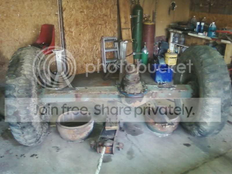

All old brackets are off the rear axle and the welded dif is ready to go back in.
Rear axle on rollers
Rear axle tacked in place.

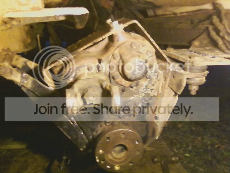

Tcase in place

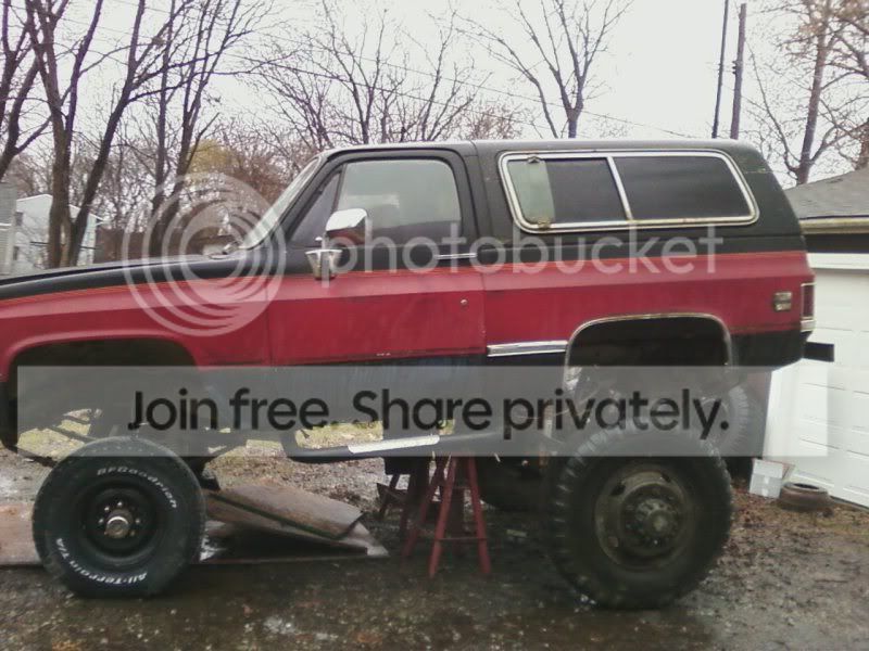

Looking like driveline angles are going to be great.

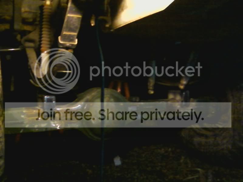

With the divorced case and it also being a drop case, if I were to keep the 14 bolt... driveshafts would be almost horizontal.
So, adding a little lift and the axles... driveshafts will work out with minimal angle.
Compared to the back, there is still 15 more inches of tire to go on it.
The fronts are only 265 16s.
